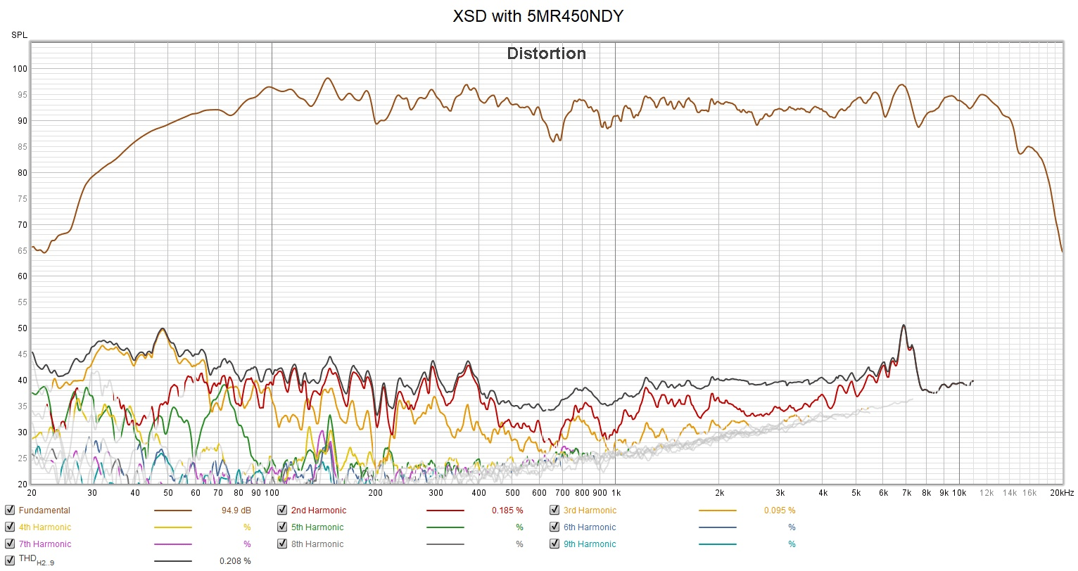

It also depends on how you use the multiple smaller woofers. In the XSD, they are opposed slot loaded drive with the magnet on one facing the cone on the other. The motion cancels suspension induced even order distortion to a large extent. You can get really clean response from qnty 8 x cheap 6.5in woofers. These 8 woofers cost about $100 and have the equivalent cone area of more than two 12in woofers but with a much smaller frontal cross section due to SLOB mounting. This is for moderate drive level of 2.0Vrms (1W into 4ohms).

woofer distortion polute the midrange frequencies. No matter how clean and advanced your midrange is, it can be all ruined by crappy woofer (big or small does not matter, if it distorts).
I think there is a wide spread assumption that distortion is mostly related to excursion only. This assumption is false, and current flowing through the voice coil has a big influence too. Otherwise, why would one see high distortion in some mid range tests where excursion is very low ?
