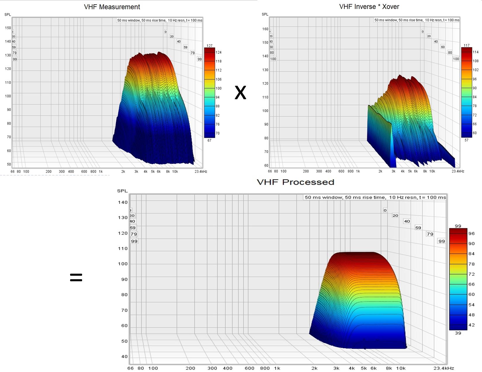

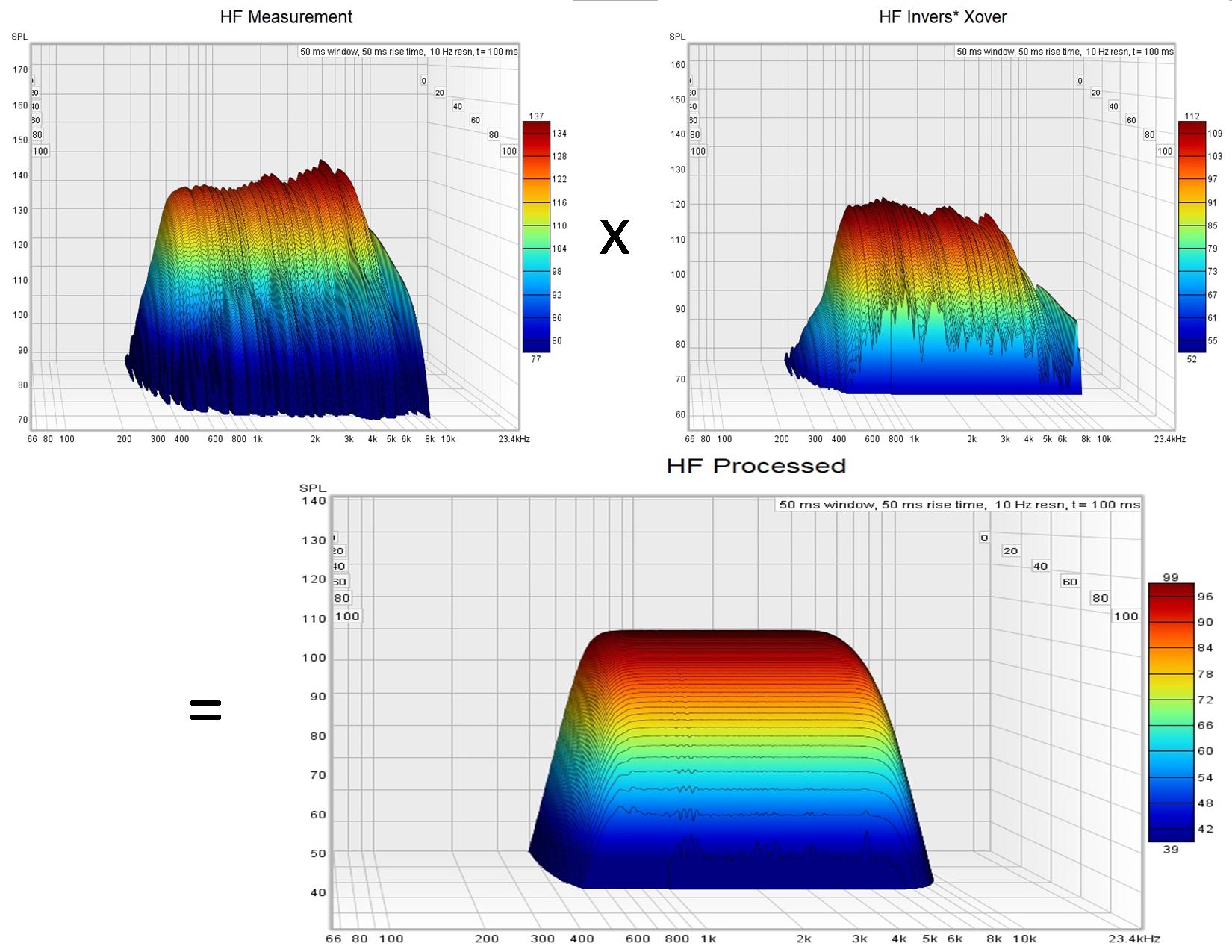

@Boden I am not sure I agree with this as a universal statement. I believe it is possible to apply EQ to a driver resonance, and achieve a flat frequency response. But this is not equivalent to a driver with no resonance. The FR of the two drivers may be the same, but the impulse response and CSD plot will be different. Perhaps you meant your statement in a certain context, and I have misunderstood your point. ?
I'm in the same camp as Boden, i think it's just mathematical equivalencies we are dealing with, including resonances.
But we need to make sure when thinking about this, that frequency response = equals frequency magnitude response and phase.
I've found when doing super duper corrections, using pure impulse response inversions, that waterfalls / CSDs clean up just like mag and phase do.
Examples: here two sections of a coax CD on a horn, measured and corrected in a clothes closet.
Lower CD section Measurement; Impulse inversion with xover added; and Processed result
Upper CD section Measurement; Impulse inversion with xover added; and Processed result

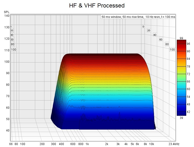

Here's the two processed sections summed together. It was a little mind blowing to see such a clean acoustic output.
Sure, Conditions aren't real world: a. in a closet; b. pure impulse inversion w no smoothing, no FDW, no nothing; and c. to a single mic spot
But the fact these are acoustic measurements showing this kind of cleanliness, .....well it says to me the Fourier math is spot-on bingo!
And handles spectral decays too, I think..🙂
