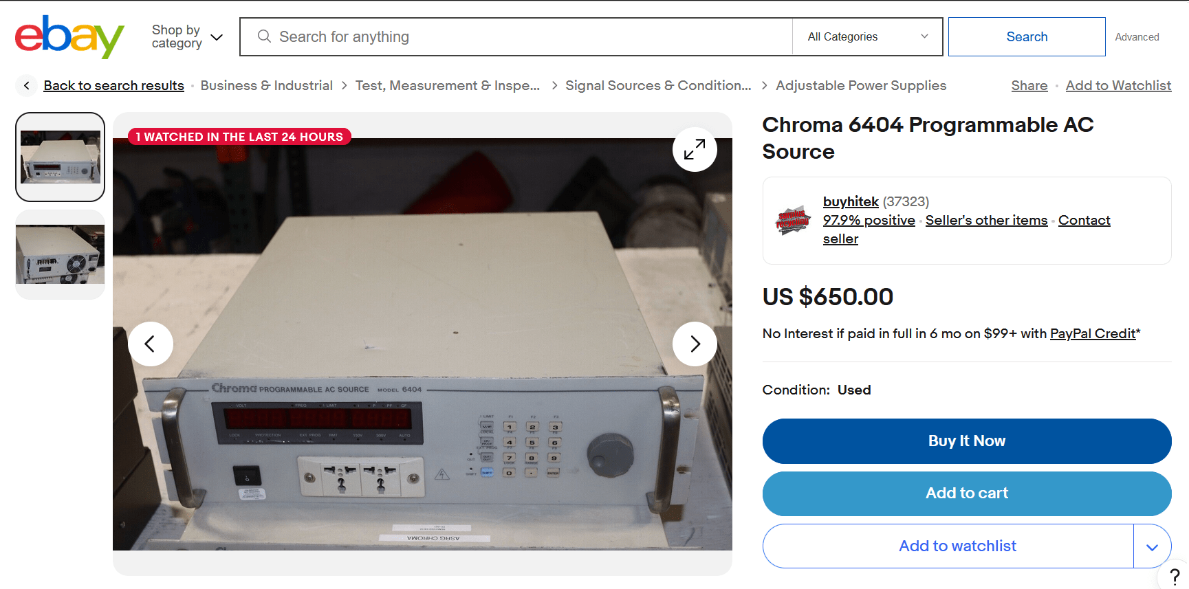

They do have the so called AC source, which was a piece of equipment I used to use to test computer power supplies. 50 Hz in, 60 out no problem. There's your hum or power supply ripple. Price of a good pedal on the used market, which makes it actually reasonable / obtainable for a studio that wants to offer this level of detail;
