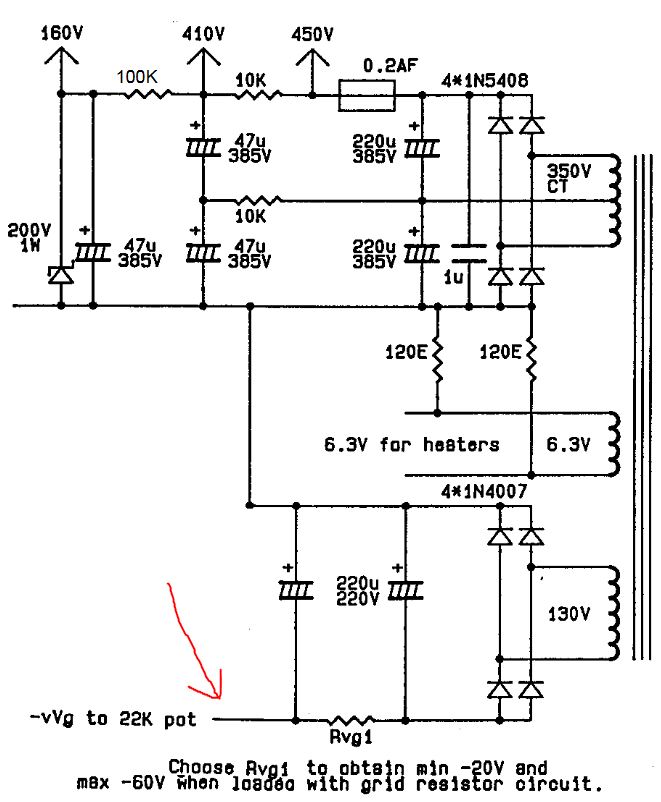

Good day. And why did you use the rectification of the power supply of the incandescent lamps, and not just apply a voltage divider and did not apply a positive potential to the incandescence of the lamps? I collected a similar circuit and the 50 hertz background was cured precisely by supplying a positive potential to the incandescence of the lamps.

Can you please explain exactly what you mean? I kinda understand but I'm not exactly sure how one would implement this.
Everyone is just a colleague. From the rectified anode voltage of + 440 volts, we put a voltage divider on the case, consisting of two resistors, the voltage of which should be + 90 volts, from the same connection point of the resistors on the case we put a capacitor of 1 MkF. Disconnect the heating circuit from the case and apply voltage from the divider. In my amplifier, the filament winding is one, so all the lamps, including the weekend ones. powered from it - there is no background and it is close even on the spectrum analyzer and by ear. Until I did so, the background was quite noticeable.

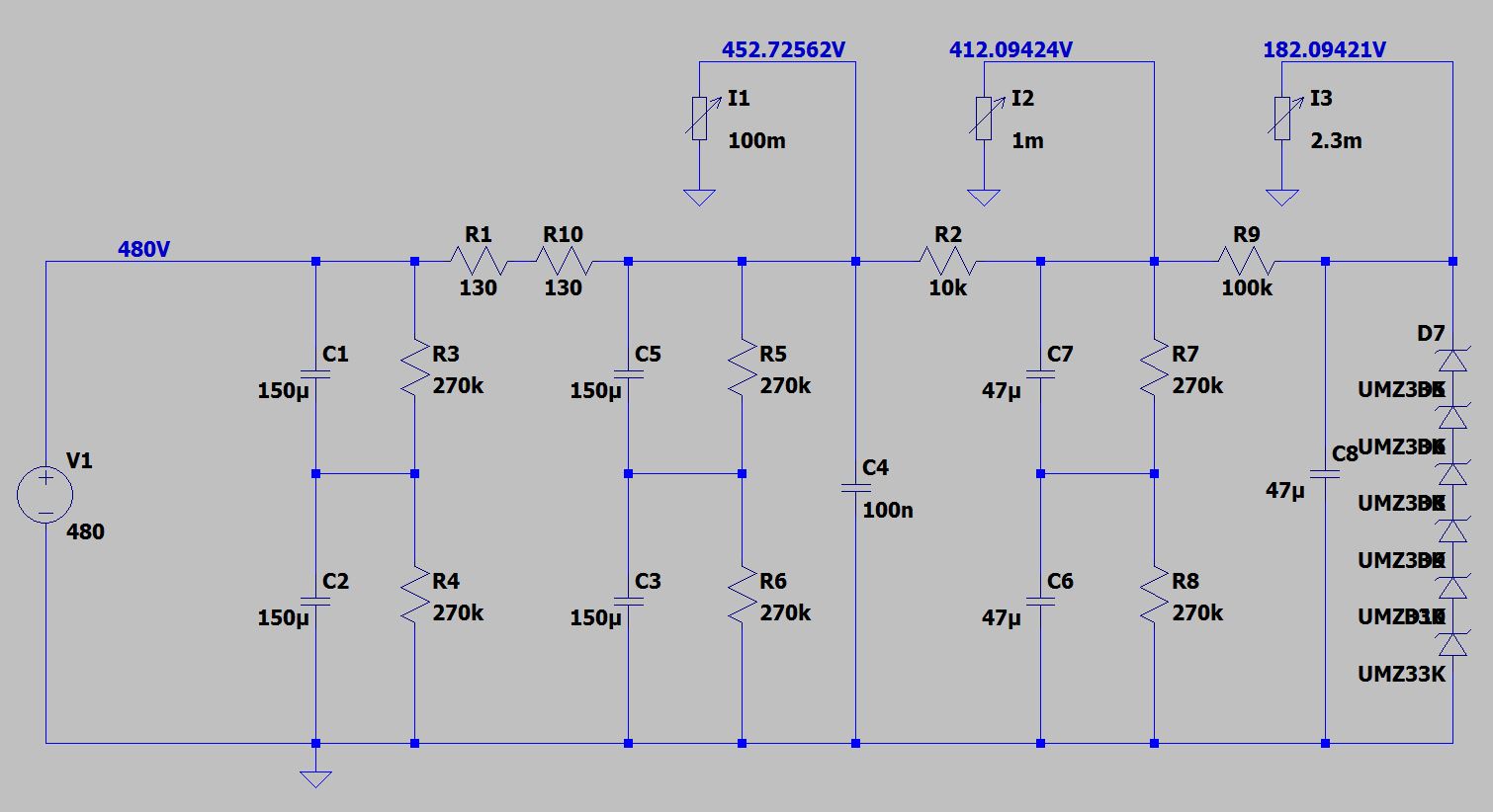

I've a power transformer with 365 Vac @ 400mA secondary (510/520 Vdc after rectification NO LOAD).
Can I use this for a first quick test of one channel of this amp? Just to evaluate any problems (and sound ) before purchasing and putting the final transformer.
You think that B+ it's too high and risk of serious damage?
Naturally B+ under load it will be lower but not much.

The 510-520 Vdc is my estimate voltage output (365*1.41=515Vdc).
I simulated and built this PSU and measured around 480Vdc (NO LOAD) so i think it might work. The PI section filter goes down a bit the voltage closer to specification.
Under load it should go about simulated. Of course, as already mentioned, only for the purpose of the first test.

OK I would be putting say some 50v 5W zeners in series with the 1K resistors on the screens of the EL34 just to get within spec. Say 425V max here. Or if you want to use that transformer maybe KT77. Even at 440V I think the reliability of EL34's would be compromised.
