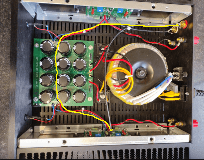

Logic800 - Another thing you can try that should reduce the loop area (and gain some distance from the secondary wiring and rectifiers) is to lengthen the input cable on the right channel and route it like my picture (the path of my yellow line).

Joined 2001
There is more loop area for induction coupling once the input cables are connected and un-wanted noise currents are flowing through the interconnect signal return. We only want signal current on there without the nasties. It was just something to try that may / should be better with this sort of layout, that's all.

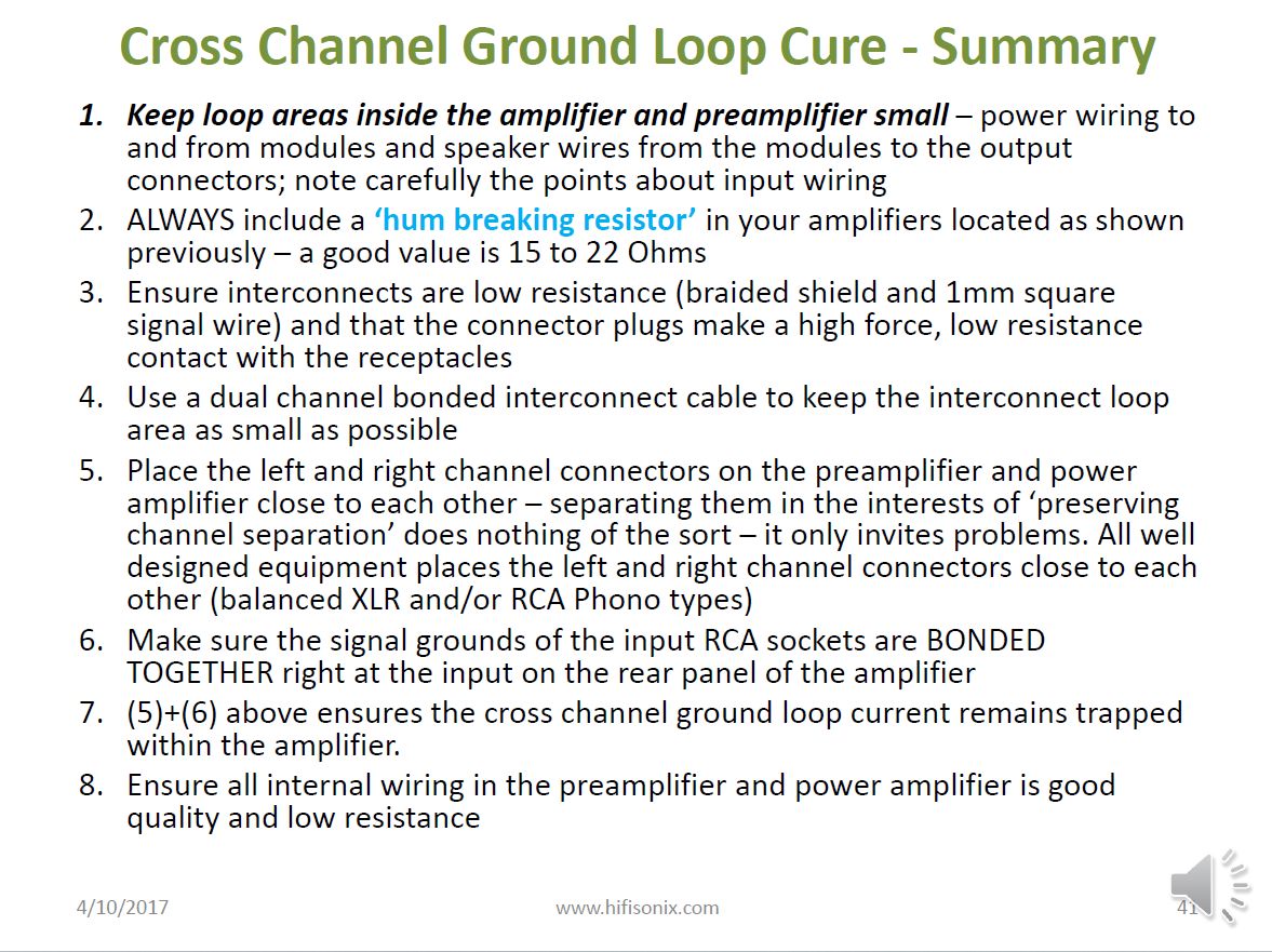

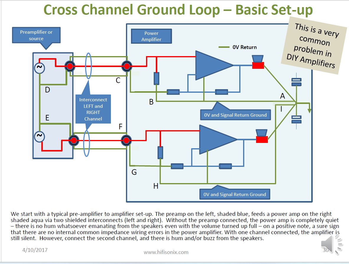

Help with buzz. Now that I have the heat issues under better control, the next thing on the list is a faint 100Hz buzz when my ear is up against the speakers. It doesn't change with volume and isn't there with input cables removed. In fact it isn't there when the input cables are attached but not connected to the preamp (a Whammy). When I connect the preamp the buzz occurs even if it is switched on or off, or even unplugged from the mains socket. Unplugging anyone of the cables (from preamp to amp) stops the noise so I tried removing the return shield on one cable but the buzz returned.
diyAudio member Bonsai (Andrew Russell) has much information on fighting amplifier noise. This is one of his articles:https://hifisonix.com/wp-content/uploads/2019/02/Ground-Loops.pdf

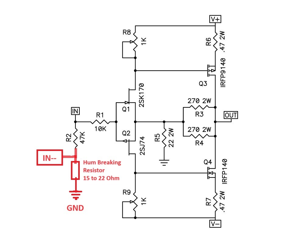

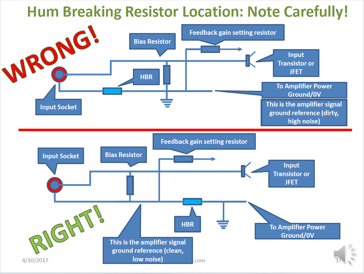

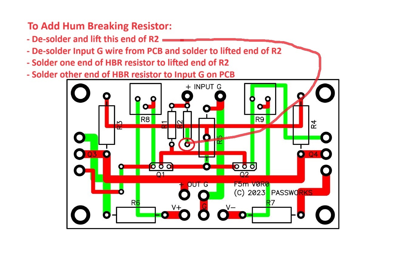

You may have a cross channel ground loop problem. See excerpts from Andrew Russell's article. william2001's suggestion is one of Andrew Russell's suggested cures. This alone may not cure the problem. The other cure is to add a Hum Breaking Resistor to each amplifier channel.
Some excerpts from Andrew Russell's article attached below.
If you wish to try adding the Hum Breaking resistor, also see below.
Reactions: 5 users
A quick question; isn't the 10ohm thermistor on the PSU board, that connects 0V and chassis ground, doing the same job as a HBR?
Not the same, that one is for safety, and allows fault current into the chassis and the IEC safety ground.
A 10R resistor between the input socket common and the audio circuit common reduces ground loop hum/noise.
