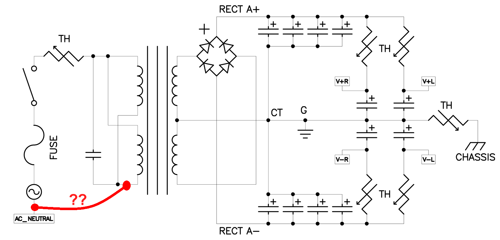

Is this a mistake?

I must apologize. I did not disclose the fact that a top cover was not included in the purchase of my enclosure, and my temps are achieved while going topless.
Have you tried a second test with a solid panel (cookie sheet, cardboard, whatever) place over the top for comparison. It seems to me that Imperfect as it is, simply sliding the panel over to allow a 5%, 10% etc opening may be helpful in laying out/buying a permanent lid. Cheers
Nice idea on the sheet pan. I cut aluminum by using a jig saw, then some clamps and a 2x4 for sanding a straight edge . I then use a belt sander (3x21or 3x24 is a good size) makes almost perfect results.Need to file the sharp edge with a file of course. I suppose a table saw with a metal blade would also work well. I assume one could use a masonite or plywood backer for thin gauges.
