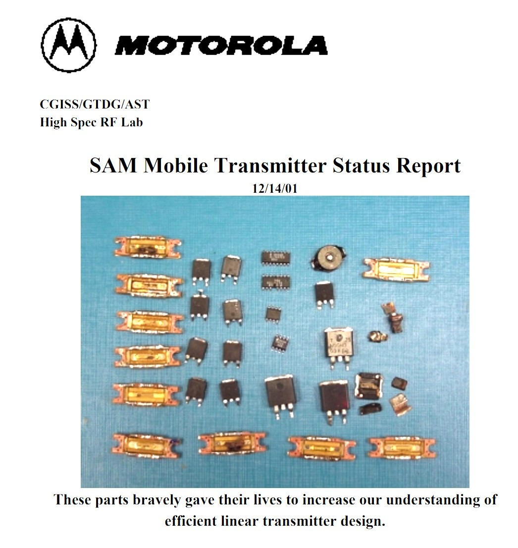

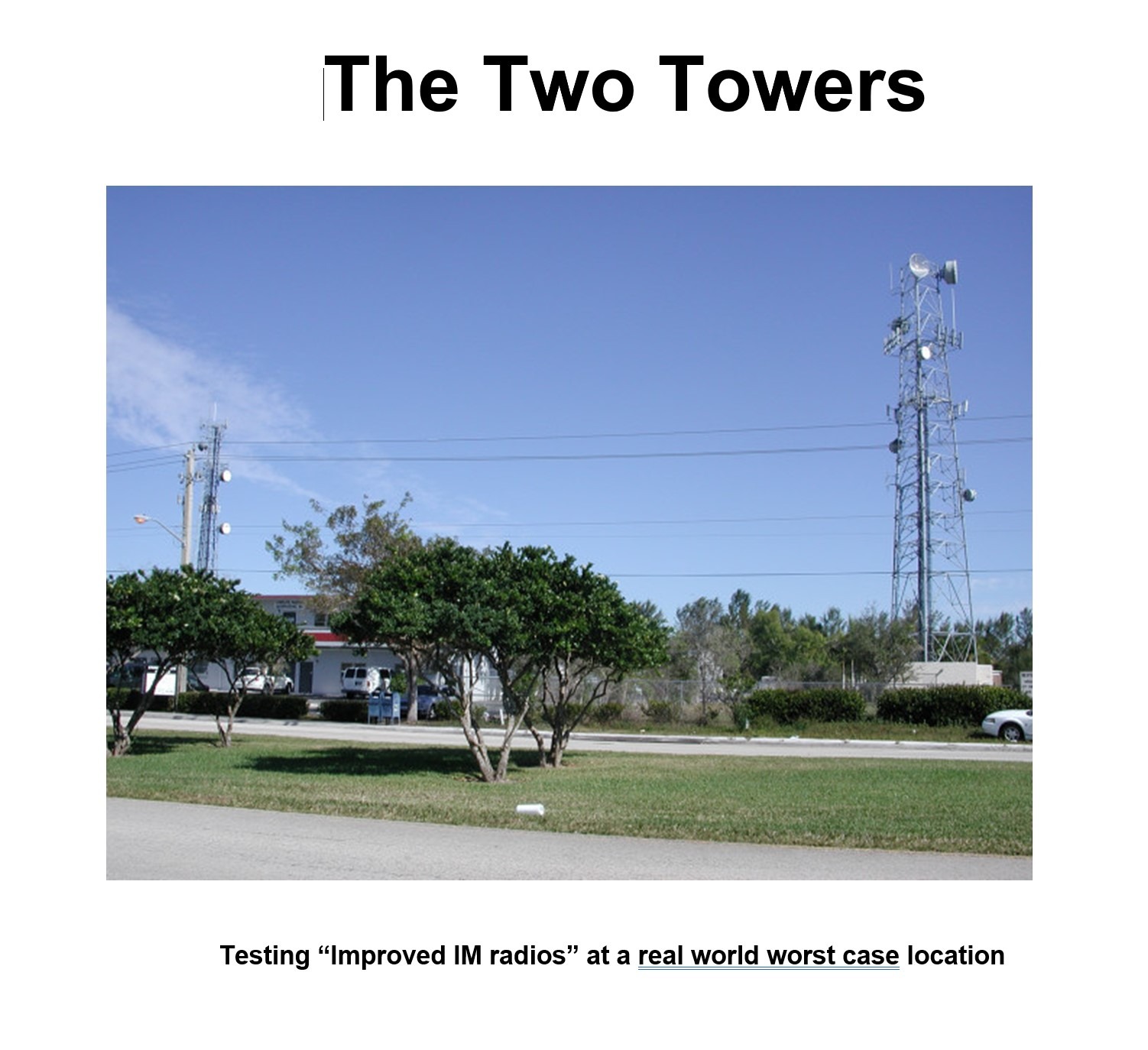

Load pull tests on a potentially unstable amp can make flaming parts. The last photos show the cover of two reports I wrote. Sometimes it's hard to get management to even read the reports that they spent a boat load of money on. This one, and most of my others got their attention. Yeah, I worked on FM receivers too. that report was written at the time when a big movie with the same name hit the theaters. The nose of my white Mustang can be seen in the picture.

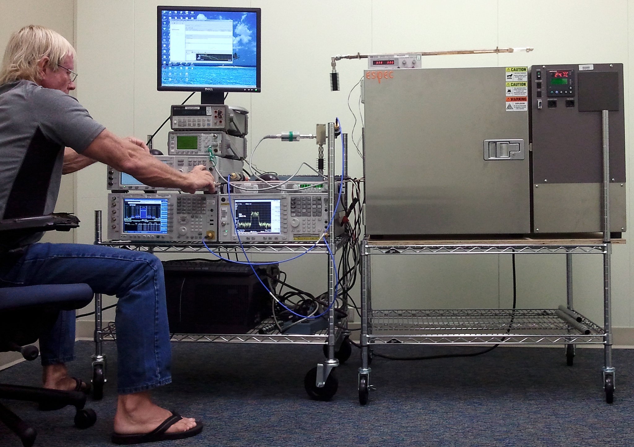

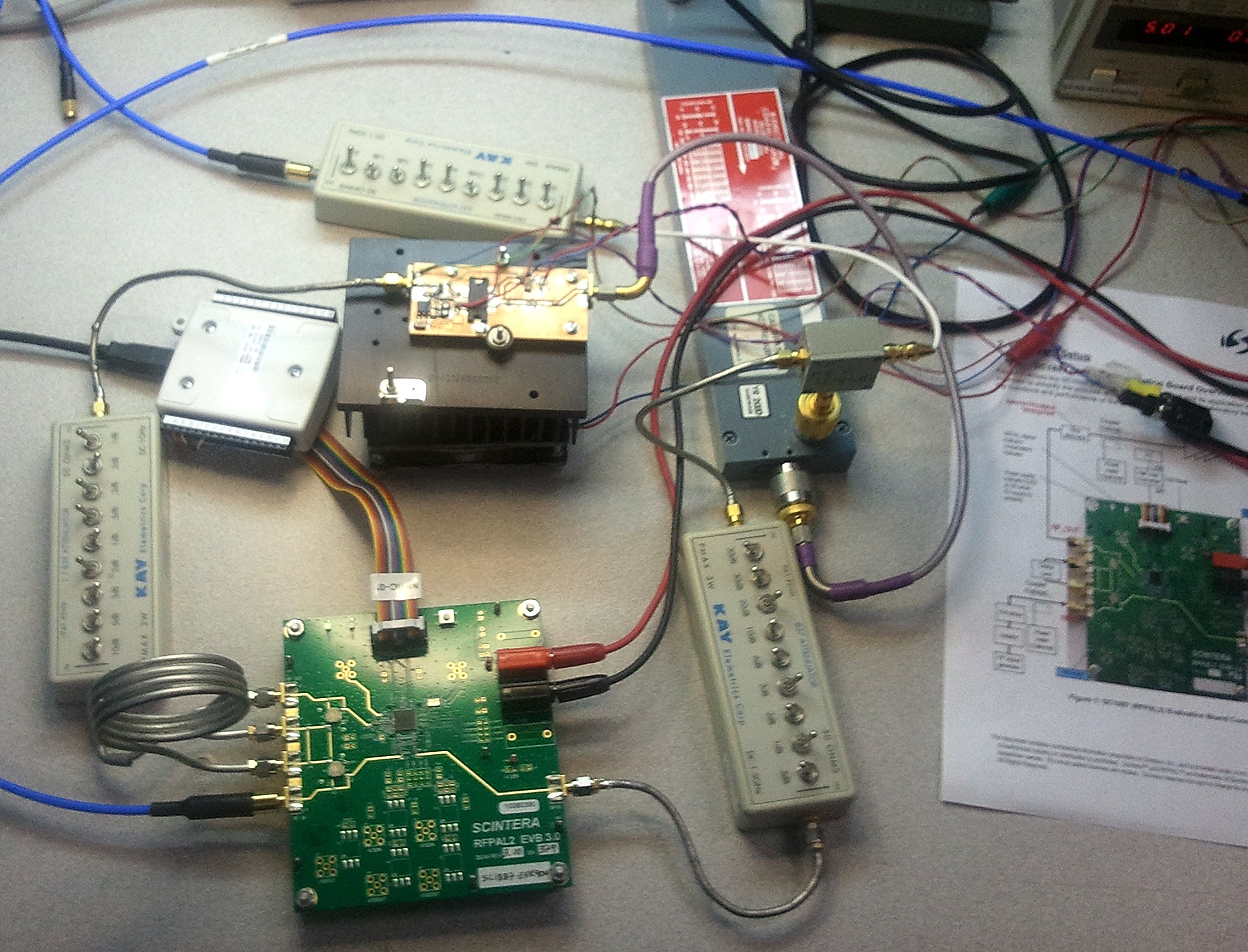

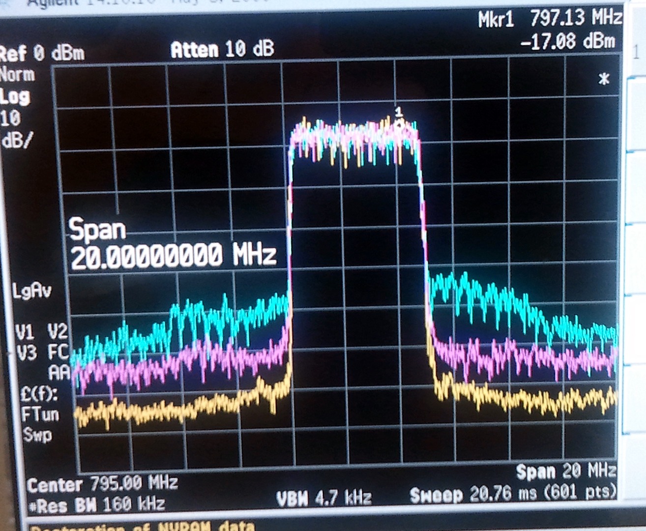

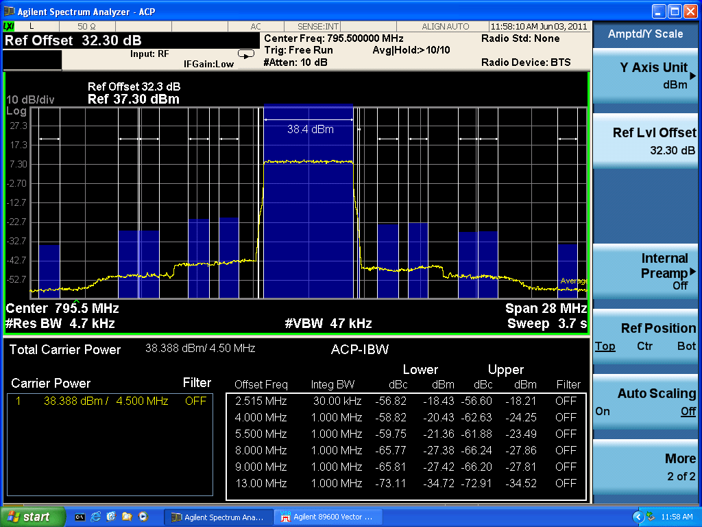

these experiments involve a 5 MHz wide LTE transmitter at 795 MHz with 100 watt peaks having a 10 dB peak to average ratio (sometimes called crest factor in the audio world). Dynamic pre-distortion being tested over temperature and load pull conditions. Trombone line (variable length 50 ohm line) and box full of assorted mismatched loads on top of temp chamber. Scintera pre distortion chip test at room temp with a 50 ohm load (the control, or known good condition). Quick response analyzer on right sees quick bursts of unwanted energy when the load is varied. A "Trombone Line" is "pulled" (hence the name load pull) to vary the phase of the load mismatch. Yellow is input to power amp. Blue is uncorrected output. Pink is with pre-distortion engaged. Better analyzer on left measures the Adjacent Channel Power that leaks into the nearby RF channels due to IMD. It will calculate the amount of leakage that's seen on the quick response analyzer. These analyzers look at the frequency VS power level of an RF signal. Just as a speaker is almost never an "8 ohm" purely resistive load, an antenna on an RF transmitter is not 50 ohms resistive. The load impedance varies as anything in the surroundings move, and it must eat some of the output from all the other transmitters in the vicinity of the antenna.
Top secret (as of 2011) Scintera chip test with 10 watt Peak RF Power Amp. Scintera was gobbled up by one of the bigger fish in the chip business after it was shown that their stuff worked.

"You know you're good when they let you wear flip flops at work"
They enforced a "closed toed shoes in the factory policy" in the 70's and early 80's. By the mid 80's there were too many people from India and the middle east working there who wore sandals, and the factory no longer built anything larger than a walkie talkie or cell phone, so that policy might have been still on the books but wasn't enforced. Flip flops were pretty common as we WERE in south Florida. So were shorts and a tank top in the summer. The building where I worked was not near what was left of the factory and was for the most part uninhabited. Let's just say that there was more than one person in our lab that ran around barefoot for a couple years. These pictures were taken during the reconstruction of our building for the plant's eventual sale. Flip flops were needed due to scattered construction debris like sheetrock screws and broken glass. The plant was sold before I left and Chewy, the dog food company now occupies that building and the other "engineering building." Motorola still leases a part of the original factory building. Somewhere between 200 and 500 people work there now. There were over 5000 in its heyday.
