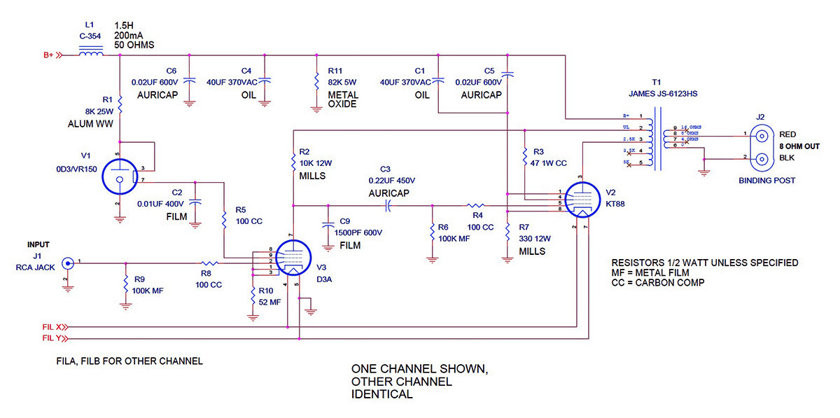

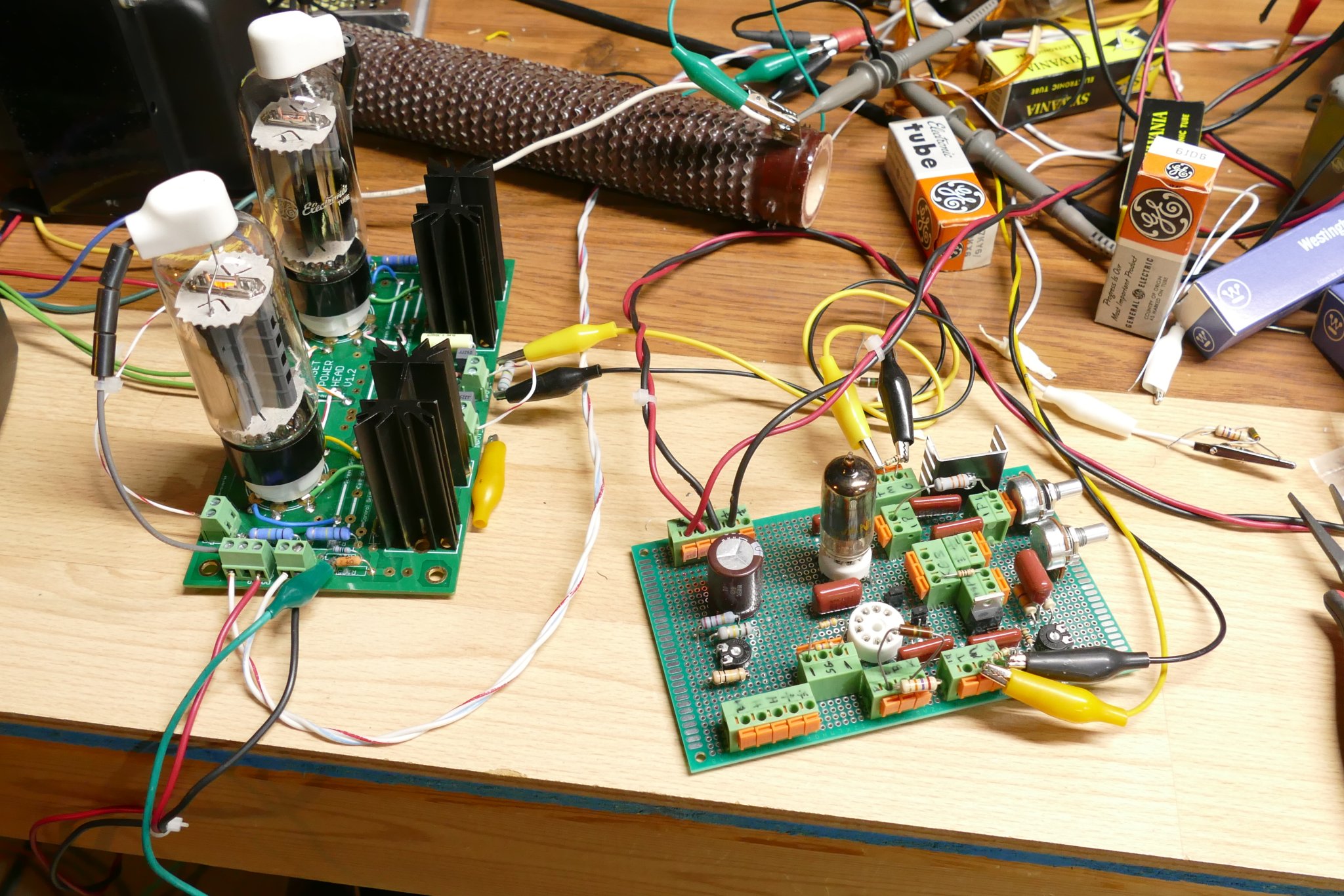

I mocked up a version of Michael Koster's Schadeode and tried it with several different tubes. My power supply maxed out at 550 volts and the output transformers were rated for 80 ma.
https://www.diyaudio.com/community/threads/set-build-recommendation.370350/#post-6599691 see post 18

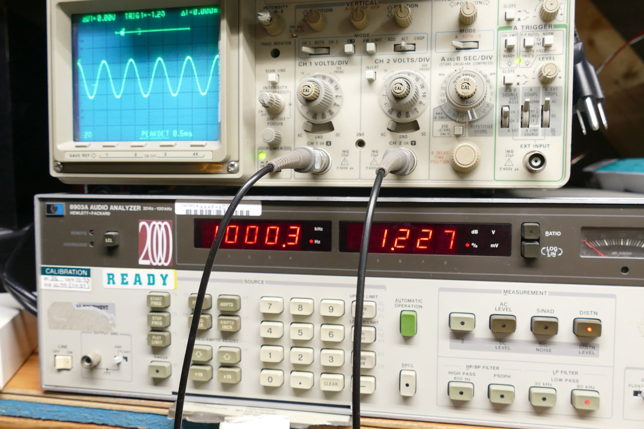

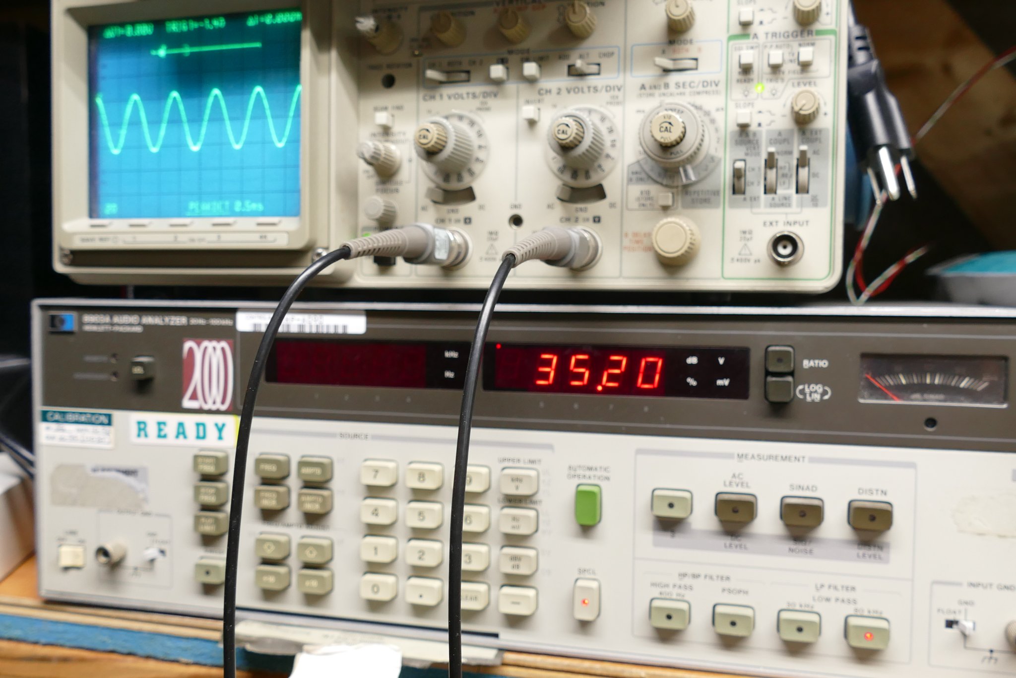

After the post above I tried a KT88 at 80% plate dissipation and got 16 watts at 3% distortion. I used a 5k impedance transformer for all tests. With a higher B+ voltage or a transformer rated for 100ma I expect I could have got 18 watts but the difference would be negligible. I did not try this experiment with a 3.5k impedance transformer which might be more ideal for the KT88.
I liked the sound as much as all of my other all tube SE amps with the exception of my Mingda 300B amps.

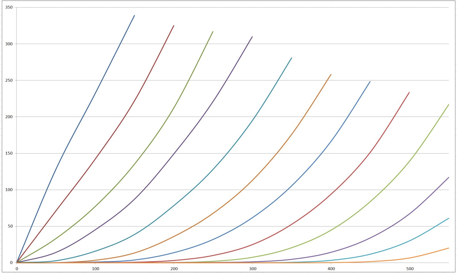

The curves shown in the picture were hand traced on a 6GF5 TV sweep tube. The resolution of the variable power supplies and Harbor Freight DVM's used is the reason for the slight offset and bend in the purple trace near the top.

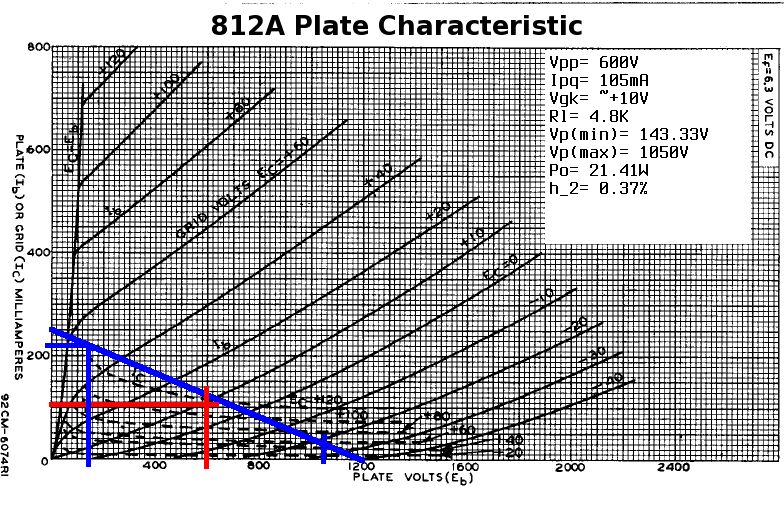

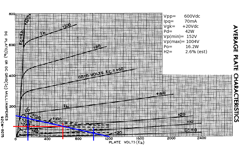

811 Loadline (attached)
812 Loadline (attached)
These two types have very similar characteristics so far as plate dissipation is concerned. The 811 is a "zero bias" RF triode that's seen in ESSSSS-loads of RF amp designs. The 812 has lower u-factor and rp for better performance as an AM plate modulated RF final. Both can make ~15W as an SE triode audio amp, though that'll require going Class A2. A MOSFET source follower can slap those grids silly.
As with anything, the devil is in the details. The A Number One "Devil" is the OPT. I gave up on this particular project due to there being no OPTs. Having the OPTs as a custom job was out of the qiestion since I couldn't find a supplier who could guarantee the specs needed for sonic excellence. Single ended OPTs really are a black art.
