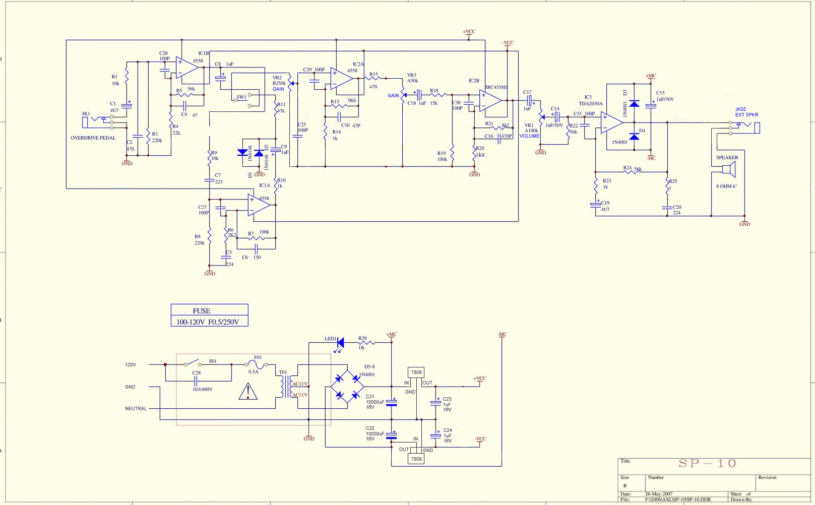

I've got a Fender Squier SP-10 amp that was given to me along with several pieces of test equipment.
I don't play instruments so I built a simple detector and use that to receive the signal from my part 15 AM transmitter so I can monitor it.
I discovered the bass response seems better with the back off and the bass control full.
The tone control circuit is weird.
It's like an individual volume control for the bass and the treble.
If both controls are fully CCW, there's no audio output.
If the bass control is turned up, the volume level of the bass changes.
If the treble control is turned up the volume level of the treble changes.
If the tone controls are set to the middle, does that provide a flat response?
Had thought I'd need to up the values of the audio coupling caps, but using the values of the capacitors and whatever resistance there is to ground after the cap then plugging them in to an online calculator I see the frequency response seems flat to 10Hz.
Also I don't quite understand the low pass filters on the OP-AMPs. What's throwing me off is the 100pF caps between the + and - OP-AMP inputs. I'm assuming maybe that is to reduce unwanted oscillations, but am not sure.
I also do not quite understand the 1uF caps between the resistor on the - OP-AMP input and ground.

It appears there's no setting of the tone controls that could yield truly flat response.
The 1uF coupling capacitors are large enough, because the loading resistances are high, 100k.
The 1uF in the op amp feedback reduces the gain to unity at low frequencies.

So the 1uF cap serves as a high pass filter, right?
If so how do I calculate the frequency?

The 1uF in the feedback networks reduce the bass. But to unity, not to zero, so they are not exactly a high pass filter.
If you don't need the tone controls, there would be flatter response and more gain if they were bypassed.
For the coupling capacitors, f = 1 / ( 2 x Pi x R x C )
If C = 1uF and R = 100k, then f = 1.6 Hz bandwidth.
For the feedback networks, the calculation is similar, using the feedback resistor that is in series with each capacitor.
Note there are different resistor values used.

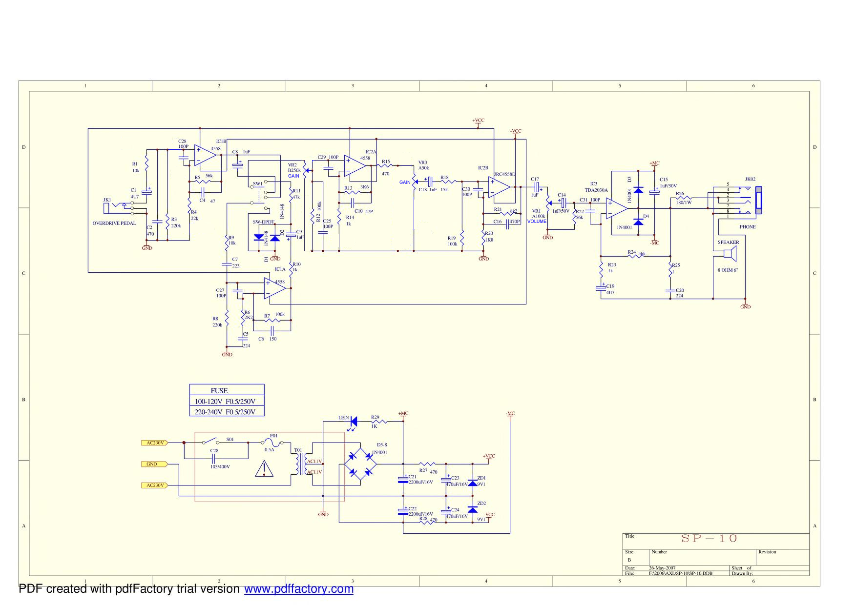

For the tone control circuit, here's what I've thought about doing.
Remove C12, R16 and R17.
Put a wire across the terminals where C12 connected.
I'd then have a gain control between the second and third stages.
With the tone control circuit as it is, I can see why this amp isn't very highly regarded.

Instead of using a cap for C3 and C11, I just shorted across them.
Doing the mod to the tone controls now allows me to drive IC2B into distortion fairly easily.
For someone who plays guitar, they might like that feature.
The amp does sound tons better now. Even has decent bass response.

Here's the updated schematic.

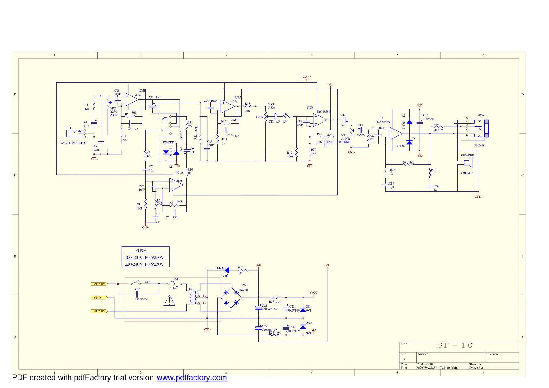

VR3 isn't needed for sure, however it does provide a more fine adjustment over the gain than VR2 does. I also basically left it in there as I don't like having a control on a device that does nothing.
Had both pots been the same value, I could have used a better tone control circuit, but given I desired flat frequency response, I doubt tone controls would have been beneficial.

Here's a thought. Why don't I do this?

Here's the new schematic and the amp seems to work great.
I thought about removing R12, but if I do that, will C25 have more of an effect on the audio or is its value so small that it only suppresses unwanted oscillations?
I probably should have moved C25 to the switch side of VR2 though.

VR2 is now the resistance to ground for IC2A + input.
My schematic is a little different in that SW1 is a SPDT switch and merely selects between the regular and overdrive which causes a problem as with the volume controls set to 0, there's still a barely distorted audio in the speaker.
Either mine was an early version and the schematic is a later revision where they fixed the problem, or mine is a later version and they cheapened things by using the SPST switch.
I disconnected R9 and now there's no audio in the speaker when the controls are set to 0.
