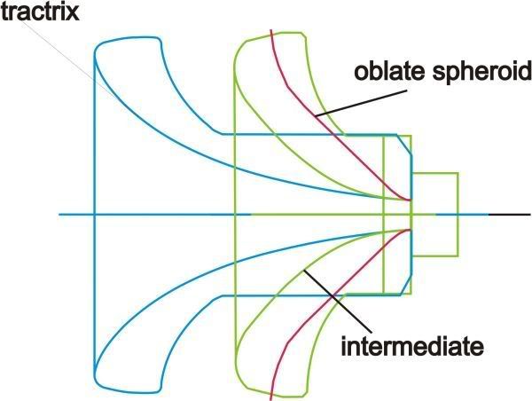

I have a single Lowther A55 waiting for use but the question is somewhat generic - I've been looking around for inspiration and I see a lot of people have been happy putting a full range driver with whizzer cone into a front loaded horn. So I've been reading up on horn theory, and see how a front loaded horn works with a cone driver. But there's not much written about how a whizzer cone driver works in such a horn.
The popular tractrix profile, and other similar profiles usually require the horn to have quite some length in order to reproduce lower frequencies and this looks like a bad starting point to me for a whizzer cone as the high frequencies will be radiated into the walls of the throat and bounce around from there. Or the throat simply cuts off the higher frequencies altogether. I can see why some folk just cut off the whizzer cones and add a separate tweeter.
So it seems to me that only a shallow horn is practical if the whizzer cone h.f. sound is to be preserved. Then it's down to conical profiles for the most part, or oblate spheroid for better loading of the main cone.
Anybody looking into this ??

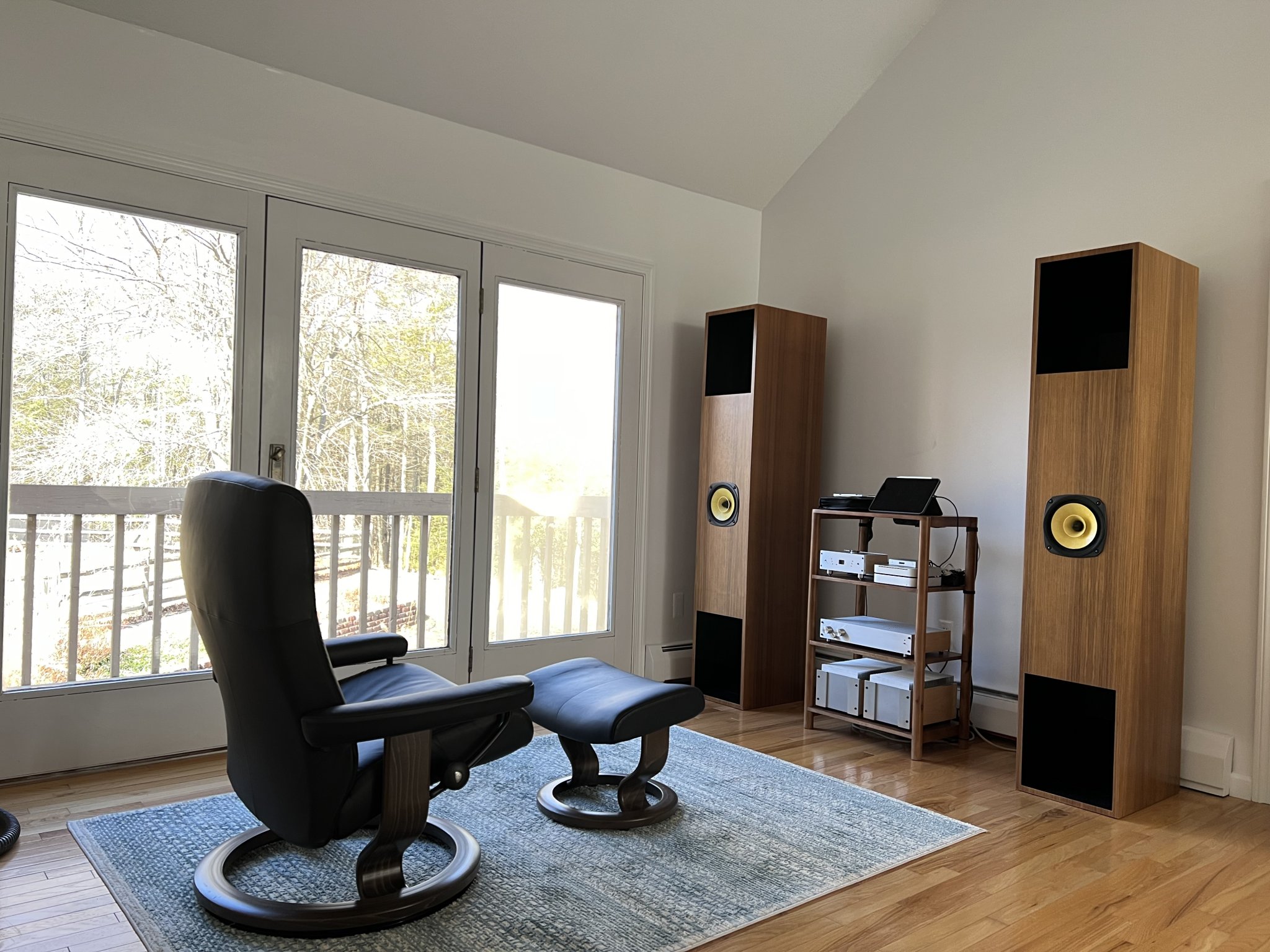

Joined 2008

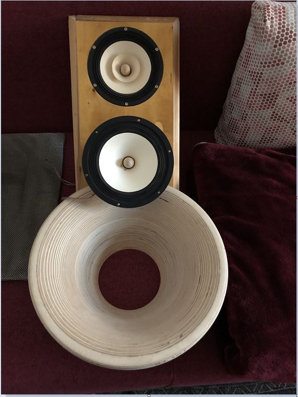

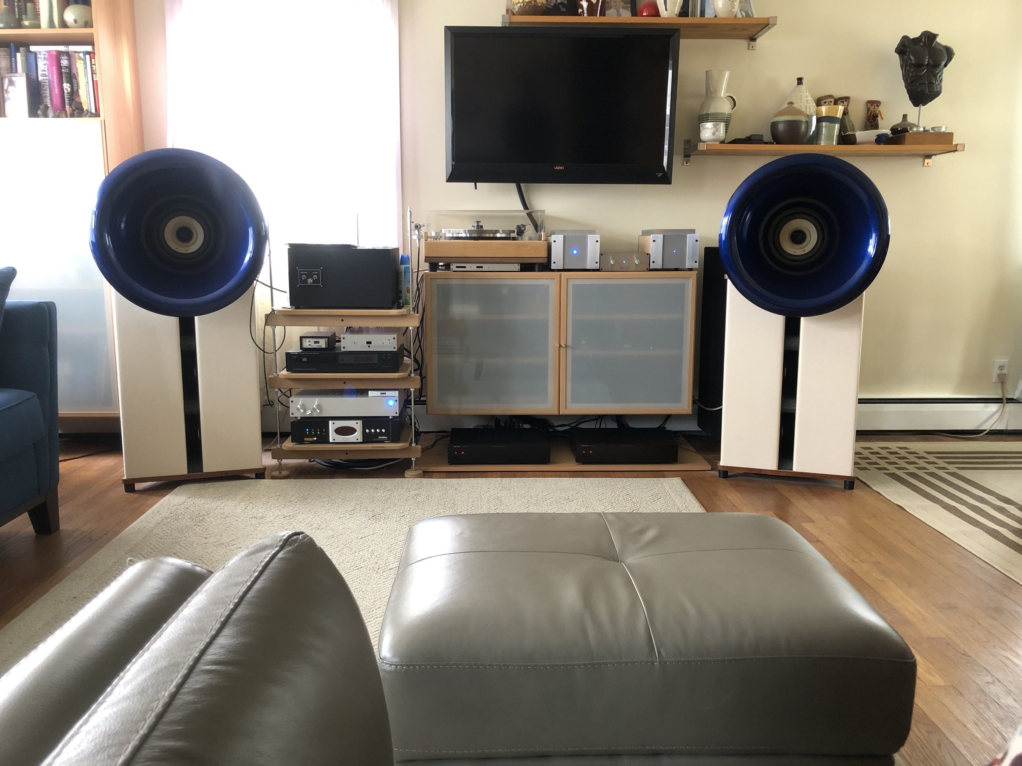

I have both front and back horns…and have used them with a variety of 8” drivers.
I can attest to the beaming and “head in a vice” sound stage with the Oris front horns in a modest sized room (15x20).
When you’re in the right spot the sound can be remarkable…shift a few inches and it all falls apart.
I got tired of it and moved on to try other things. I’m hoping to return to front horns albeit a multi way system with different horns that will hopefully minimize the issue.
I still use and enjoy my back horns on a daily basis.

GM - Interesting - I've never seen a separate horn insert before, neither spoken of or written and I don't see how it would even work with a whizzer because that part of the driver could not be sealed to the throat

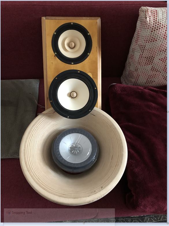

Hi @Bigun,
thank you for this interesting question!

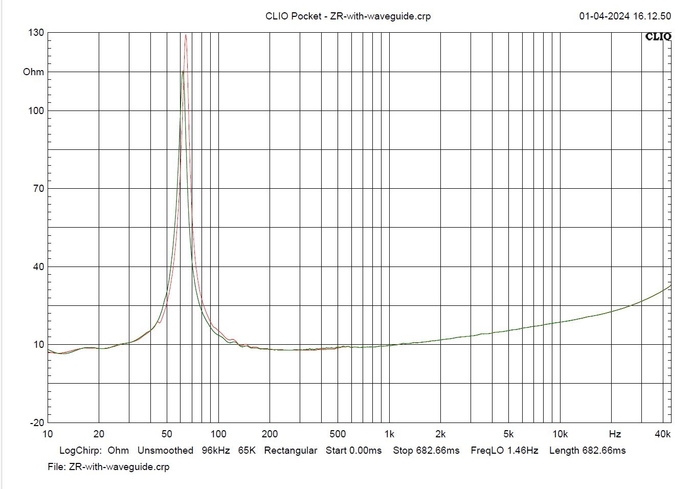

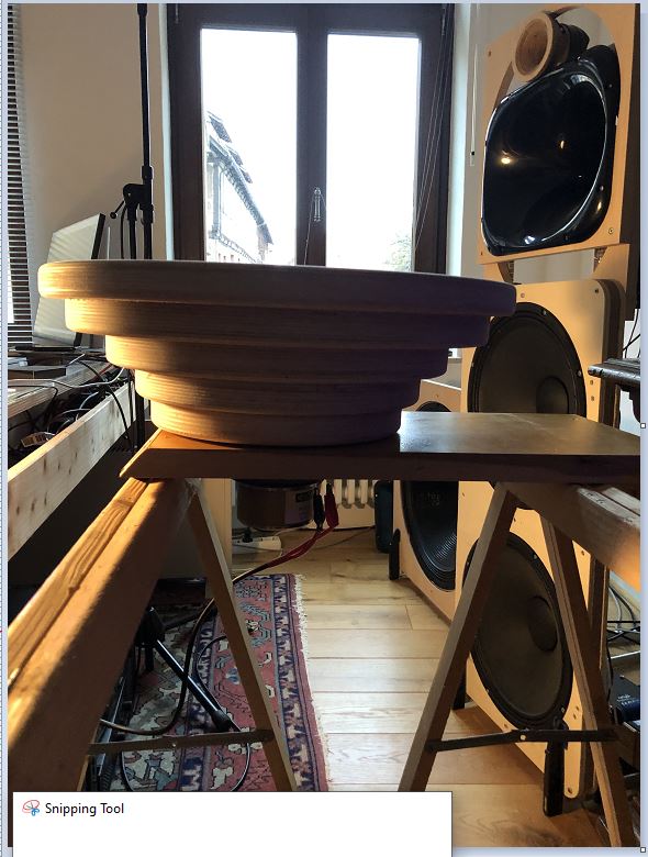

I have a CLIO pocket measurement system and this three items
i will be able to make some measurements of the two Sonido SFR200A items with and without whizzer cone with and without the waveguide
i can plot them together in one graph so that you can see the difference
to be complete i would have to make the measurements at 0, 15 and 30 degrees, twelve measurements all together this will take some time
then you will have an answer that is more than only an educated guess
maybe some of the measurement experts can make some suggestions about the distance of the microphone and the time window in CLIO best suited to make a measurement of the items and not of the room where the item is placed for the measurement
today as of the first of April it is raining cats and dogs here in Germany, i realize that the best is to wait for better weather and go outside in the courtyard for this
So far - so good, Stefano
Reactions: 1 users

Hi there,

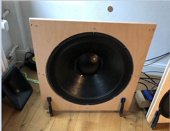

we have a forum here in Germany where i want to participate at the point source contest this year either with the KEF SP1715 coax with a Cobra back loaded horn and the waveguide or with the SFR200A whizzer cone FR with a Jericho horn and the waveguide
but for me as a quite helpless carpenter the much easier thing is to combine the stuff in a FAST project with a 21 inch OB woofer

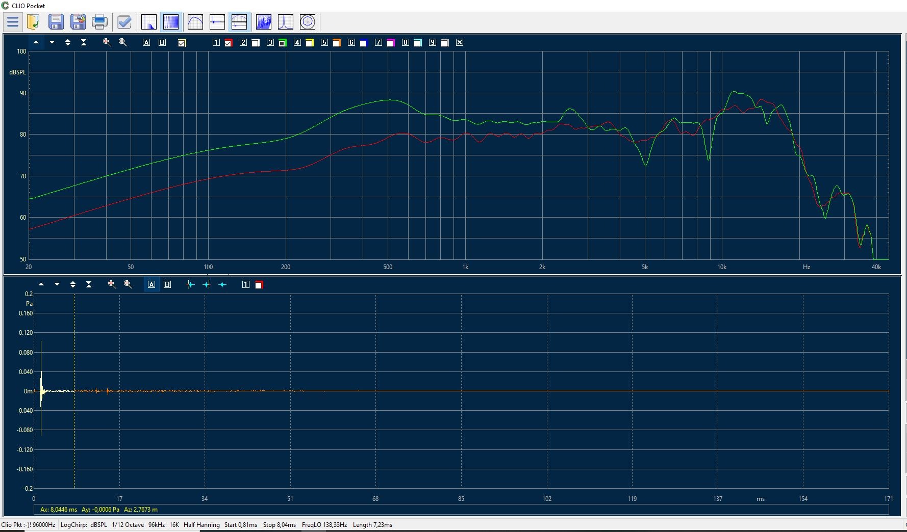

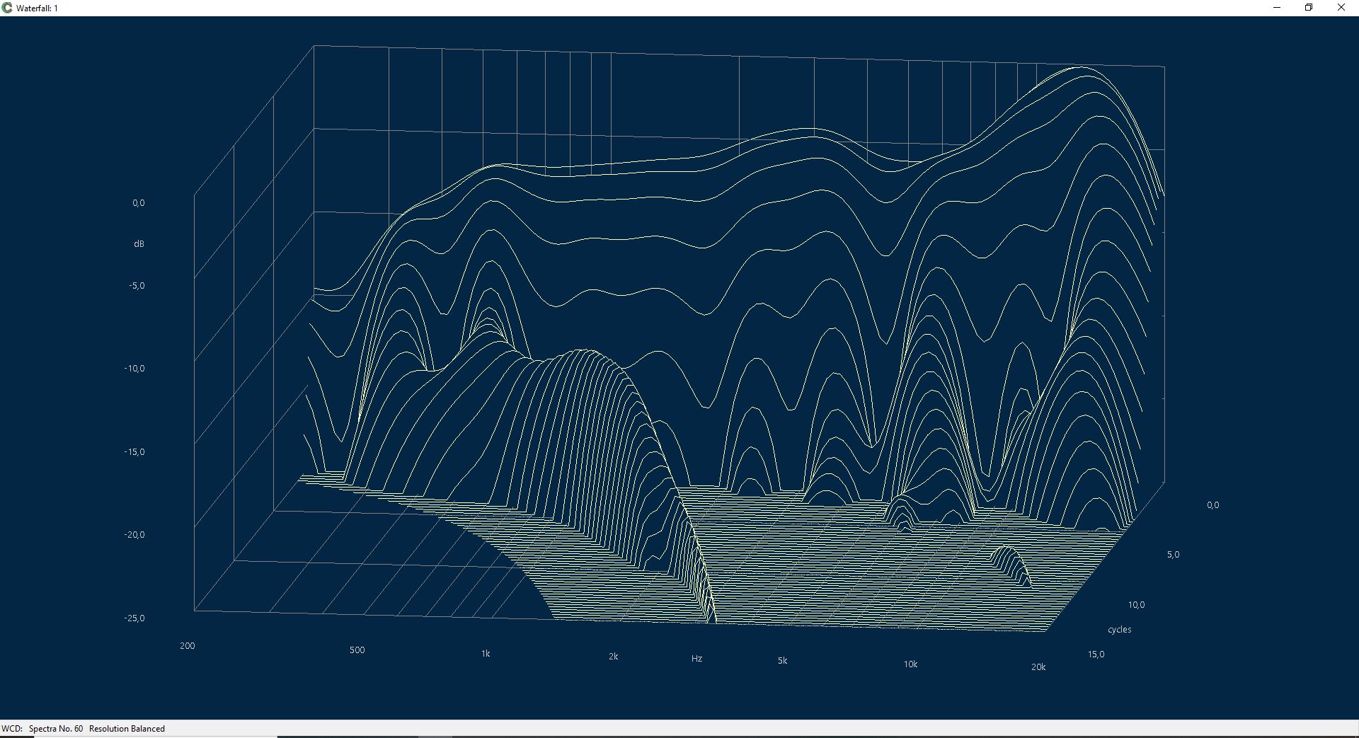

first SPL quick shot windowed measurement in the room with 37 cm microphone distance on axis
first analysis better midrange not so good high range with the waveguide
some kind of resonances with more pronounced breakups at about 5000 Hz and 8800 Hz with the waveguide

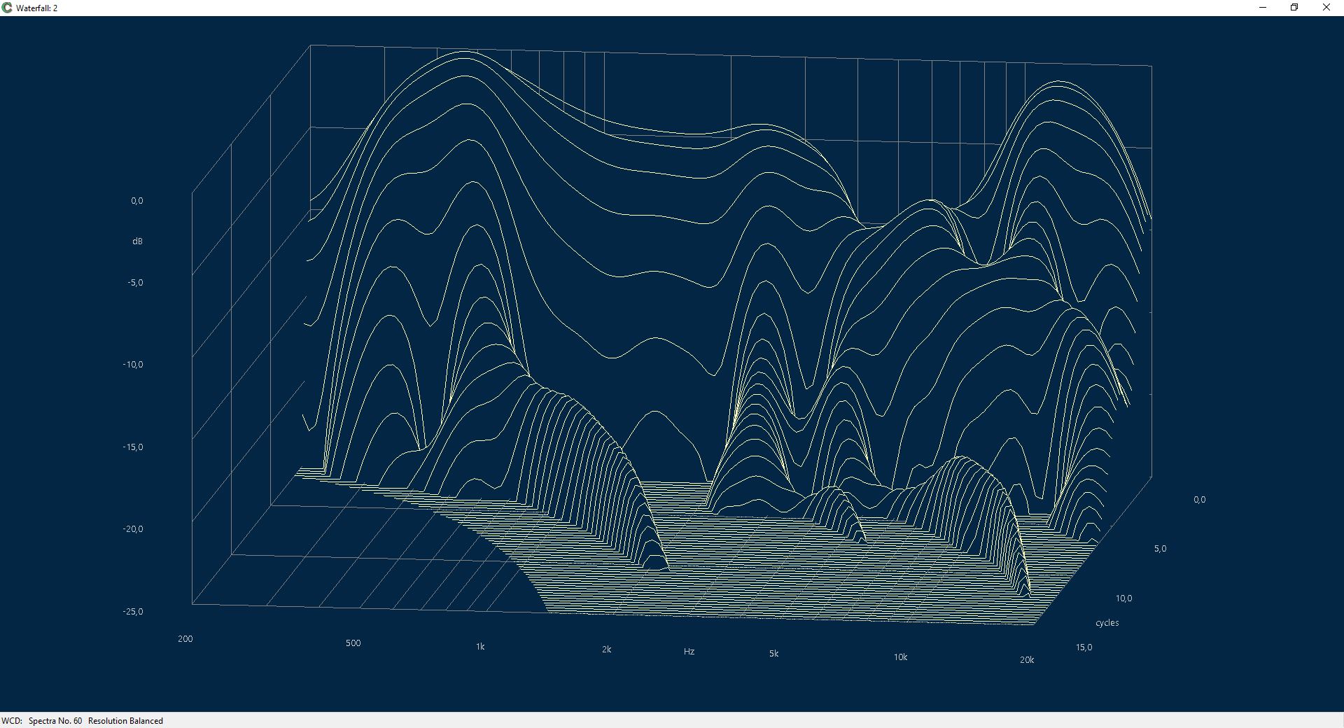

WCD wavelet cycle decay no waveguide / waveguide
