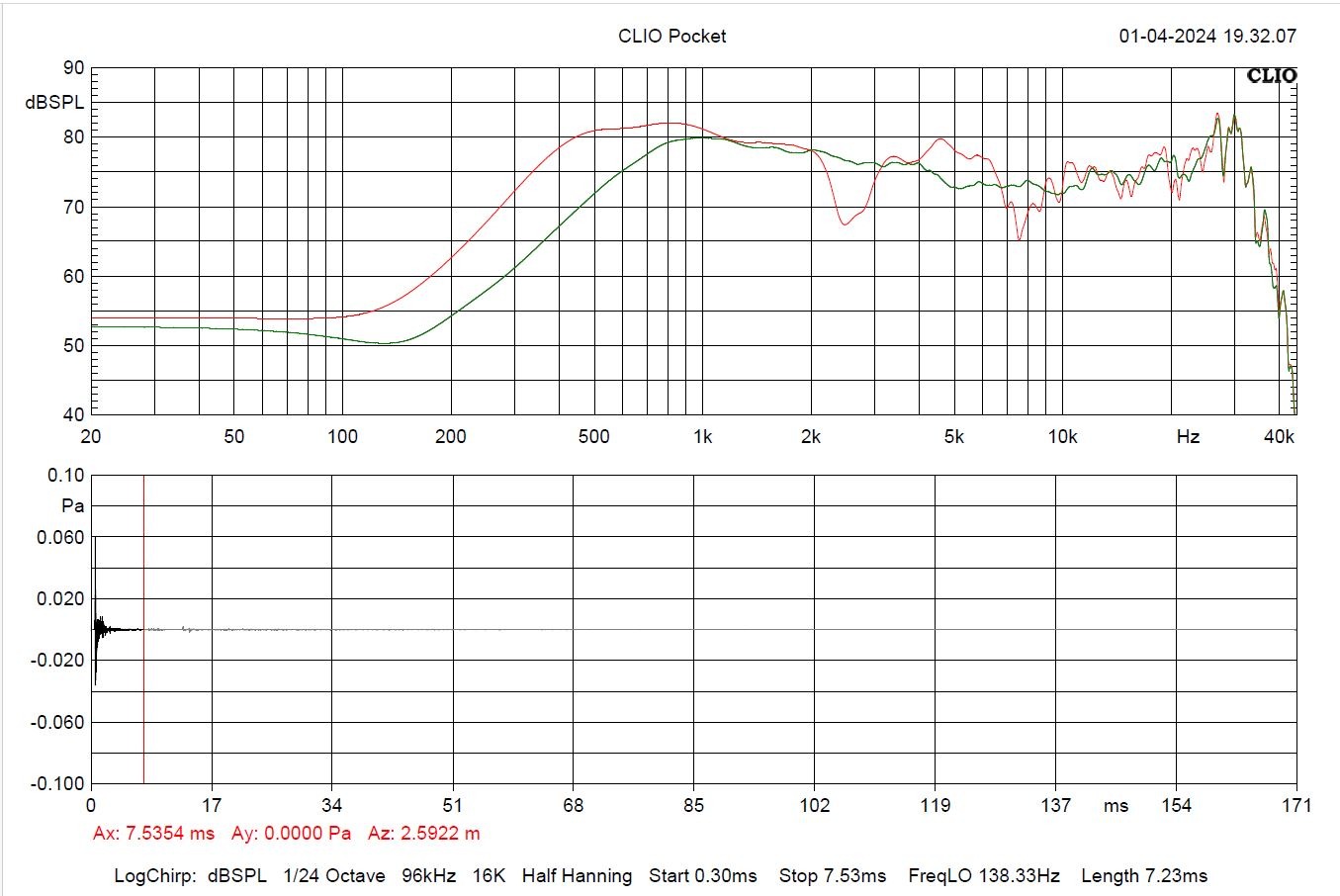

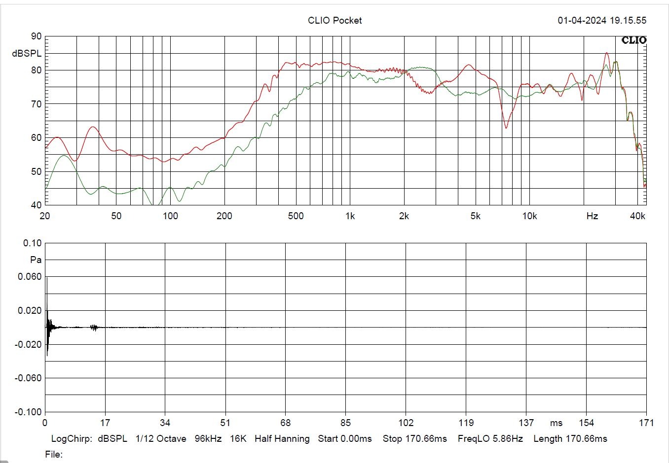

SPL measurement A / B comparison with / without waveguide with the KEF SP1715, here
massive influence of the waveguide for the tweeter of the coax chassis
second plot with better suited test baffle
very smooth response without the waveguide - bad breakups with the waveguide for the coax tweeter

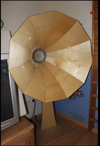

Thx for the link - Those guys sure do make some pretty looking horns but I can't shake the desire to DIY itHi @Bigun,
i am not such a good carpenter
look here for details
https://www.lautsprechermanufaktur-heyder.de/en-us/lmh-horns/strak-horns

I'm not very knowledgeable about interpreting this data, what it seems to suggest is that a waveguide is not helping the situation with the highs, with or without a whizzerfirst SPL quick shot windowed measurement in the room with 37 cm microphone distance on axis

Hi @Bigun,
i was surprised to see what the waveguide is doing with the coax chassis, even worse than with the full range chassis with the whizzer cone
i think a full range chassis with a whizzer cone has breakups in the high range anyway
the Sonido SFR200A may be one of the full range chassis that take more advantage as disadvantage from the front mounted waveguide where the front horn acoustic load is taming quite a bit the 330 Hz - 440 Hz resonance coming from the totally undamped cloth surround
the KEF coax with the right crossover between woofer and coaxial mounted tweeter has a smooth frequency response with no breakups, here the waveguide is more a disadvantage
i think the ultima ratio would be to build the front wave guide and judge with listening tests
if you check the gallery of the Sonido DIY folks, there are a lot using front loaded horns as waveguides with the Sonido full range chassis
https://sonido.hu/galeria.php?lang=en#
hope it helps, Stefano
P.S.: just one example of many taken from the Sonido gallery here

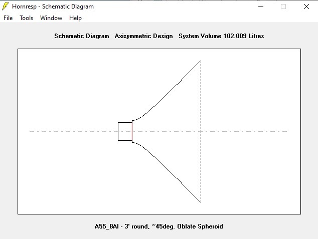

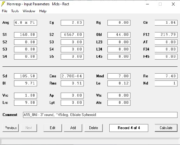

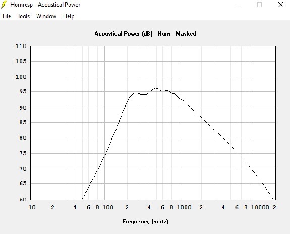

Hi Stefano,
This seems like a sensible conclusion.
For a waveguide, I don't pretend to understand the difference between a waveguide and a horn, but ignoring the problems of names, I also don't know which profile would be most suitable. It does have to be relatively shallow with a quickly expanding profile to leave the whizzer cone unhindered. This seems to rule out the exponential/tractrix profiles. And that leaves mostly conical profiles which as I read about have the disadvantage of poorly loading the main cone at low frequencies.
The solution that is recommended from some authors is the Oblate Spheroid coordinate system based profile. As I understand it, this profile is mostly conical but uses a slower throat expansion for better loading and the mouth is curved for less mouth reflections. Do you think this is the right direction ?
I'll take a look at this with Hornresp.

What I'm thinking of is a waveguide that will load the main cone to help compensate for the rising response of most full range drivers. The cone/whizzer doesn't need loading at higher frequencies but the horn needs to stay out of the way.
I propose that this is best accomplished by aiming for a more or less conical profile with walls at 45 deg. to the normal axis. This profile is quite different from the deeper Oris/Tractrix horn profile for loading down to 200Hz.
