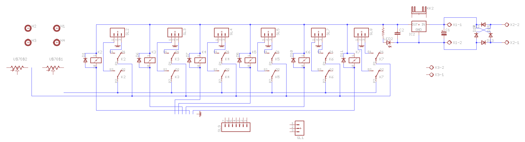

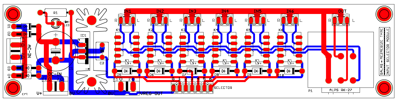

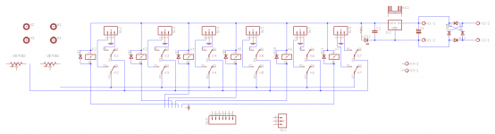

Hi Tea-Bag,
I received the boards some time ago and was checking required parts etc when I noticed the schematic is not included in the pdf file. With the black soldermask it is a bit difficult to follow the traces, so could you please post the schematic?
Thanks,
AlbertNL

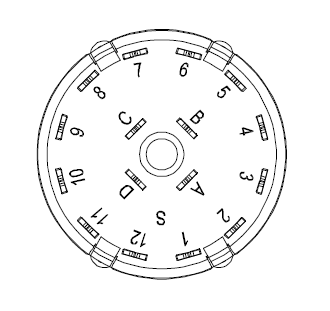

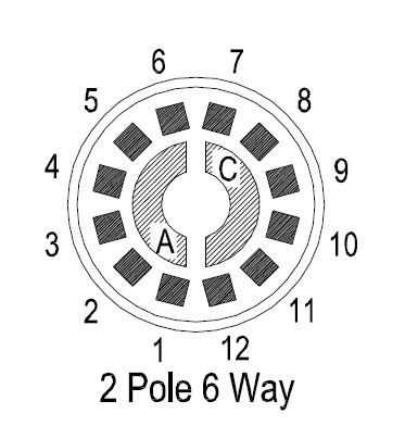

Hi Albert, here is the schematic and the board tracing. Also the positions and poles pins for CK1030/CK1025 Lorlin switch.
1-6 ---> A
7-12 ---> C
The relays PSU ground is not already connected to the signal ground so to allow you open grounding options. Builds are many and different, the general grounding scheme this selector board ends up working with each time is unpredictable.
If you borrow DC from the preamp its ground return may already be showing continuity to the signal ground for instance. If not or you have a dedicated transformer for the selector board you may need to connect its input/output ground line with its 7812 PSU ground line to avoid hum. Or you may opt wiring both of them to chassis if common to system ground along with the metal body part of the pot if its not already having continuity to chassis through an extension rod or by being mounted on the front plate. Anything that works best for no hum.
