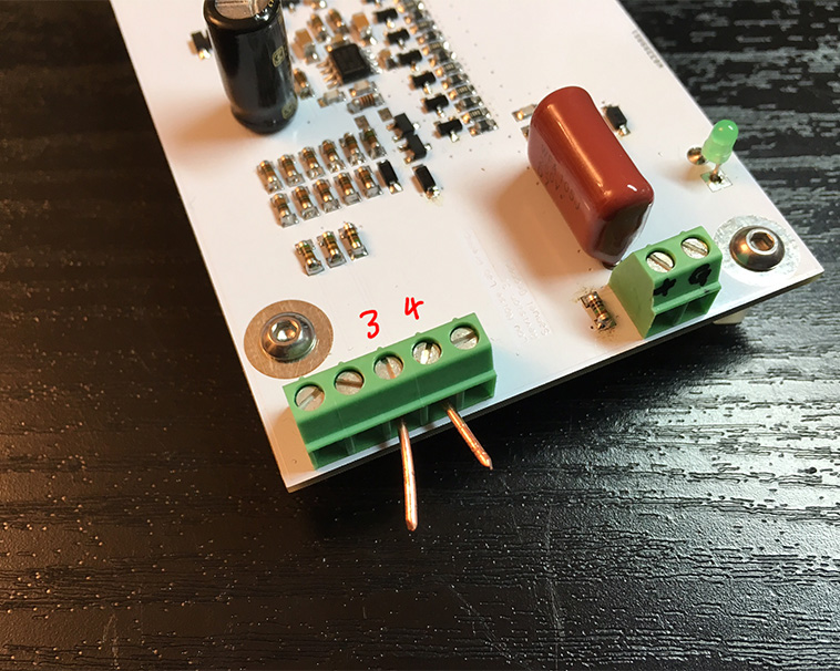

Pin 3/4 of J102 go to pin 2/3 of the output XLR.

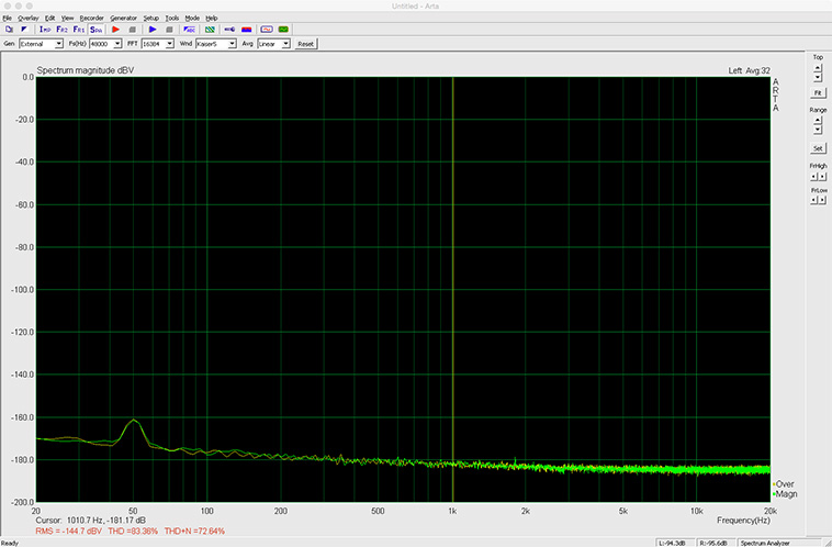

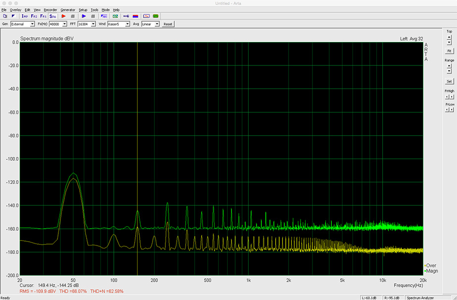

I ran the measurements again. 1k resistor in green. Shorted input brown.

Could you tell me how you managed to measure down to -180dB. Thanks.
Could you tell me how you managed to measure down to -180 dB.
The scaling is (essentially) arbitrary in this plot--the ratio (difference in dB) between the two measurements matters. If the FFT size is made larger, the bins get narrower and the noise drops (less noise energy per bin). Arbitrarily low noise floors are possible that way. If you want to measure noise with an FFT, you need special scaling to compensate for this--unfortunately many software packages don't support this. A commonly misunderstud topic.

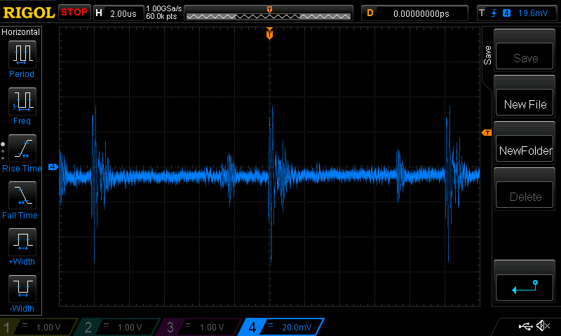

I only now had time to connect my signal generator. I dialled in 10mVpp. I connected my scope to the output of the pre amp and selected it to measure Vpp. Divisions: 2ms and 5V. From 50Hz all the way through to about 130kHz or so it displayed Vpp of 10.6-8V (it flickered between the two). Above about 130kHz occasionally 10.4Vpp would be displayed, more often as I increased frequency. At 10Hz (1s per division) Vpp was a constant 10.6V.

100 kHz at such high output levels will probably drive the amplifier into slew-rate limiting. If the purpose is to measure frequency response, I'd reduce the input level to about 1 mV (peak, peak-peak or RMS).I only now had time to connect my signal generator.
The considerations apply to random signals only. Residual ripple in a voltage regualtor is a steady-state signal, related to the mains frequency; it is measured correctly with standard FFT settings. If unsure what you're looking at, you can double (half) the FFT size. Random noise will drop (rise) by 3 dB. The level of a steady-state signal won't change.Samuel, can you please expand on your last comment? So there's no remotely reliable vertical scale? How would one determine, for example, the line rejection of a measured power supply if there's no reference for noise floor?
Recommended reading: The Fundamentals of FFT-Based Signal Analysis and Measurement in LabVIEW and LabWindows/CVI. The topic of noise scaling is adressed in section 4, but it's probably wise to go through the entire text.

Thanks. Yes, the intention was to just do a quick check of the build with respect to gain and frequency response. I just kept dialling higher frequency until I saw a drop in output. It seems 4mVpp is the lowest my new signal generator will go. (I thought its specs went down to 2mV but it seems not...)
