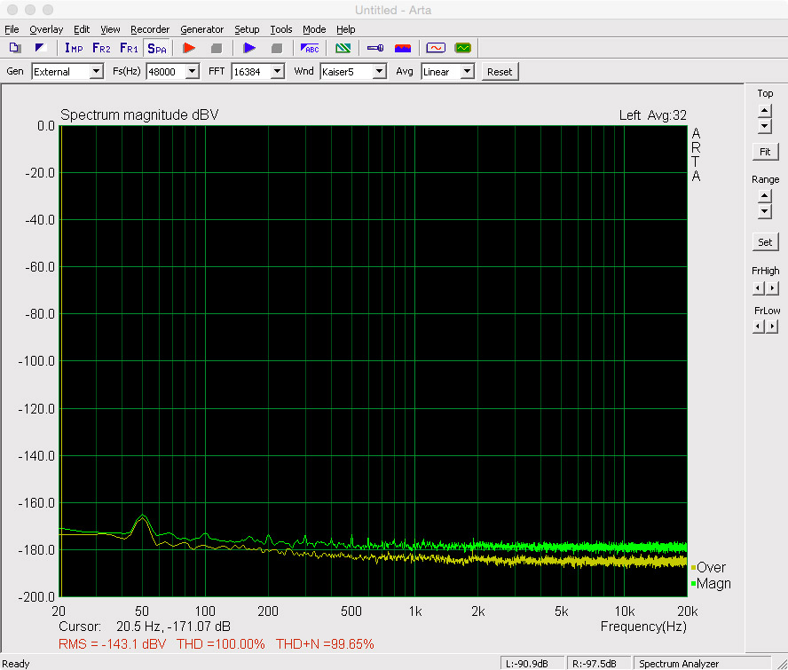

I mean all the peaks in the FFT. Below is the image from the previous post (preamp shorted versus 1k resistor). The newer thumbnail image shows the preamp shorted (yellow) versus the sound card looped back (green). I left the preamp gain setting in ARTA unchanged for the latter so the two align better. (All 32 linear averages.)
I presume the peaks in the yellow ft result from preamp noise or something else in my cabling to the sound card. I'm just wondering if this sort of noise floor is to be expected for this preamp or whether it is an indication that I have done something wrong.

What you see is hum (mains power interference). Can you run a measurement set with the input of the sound card shorted (not a loop back!), and then with the preamp connected and its input shorted? This will indicate if the hum is picked up by the preamp, or a "feature" of the sound card.

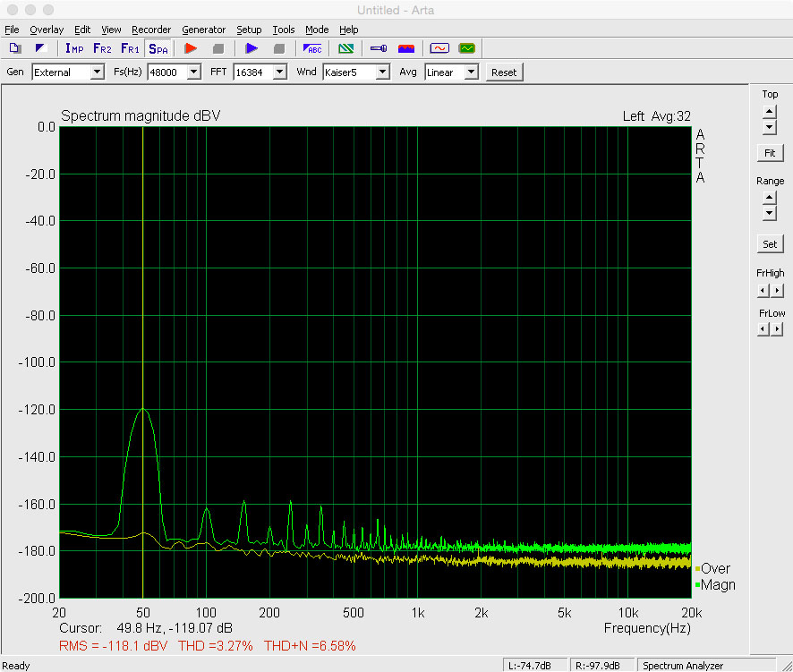

The embedded pic above (not the thumbnail) had, as its yellow trace, the preamp input shorted (connected to sound card) but I did all the measurements again for a better side-by-side comparison.

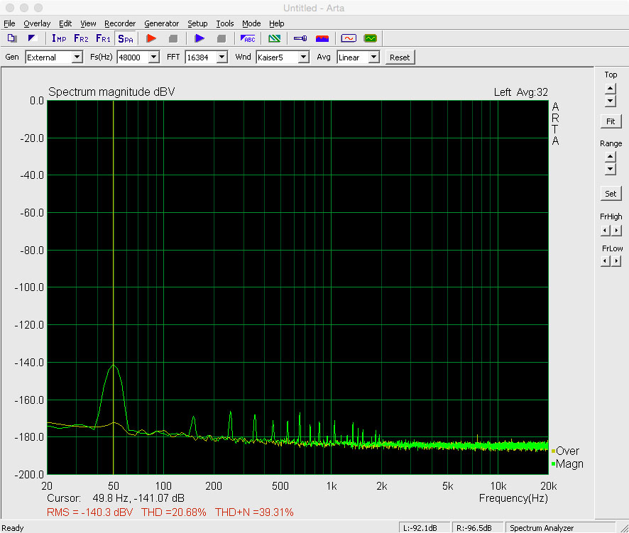

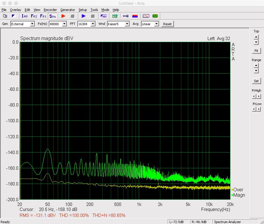

The first pic below shows - yellow trace - the cable to the balanced input of the sound card shorted (i.e. the clips at the preamp end simply connected together). The green trace is with the unpowered preamp connected to the cable with its input shorted. The second pic is the same but with the preamp powered. It suggests to me that neither the sound card or the cable is the source of the noise.
These images show a better noise floor than the previous images, but still a lot of interference/noise. I guess the next step is to put the preamp in a metal box, but I'm surprised it acts as such a good antenna.

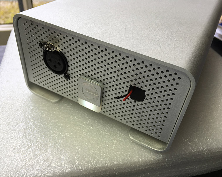

Aluminium conductive enough?
Yes, although pure silver would be better.

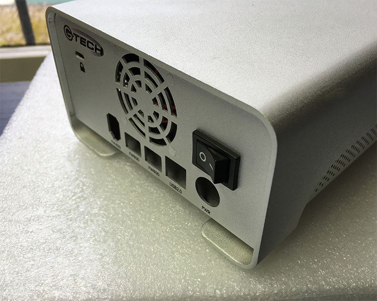

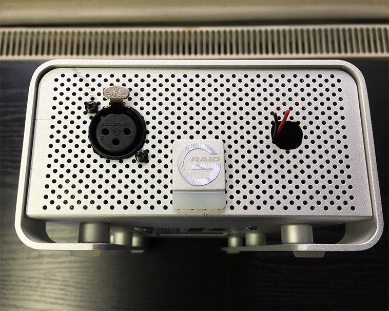

Hopefully this will be better. I found an old Firewire drive. I thought the G was poetic (and it had a built in LED and switch). Need to purchase a BNC jack for the input.

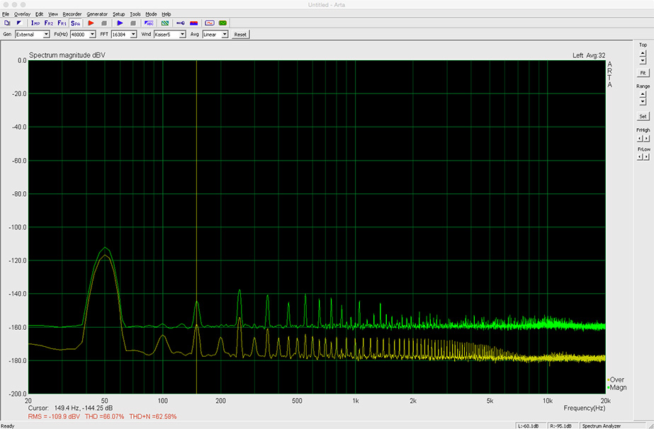

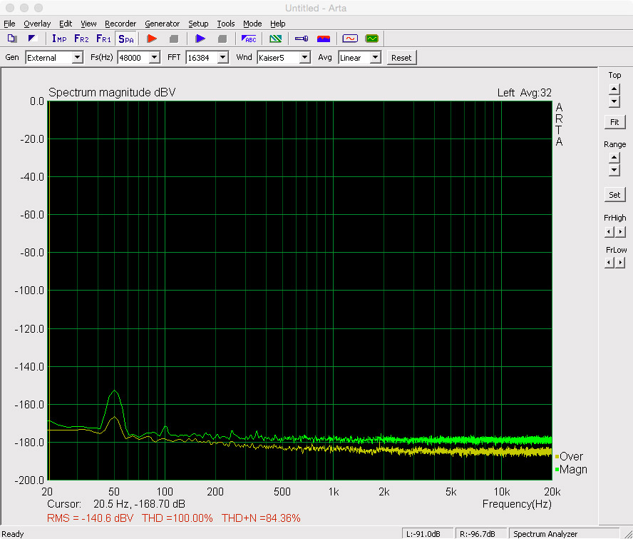

Ok some progress. My BNC connector arrived. Pic 1 shows the result when I short the input connector on the board itself (and then assemble the enclosure). The second pic is when I short the BNC chassis connector. (The yellow trace is the sound card shorted at the XLR/amp end of the balanced cable.) Initially I had problems because the board mounting holes aren't isolated from the circuit and I had used metal standoffs - cold/GND of the input BNC was therefore connected to the chassis.

to connect to a DUT. However, if I short this lead and look at the results in ARTA they're not pretty. Clearly I need a shorter lead and likely some means of shielding the DUT as well.

It looks like you got 3nV/rtHz @20Hz (assuming 10dB/decade, this maps to about 4.2nV/rtHz @ 10Hz) which is pretty good for a Jfet low noise stage.
I was always wondering how Mr. Groner got 1nV/rtHz @10Hz. This, and the incredible low noise corner frequency he got look to me like out of the reality realm for Jfets (and not only the 8xBF862). Perhaps he would care to jump in and explain?
I'm thinking it may be better to use another XLR connector rather than the BNC. At least then the input cable shielding will connect to the enclosure. It won't be connected at the other end but perhaps the Faraday cage helps. Do people think crocodile clips are still the most practical termination for the other end?

It looks like you got 3 nV/rtHz @20 Hz (assuming 10 dB/decade, this maps to about 4.2 nV/rtHz @ 10 Hz) which is pretty good for a Jfet low noise stage.

I was always wondering how Mr. Groner got 1 nV/rtHz @10 Hz. This, and the incredible low noise corner frequency he got look to me like out of the reality realm for Jfets (and not only the 8x BF862). Perhaps he would care to jump in and explain?
