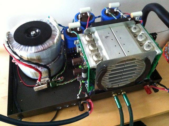

Attached image, is an older build, of my first modified DH500,
for perspective...
~ BIG BLOCKS FOR SURE ~

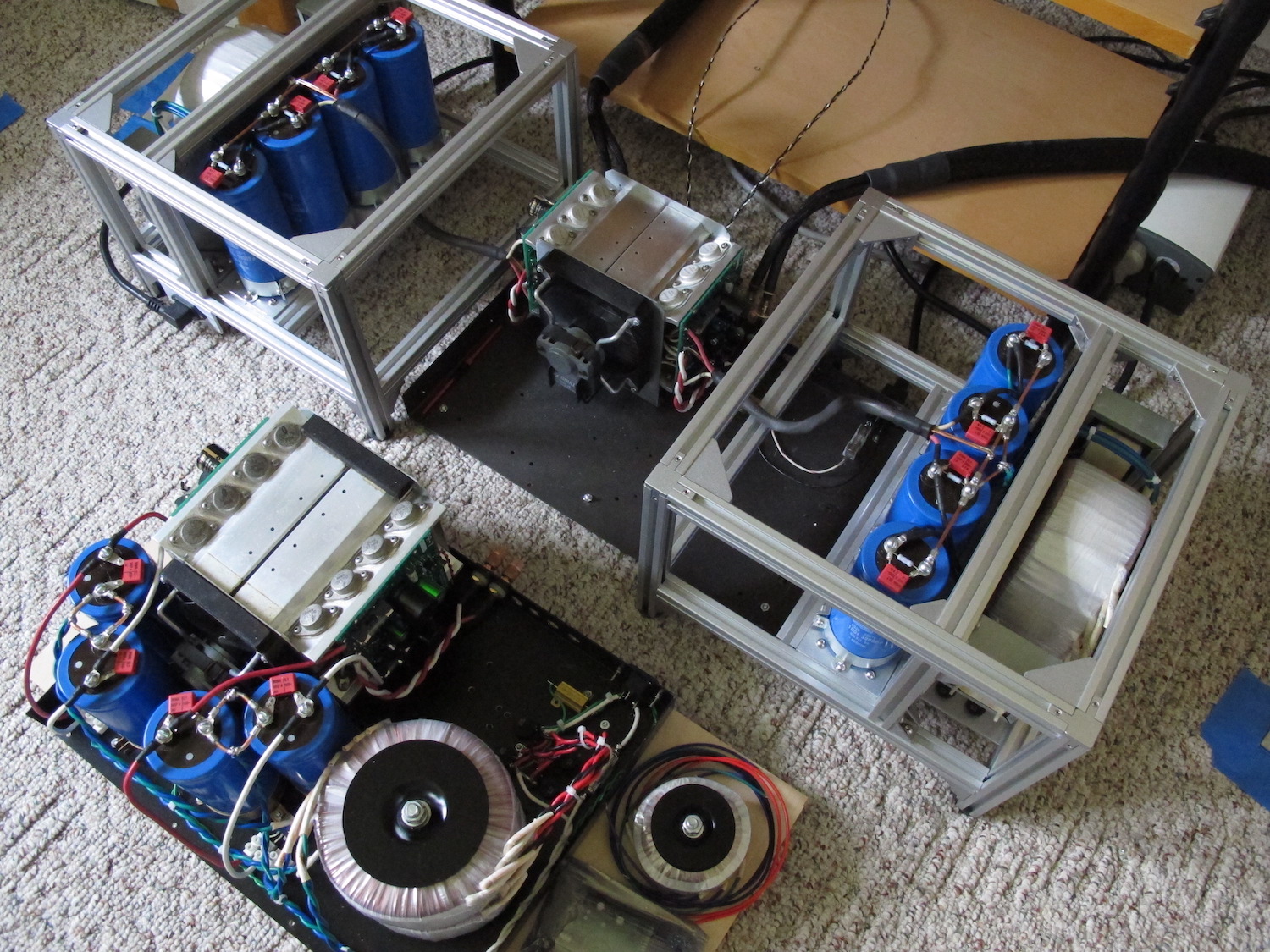

How I spend my time in retirement...
That is for sure. I struggle saying, I enjoy building as much or maybe even more than simply listening.
Those are 1000va toroids. The "conventional" reworked Hafler 500 / 600 are dual stacked 625va., (same value as single stock iron core transformer) are the largest which will fit inside the chassis. I wanted to 'double' that size.
A couple of amp builds down the road, I will try / build with 2 of the "smaller" 625va toroids, but wanted to try the Mundorf MLytic HC first.
Looks like you are having some fun with your test setup there.
What sort of kVA rating are the toroids?

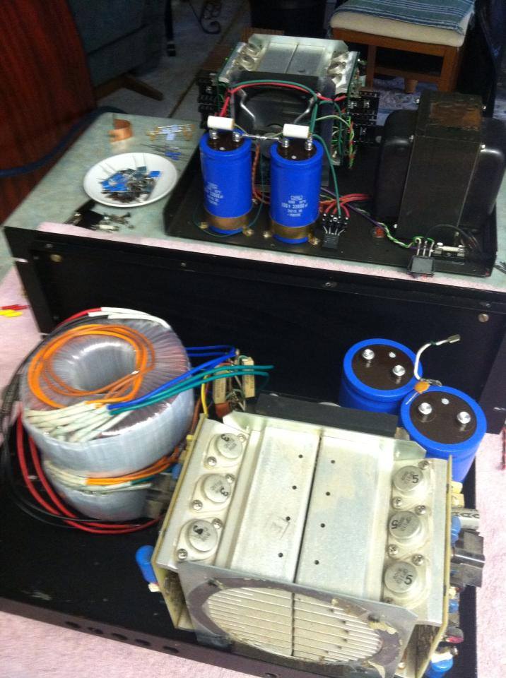

Proof of concept / test chassis(s)
At this point these are more concept amp / power supplies, overbuilt beyond "conventional" modifications... to see if the bigger supplies were even warranted [it is] I essentially wanted to 'use all of the same parts' to keep consistent in my escalating comparisons. I have had considerable conversations in P/S development with John Hillig, he is aware of and honestly influencing ...contributing greatly... related to my builds. Fankly, I am working (sharing with him) aspects of things outside of his direct product offerings, which [understandably] must all reside inside the chassis.

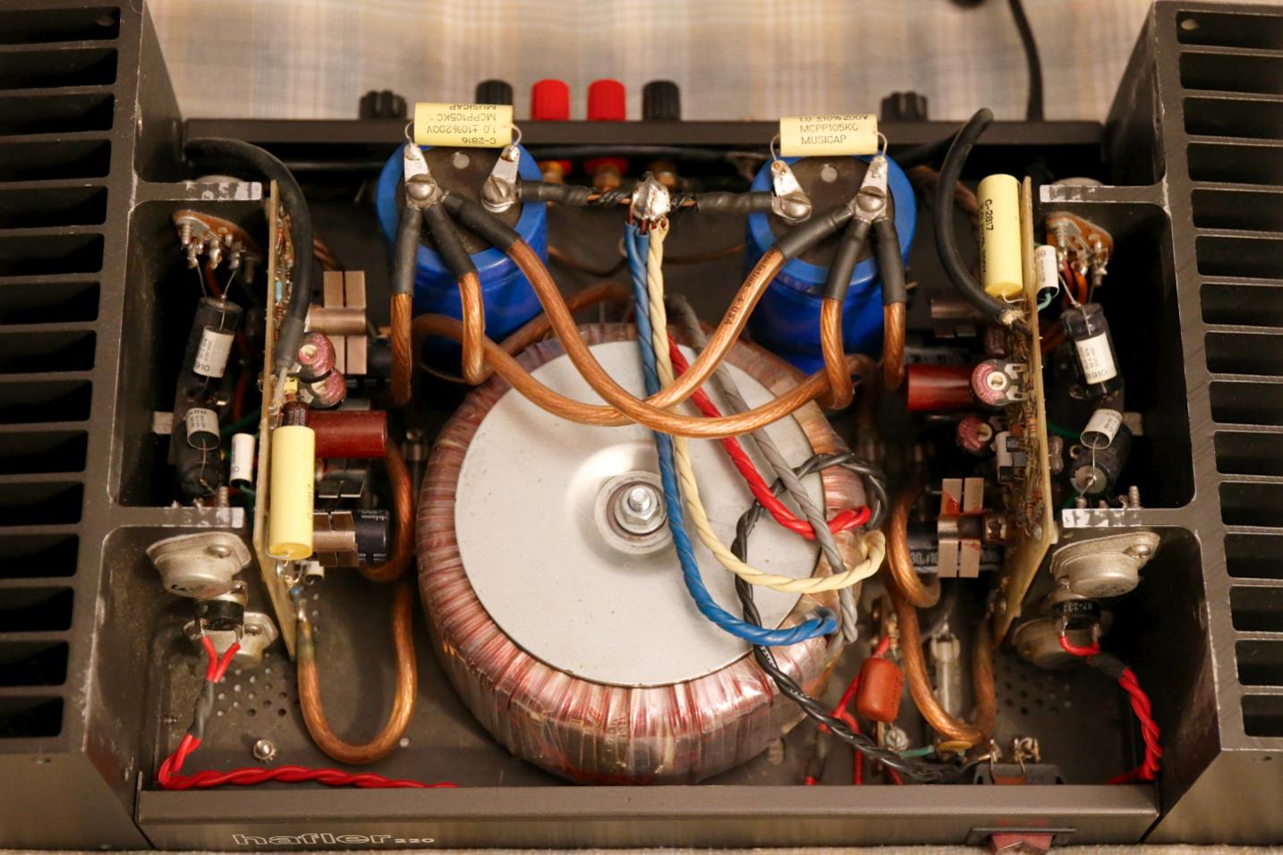

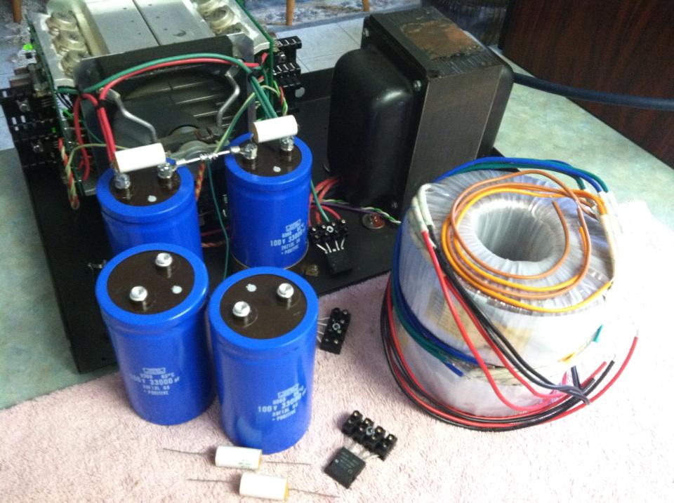

YOU ARE IN FOR A HUGE SURPRISE GOING DUAL MONO!!! (image 2) is the first DH 500, I modified in 2012... I only listened to - tested it it for 6 hours before tearing it apart. It was a big disappointment. (Image 3) was the eventual path. (Image 4) like everything, I am building in multiples and doing close comparisons along the way. Stock supply is ~ grossly lacking ~ unable to render the true capabilities of the DH500 power module.

I wanted to try the dual mono with my DH-500 a while back, as I had acquired an extra Hafler transformer for that. Never got to it and wasn’t looking forward to the idea of the packaging required to fit it into the original chassis.
It is surprising how these amps respond to power supply mods.

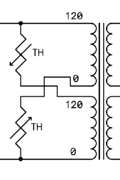

The original transformers make for great line isolation when configured back to back however, if you wind up with an extra pair.
