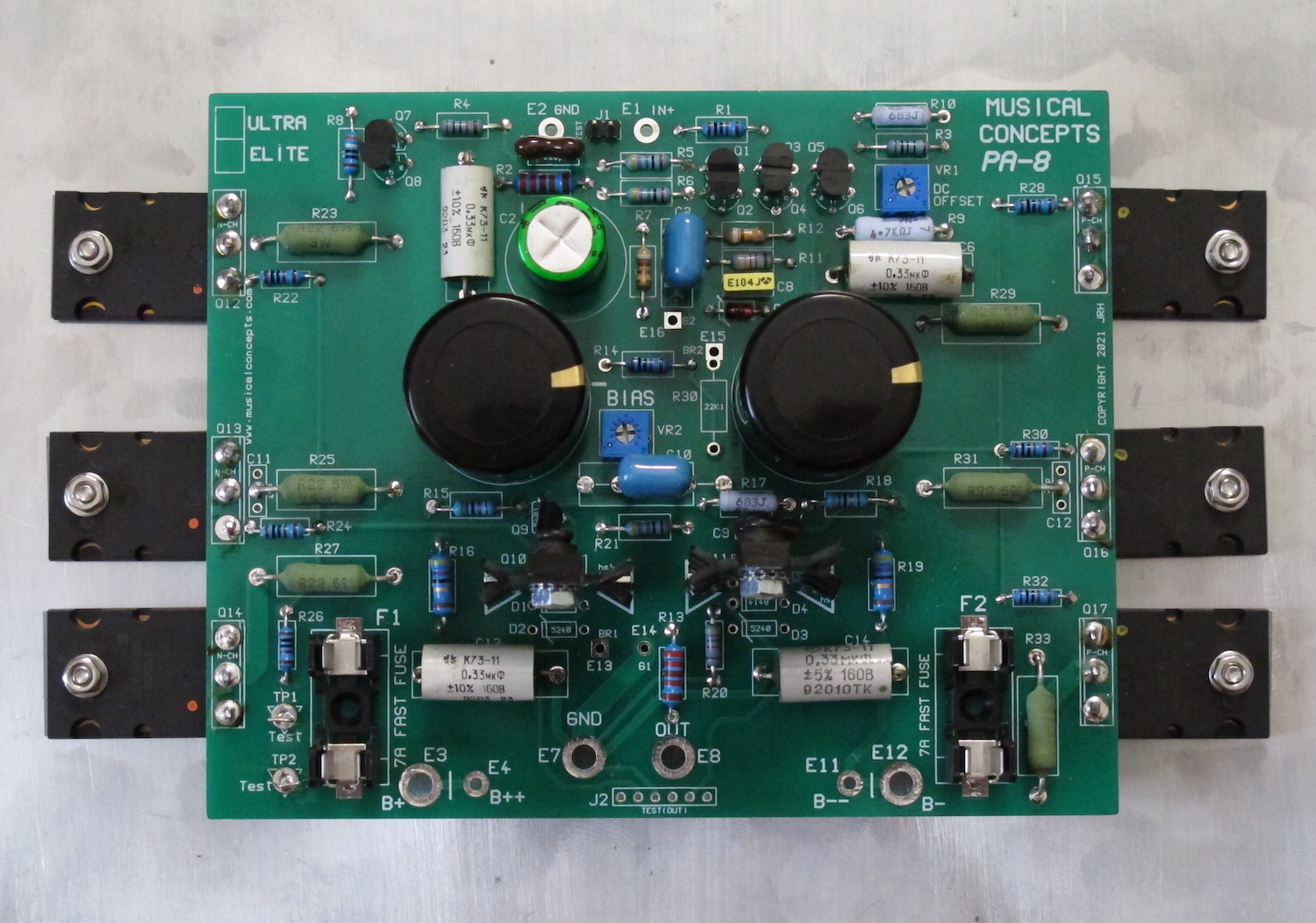

Takman resister loaded boards
Hey Mark, Sorry for the delay in response, I have been building and testing amps... not near my computer.
That is a difficult question to address. A person Nth degree'ing an amp or 2, it is doable, more reasonable. Me? with over a dozen amp builds, modeling various circuit configurations... it becomes somewhat impractical. That said 1/2 of my boards are the Takman Metal Films, with a few Takman Carbon... each have virtues... Stock built/loaded MC boards sound very good.
To me, its like when I bought / owned Levinson system, I bought the *S class* or S badged gear (still own my 360S DAC, love it) In shooting Canon... I shoot mostly L-Series Lenses. If I drove a BMW, it would likely be an M Series. Not being snooty, more to serve as examples of HALO class offerings. Hmmm, to purchase and drink "Reserve"labeled - first growth wines, Cognac, etc. Where do we draw our lines???
It could be said [or argued, by the "all components measure and sound the same" crowd, which may sadly struggle to grasp component voicing / tuning prospects] The Takmans .are. among the best/most neutral resistors, especially relative to cost... I would have to agree, promote that perspective of nearly 10 years using Takmans in my system(s)
Whether a persons budget, system needs and goals (abilities to resolve) may warrant the expenditure... so many people running stock power supplies??? Takmans refinements could be lost in hierarchy of performance needs and relative virtues.
Image : example of Takman loaded PA-8 board, SOUNDS FABULOUS.

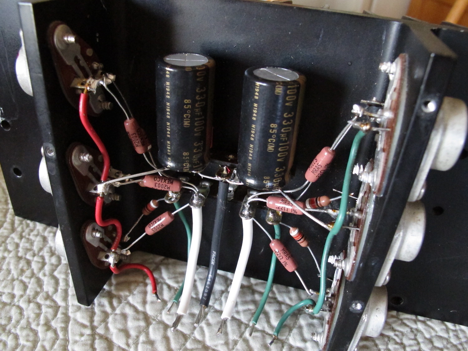

Resitive loading of the output stage
~ I wanted to commit this somewhere ~ 500 thread made the most sense.
*the other* thread has become SO lopsided = should be renamed,
I digress...
The example shown is of my P230 mono, XL280 six output amp.
I think that this applies to any "Hafler" based amp, but is
more critical with the added output devices.
*My unaltered [but completely radically rebuilt] XL600 sounds raw
and unrefined by comparison to 5 other builds... *It may just get
Exicons and the O/S loading...
I have tried the SOURCE RESISTOR loading resistors along
with corresponding changes in the gate resistor, there are no Micas
used for compensation as part of the PA-7MKII/PA-8 equation.
PA-7 (hardwired p to p) behind heatsink, on board with PA-8.
I have used 4 different values (not so much my intent or desire)
but the 1% N. I. wirewounds are too expensive = price gouging.
I think (suspect) older vintage FETs would benefit from
higher values like .47 used in one amp.
I cannot hear meaningful differences in the values used, I like the
refinement so much, I want to do this to every amp I own.
The refinement(s) to my ear and in my system(s) brings the
vintage Hitachi MOSFETS, much closer to the refinement and
beauty of the Exicons, even matching their imaging holography.
I had planned to put DD Exicons in most of my gear ~ but ~
if we can get this close to a sound, "bringing the MOSFETS
closer together" I have to rethink my planning.
I am in a holding pattern... The Kitty Roe Roe likes
the Exicons, sound great and make me happy!
She plopped herself down in the midst...

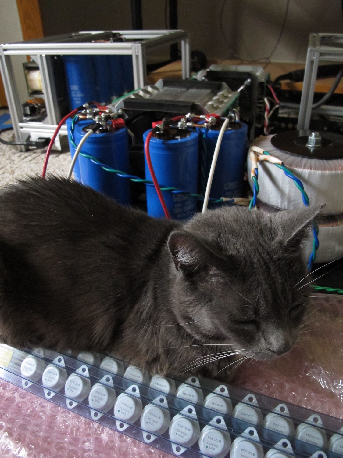

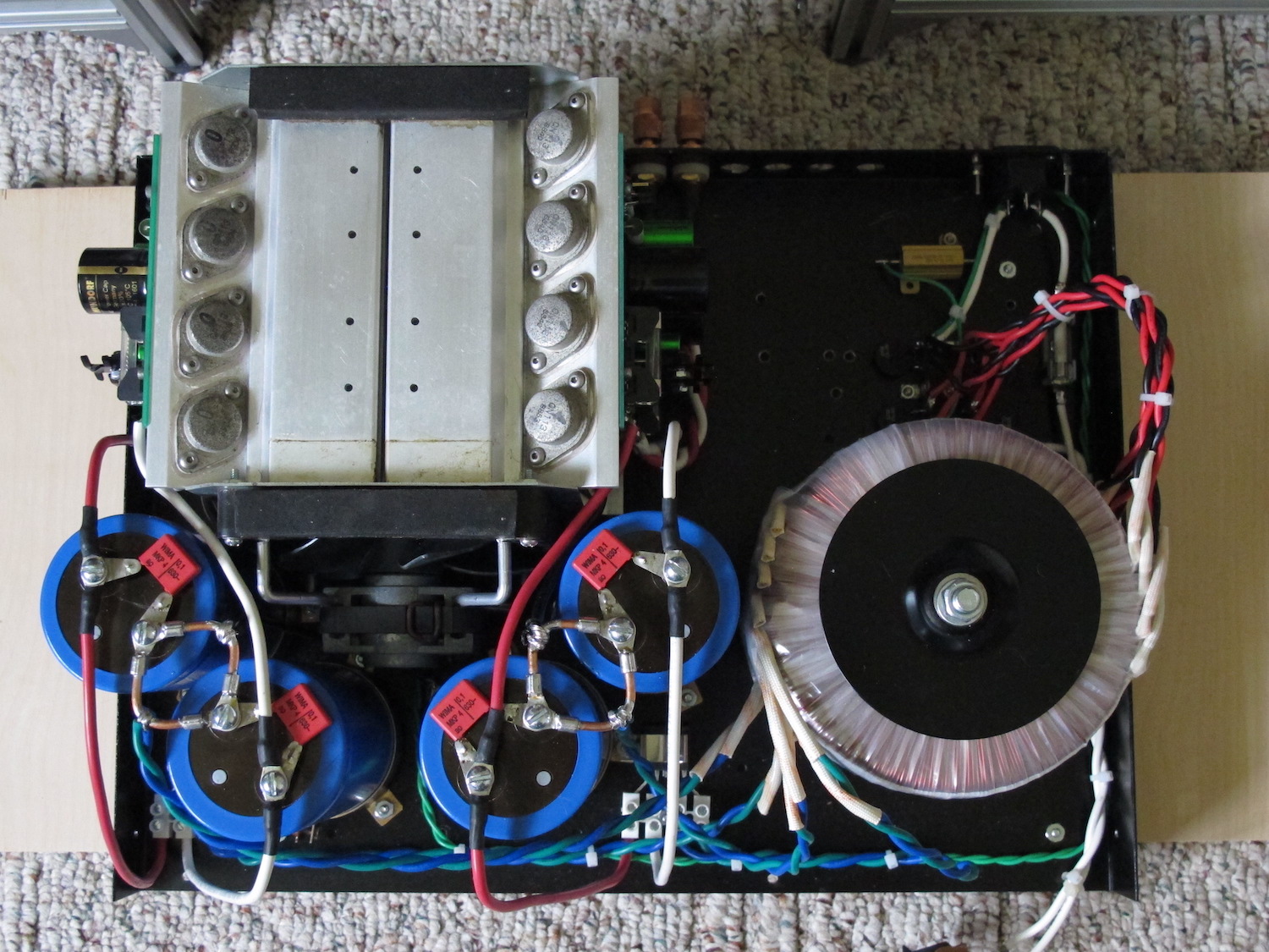

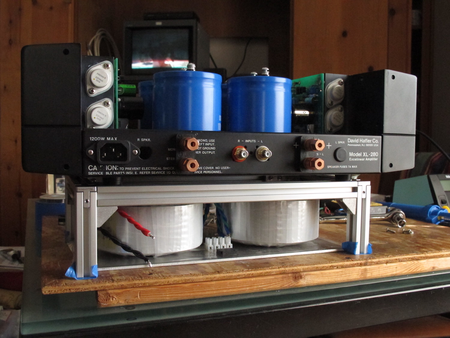

Hello all and first I must express gratitude to all the contributors to this subject! One of the best sounding amps from my past (1980's) was a DH-220 modified by a sound lab engineer (Groton Ct) that had a two level chassis with the lower being occupied by the power supply. I myself have more recently been having good success modifying adcom amps, but looking forward to hafler again! I have slowly been acquiring some of the key components to build a pair of P-230 true mono blocks. So far I have the Cordell/Savas 220C-A1 boards and P-230 OPS boards along with all the components to stuff as well as 6 matched pairs of exicons (12 total). I also have some massive heatsinks salvaged from a yamaha P-2200. My concept is to run the boards at DH-500 rail voltage and amperage. I have included the part substitutions from earlier in this thread for the higher voltage. I am now planning power supplies and want to ask if anyone has a sorted linear design (including part numbers) they would be willing to share using some of the latest ultra fast soft recovery rectifiers and a 500-600VA transformer. I was going to build Mark Johnson's quasimoto and sort it myself, but thought I would see what others have done first. Thanks
Franken' DH/MM500 modeling
Not really sure what to call this... result of brainstorming over the weekend.
I have quite a few parts [in 'anticipation' of supply chain issues] and from
"cannibalizing" a number of amps over the years to build with.
~ when building amps = I ALWAYS start with the power supply ~
with the intended [specific circuit] chosen parts and models of use.
I don't abuse my audio gear (or cars) though I do ..enjoy.. them,
drive them, never really holding back... Can never have "enough"
horsepower, current capability (torque) or dynamic headroom.
I want to push the performance properties of the 500 series closer
to that of my scratch built CLC amps, proper ~ power supplies ~
and as per, parts simply will no longer fit (completely) in box.
My goal is to build amps that are really difficult to clip (reserves)
more than "play really loud"... build the device for unfailing
demand, abilities to .really handle. the peaks...
The 500 will have a small frame below holding / enclosing
a larger portion of the P/S section + I can then squeeze (2)
1KV transformer(s) into the build. A shown on the right.
