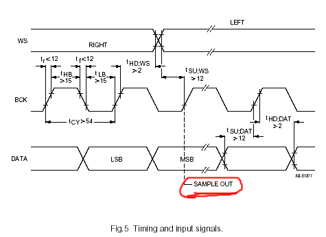

Reclocking

I am a bit puzzled at the reclocking. The xtal is 11 or 16MHz, depending on the cdp master clock. You are reclocking i2s with that clock.
Actually, this CDP (Philips CD723) has a 8.4672MHz clock, so that is the clock frequency that I put in my DAC. Apart from keeping the CDP happy, my DAC poses no condition on clock frequency (read on).
Does the xtal freq actually have a relation to the i2s clock freq coming in at IC2, or are you just 'reclocking' like the async reclocking designs on the net?? If so, the clock is considered too low speed, think they are using >25MHz.

I dont know the tda1545, but normally data and ws are clocked in when they are stable. Data and ws change at bck going low, so the dac clocks in at bck going high. I did not make timingdiagrams to understand the reclocking circuit, but i hope you did..! Would be nice to see them.
I attached the timing info from the datasheet. Analog sample out and input data acquisition all happen on the BCK rising edge.

What is wrong in the design in IMHO is that you cannot guarantee that the signals on D4-D6 of IC2 are not changing at the same time as clock on pen 9. This depends on the delay in the loop 'clock to cdp' - cdp decoder/filter - spdif - crystal input chip. There is a small chance this happens, but i guess we both know murphy.. Change the cdp or cable(s) and it might not work anymore..
You are absolutely right, I was absolutely not sure that it would work when I plugged it in. I had other plans it case it didn't, including FIFOs. That's why I put the SPDIF receiver on a separate board : to be able to change plans if need be.
My design would be quite picky on cables I guess : if the edges fall on the wrong time, boom. But the nice thing is that if it works in a configuration, you can be pretty sure it'll always work. But, remember a half clock cycle at 8.4 MHz makes about 15 meters of propagation distance... This leaves a bit of tolerance.
Anyway, it got me worried, but when I plugged it, it worked, and the waveforms were just like they should be (ie. clock edge right on a stable area of BCK). So I have no more worries now. Seems like Murphy was on vacation.

Problem is : my system fails if clock and BCK have a relative delay which makes the edges mess with each other. I don't know which delay I will have, but I know it is constant. Therefore if my system works once, it will always work.
Anyway, it worked when I plugged it in, and has kept working ever since, for about 1 month of continuous use now.
