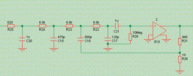

You may want to look into filters like
this.
If you're simulating have a look at group delay in the upper octaves.
Note that R25/C20 are part of the passive IV of this particular DAC, and that
C21/R28 are arbitrary and not meant to be realistic values.
Overall gain is 6dB, implemented by the ideal voltage-controlled voltage source E10.

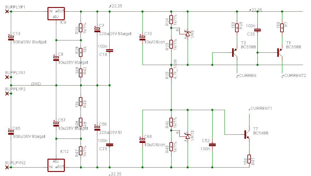

Power supply details
Very impressed with the whole dac, I'm also in the (early) stages of building mine and had a question about ur power supply arrangement.
It is obvious that the final TL431 regulators are being fed by current sources. It is the current sources, however, that make me itch my head.
Could you run me through the calculations you used. And also what purpose is the 150r resistor after the emitter follower but before the final TL431?
Sorry if these are stupid questions, but I'm still trying to learn basic electronic theory...
Some calculations on the current source (correct me if I'm wrong):
Vb = 15.6V (formed by voltage divider of 4.6K and 2K)
Ve = 15.6V - 0.6V (diode drop) = 15V
Therefore current sourced from this setup is found from voltage across 150r resistor divided by Ve. i.e. (22.25V-15V)/150=0.048A or 48mA.
Are these calculations correct? Also what role does the shunt regulator play here? What is the advantage of using the shunt regulator over a LED for example?
From this logic, the 150r resistor between the current source and the final TL431 regulator (next to the ICs) should be a power resistor, as the power dispersed will be Vdrop = 15V-5V=10V squared / 150r = 0.7W
I guess that that resistor is there to isolate two feedback systems from each other: the current source and the shunt reg.
BTW, adding one R and one transistor to the shunt regs lowers their output impedance considerably, see TL431 datasheets.
I'll use component references from this schematic :
Ok, so the upper rail voltage for the current sources supply is 22.25 V from a LM317. From this we derive an emitter voltage for the current sources, using a shuntreg (VR5) set to 5V. Thus the current sources see 22.25-5 = 17.25 V on their bases.
R25, 4.7k, is only here to give bias current to the shuntreg.
This is so I can get +15V for my opamps and +5V for my digital with only one supply rail. But this raises a problem : the current sources feeding +5V circuits will dissipate a lot, hence the power resistor in the collector. It takes dissipation away from the transistors.
In my next DAC I will probably split 5V and 15V supplies in order to keep it cleaner and not make small signal transistors heat too much.
By the way, the two systems (CCS and ShuntReg) are already insulated at HF by the ferrite Choke.
And for putting a transistor on TL431 to lower impedance, why not ? I'm curious about it, have you tried, does it sound better etc ? I did not try because I had too many components already...
Pierre
Shouldn't two stages should be well isolated anyway given the low output impedance of the transistor used in the current source? I have seen an Elso Kwak circuit without this resistor in place.
Regarding the lowering of TL431 output impedance. Do you mean using a simple emitter follower circuit?
Cheers
Thanks for your help! 🙂 What differences would you expect if you implemented the current source with:
a) diode?
b) led?
rather than the shunt regulator...
I've already built a power supply for my tda1541 dac using a three pin regulator and shunt regs next to the supply pins on each ic, but this could be good tweaking ground!
I've also read that separating analog and digital power supplies can have a beneficial effect. i.e. running the output stage off a completely separate supply. Also some people have suggested running the Va supply for the receiver PLL off the analog supply.
a) diode?
b) led?
These are a bit more noisy and you don't choose the voltage. I don't know if the noise here is important though, because it is quite well rejected by the TL431 doing voltage regulation. I chose to be save and use the lowest noise option anyway.
You mean you feed your shunt regs with resistors ? In this case, yes, using current sources is easy... what about trying it and reporting here abuot what you find ?
Did you put ferrite beads on your supply lines ?
For the receiver PLL, I see no interest, as I reclock my signal afterwards. If you use the CS8412 PLL to extract the real clock, however...
For analog/digital supplies : with the current sources, I think they are well separated already...
Regards
Pierre

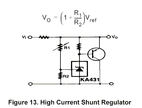

Werner said:
This what I meant ...
Output-Z will be around 100mOhms
up to 10kHz or so. Cross over to an elcap with similar ESR at 5-10k, to avoid resonances.
I saw it in the datasheet... Did you try it ? It should have a lower impedance... where did you get this impedance value ?
But the datasheet mentions 150 mOhms for the TL431 alone, so is it worth to add the transistor ?
Supply is on my TDA1543 DAC, but no listening yet. And even so, the last time I played it with standard shunt was already weeks ago.
No, a 431's output impedance is not 150mOhms. It is more like 200m, and then only when in used in unity-gain mode. With your 1k/1k divider it is 300-500mOhm, depending on sample.
My figures are from simulations, so only indicative of course.
