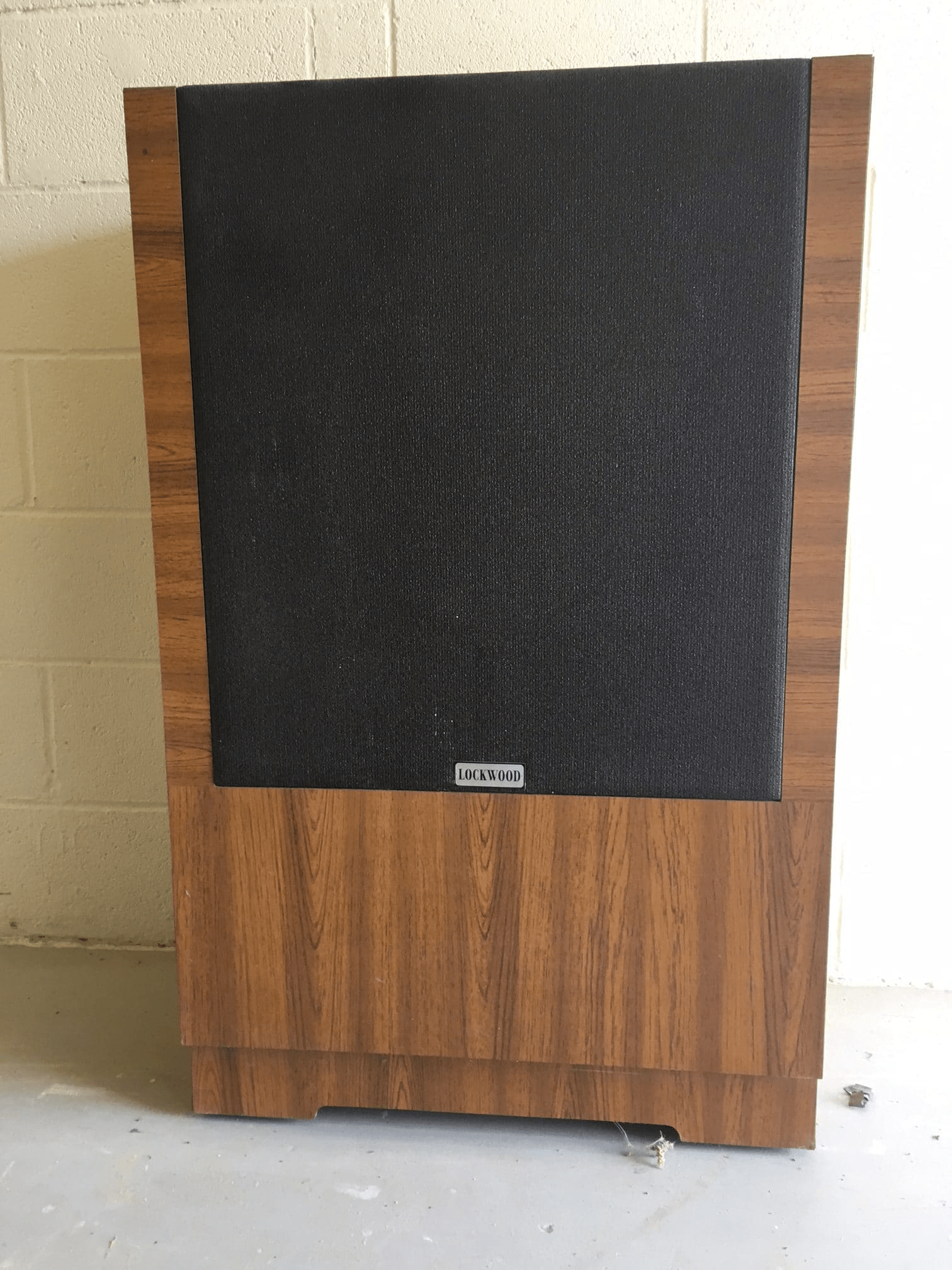

They may well be monitors made by a 3rd party using Tannoy 15" DCs. Possibly late Lockwoods.
Tannoy-made monitors usually have the treble adjust panel on the front but the Lockwoods I've seen pictures of do not so that may be what they are.
Could be Lockwood Majors. Try contacting Lockwood directly as they may know more.

A picture of the front of te speakers may help.

The picture I asked for is just simply the front of the speaker as Lockwoods have a quite specific look which makes it easier to confirm or dismiss.
The only thing I can say with a fair degree of certainty is that these are not in Tannoy cabs.
