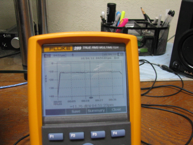

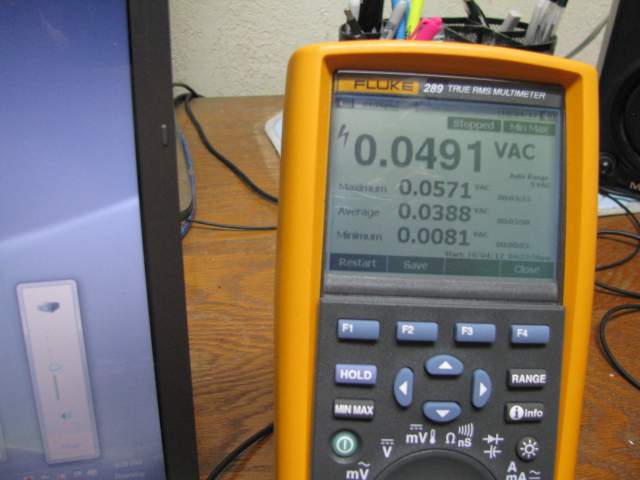

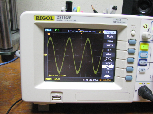

I just received my little package from China. I'm very impressed for the price and tiny size, IMHO. The sound is subjectively miles ahead of the built-in DAC in a Sony laptop.
Here are some photos and measurements for fun:

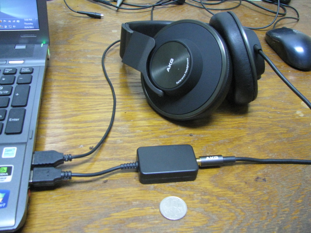

The first picture shows the tiny size of the DAC vs. a US quarter, a pair of AKG K550 headphones, and a PC mouse. Small!

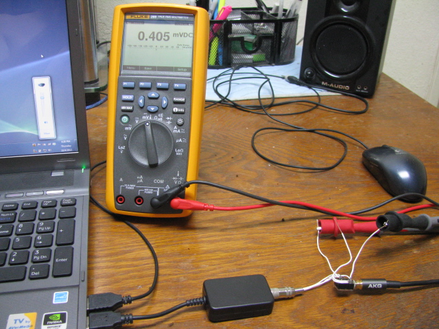

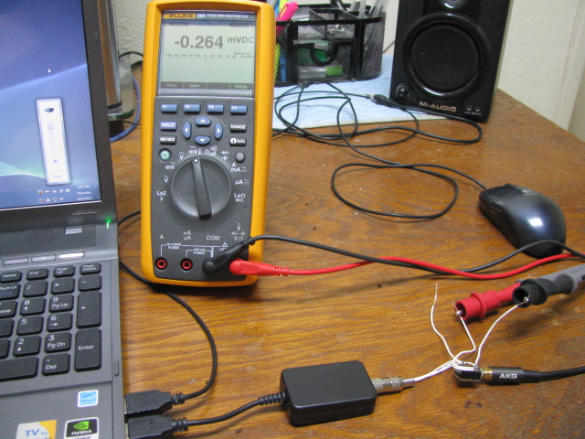

The next two pictures show the DC offset on the two channels. 405uV and -264uV. Those tiny levels are fantastic.
Next are the AC volts rms values over the course of playing a song on the PC, max - avg - min. The AKG K550 headphones are being powered directly by the DAC here. The PC volume slider is at about half way, 48/100, which results in normal listening levels on the K550s. The range goes from about 8mV rms (min) to 57mV rms (max). The PC slider in the photo isn't clear. That blue glob at the top isn't the slider, that is an icon. Look hard right at the middle of the slider range and you will see the slider "handle".

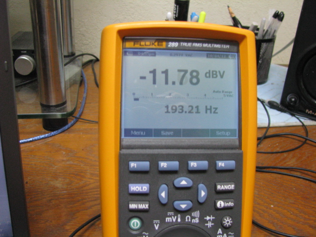

The next 3 photos are a dB/V plot during a frequency sweep from 20Hz to 15kHz on the PC, along with photos of two of the data points during the sweep. The X axis on the plot is NOT frequency here but rather time, set up for a 1 second sampling recording, while I turned the sweep file on and off on the PC. So this plot is useless for looking at low and high end frequency rolloff, rather just roughly what happens in the middle. Which is pretty flat!

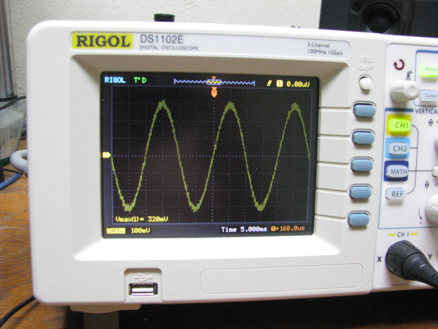

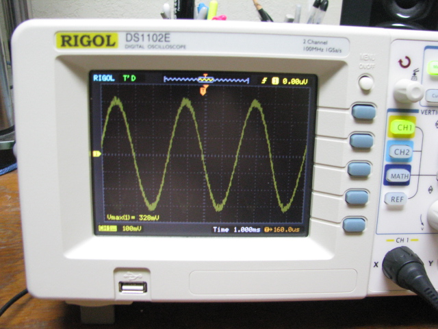

The next 3 photos are scope shots at 50Hz, 250Hz, and 15Khz from sine wave files on the PC. The scope probe is 10x (32mV DAC output, the 320mV shown on the scope screen divided by 10) and the time base is adjusted as it went to just show a few cycles on the screen. Vertical volts/div remains constant on all.
