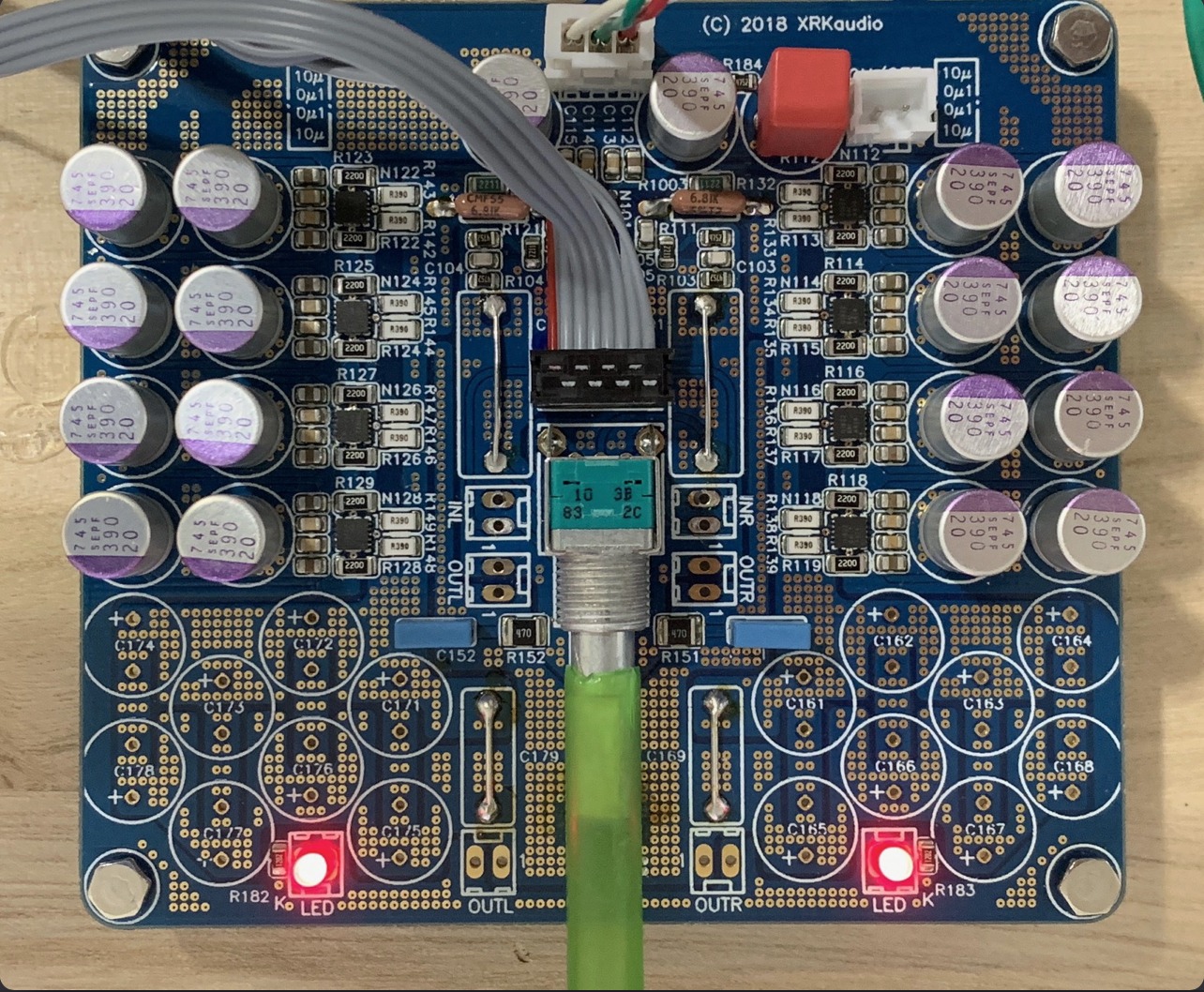

If using OPA1656 it is current limited to 200mA so P=I^2 x R gives 1.28W for 32ohm load. But that assumes voltage rails not reached. Assume +/-18v rails and we get P=V^2/R or 36v/2.83 for 12.7Vrms. This gives nearly 5W so it means it is current limited to about 1Wrms into 32ohms.Hi XRK, how much power output for this amp ? Is it larger than pocket class A ?
You can redo calcs for dual 9v batteries. These are closer to 8v or +/-8v or 16Vpp. This is 1W rms into 8ohms.
It’s bigger than PCA S laid out but could be made small with better layout and electrolytics all on one side of PCB.
Oops I meant 1W into 32ohms. And the current and voltage both support it. Never realized how powerful this could be for a couple of opamps. If you like where this is going check out my 8x parallel OPA1622 headphone amp. It’s technically capable of 10w into 8ohm speakers!If using OPA1656 it is current limited to 200mA so P=I^2 x R gives 1.28W for 32ohm load. But that assumes voltage rails not reached. Assume +/-18v rails and we get P=V^2/R or 36v/2.83 for 12.7Vrms. This gives nearly 5W so it means it is current limited to about 1Wrms into 32ohms.
