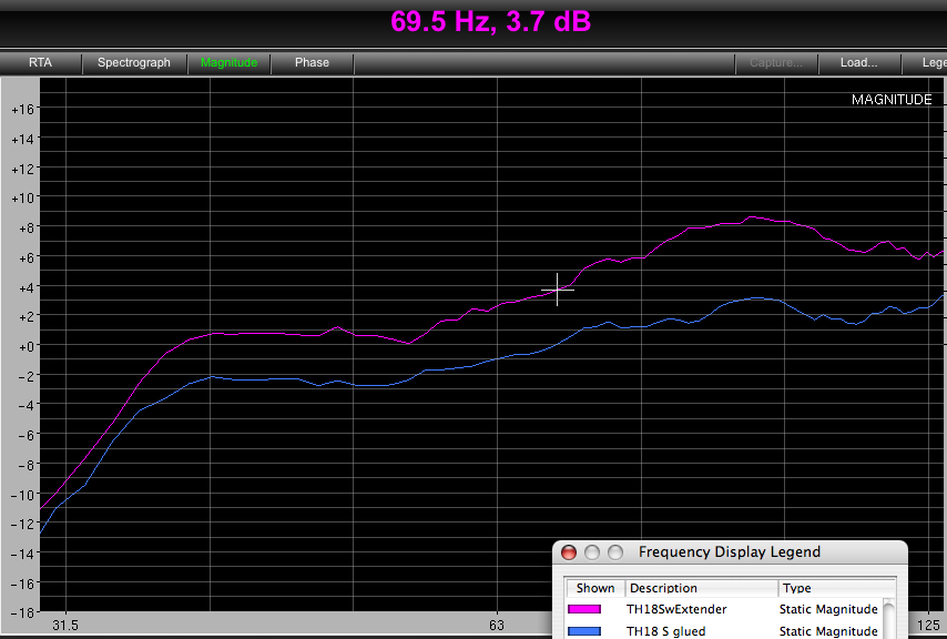

My (former) mains PA uses rather small horn top cabinets, only 26.5 inch wide. The sealed conical expansion FLH (front loaded horn) response drops below 200 Hz, but using fourteen 8" drivers per side makes the response OK to around 70 Hz. When I need a bit more low end and directivity I use wave-guides in front of the stack, it gives the low end of the horn a 3 dB boost down to around 70 Hz, and maintains the 90 degree pattern down pretty low.

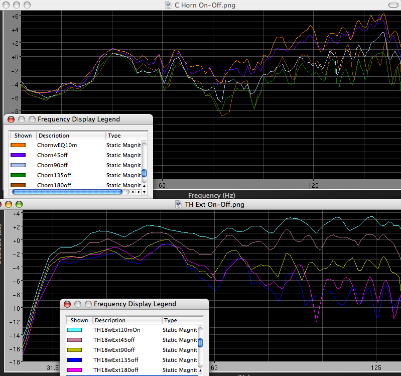

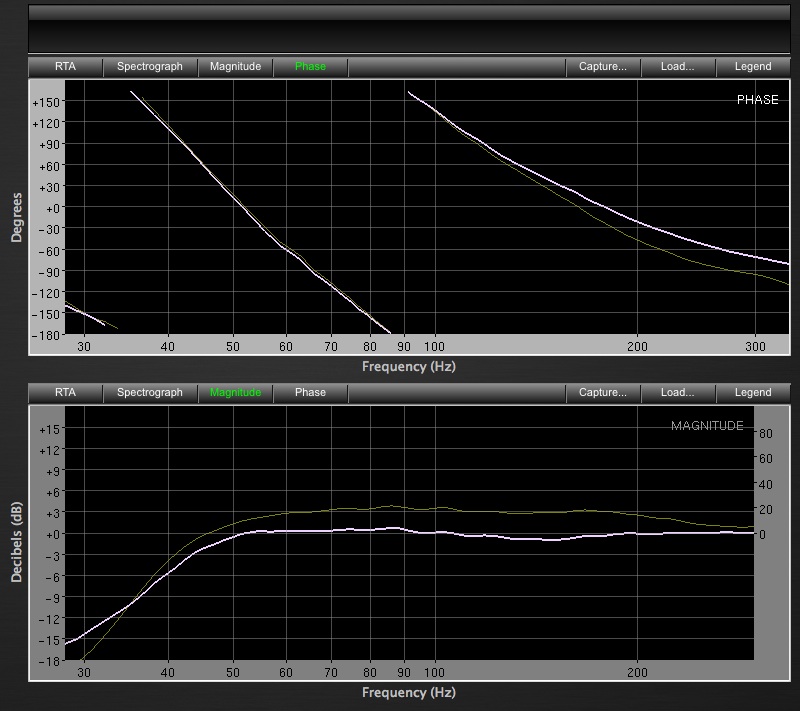

In front of the Keystone TH (tapped horn) cabinet, the wave-guide increases SPL (sound pressure level) by an average of 3 dB over the entire sub-woofer pass-band from 36 to 100Hz.
The wave-guide adds SPL to any LF (low frequency) enclosure by increasing forward directivity.

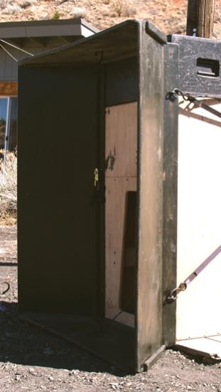

The wave-guides in the photos below are constructed from four pieces (top and bottom, left and right sides), and break down to a package about 6" (inches) x 20" x 54.75". Ratchet straps are used to attach the four parts, and to attach the wave-guides to the mains cabinets. There are no rattles even at the full peak power of around 6600 watts per stack. Since the wave-guides couple a larger area/volume of air in front of the stack, SPL in the immediate vicinity directly in front of the stack is actually lower than without the wave guide.
The wave-guides take a few minutes extra time to set up, but considering the cost to output level increase they afford in a small cargo space, the equivalent of doubling speaker cabinets without paying for the second set is quite worth it on gigs that need a lot of SPL using the minimum amount of power.

4) Wave-guides can add 3-6 dB forward gain with no power compression, drastically reducing power demands for a given SPL compared to the same cabinets without, and require no special design consideration regardless of cabinet design- they work equally well on BR (bass-reflex), TH, or FLH. The bigger the wave-guide, the better, for more forward gain and reduced rear "wash", while also reducing SPL in the immediate near-field directly in front of the cabinets.

The extender happened to work quite well with the Keystone sub, it may work well with other TH designs of similar aspect ratio.
Reducing the size to the height of the mouth would probably reduce the gain by half.

A ridged side “Dixie Cup” approach could save time in set up if one has the room, the Community Leviathan did that for their horn extenders.
I don’t have the room for that, the wave guides (double in height to what was shown in front of the Keystone sub) fit on either side of speaker cabinets in the front “V” section of my 5 x8 foot trailer.
Having angled top and bottom also makes stacking problematic, another reason in favor of a flat top and bottom.
The wave guides I have were made to extend the mid/high horns in my system, the horn extension is 90 degrees (45 degrees each side), 15 inches from front to back.
As I mentioned in the OP, the wave-guide/extender increases the low end of the mid horn by about 3 dB down to around 70 Hz, but using it in front of bass reflex cabinets or folded horn cabinets below 70 Hz, the wave-guides did not increase level noticeably in that range.
So I really did not have high expectations when I tried the wave-guide with the Keystone sub, though a quick model using Hornresp looked promising enough for me to do the test.
I stack my top cabinets on top of my sub cabinets.
When I use the wave-guides, they stack from the ground up, so whether they would do anything for the sub response really made no difference .
The 3 dB increase across the entire sub range was a pleasant surprise .
The Keystone sub has a rather large front panel to mouth compared to many TH designs, which makes for a larger boundary. The wave guide more than doubles that boundary, and when mirrored by the ground plane, makes for five times the frontal area boundary.
The large boundary increases directivity so forward gain is increased, while level to the sides and behind is reduced, the same as what is observed when multiple TH are arrayed.
Extending an array’s front to double the area probably would also increase directivity by a similar amount as I measured.
As far as using a wave-guide with the JBELL stadium horns, (or any other tapped horn) I’d suggest the bigger, the better, but I’d expect from my test that doubling the frontal area should result in 3 dB forward gain, and a corresponding rearward loss.
