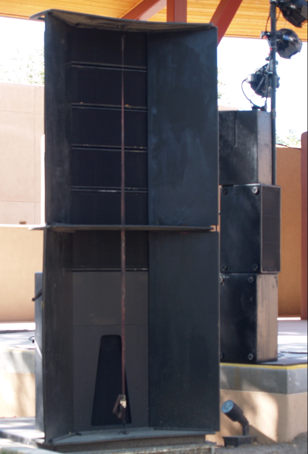

Sweet, thanks Art. Pretty close to what I envisioned. I assume the slots and holes make no significant difference in SPL output.
My cabinets are 3/4" baltic birch. Would you recommend I make the waveguide out of baltic birch as well, or do you reckon 3/4" aurauco is sufficient?
And I see you didn't go with the approach of making a square (with the waveguide and mirrored ground plane)...(unless you go two-wide). Still must work well, I imagine.
Compare the area of the slots and holes to the total mouth area and you could figure the percent reduction in output they cause, ie, something like .001% of 3 dB.
The handle holes make them much easier to carry, the side pieces in the waveguides in post #40 are just a bit too deep to fit under most people's arms without.
With the handle holes one person can easily carry the four waveguide pieces.
I use 3/4" Arauco ply. Baltic Birch would be stiffer and heavier, but the pressures are not very high with such a large mouth area. I don't notice much vibration even when using the Keystone 18" with 14 eight inch speakers running above sharing waveguides.
The taller the mirrored ground plane image, the less vertical dispersion.
I prefer the audience get the LF sound rather than the birds or the ceiling;).

I wonder if there would be any major difference putting two stacks of subs next to each other and putting the waveguides on the outside of the coupled stack VS two separate stacks with their own waveguide, but next to/touching one another.
From a low frequency standpoint, where 1/4 wavelength is the width of the array orgreater, little difference.
At the upper end of the spectrum, say 100 Hz, unless the center to center distance is under a 2.825 feet (less than a meter) or so, there will be off axis comb filtering.
My preference would be tight packing the subs and putting the waveguides outside.
My main PA uses rather small horn top cabinets, only 26.5 inch wide. The horn does not do much below 200 Hz, but a lot of cones makes the response OK to around 70 Hz.
When I need a bit more low end and directivity I use wave-guides in front of the stack, it gives the low end of the horn a 3 dB boost down to around 70 Hz, and maintains the 90 degree pattern down pretty low.
Using bass reflex cabinets or standard horn cabinets below 70 Hz, the wave-guides did not show any level increase in that range.
However, in front of the Keystone TH cabinet, the wave-guide averages more than a 3 dB increase in level over the entire sub range.
The wave-guide/extender significantly increases directivity too.
The wave-guides are four pieces, break down to a package about 6 x 20 x 54.75. Ratchet straps are used to attach the wave-guide to the cabinet, no rattles with full power.
The wave-guides do take a few minutes to set up, but considering the cost to output level increase they afford in a small space, the equivalent of doubling the speaker cabinet without paying for a second speaker, quite worth it on gigs that need a lot of level with the minimum power.
Some construction details have been added in post #40.

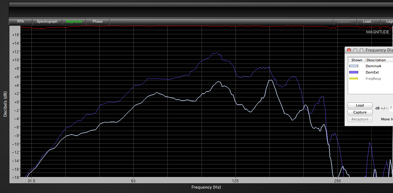

Do you think that an extender would lower the F3 of a tapped horn or BLH?
Patrick,
Turns out my previous statement:
"Using bass reflex cabinets or standard horn cabinets below 70 Hz, the wave-guides did not show any level increase in that range."
was incorrect, as I found out later with more accurate testing.
In all cases, an increased frontal area increased level, but in no case did the F3 go lower than the original response.
Even with the Domino DFLH (pictured in post #40), which IIRC Hornresp indicated would go lower with the extender, it did not, to my dismay :rolleyes:.
Smoothed the response and added almost 6 dB of "punch" though, as you can see in the chart below.
