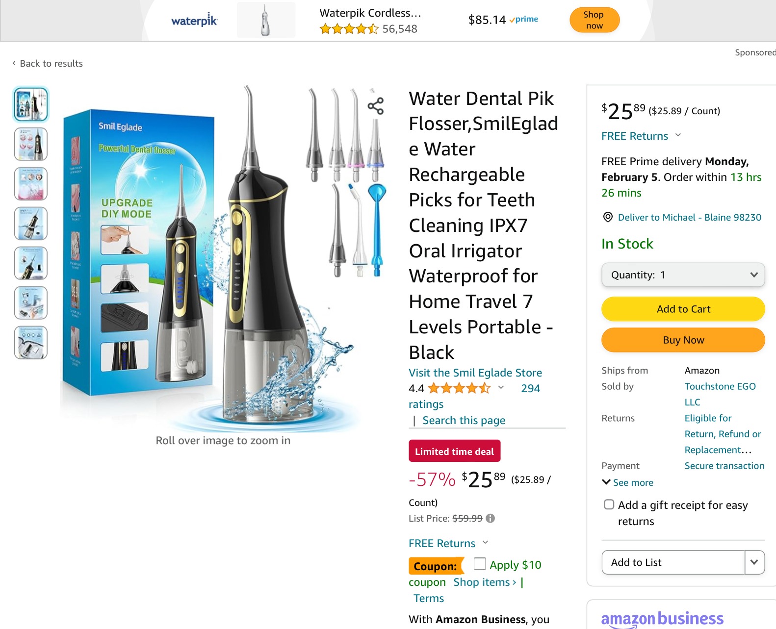

I wonder if a water pikmwould be an easier way than using a “toothbrush”
I am sure there are some solutions that would be safe for the water pik and still be effective in loosening dirt
I wonder if that would void the water pik warranty :)
I have got to try this on something not too valuable. I need to get a cheap dirty receiver somewhere to experiment on. And maybe a cheap old waterpik so my wife doesn’t freak out

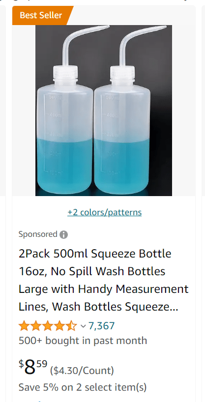

I put the Isop in one of these safety wash bottles and totally rinse the board surface after a 60 second ultrasonic brush over. I'll use a lot of Isop to rinse the flux away and the nozzle affords some spray away force. I do it over a bowl to catch all the fluid.
https://www.amazon.com/gp/aw/d/B07D6KZZQL?psc=1&ref=ppx_pop_mob_b_asin_title
After 3 cycles, that board is amazingly clean and I'm a little dizzy from the fumes. Win win all around ;) I'm not very experienced with other methods but this seems to work wonders and I don't need kimwipes. Just be sure to do it in a well ventalated area.

99% IPA and a dollar store vibrating toothbrush, two cleanings, the first cleaning still leaves a little bit of sticky flux, then the second cleaning its perfect. I lay out a dishcloth and dispense the IPA all over the board via one of these bottles, let the IPA sit for a while and it dissolves the flux: I've tried denatured alcohol but found 99% IPA works better and is more pleasant to smell.
