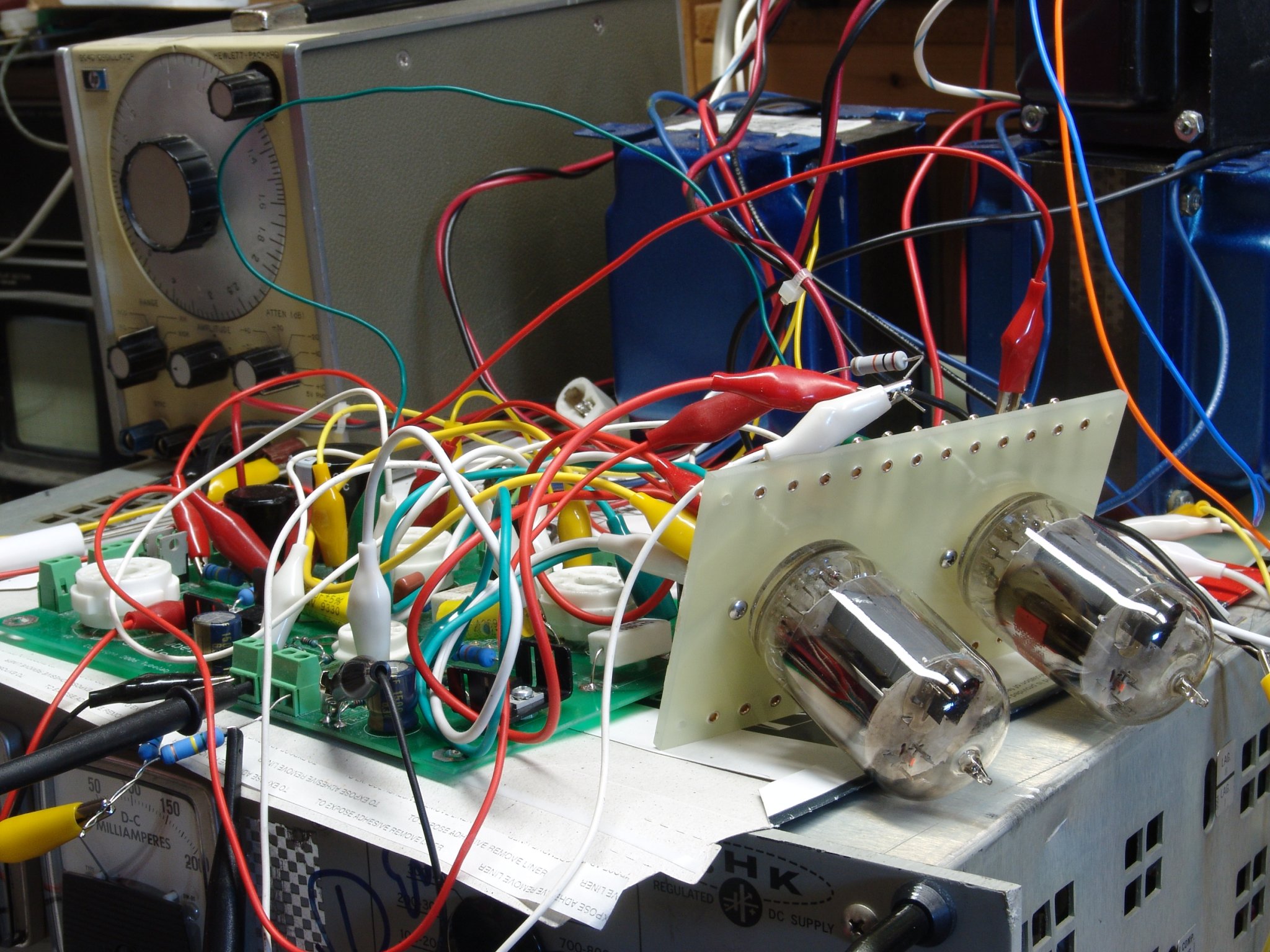

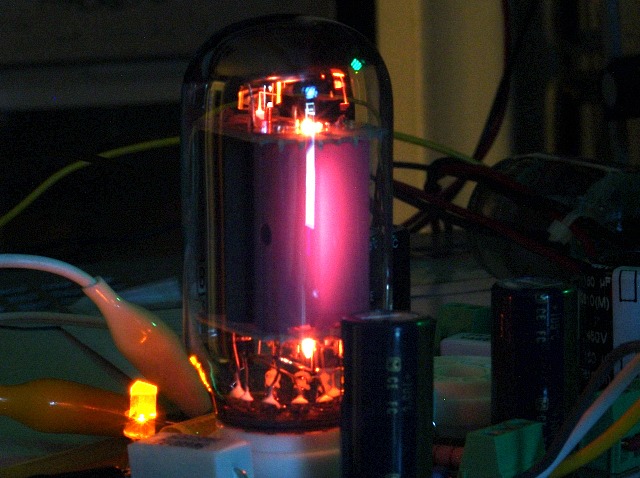

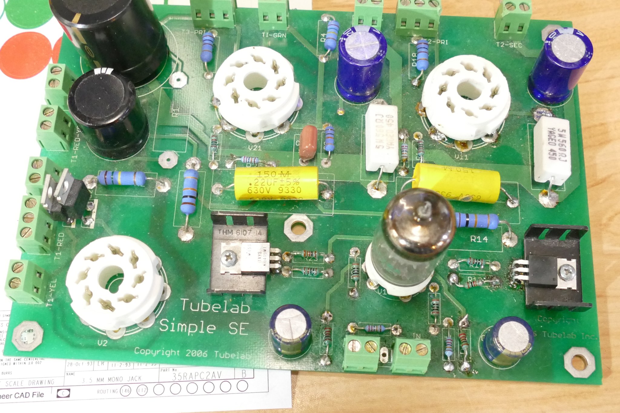

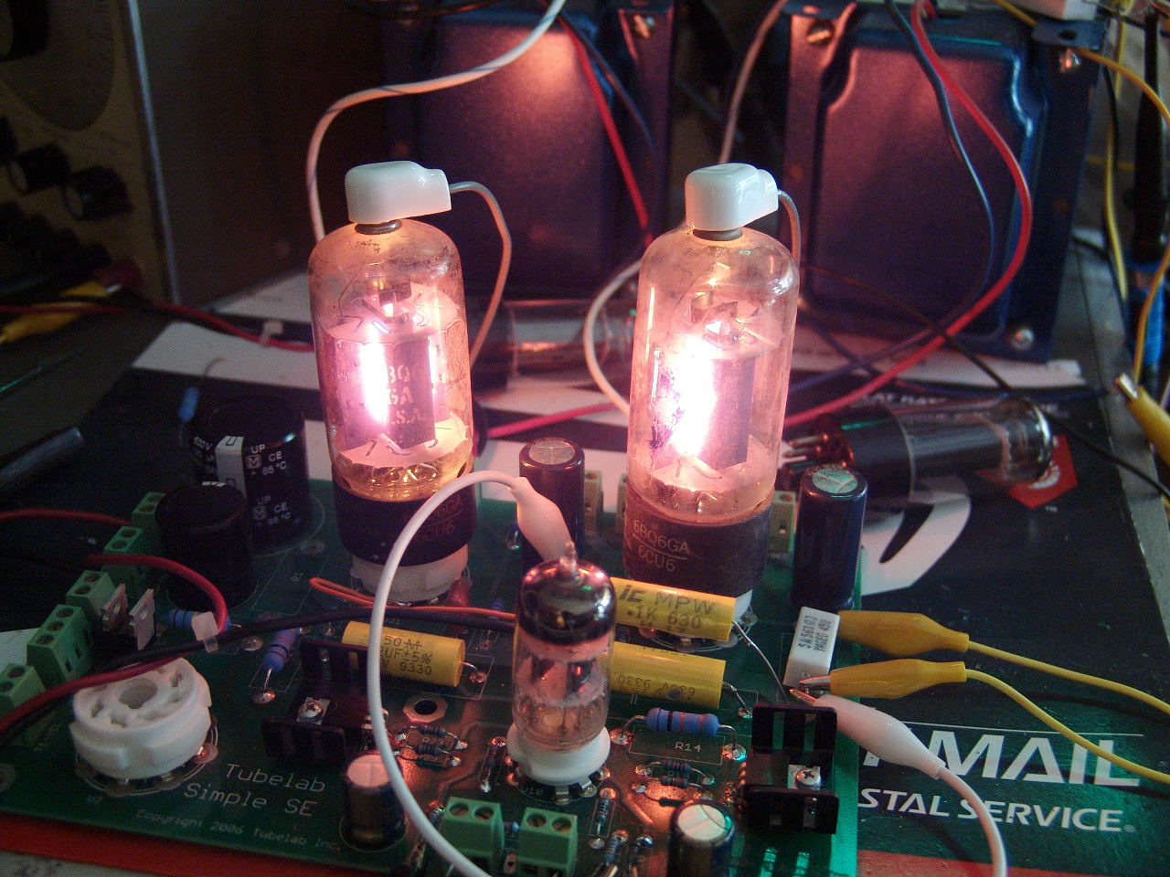

This old SSE board was the first one I ever built. It has been used for experiments for nearly 20 years. Some DUMM BLONDE experiments with TV sweep tubes caused both cathode bypass caps to explode nearly simultaneously when I turned the power supply up a bit too far (around 525 volts). This happened not once, but twice along with the venting of the power supply electrolytic. The board now has a 630 volt cap in its power supply and 100 volt cathode bypass caps. It has been through the dishwasher twice that I can remember, and it looks like it could use another washdown.
It lost one of its bypass caps in the attempt to melt a 6LR8 that was mounted off board.
It lost both simultaneously when I was finding the thermal limit of some crusty looking 6BQ6GA tubes that AES sold me as "NOS." This did get the tubes and everything else rather hot. One cathode resistor went open blowing its bypass cap, followed by a repeat in the other channel within seconds. That prompted the second trip through the dishwasher. Date on the photo says 2009, so it's been 15 years since it had a bath.
A few years back the IXYS 10M45 CCS chip became unobtainable. I tested about 30 possible alternatives in the board which left the area around the right hand chip a bit crusty. The last experiment involved driving the two channels out of phase via a little Edcor transformer and connecting a single push pull OPT up to both channels to create a push pull amp. Everything still works, so I see no reason to clean it yet.
