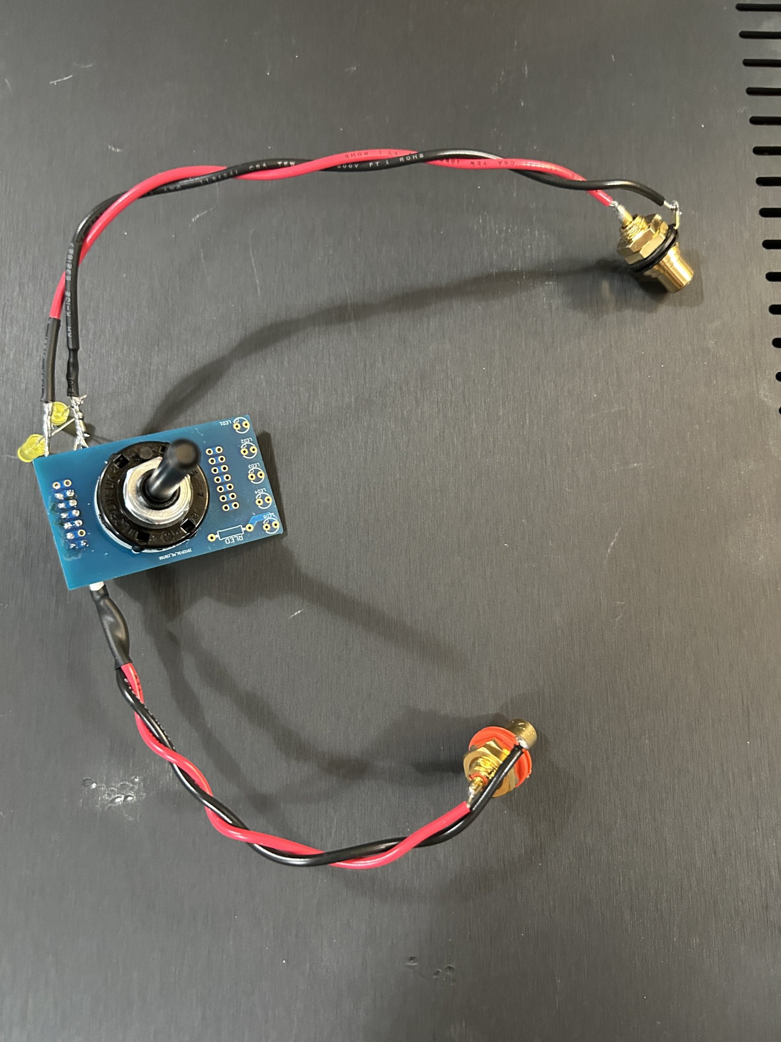

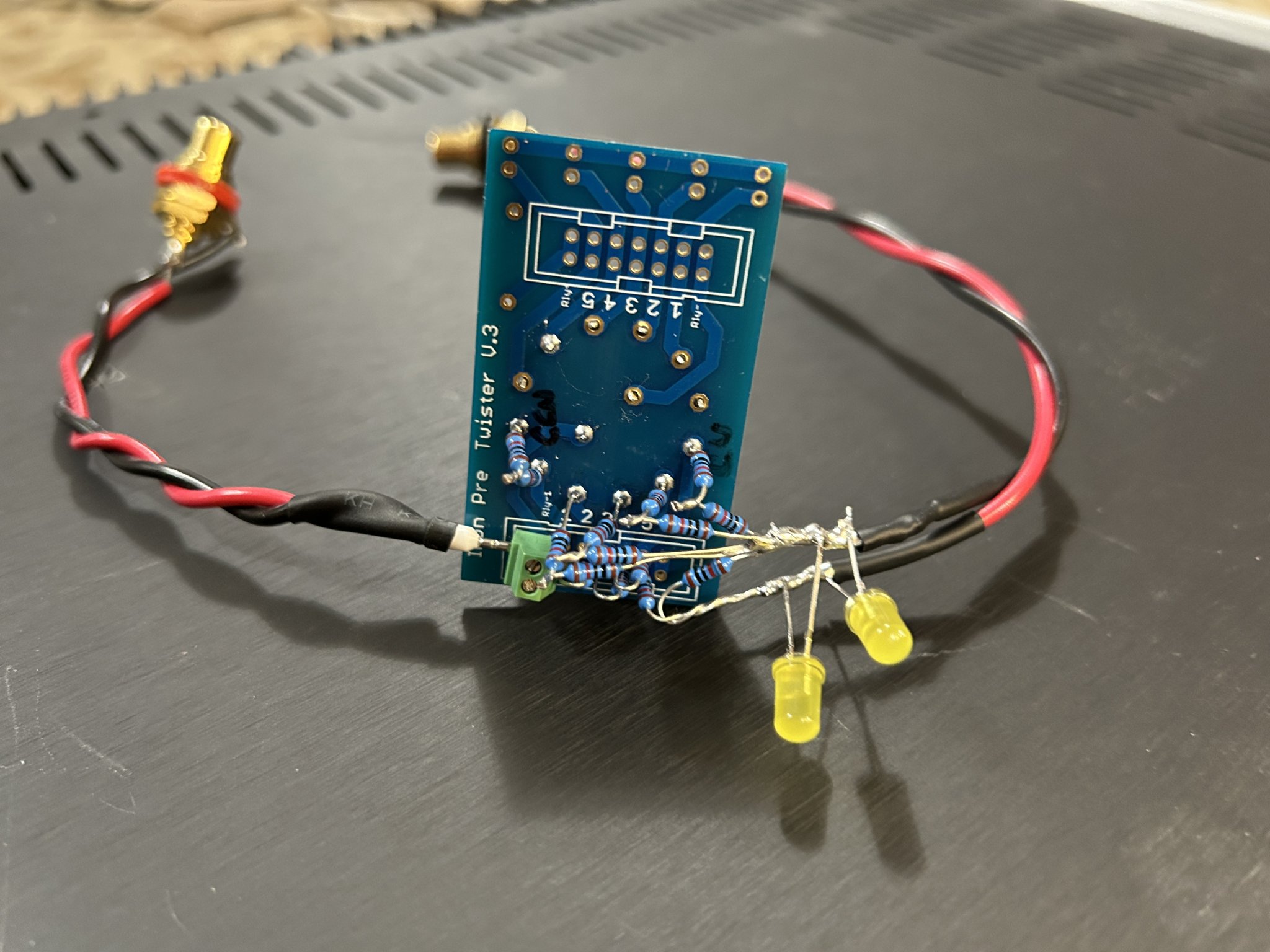

It's a wonderful little project. I think Claas posted about it early on in the thread, and I forgot about it. Ben kindly reminded me of the option a weekish ago.
Mine is <cough> not quite to the standards of the original builders', but it's quite functional. I didn't have two resistors exactly in the 1:2 ratio... so I used two in series for the "2" part. I was impatient and was not about to wait for a Mouser order. Ideal, no... functional and quick to get me over the hump... yep. I used a left over 'twister board' to remove some of the point to point soldering.

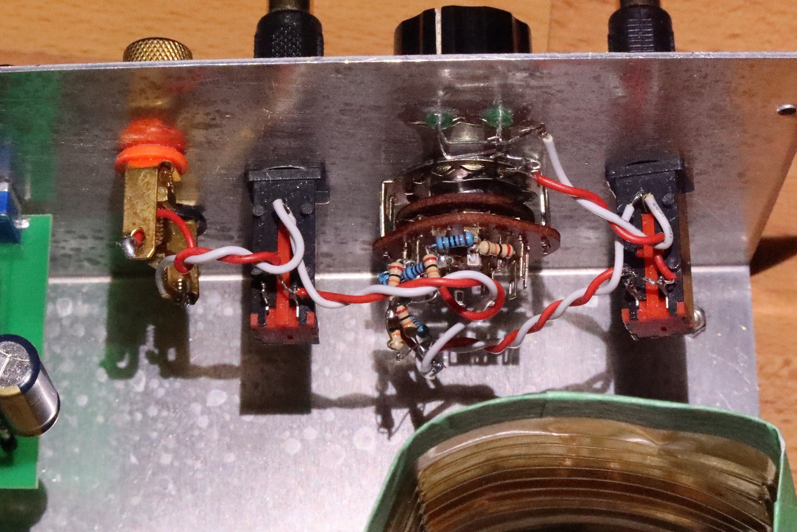

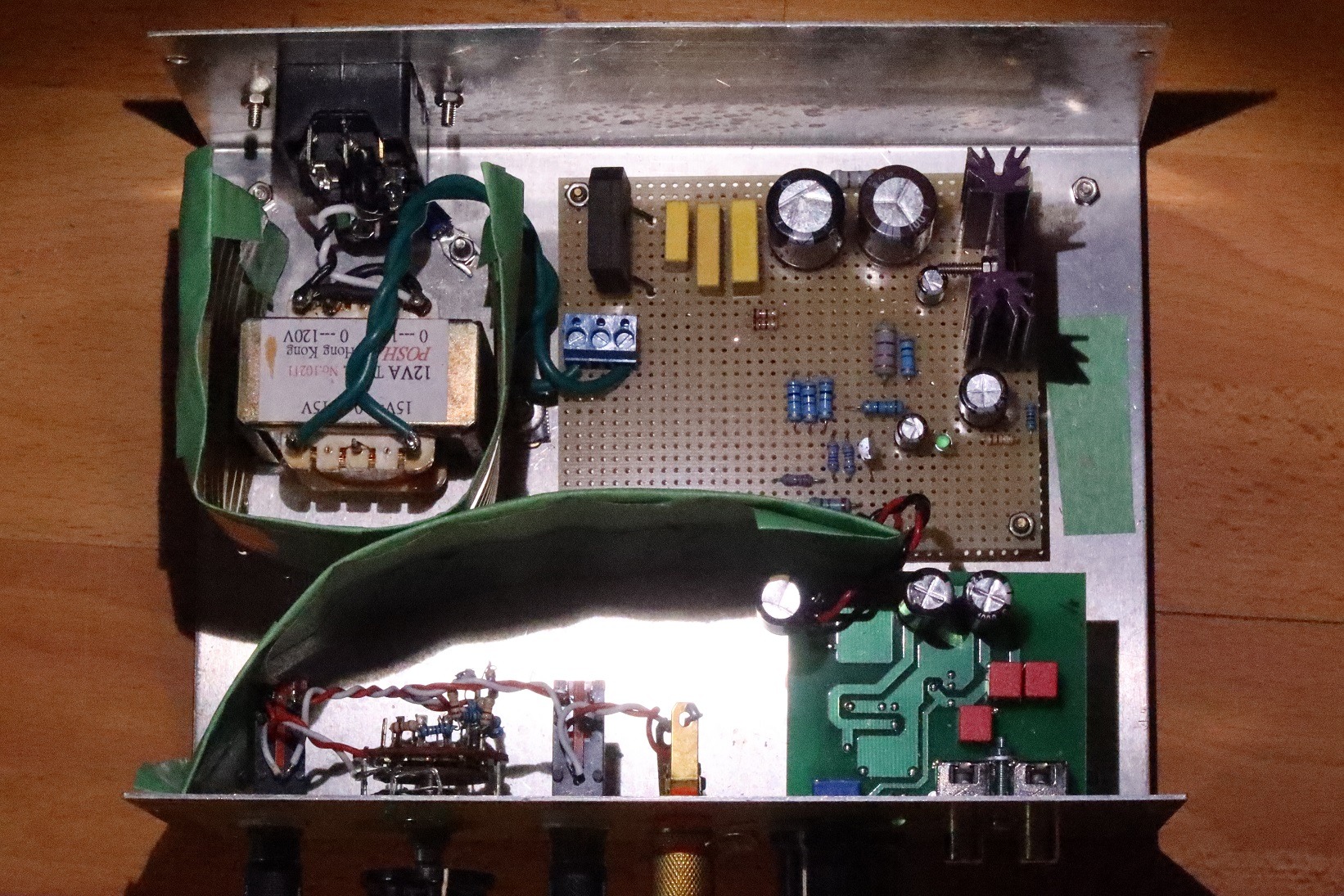

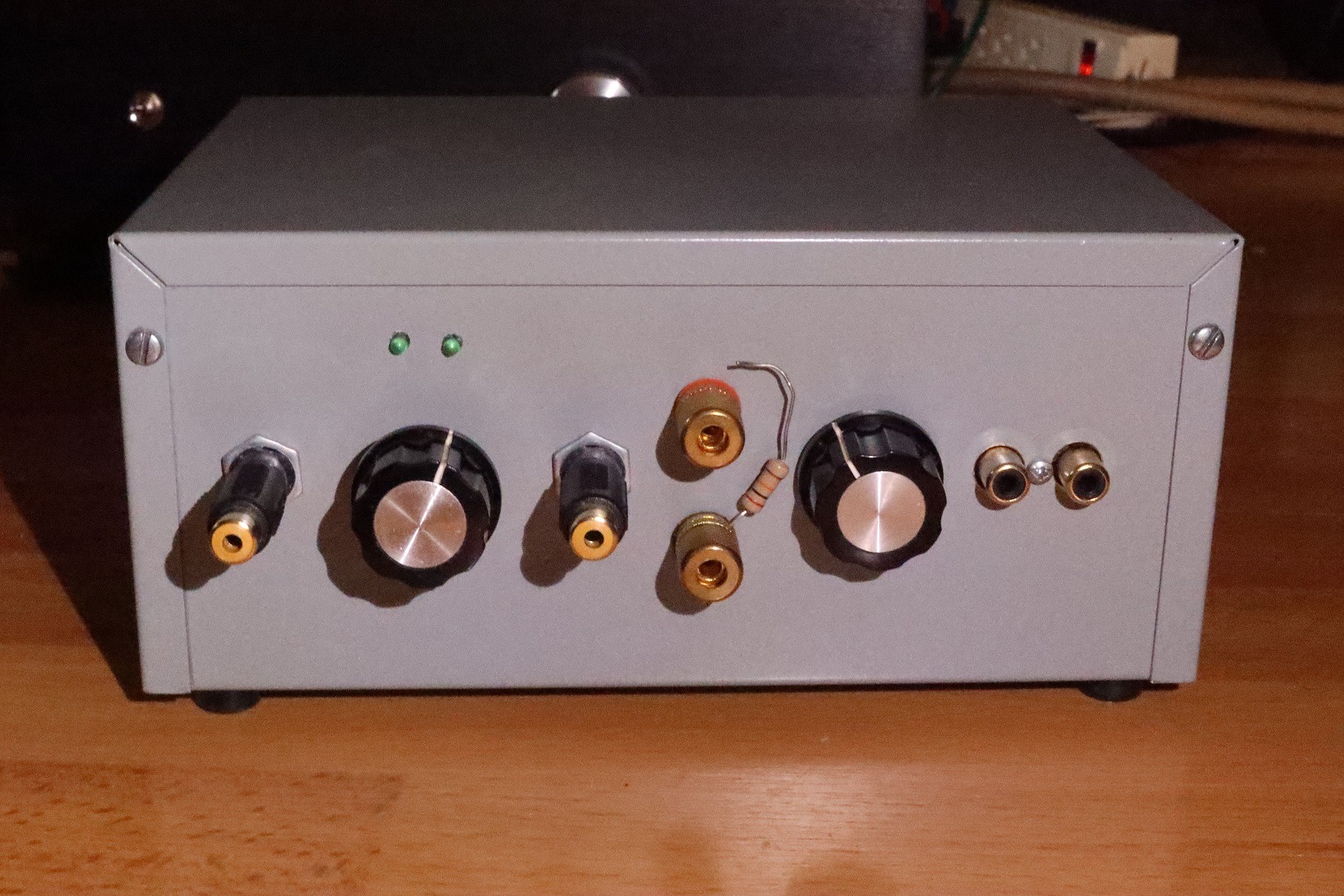

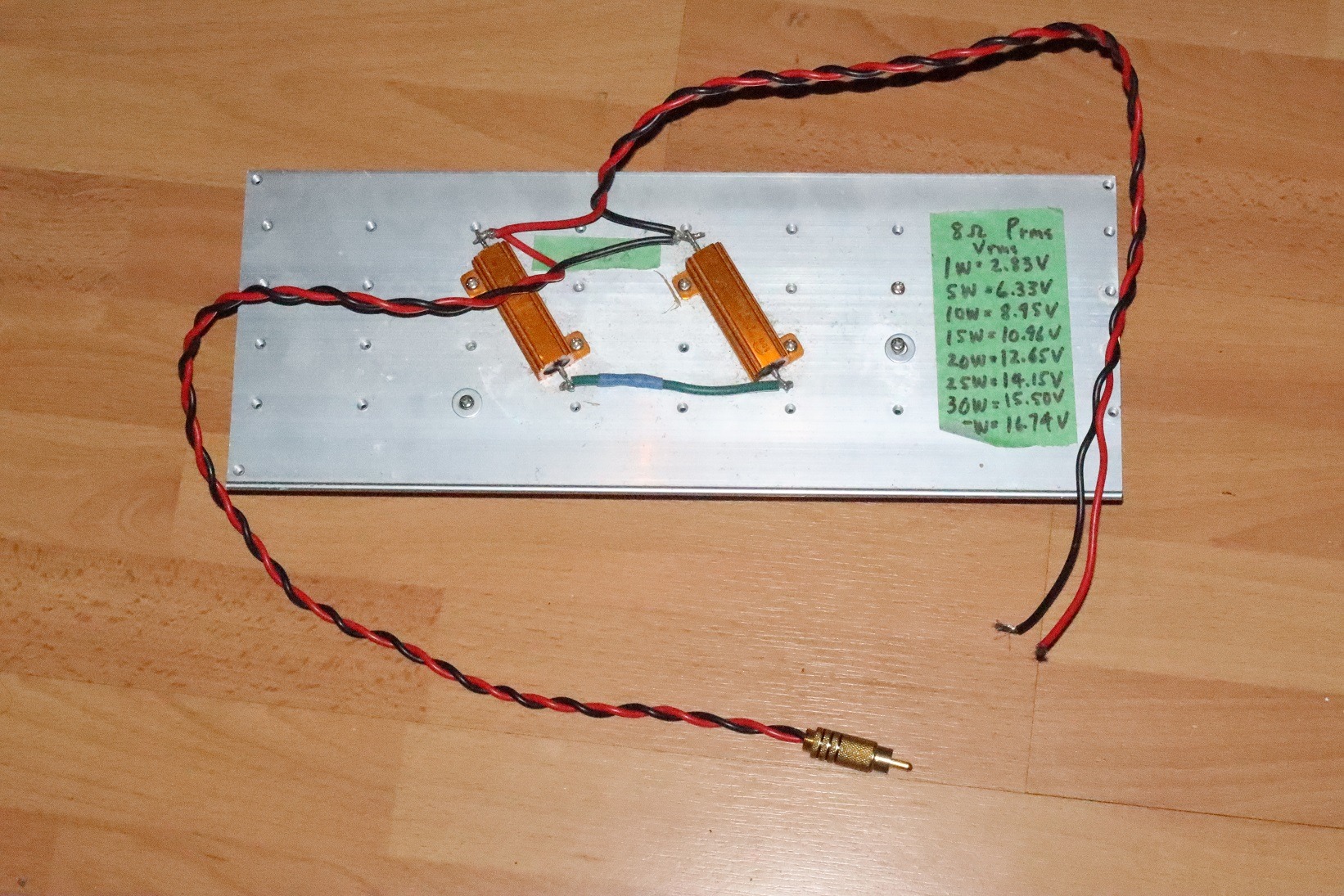

I put my Victor oscillator, its power supply, and the Akitika all in one chassis. I cut up a tin can to shield the power transformer and I added a piece of Mu-metal to shield the attenuator and oscillator from the transformer.
On the front panel, from left to right, is the attenuator output, attenuator rotary switch, attenuator input for connection to DUT, with a choice of RCA or individual signal + and - terminals, oscillator signal level adjustment, and two oscillator output RCAs. The attenuator input + and - terminals are handy for connecting a load resistor if the DUT is a preamp, and the terminals can also be used to attach a Volt meter to measure DUT output Voltage.
I chose a linear power supply because I didn't want to deal with replacing batteries.
For power amplifier testing, the load resistors are on a heat sink, and the output wires are terminated with a RCA plug for easy connection to the attenuator.
I can't make out the make/model of those 50W load resistors , but some caution may be needed to confirm they don't have substantial TCR or distortion. I had one make/model (RS branded) which exhibited a large TCR which I think was due to a different type of metal end terminal - whereas an Arcol HS50 was blameless. There are also some threads on determining the distortion from load resistors - which can be a concern when trying to measure quite low levels of harmonics.

^ Great information. I'll have to look that up also. I got Arcol NHS 1% 'low-inductive' types for higher wattage testing. So, hopefully... :xfingers:
