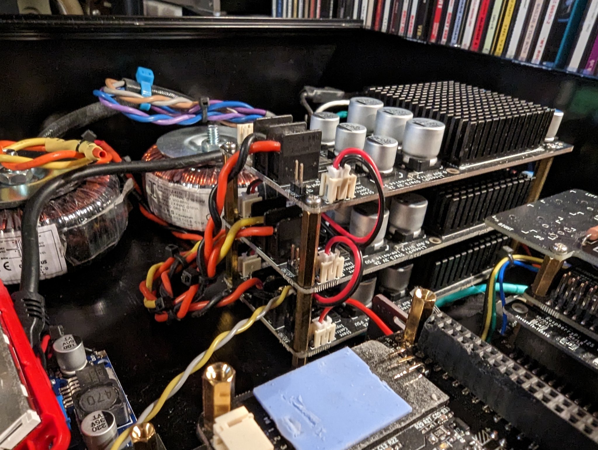

@MartinJohn,
(1) I see 2 x LifeP04mini with UcConditioners on top. One is 3.3V powering the Dual Mono Plus DAC with the three rails bridged. Does the other power the FiFoPi Q3?
I started out with 2 x LifePO4 minis, but replace the 6.6V one with a 5V LinearPi. Reason being, I thought the mini would regulate down to 5.0V, but it does not. Ian had mentioned the 6.6V mini is for specialized applications. In addition, since the batteries are 3.3V each, they are placed in series on the 6.6V mini, and 6.6V is what you get at the output. That's my understanding of it. @Ian, please correct me if I'm wrong. I can claim being a senior citizen and suffer from CRS more times than I want to admit! 'Can't Remember S#!t' :)
So, yes, the only 3.3V mini is powering the DAC. I know you get better performance using separate (AVCC, DVCC, and 3rd?) supplies, but for space constraints reason, I decided not to use that arrangement in this build and let them share 1 mini. The FifoPi has a 2nd dedicated 3.3V LinearPi. That LP actually replaced a DIYINHK low noise supply I was using earlier.
(2) I see a ConditionerPi under the RPi. So RPi is UC conditioned at 5v, where does the (regulated) 5V come from?
You are correct. The last 5V LinearPi supplies the StationPi Pro board, and that's where the regulated 5V comes from for the Pi. Again, this may not be the best practice, and in the past my other DAC used 2 x 5V supplies for the StationPi. One for the RPi side, and the other for the Audio side. They can share a common PSU with a couple jumpers installed.
(3) I also see the 2 x toroid's each with 2 x 6V secondaries.
Correct. I'm using 2 x 50VA trannies with dual 6VAC secondary windings. I do have 1 spare winding, so could add another PSU if I desire. The LinearPis are great for stacking too. Helps to maximize vertical space. Below is a picture of another DAC where I used 3 stacked LPs.
Hopes this helps.
Rick

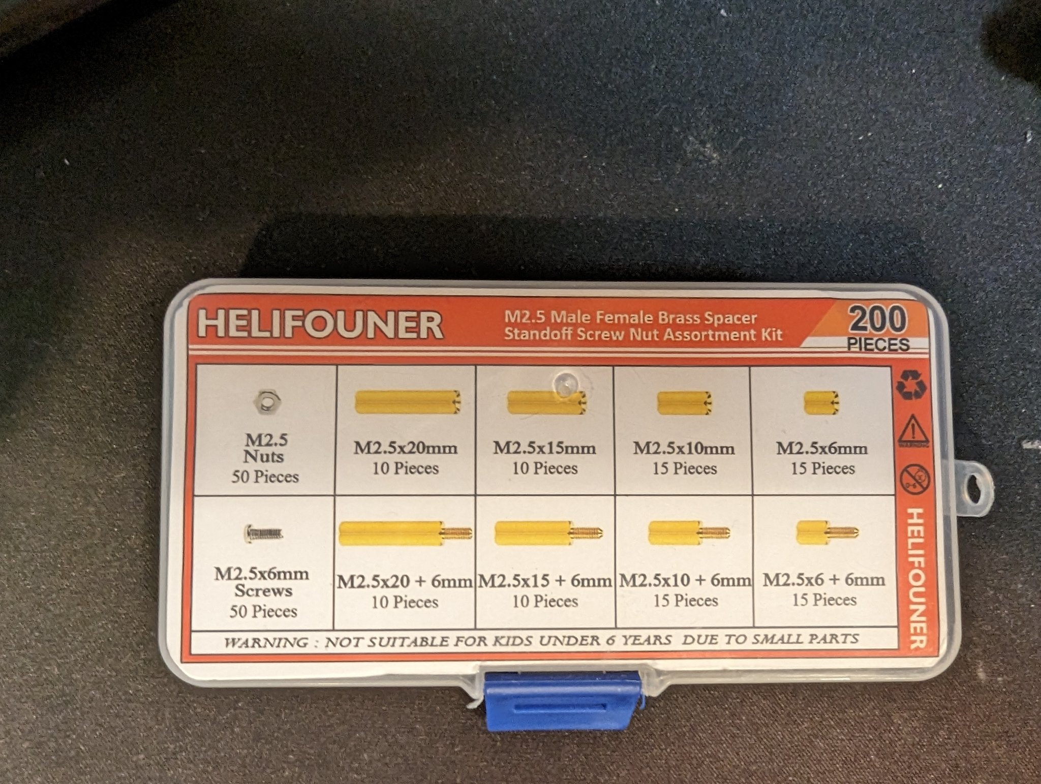

Rick,
Thanks it certainly does give me food for thought. In the photo of the stacked Linear PI power supplies, how long are the standoffs between power supplies?
Martin
Those are 25mm (M2.5). You probably already know this, but years ago when I started down this rabbit-hole hobby, I quickly learned I would need a lot of standoffs. Even though Ian does supply some with his boards, I usually need more and at different lengths. Amazon (or AliExpress) to the rescue. These multi-variety packs are handy to have around. I keep my shop/lab stocked with these multi-sized ones. Most of the ones I use are in the range to M2.0 to M4.0. If I don't have the exact height I need, I put two together and get close enough. I've found that with Ian's boards, you have to take care and make sure the boards clear the bottom board. If I only need 1 or 2mm I use nylon washers.
Rick

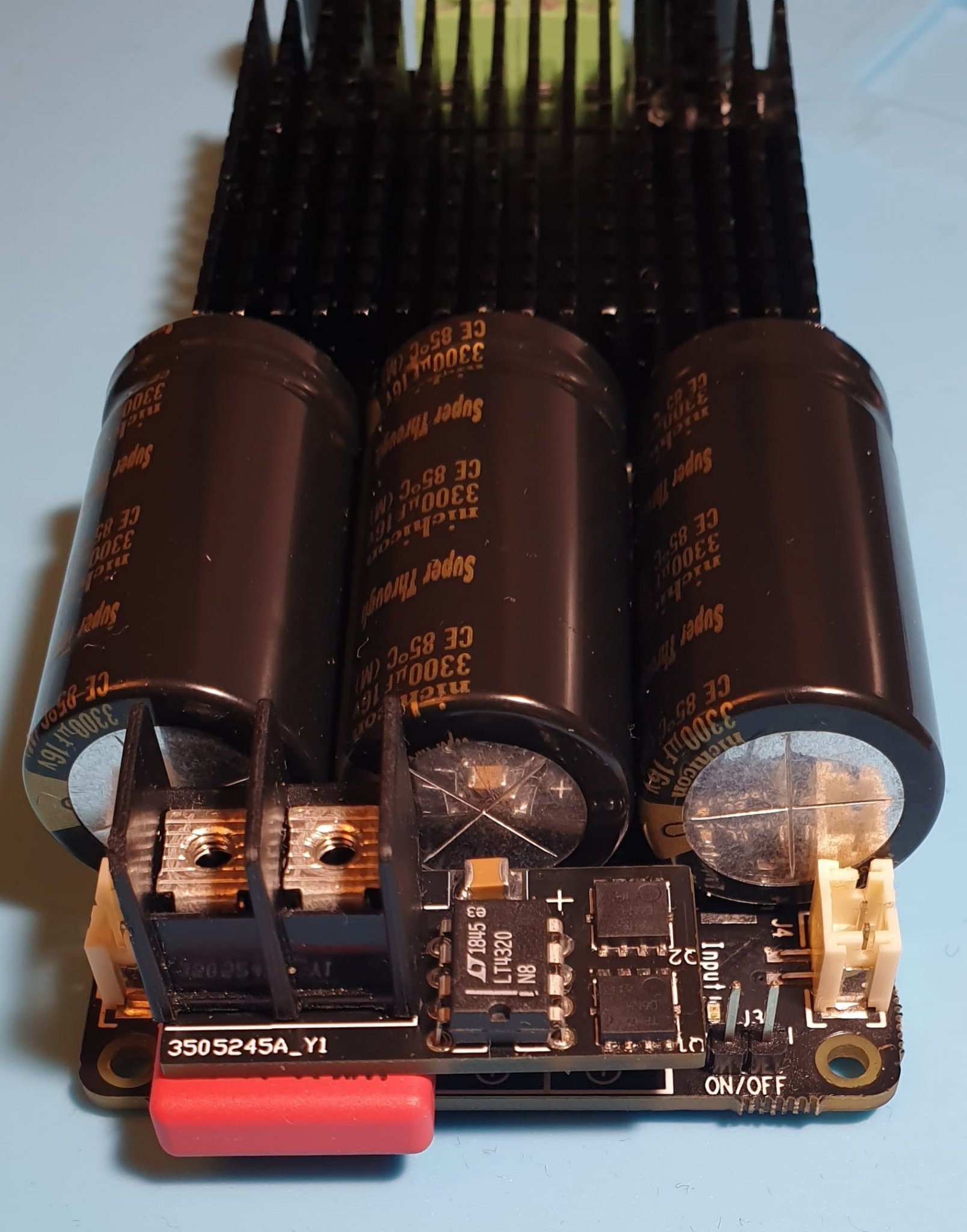

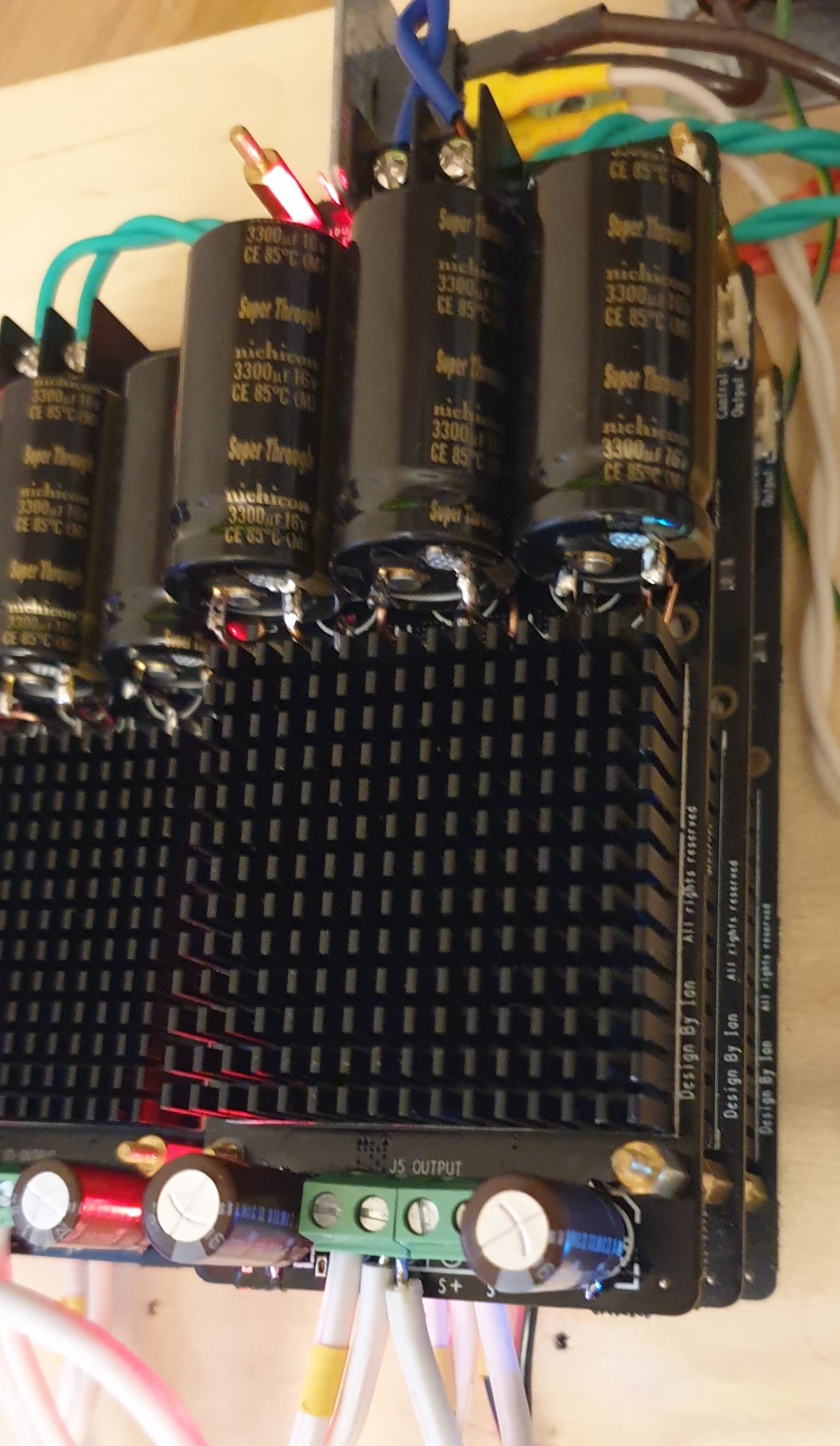

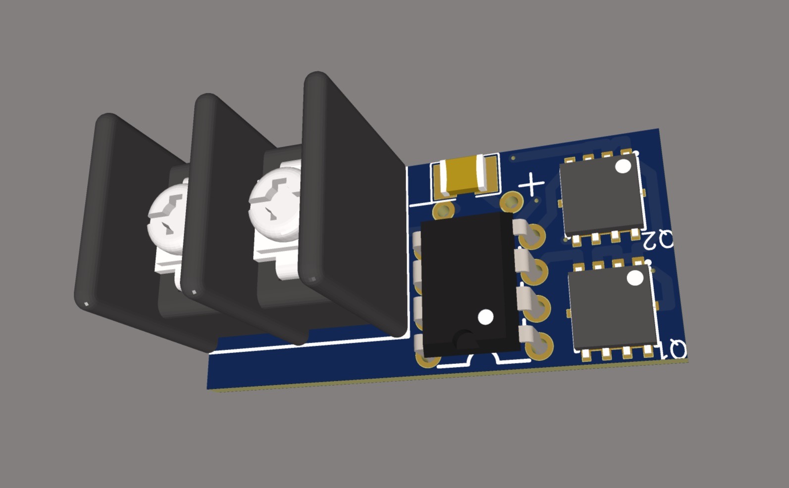

I want to share my experiments with Linearpi. In the stock - the usual good power supply. But if you replace the capacitors, then it becomes audiophile. As a result, I came to lkg grade3 at the entrance and cerafine at the exit. In this form, he confidently outplayed UcPure. And perfectly complemented by UcConditioner along with 3000f. This is the best I've heard for the clean side of fifopi (clocks must be powered separately from fifopi, then everything is audible) compared to other PSUs. After I changed the diode bridge on it to lt4320, I can also hear it.

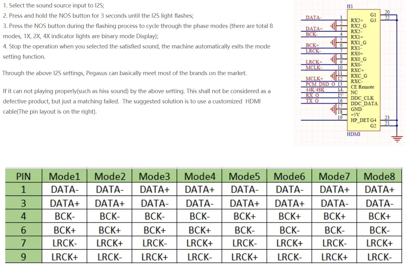

Hello to everyone, a little question from a newbie :
I've got a Musician Pegasus dac and I'd like to use an HdmiPi Pro to use the I2S entry of the dac to get the best of it.
As far as I know, the Pegasus has 8 different HDMI modes.
Would the HdmiPi Pro be compatible with Pegasus HDMI ?
I guess it should be used with the Fifopi Q7.
Thanks in advance for any info !
