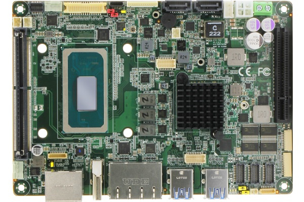

My wish is to move on from Raspberry Pi to a x86_64 platform in 3 years, but I don't think the x86_64 software is mature enough yet for GPIO.
I considered a Turning Pi2 which allows four Compute Module 4, but that's not going to work out. You can't scale CPU power with Raspberry Pi for Audio purposes.
So I want to UltraCap a Motherboard (9V - 24V) with a powerful Intel CPU and my own Audiophile RAM (Left side of Motherboard). And on this platform, I only trust PCI-E (Right side of Motherboard). So if there is someway to add Audio HATs on a PCI-E board that would be nice. But then you have that GPIO software bottleneck even if the hardware works out.

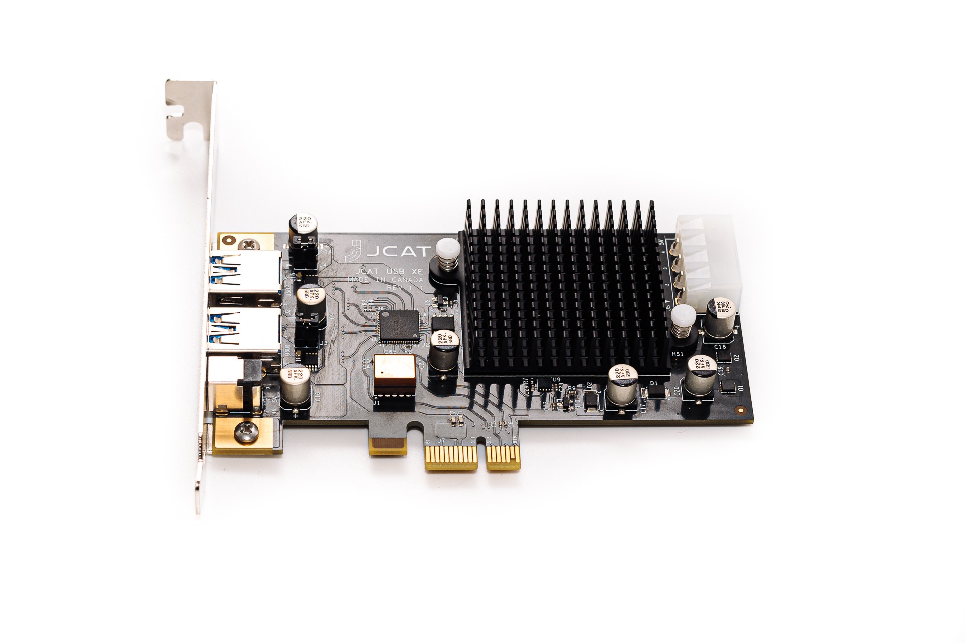

I'll likely try this with PCI-E USB with USB optical cable one day. It would just be nice if somehow you can SinePi a PCI-E solution for Andrea's Clock or Clock-Roll on PCI-E without the legacy Raspberry Pi interfaces. That way there may not be a need to involve GPIO at all, so the software doesn't need to catch up.
I already run low latency realtime on both Raspberry Pi and x86_64, so I have optimised pre-compiled kernels already. Just the additional CPU Power and Audiophile RAM would be fun.
Something like this. I believe U1 is the clock:
Toslink would be nice, but I have a USB optical cable so I'm unsure ATM. I never tried re-clocking USB yet.

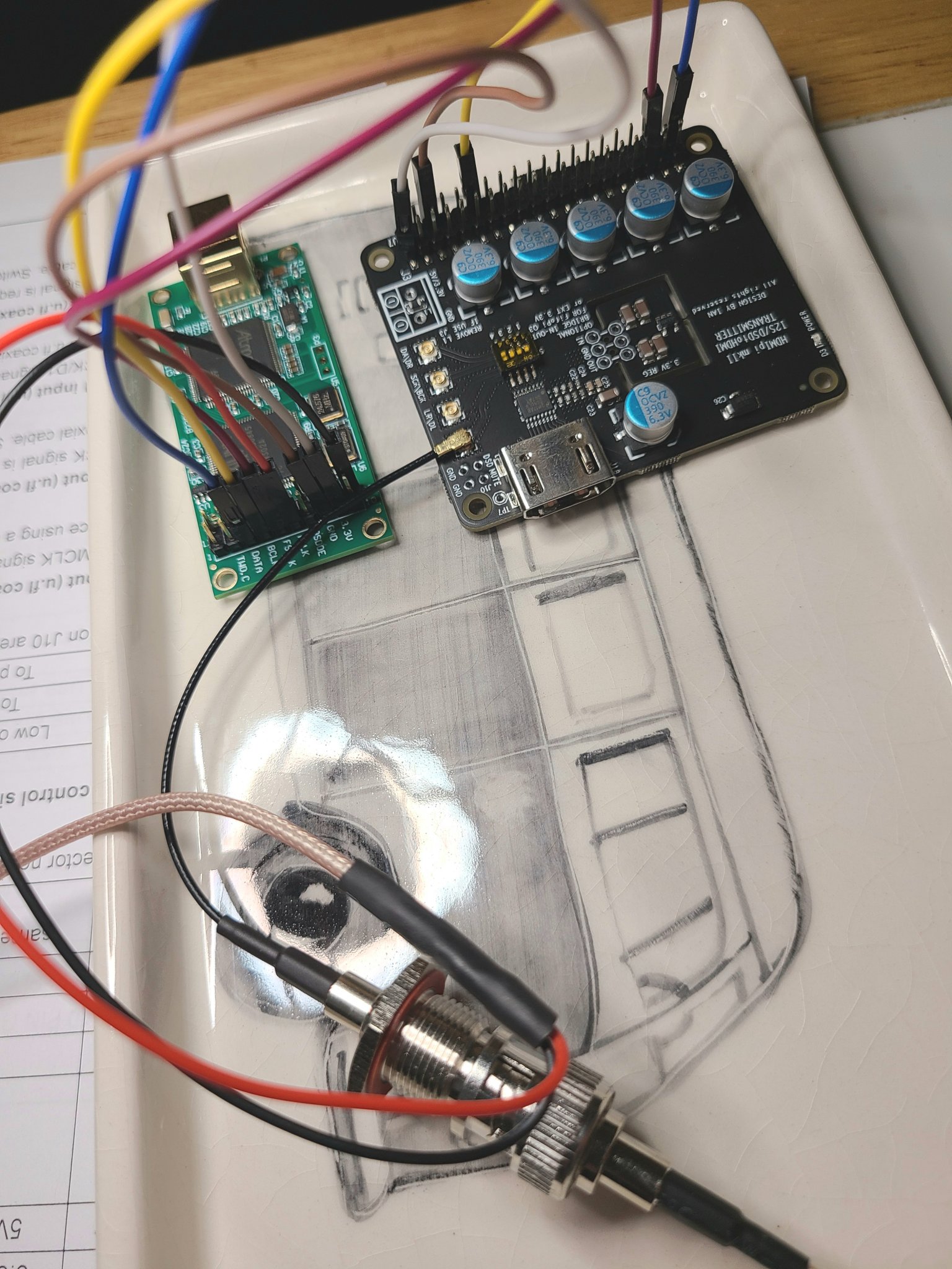

Total noob here. Will the below work as a standalone USB to i2s converter if I add an external power supply? Not currently working with my holo spring DAC. Had tried to use the 3.3v from the amanero board but I don't think it provides enough current. I do have a PS Audio DAC I could try that I believe sends power over the hdmi cable, unlike the holo.
Just trying to start cheap with the parts I have laying around, and then possibly upgrade once I have something working. The coax breakout wires were hooked up with red to mclk and black to gnd on the amanero 20 pin header. Hopefully I have the switches on the hdmiPi in the right positions to receive i2s signals (minus mclk) from the gpio pins.
Thanks, and I'm excited to be starting this journey!

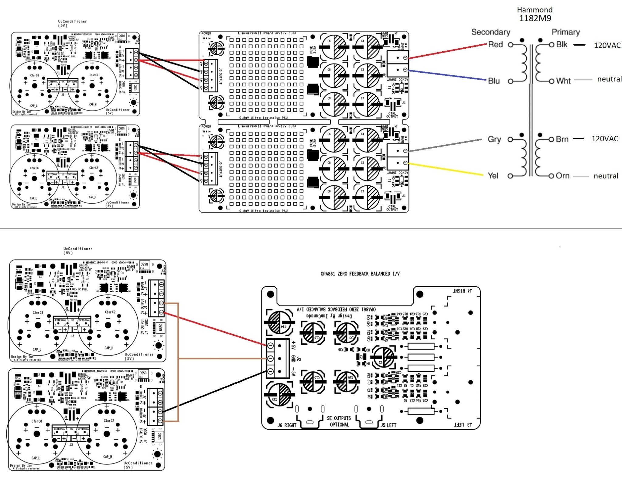

Hello; I have a question about the 2x 5V (1x-5/1x+5)power supply of the OPA861 fully Balanced Zero Feedback I/V Stage.
1. could I use 2x UcPi board with 2x UCCONDITIONER 5V ?
https://www.audiophonics.fr/en/powe...er-supply-board-for-raspberry-pi-p-16717.html
2. or would 2x LIFEPO4 MINI 6.6 V with 2x UCCONDITIONER 5V also work?
https://www.audiophonics.fr/en/batt...-battery-power-supply-module-66v-p-15832.html
I would like to connect it like this, only without the toroidal transformer and Linear Pi Dual..

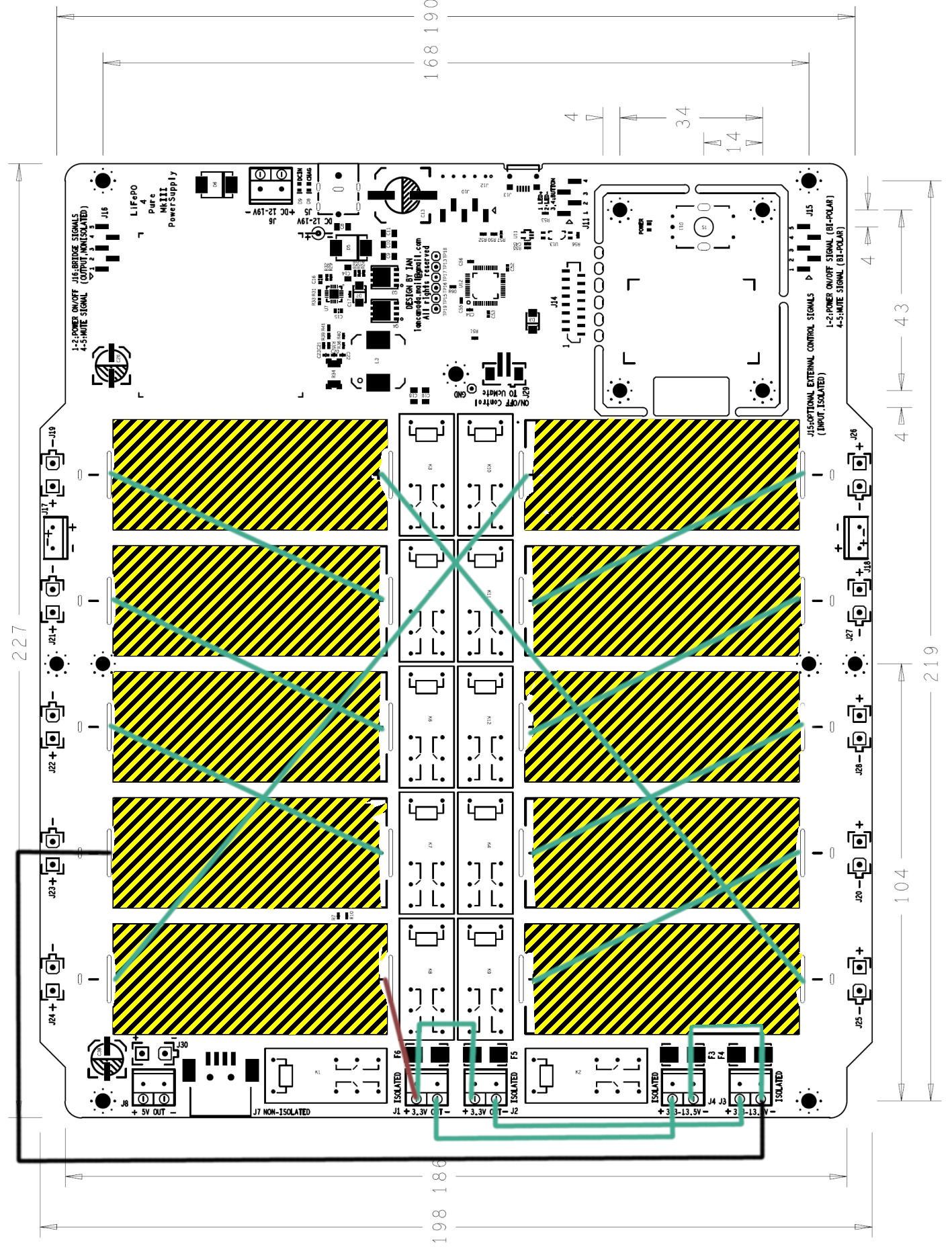

Please ignore my request for USB future anything. I going to give up on USB Reclocking because there is just no value. I came to this conclusion after configuring my LiFePO4 MKIII to use All ten batteries to test power my Intel NUC PC.
I got a little under 3 hours of use. It's not enough to justify a Passive Powered USB Reclocking setup since I only use Audio gear that is off of Mains. I could scale three UcPure/UcBalancer, but it has crossed the inflection point of value.
  1. PCI-E USB Reclocking boards cost around $1500
  2. The Industrial Motherboard plus Audiophile RAM cost around $1800
  3. 3 UcPure/UcBalancer will add up too with 18 Eatons needed in total.
I would only use the latest generation Xeon processor for this project and that probably eats a good amount of power.
I have arguably the World's Best Toslink Chain with Andrea's SOTA CLK @5.6448 MHz/TransportPi AES and arguably the World's Best Passive Power Supplies with the UcPure/UcBalancer so the USB project would have to provide a good amount of value to pursue. It doesn't, it may even be a downgrade from my current sunk cost setup.
So I'll keep an eye out for the USB Input on the ReceiverPi in 2025 if one day I go RPI-less. For now, I'm a very happy camper as my whole chain is off Mains via Passive Power. I was distracted by USB options, but in reality what I have built is really all I need. Money better used for Music or UcPure/UcBalancer upgrades.

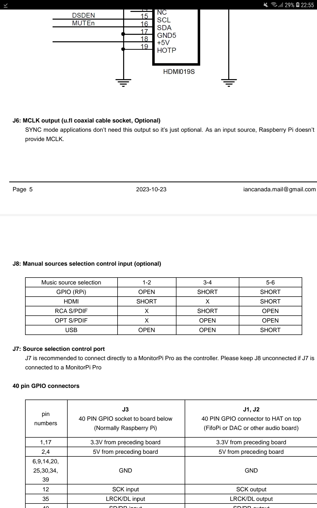

Hello. I have lots of staff from Ian. My latest is receiverddc input board. Im building dacnad want to have some inputs. Dac have one big oled screan nad dont want to add next. Problem is with manual input select J8. Receiverddc manual is not clear in this part. By shorting pi 2 with pins 1,3,5 i can chouse hdmi,rpi, usb and coaxial. But how to activade A optical? Very thanks for help.
