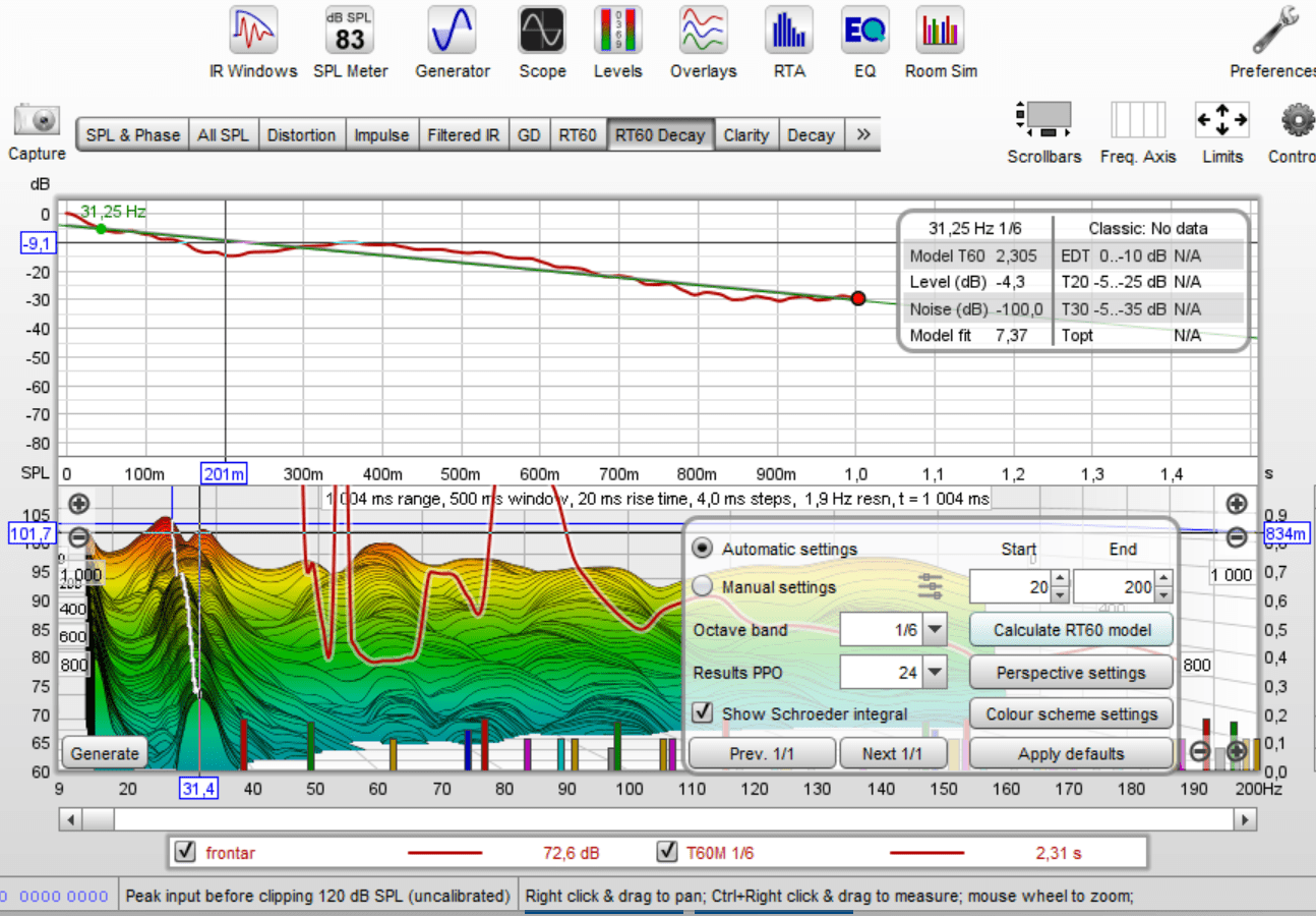

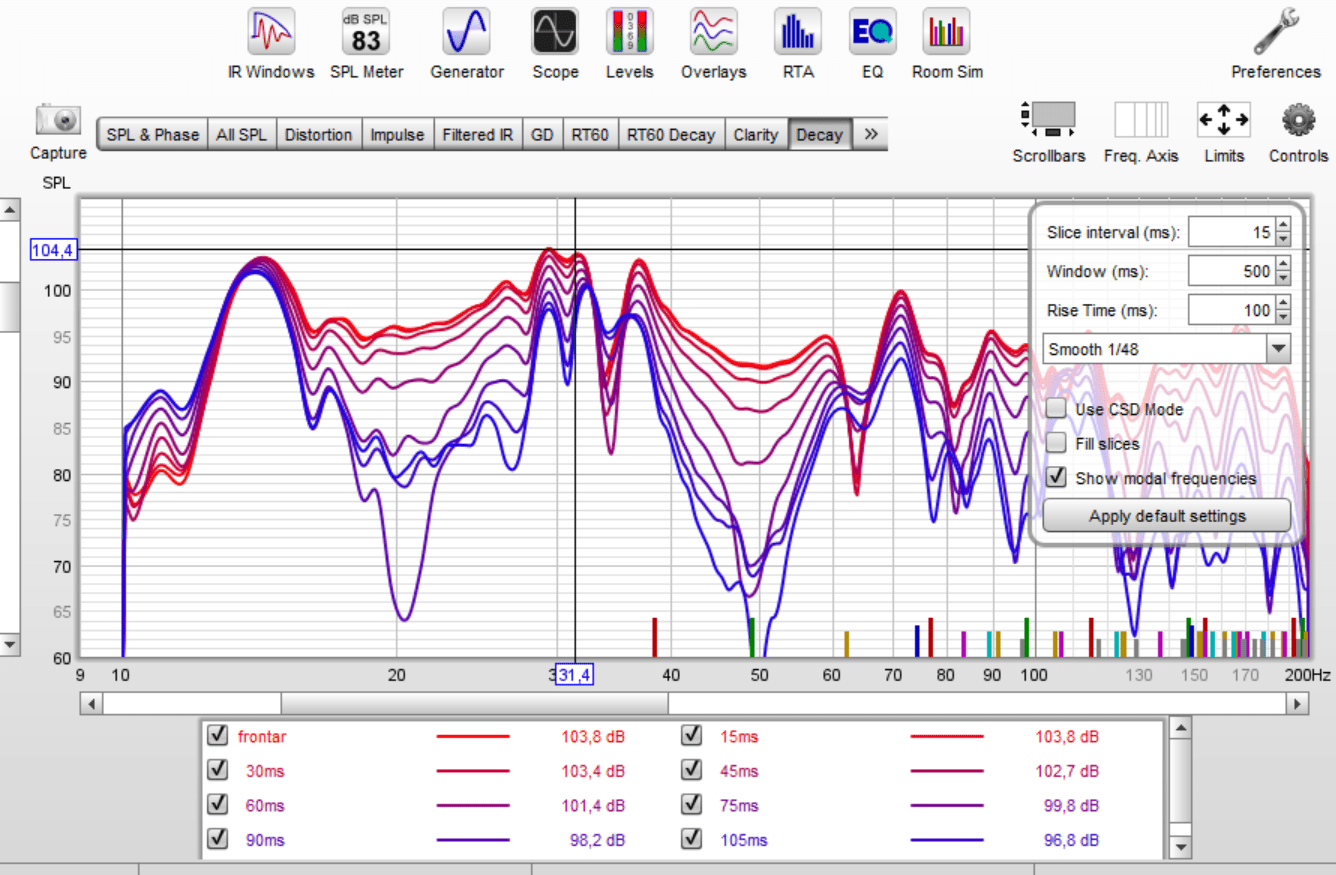

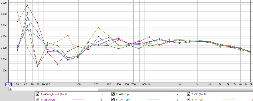

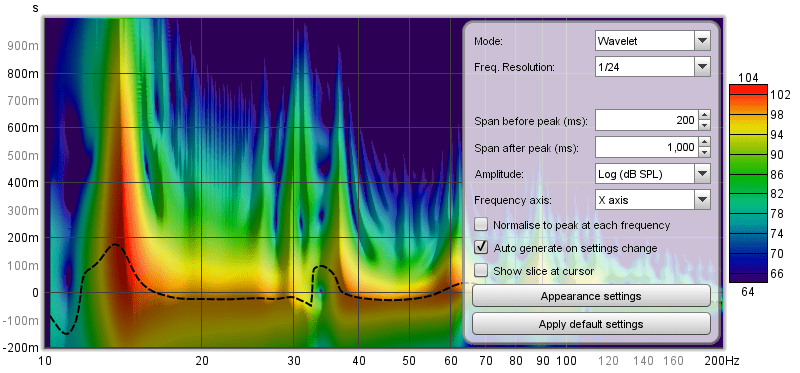

I did a small experiment this evening until I ran out of batteries in the mic preamp. So far, it looks to make some sense in measurements. Evens up frequency response and shortened the decay around 35Hz, which is the standing wave between front and rear wall.DBA = Double Bass Array is the very same concept as C.A.B.S. = Controlled Acoustic Bass system. With more than 1 bass source and using opposite phase and walls + suitable time delay between them, you "kill" the build up of (some) resonant bass modes in the room. DBA would "kill" at the first bounce from the first source hitting the back wall. It may be harder to adjust with mains playing full low frequency + a delayed sub (corresponding to 2 x room length) at the front wall. If you can, why not try.
I was playing around with delays, and ended up with much shorter delay than I expected somewhere around 20ms seems to work, but I was expecting abt 30ms with the room abt 5,5m long. Playing around with a few ms back and forth had some positive effects in some areas, and negative in other.. I was trying to tune it for maximum effect when the battery ran out, so now I put on some music instead, and I had to turn back the gain on the sub. Also played around with LP for the sub, and it seems just 1st order starting at 30Hz blends in best, Tried LR12 & LR24, but the steeper filters made it sound boomy, I'm guessing it's phase integration problems to the main speakers since I tuned the delay with only the 1st order filter. I also have a shelving filter to further compensate for the low end drop off of the sealed box.
I have now dialed it down to a level where it blends in better, and seems to improve the sound when it is unmuted. I'm not 100% I like it though, will need to give it some listening with different music I think.
I attached some of the REW measurements, maybe somebody can tell me more about what to look for I mostly looked at FR and spectrogram, where it was mostly the long tail around 35Hz I concentrated on.
While listening and writing, I have already tweaked the 1st order LP and gain, so the change with the SW on is just quite subtle now. I can still feel the 10" cone move a bit at moderate level though, so it's doing something

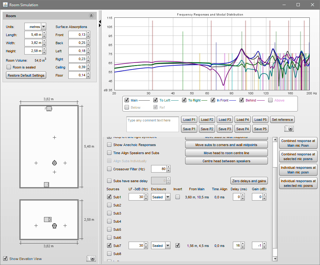

You may play with REW RooSim and see how it works
p. s.: ideal case:
Missed this. Delay must be room lenght (may be ajusted slightly), rear level slightly less than front.I attached
IME first modes and second lenght suppressed effectively.
You can also check how things and ringing turns out with the sub in opposite phase versus in phase with the same time delay applied. I looked quickly at the tab “RT60 Decay” and your measurement no 1-frontar and the other measurements with frontar + inverted sub with various time delays. It seems “funny” that around 31,25 Hz the T60 varies so much, between 1,036 seconds for measurement 10 and up to above 2 seconds for the other measurements. Below are pictures from no 1 and no 2. If you move the cursor from low to higher frequencies in the lower diagram, you can see how Model T60-figures changes depending on frequency at the top.
(In a frequency diagram ist is common to show 50 dB difference between top and bottom. So I changed it to max 110 and lowest 60 dB)

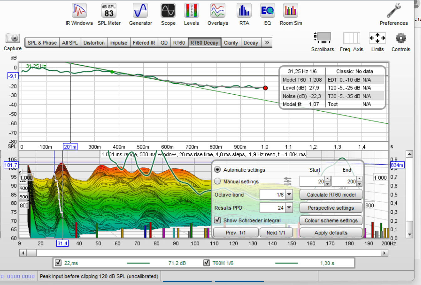

In the Waterfall tab and Decay one, one can notice your room modes with long tails in the Waterfall at around 31,4 Hz and low decrease in dB over time in the Decay tab.
When I am checking if moving the couch / speakers / toe in of speakers makes a difference for early unwanted and strong reflections, I use the tab Filtered IR and set the time scale to minus 0,001 to 20 ms. In mixing rooms for music, a common goal is no stronger reflections than -20 dB within the first 20 ms. -To hear what is actually on the recording without the room audibly influencing much. That is not easy to accomplish in a small living room, so one may have to settle for -10 dB within 10 ms or so. (Some people enjoy quite strong early reflections though, as the soundstage may seem wider, a personal choice.)
Edit the 1st picture is measurement 1, then measurement 2 and then measurement 1 in Decay. I see you need to open them in a new window to read the small text and figures..

I'm planning to do some more testing and measurements later today. I think one reason for the RT60 variations could be low SPL levels while measuring, and varying background noise.
I also found that changing the spectrogram settings to wavelet and 1/24 resolution gives a lot more detailed picture of the decay.
Yes. This can be verified. For exampleI think one reason for the RT60 variations could be low SPL levels while measuring, and varying background noise.
-6 (110-115 dB at LP) is compressed and distorted and #1 is near wall.
Yes. And lower than 1/6 resolution may cause artefucks in peak energy time. Smooth 1/6 peak energy time graph (in combination with other parameters) seems like a legitimate goal, correlated with the audible impressionthe spectrogram settings to wavelet and 1/24 resolution gives a lot more detailed picture
Clear. It doesn't work well even if amplitude and phase responce' are identical. I've read about hobbyists adding an inverted and delayed LF signal electrically to speakers and called this "DBA"just using the main speakers and connected the sub at the front wall, so delay should be double the room length I think

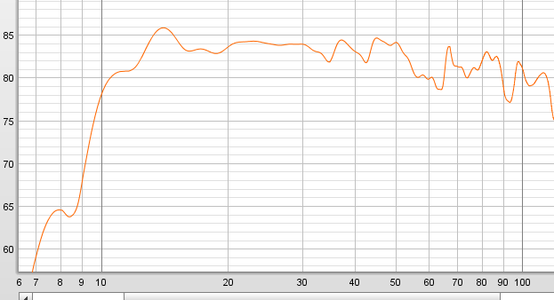

I did some more measurements with the sub at the front wall, but no really conclusive results. Seems phase alignment is an issue. Trying to run it in phase should boost the standing waves I think, but it seems different delays are needed to 'align it' depending on the frequency. I have not bothered trying to measure phase/group delays at the relative positions/speakers and try to puzzle that together some way, I would most likely fail and be in a bad mood afterwards.
Subjectively I think there is some improvement to be had since I can even out the frequency response in the listening position, but at the same time the bass sounds a bit 'muddy', I'm thinking it has something to do with the delayed signal mixing with the direct signal.
I also tried moving the sofa, but there is not so much to gain within the limits I have. I tried moving it forward 15 and 30cm, and the 15cm move seems a bit better compared to the original position in the 100Hz range. #0cm forward introduces new problem, and the overall result seems worse. I base this on looking at the RT60/clarity curves and FR. With the sofa moved 15cms, my ears are now about 1m from the windows behind me.
I also measured with the door to the bedroom (front right) closed, but this created another standing wave around 26Hz, possibly the 15Hzresonance was 're-tuned' to 26 when closing the door. I changed the sweep to start at 20Hz, so I did not see if something happened below 20Hz. There was also more problems around 100Hz with the door closed.
In general, looking a the reverb in the room, it's a mess, or should I say way too much reverb. like 200ms and up.. Lowest in the treble and slowly rising until it goes totally crazy in the bass.
I have now moved the sub to the rear window behind the LP, and just been able to get a cable to reach the sub, hanging in the air across the living room.. will try some measurements on that next..
