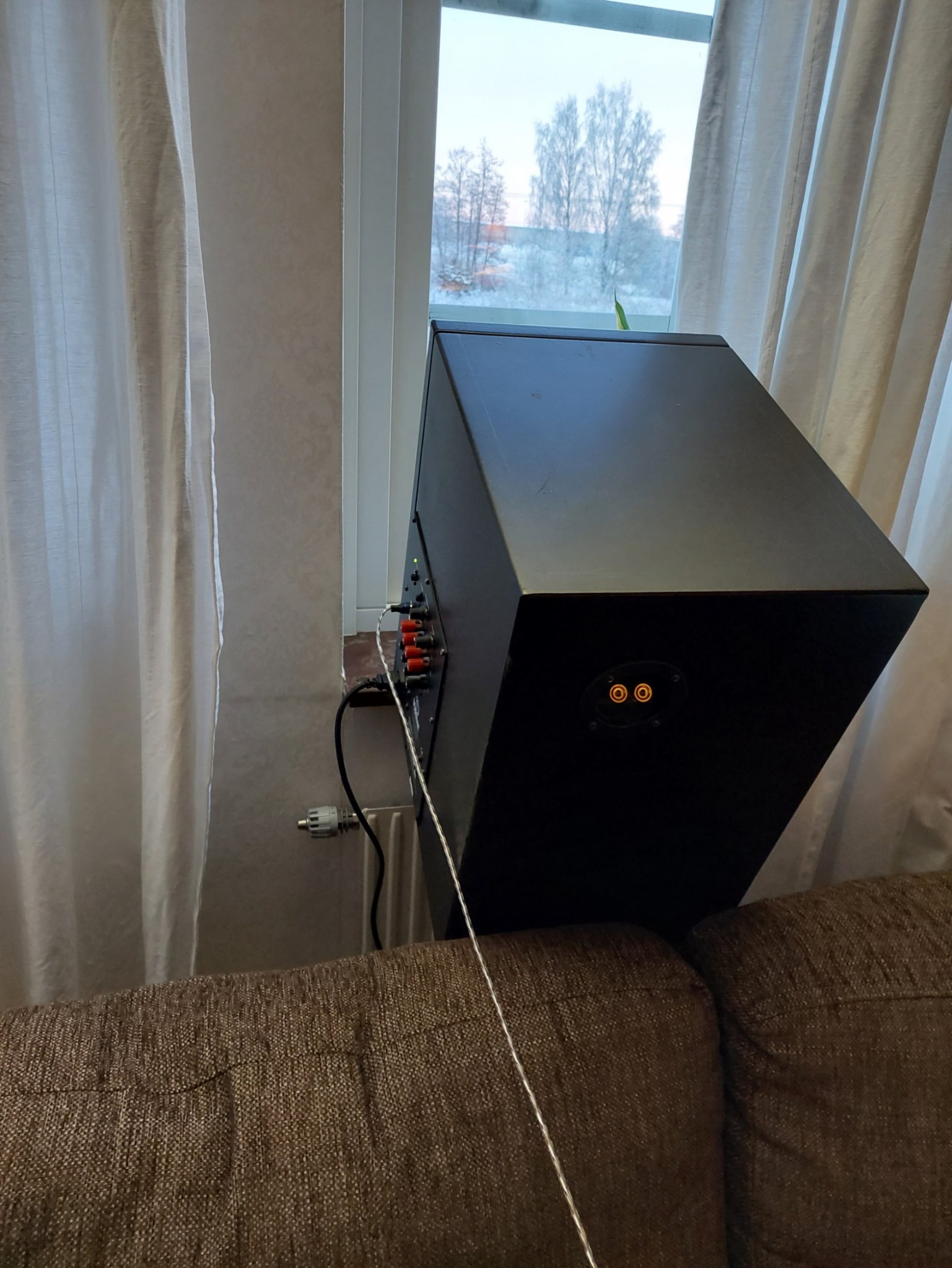

I have tested with the sub moved to the rear, and it's not looking very good either.. Sub is placed just behind the listening position, cone facing the rear wall (window) at abt 20cm distance. I can upload a picture soon.
For some reason it does not seem to do anything about the standing wave, except reduce the SPL.
So this is what I did for the quick test:
I tuned the sub delay for max cancellation at 32Hz by ear, and then muted the sub and ran a measurement with just the fronts, and again unmuted the sub and measured with fronts and the sub.
There is abt -14dB at 32Hz with the sub unmuted, but the decay looks the same anyway, it just starts out on a lower level. So the level is lower, but the ringing/standing wave reverbs the same.

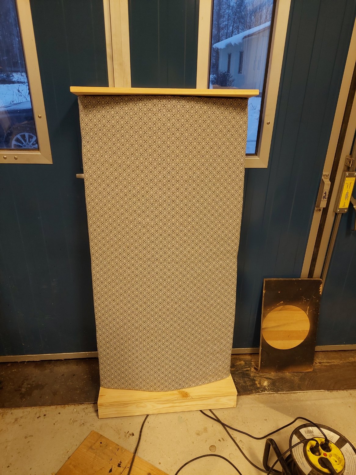

As I mentioned before, I made some experiments with some simple panels in the first reflection points on the side walls. The conclusion is that they seem to work better when angled so they are facing towards the speakers a bit. If I put them flat against the wall, they seem to have less effect. This got me thinking that since it looks too awkward to have them at an angle like that, maybe the ones I make should have a rounded shape to be more effective than a flat absorber against the wall?
So what I'm thinking at the moment is some sturdy metal net in a rounded shape (half cylindrical?) as backing, and the absorbent and some fabric wrapped around that. Maybe put a few small shelfs on it to make it look and function like furniture too.
I'm thinking this could help with the varying listening positions and their reflection points too. When I sit in the corner, the reflection point is further back in the room, but the angle is more shallow, so a rounded absorber sticking out a bit from the wall should 'shadow' this second reflection point better than a flat one. Some added depth should give it some absorption lower down as well.
Comments welcome!

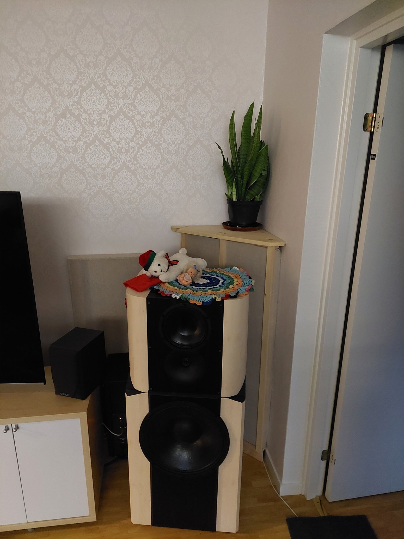

A small step forward, I just put an absorber in the front right corner. Still not finished, I need to make a 'cover' for it that can be used as a shelf and also to seal the top. There is a small piece on top now just as a temporary fix. Need to buy more wood to make one for the front left corner too.

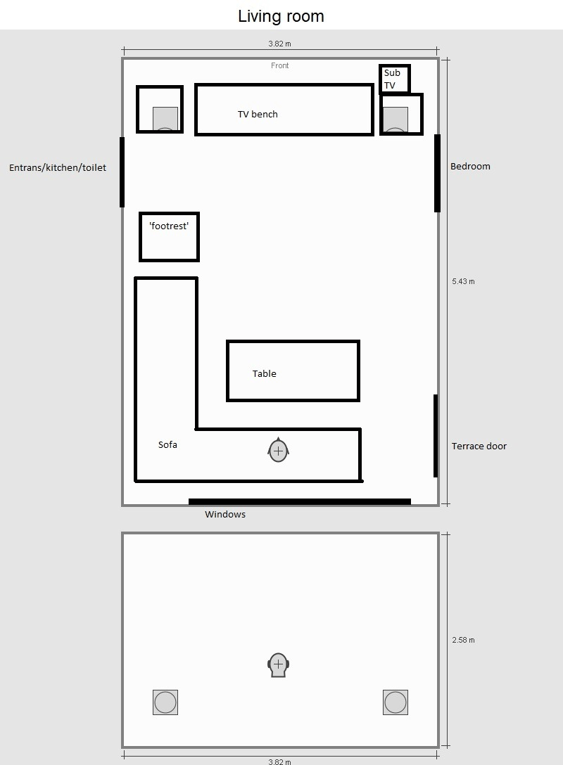

A friend came by to audition the speakers today. I sometimes call him Ernst (Swedish TV decorator) because he's a perfectionist when it comes to interior decorating, and most other things too
Anyway, his suggestion was to rotate everything in the living room 90deg counter clockwise, so the sofa would be between the bedroom door and terrace door. TV and speakers on the opposite wall.
We made some measurements, and it should be possible, but I would have to remove/modify an armrest on the sofa to make it slightly shorter to fit between the doors. Accessing the terrace door would probably be a bit awkward, since it would be 'behind the sofa'.
The listening triangle would be more correct like this, and sitting in the sofa, one would have a view out the window. The sofa and speakers would have to be up against the walls though, and speakers more or less in the corners still. No chance of adding a sub behind the sofa in that configuration.
I'm thinking I could make some extension for one speaker and move just the speakers and sofa to try what it does to the sound. Maybe make some measurements too.
Re-posting the room layout as it is just for reference. Does it sound like a good or bad idea?

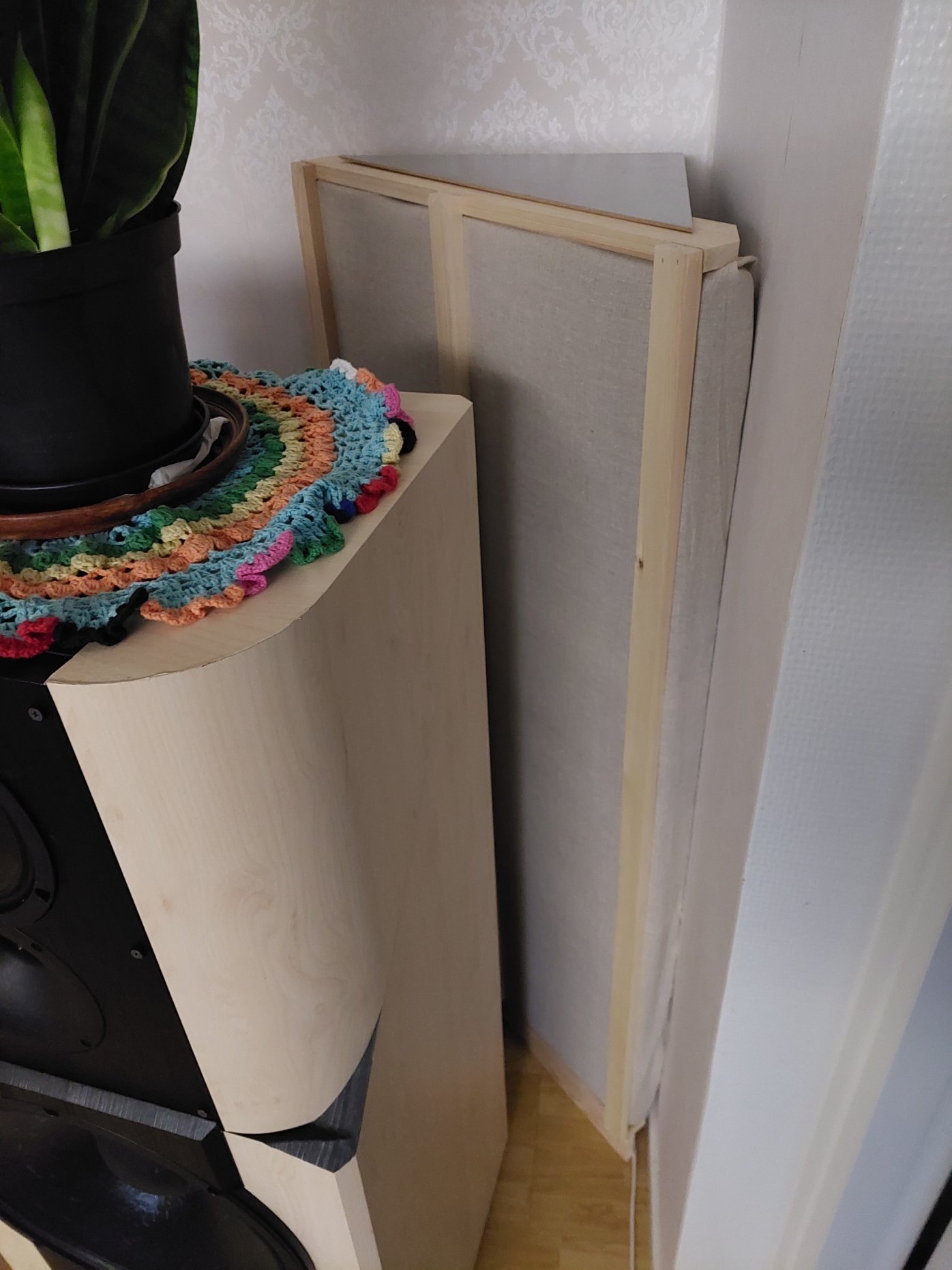

I made one more corner absorber for the other front corner, and also finished the first side wall absorber today.

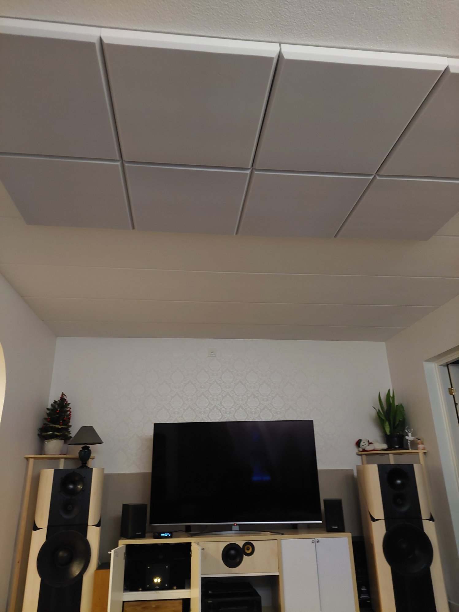

I have been trying to figure out some nice way to mount the absorbers in the ceiling, but today I just slapped them there using some latex glue. I did a quick test in the garage first, and the glue seems fairly easy to remove, but the basotect still sticks well enough to it. Hope they stay up until the glue has dried.. Seems the sizes of the pieces was not perfect, so I ended up leaving some small gaps to get them to line up.
They are offset to the left side of the room since my listening position is either in the middle or to the left.

Dear Rallyfinnen,
I am solving another noise suppression problem, totally unrelated to yours, but stumbled on this thread and... I have a feeling, that you are desperate and solving the problem the exact opposite way you should. I am no expert, but you miss some of the basic principles of "normal living room sound" and do some of the tricks of the studio, but totally miss the others which should be in standard room.
What you want to achieve? A bit of studio sound? A bit of normal room + studio sound? Normal room sound? Normal treated room sound? Just remove concrete wall echoes? There is nothing bad in any of those directions. But if you say the direction - then it will be easier and cheaper, because now you do random stuff. Forget the measurements for the moment.
So:
1. The planning of the room is very bad for music and imho not ergonomic at all. Here is why:
1a. You have a room, which is far from perfect square - a rectangle, and speakers-listening position is on the long ends. You get some of the horn effect, many echoes and so on.
1b. Window on the back of current listening location - nightmare. The back wall from listening position is the one I would try to treat first and maybe the only surface I treat. Massive skyline type diffuser or massive absorber on the back from listening position or nothing, as you sit in pretty big sofa which acts itself as an absorber and bass trap.
1c. The current position is not symmetric, terrace door and its arc on the right is untreatable. You cannot improve or change much accoustics of it.
1d. You have TWO door arcs near speakers: 4 extra corners (we can also count as 8?). This is probably the worst you can have near speakers, as now you get many reflections form the arc surfaces, corners, from another room surfaces and so on
1e. You loose a lot of the first order reflection of sound, as it goes into another rooms. I think around of 20-30% of the direct speaker radiation goes through the doors if I can say in such terms.
1f. Bonus. People go from entrance to bedroom... They definitely obstruct sound. A small thing but still...
1g. Bonus. You cannot listen to the music without bothering others in the bedroom and kitchen...
How to solve everything in "1"? Just move speakers + TV to the right (or left) wall!!! I think sofa can be rotated or you can just sit on the other side of it, right? The only thing you will lose some of the distance between speakers as the doors limit (no such problem on the left wall) but gain a lot.
2. Somebody gave idea about sub under sofa idea - brilliant thing! In my room sofa is in the middle of the room, if I had it near the wall the first thing I build the narrow transmission line sub to put under it. Volume knob will solve all the doubts about it being too loud. As a bonus - if you have sub ~1m from listening position, most likely it will have the phase you need and sound exactly the way you want. It is a half day work with beer bottle in hand to put wires behind skirting boards.
3. I cannot understand the size of the table. Is it big? Massive? Does it obstruct speaker drivers directly? Now it is as an additional surface which needs to be accounted for. I really doubt that it makes positive impact. Smaller table between listening position and speakers - better.
4. You have too little big dimension massive objects in room. I can count just 2: sofa and TV table with stuff in it. Absolutelly a cool thing you did with making sofa more massive and absorbant! No way you will make or want to make artificial sound absorbing panels of this size and weight, so Ikea bookshelf with books and random stuff on the current wall where now speakers are, could act as a diffuser and bass trap. Can be closed with some doors or open - does not matter much. Also for example a big pot (20+ liters, the more the betters) with plant in it could help on the corner near terrace door. If we assume rule of thumb that we need at least 1/4 of the wavelength size objects in corners to deal with reflections, then for 100Hz it is ~85cm, for 200Hz it is ~43cm. Imagine the face of your darling when you put acoustic panel of 40cm thickness on the wall... As a bonus: exacly on the opposite side is window, which also lets some low-mid freq sound out of the room - so you may gain some symmetry.
5. You already are putting some acoustic traps behind the speakers. Remove them! In this configuration it is the ONLY normal wall you have in entire room and you are ruining the reflections from it. In this configuration I would try to put them on the ceiling corners near terrace door and another corner behind listening position.
REW is a nice tool... I measured my own room... It is a nightmare, more than yours, but for different reasons, but I also have many arcs of windows, many corners, also big coffee table and so on. In your case just 1 move could solve the biggest problems, I don't have such opportunity. If you have doubts about my suggestions - you could paint with pencil arrows of "sound" every lets say 30 degrees from speakers with 3-4 reflections. In 3D - with imagination probably. Be honest: reflections form arc corners near sound source and windows not work well.
Wish you success!
