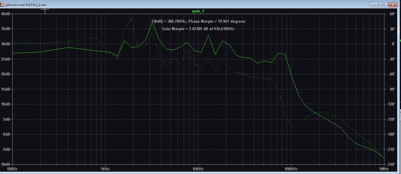

I noticed this also when using a working amplifier circuit and the Tian probe wouldn't run. I discovered there is a new way of performing loop analysis. LTspice now uses a new parameter and symbol called .fra. You can find the symbol via >edit>component
There is an op-amp example on your computer in this location-C:\Users\username\AppData\Local\LTspice\examples\Educational\FRA\fra_eg1.asc
I added the .fra parameter to your circuit, it seems to run okay except it couldn't calculate the gain margin because the phase response didn't cross 180degress, it runs fine using the Tian probe in the older version of LTspice.
I'm not a expert at this and can't be sure if I had the .fra parameters configured properly. The .fra parameters can be changed by right clicking on the symbol.
I found it was helpful by having the old version of LTspice to compare the loop gain responses so I could change the .fra parameters to match those of the Tian probe.
There is also additional information in the LTspice Help Topics.
Additional Information
I found using the .fra parameter frustrating, it's really time consuming to get the parameters set correctly so the analysis runs properly and when it does run its really sloooowwww. If you don't have a circuit where you know what the gain and phase margins are from using the Tian probe in the older LTspice versions then you'll have great difficulty in determining whether there is something wrong with the circuit or if the .fra parameters have been configured incorrectly.
As an example the attached ltspice circuit has a weird phase response using the .fra but runs fine using the Tian probe. Am I doing something wrong.......maybe someone else can work it out.
Users should keep LTspice V17.0.36.0 on their computer so they can continue to use the Tian probe for loop gain analysis.

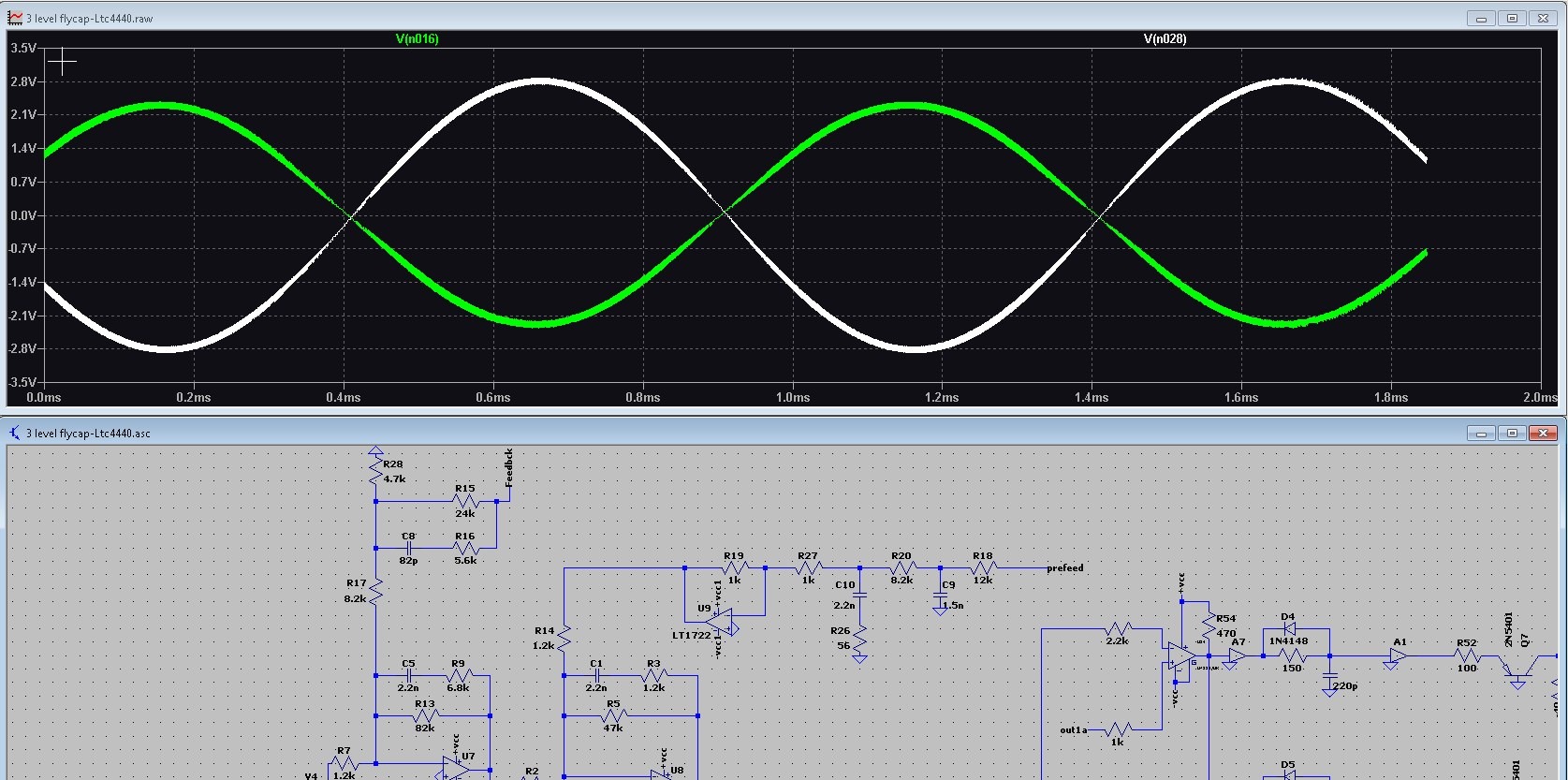

Hi All.
I even did not now this version was present, did discover after search for a way to do open and closed loop sims, I came here.
After install, and uninstall of the old version I have now set the new simulator up and is working.
I saw direct it was much faster and cleaner, the simulations looks much better.
I just need to learn how to use Fra for openloop gain simulation, but this new ltspice can do much better with class d.

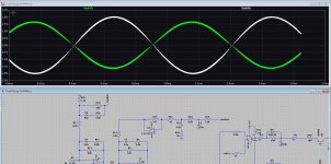

Hi Here.
I have question about FFT I get such a peaky result, the same when I do normal FFT on standart and do not use blackman-harris
and 5 what I normal do, with the open loop.fra I can not change that and so get peaky result who looks bad.
Can I setup this?
thanks.
