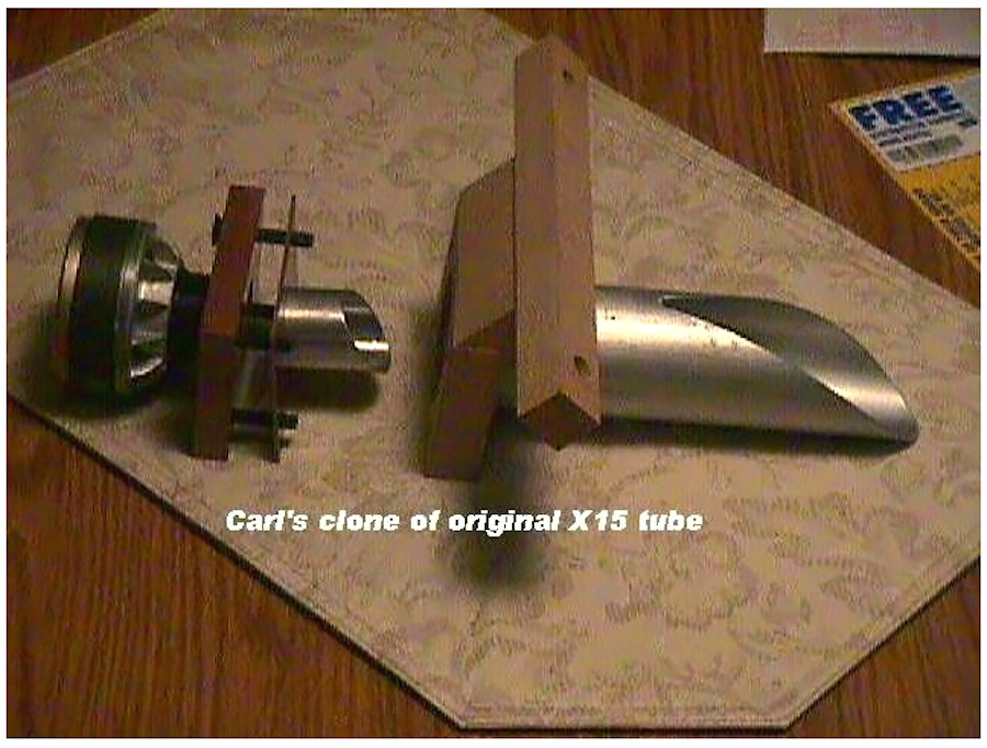

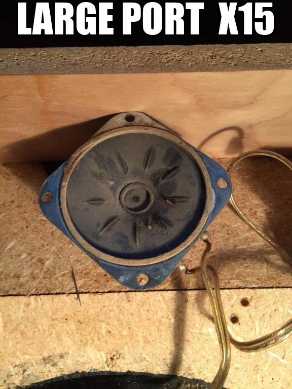

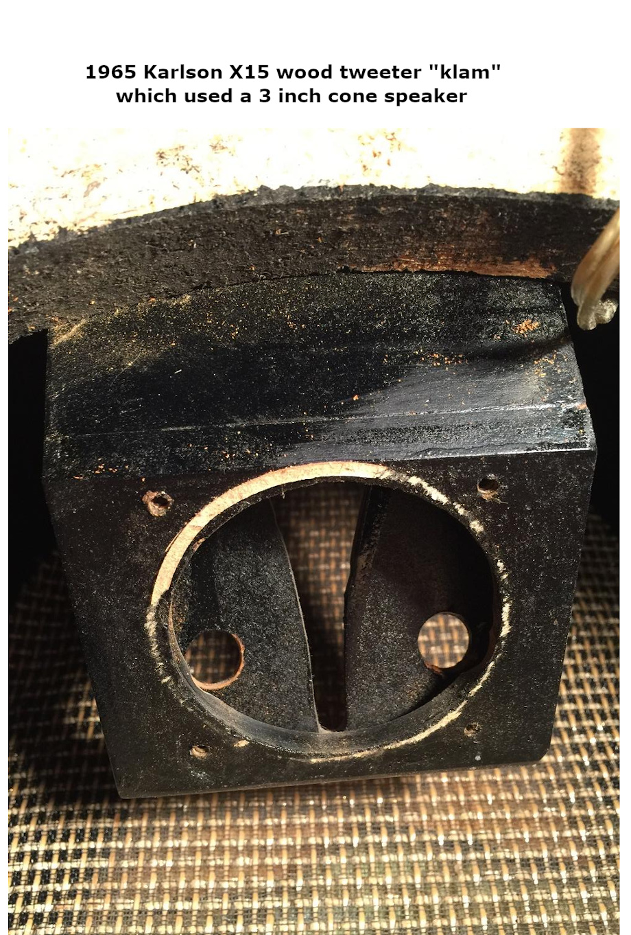

Karlson X15's First Tweeter
used a 3 inch cone speaker, looking like some of the Quam brand tweeters of its day, but in an open back frame. A Styrofoam coffee cup was used as back chamber
The aperture appears to be radial arc - there were two 1/2" diameter holes spaced 2 1/2" apart.
It mounted to the lower panel of the 3-panel reflector.

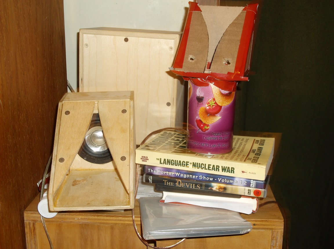

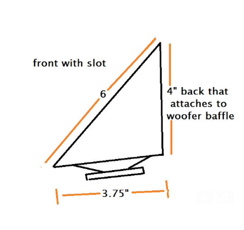

Freddi, is there any sketch of the small klam? Is it similar to the one I tried to design for 3D printing? My large printer is getting back online soon, so I should re-visit this little project and print it in full size with improvements so that it can actually be printed (or print it in two halves worst case).
you'll have to make a sketch. Its triangular, and the front either 7 inches in length (from David A. Young) or 6 inches (?) which was the dimension given for the one in the X15 pictures above. Width was 3.75" and the speaker baffle square so 3.75" x 3.75". The slot appears to have been radial arc based and there were two 0.5" vent holes spaced 2.5" apart center to center.

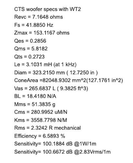

Hi EddieT in today's market I'd look for a 15 inch driver with moving mass between 50 and 75 grams, a rising on axis response could be useful.
Although with significantly higher Qts than Karlson’s CTS 15” speaker, an Eminence Delta 15A may be a good match - it may have been the speaker John Lapaire preferred in a copy of X15 (just wrote to him - hopefully a reply)
https://www.eminence.com/pdf/Delta_15A.pdf
Kappa 15A should be good and kicky - I'm not sure how to deal with its peak - GregB said for some reason it was inaudible in K15 and certainly in the big "Artichoke" Burning Man horn.
https://www.eminence.com/pdf/Kappa_15A.pdf

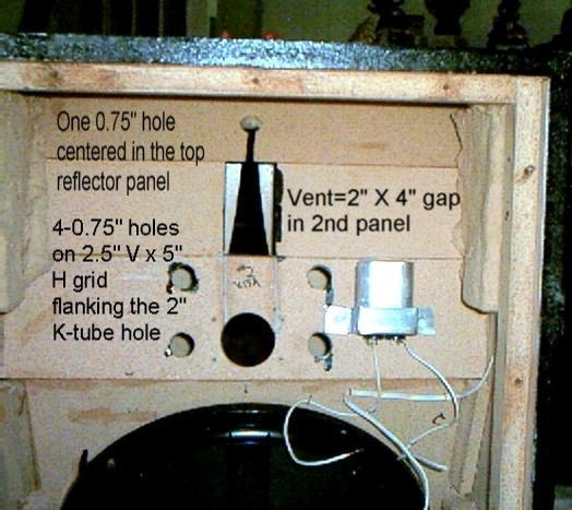

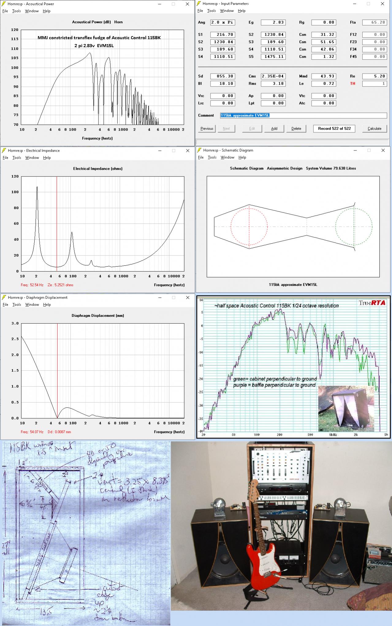

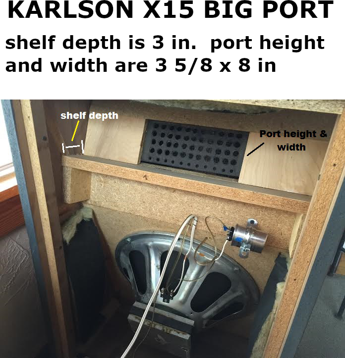

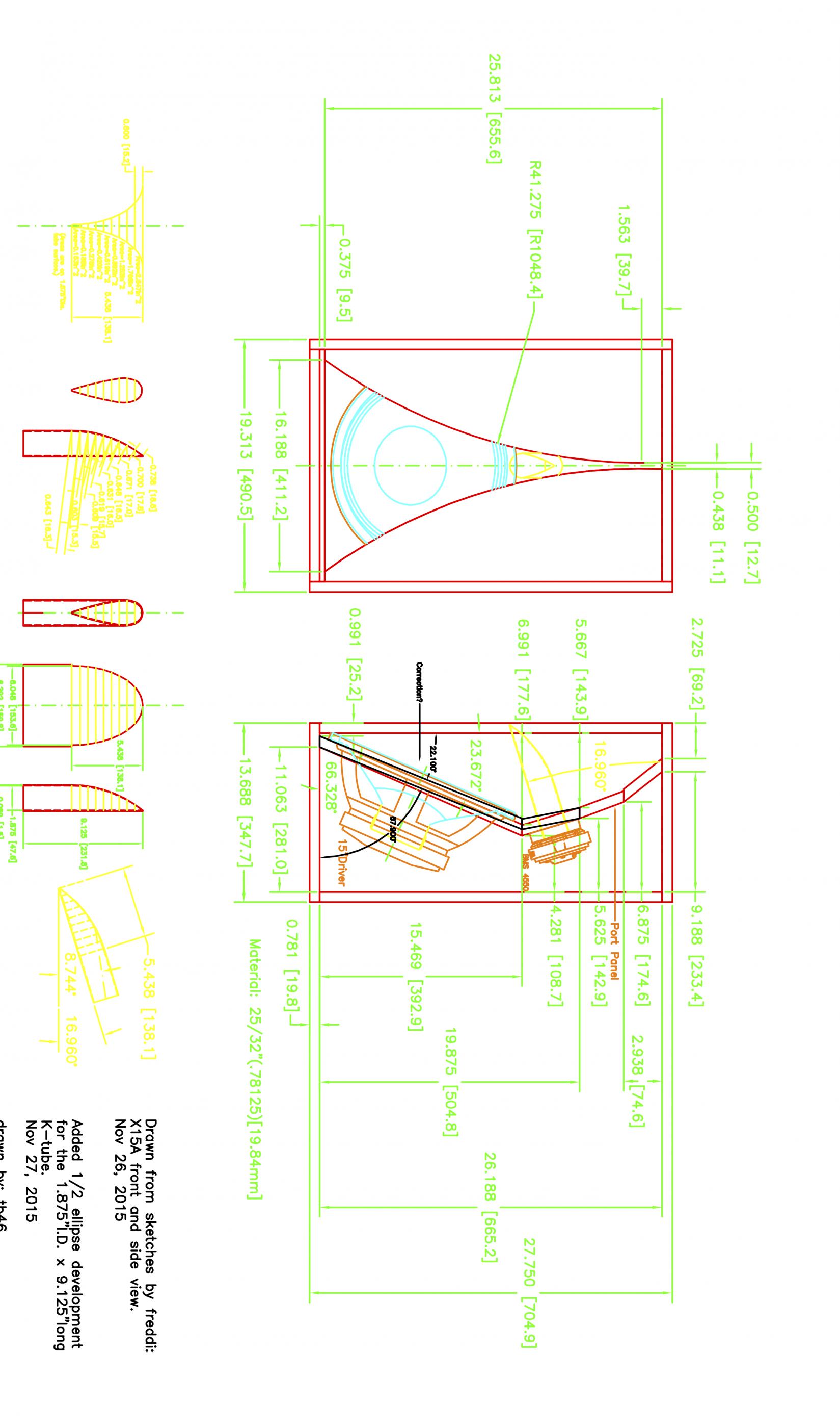

The big port X15 had the same 3 panel reflector as my X15, but wider. Its port area was very close to that of the later Acoustic Control 115BK/BC2 K-coupler.
115BK is a very nice little cabinet which measures smooth and it tuned to about 53Hz.

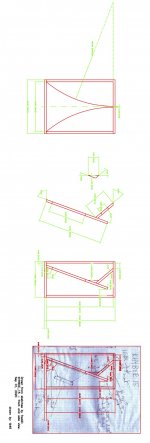

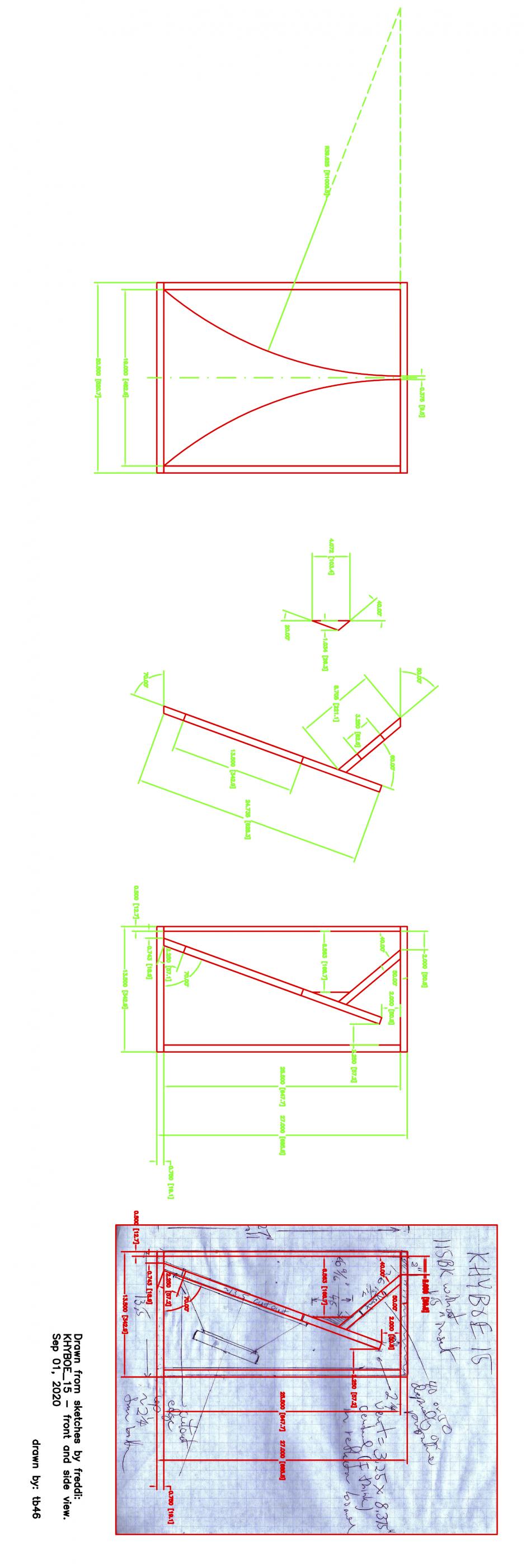

FWIW I would consider building X15 size with a simple port board like "this" as drawn by TB46. Then again, Carl Neuser built X15 with a fully curved bent wood reflector and said that was an improvement in sound quality over the approximation.
Also, here's TB46's drawing of Acoustic Control's 115BK

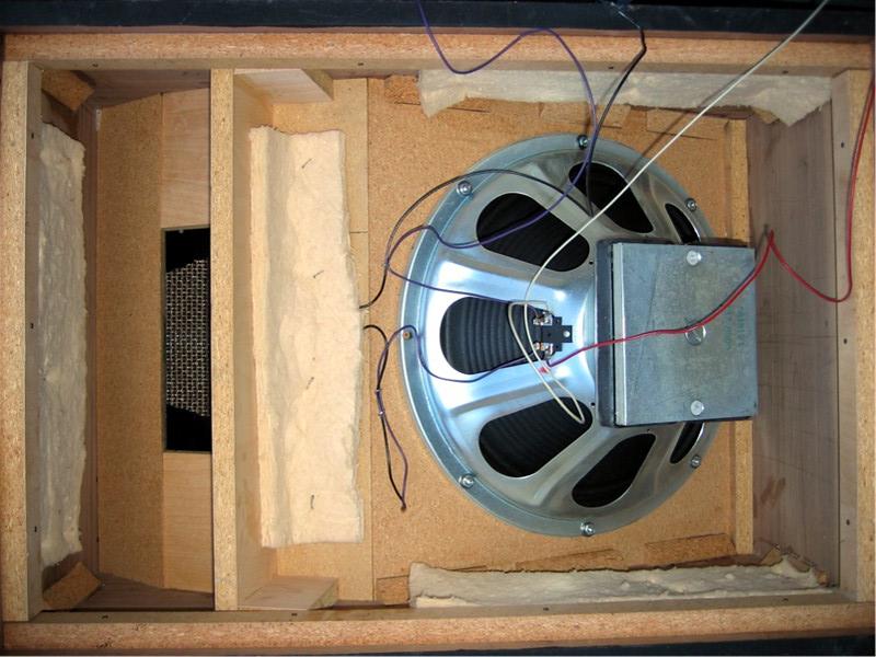

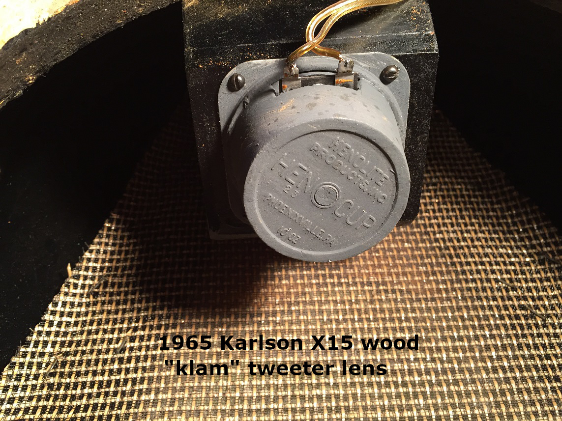

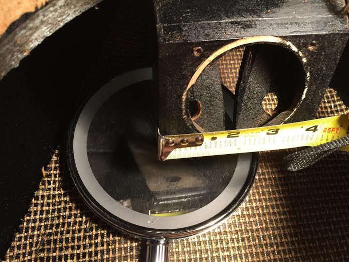

Hey Pelanj and EddieT - does it look to you from the photos above that the tweeter klam is canted "forwards" ?
Here's the 3 panel X15 reflector - one can see that the back chamber seems to hang within the speaker baffle's cutout
I think, but am not sure that the little wood tweeter klam attached to the lower reflector panel (?)
To be honest, I am now completely confused on how it was mounted. Was it in front of the woofer on the top? Then the baffle normal would be actually pointing into the narrow part of the front slot? And I see my test model has the k-slot turned upside down
Edit: Fixed that.
Edit: Fixed that.

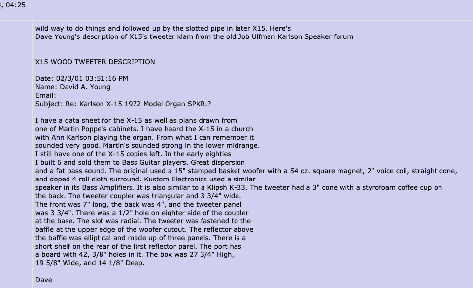

Here's David A. Young's description from a 2001 post at Job Ulfman's Karlson Speaker forum which sounds like the mini klam was attached to the speaker baffle. Since David was familiar with Poppe and apparently, the Karlsons, perhaps his 7 inch measurement is the more accurate, assuming not varying from cabinet to cabinet. Its interesting that Poppe's X15 was tuned with such a resistive vent.
Date: 02/3/01 03:51:16 PM
Name: David A. Young
Email:
Subject: Re: Karlson X-15 1972 Model Organ SPKR.?
"I have a data sheet for the X-15 as well as plans drawn from
one of Martin Poppe's cabinets. I have heard the X-15 in a church
with Ann Karlson playing the organ. From what I can remember it
sounded very good. Martin's sounded strong in the lower midrange.
I still have one of the X-15 copies left. In the early eighties
I built 6 and sold them to Bass Guitar players. Great dispersion
and a fat bass sound. The original used a 15" stamped basket woofer with a 54 oz. square magnet, 2" voice coil, straight cone,
and doped 4 roll cloth surround. Kustom Electronics used a similar
speaker in its Bass Amplifiers. It is also similar to a Klipsh K-33.
The tweeter had a 3" cone with a styrofoam coffee cup on
the back. The tweeter coupler was triangular and 3 3/4" wide.
The front was 7" long, the back was 4", and the tweeter panel
was 3 3/4". There was a 1/2" hole on eighter side of the coupler
at the base. The slot was radial. The tweeter was fastened to the
baffle at the upper edge of the woofer cutout.
The reflector above the baffle was elliptical and made up of three panels. There is a short shelf on the rear of the first reflector parel. The port has
a board with 42, 3/8" holes in it. The box was 27 3/4" High,
19 5/8" Wide, and 14 1/8" Deep.
Dave"

years ago I tried to mock it up in cardboard but did not have a strong 3" driver plus the back chamber obviously was larger than the truncated coffee cup

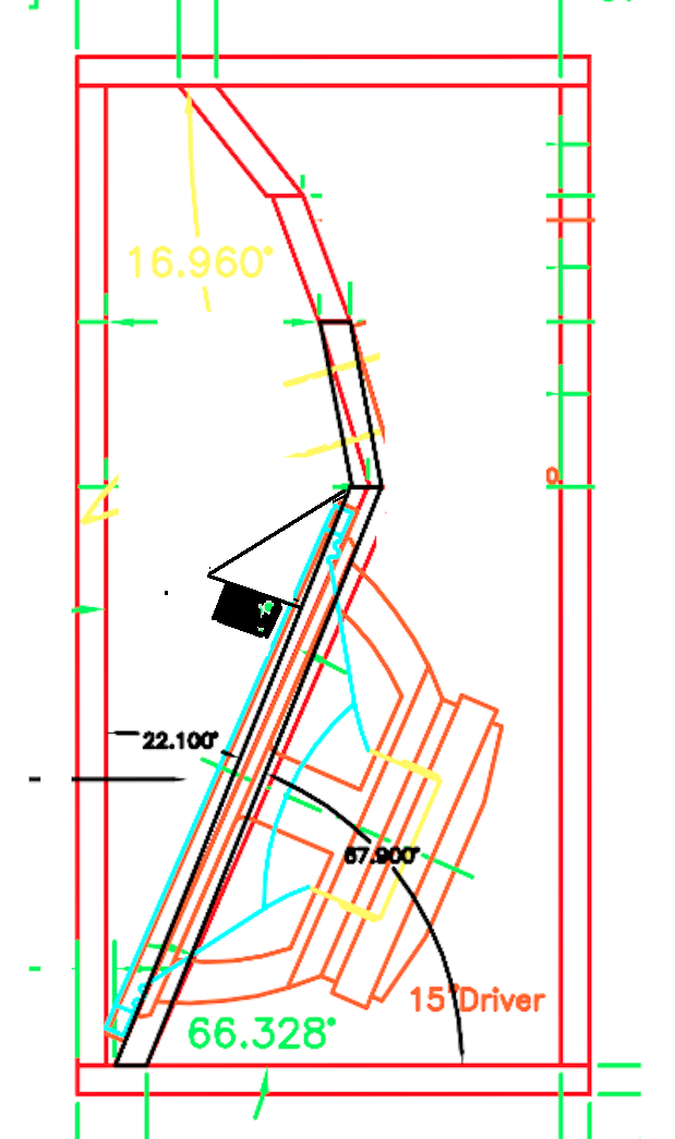

Being attached to the upper edge of the baffle is interesting. That baffle leans back from vertical ~ 23 degrees which means a lot of the tweeter's energy would have been bounced off the reflector and some fired at the narrowest part of the main aperture - right ? (the concept is konfusing)

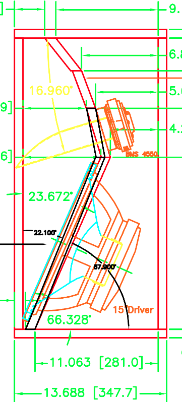

something like "so" ? - be nice to have it drawn to scale. With a K-tube in the X15, there's a fair amount of energy
propagated at right angles to the slot plane which is also reflected from the 3 panel ellipse approximation reflector.
(Carl Neuser says a fully curved reflector is an improvement yet over the approximation)

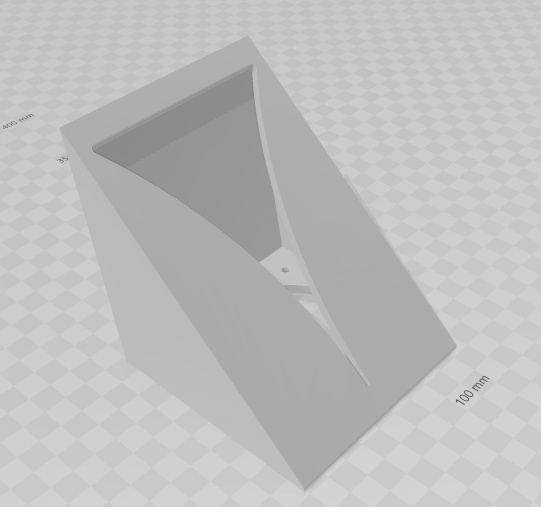

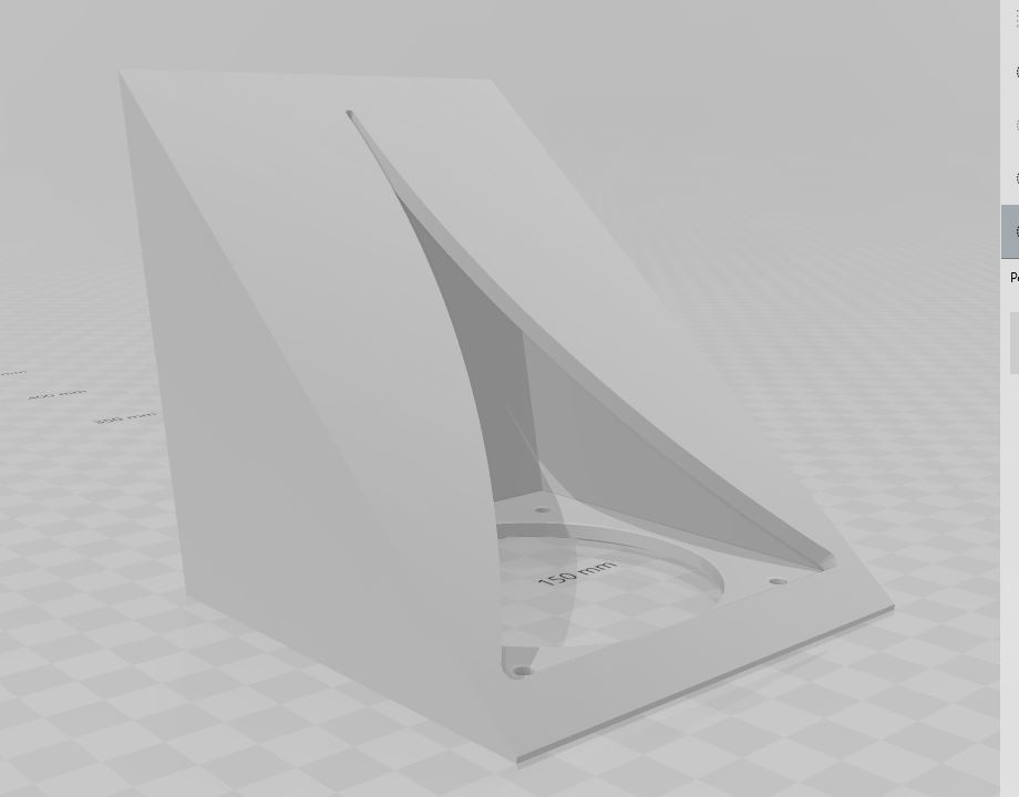

Confused about mini-Klam positioning.
Hi freddi, looking at pelanj's 3D model in post #6, shouldn't the K-slot have the narrow end at the speaker, and the wide end away from the speaker? Oh, just saw pelanj's post #12, so that's fixed. Also, I can't get my head around how this is mounted in the Karlson enclosure. Is it mounted above the driver on the driver baffle board, partially overlapping the 15" driver? OK, just saw post #16, now, wouldn't it be better to have the big driver inserted from the back? Still somewhat confused. Help.
Hi TB46
I think the four inch side attached to the main speaker baffle - one can see the aperture of the tweeter klam pretty clear and the way
it hung a couple of inches below the woofer's nominal 13.3 inch cutout.
At first I thought this tweeter klam was titled forwards by bumping against the lowest reflector panel but guess the four inch sided flush against the upper part of the speaker baffle would work out correctly - look at the front view of the baffle with that Quam or whatever brand 3 inch speaker. Maybe those holes and ones unseen to the left held metal brackets to secure the little klam to the baffle.
How thick does the wood look to you ?
hi pelanj and TB46
- that is quite an angle considering X15's 23 degree baffle tilt. The highest F's would go pretty much "straight" down the klam and bounce off the reflector.
Amazingly enough, some high F stuff can get to and out of the narrowest portion of a K's aperture. The fact that is was considered to sound good as Ann Karlson's organ speaker is intriguing. I'd guess the 4 ohm version of 3FE22 would be one of the hotter 3 inch fullrange available today, and should be more comfortable with a low crossover point than 1 inch format compression drivers which reach 15-20KHz.
