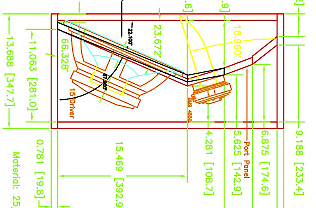

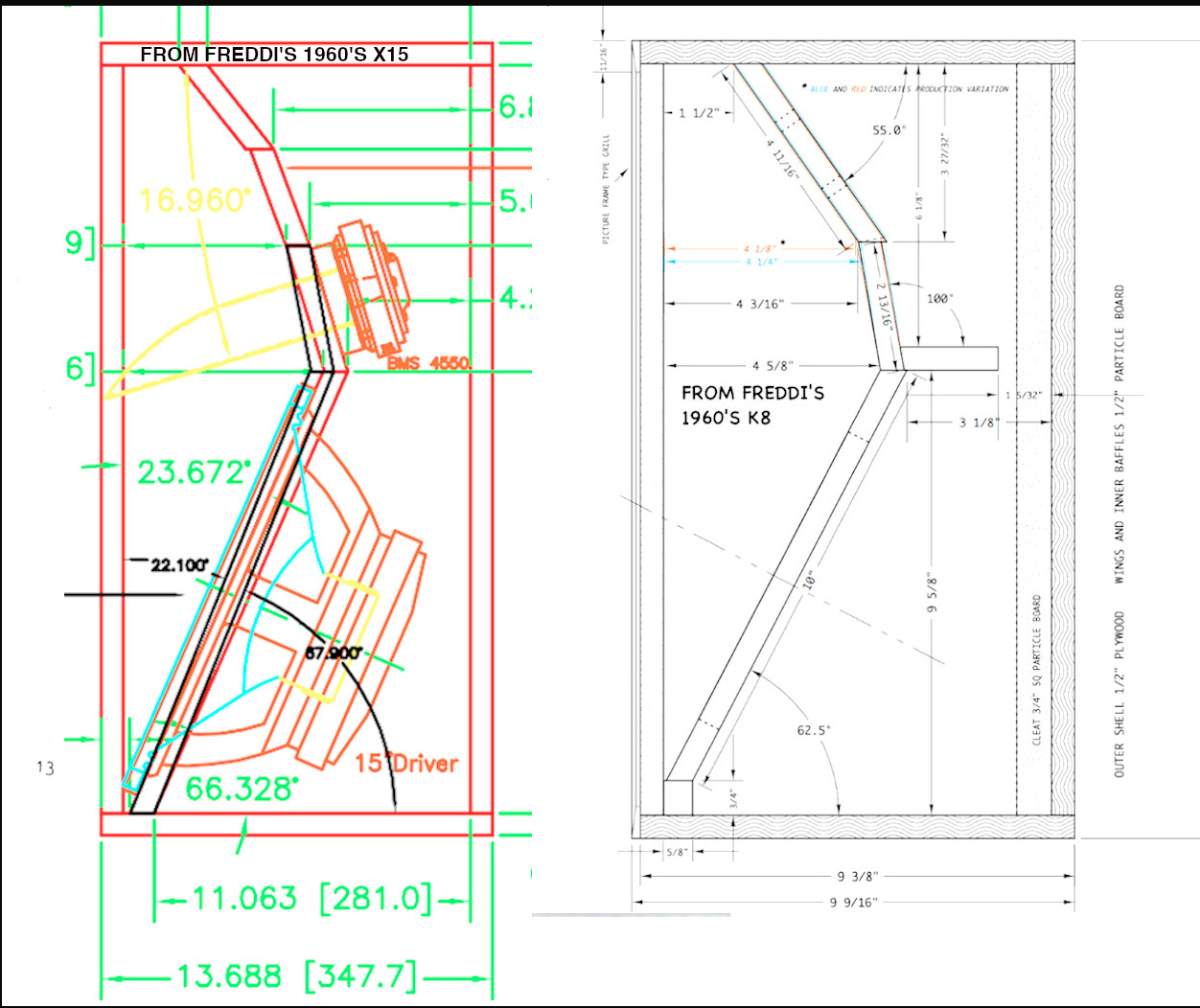

Hi freddi, looking at pelanj's 3D model in post #6, shouldn't the K-slot have the narrow end at the speaker, and the wide end away from the speaker?

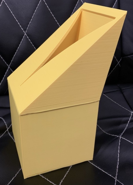

Back cover printed. To print a pure cube is not the smartest thing to do, but it will serve its purpose. I hope I will be able make some acoustic measurements on Wednesday.

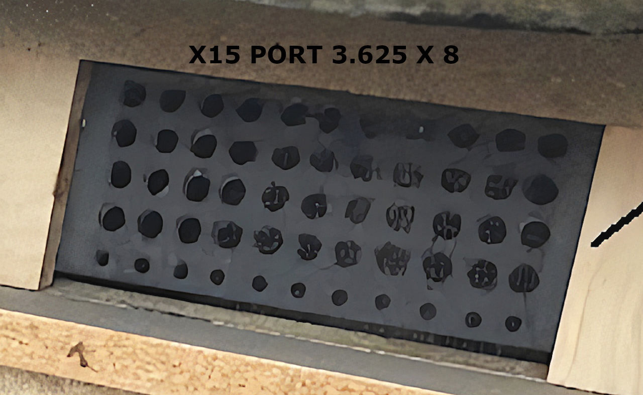

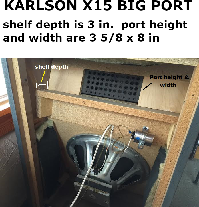

Pelanj - as long as that's loud enough to keep up with a woofer like in X15, then should be fun. I've gotta have one - probably with the two 1/2" de-Qing holes.
Speaking of de-Q-ing holes, that one X15 with large cutout appears to have a resistive holey vent with grill cloth, crammed into its opening. Another X15 with the same opening but a little exponential horn mounted in its chamber (and also pointed "UP", did not have this feature.)

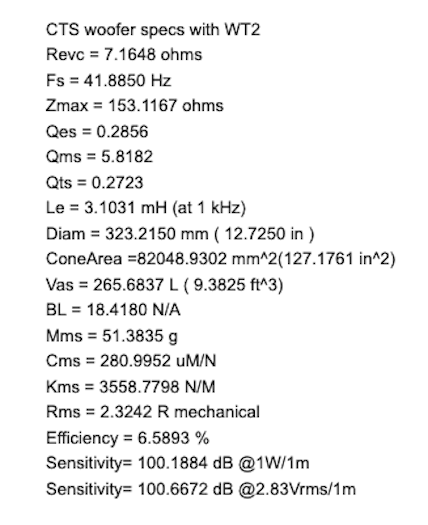

Q wise, that CTS15 was pretty strong - its voice coil inductance was a bit on the high side.
(that board appears to be "Masonite") A board like that covering K15's vent might be helpful with higher Qts drivers - if one wants a dry-taut sound on drums.
I figure X15's CTS organ speaker had a double layer coil to lower Qes, with tradeoff of higher Le. It was run fullrange in X15.

I will share the STL once I make it nice - with radii at all corners. Holes are no problem, too. I hope Fusion360 will be useable for this even after 10/1. What would be the best way of mounting these? I can add mounting tabs anywhere. The prototype will be just put on top of the K15 clone I have. But I am afraid that it will not keep up with the woofer.

I'm hoping Pelanj feeds enough power to his 3D printed X15 klam tweeter lens to have it keep up with the woofer.

I wonder if that one X15 with large vent stopped down with a resistive insert board is just like the one used by Ann Karlson for electronic organ?

Here's the detail on that factory X15's port board - looks to be hardboard aka "Masonite"
I'd imagine under hard drive conditions, the port would "choke" cease any useful output, lower Z peak
would nearly disappear, leaving an impedance for a short time looking close to "aperiodic"

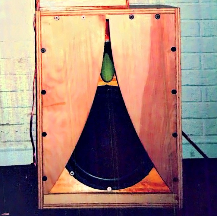

The X15 is one proper way to make a 2-way. A simple 1 inch inside diameter pipe with half - ellipse based slot ~5.3" long and 1/8" gap at the start of that slot makes a fine K-tube which can be mounted directly above the woofer.
Below is an original X15 K-tube mounted in Carl's early approximation of the X15. Its apparent from another X15 with much smaller diameter pipe that John Karlson was experimenting with different diameter pipes and different slots.
The green stuff inside the K-tube is some sort of damping compound.

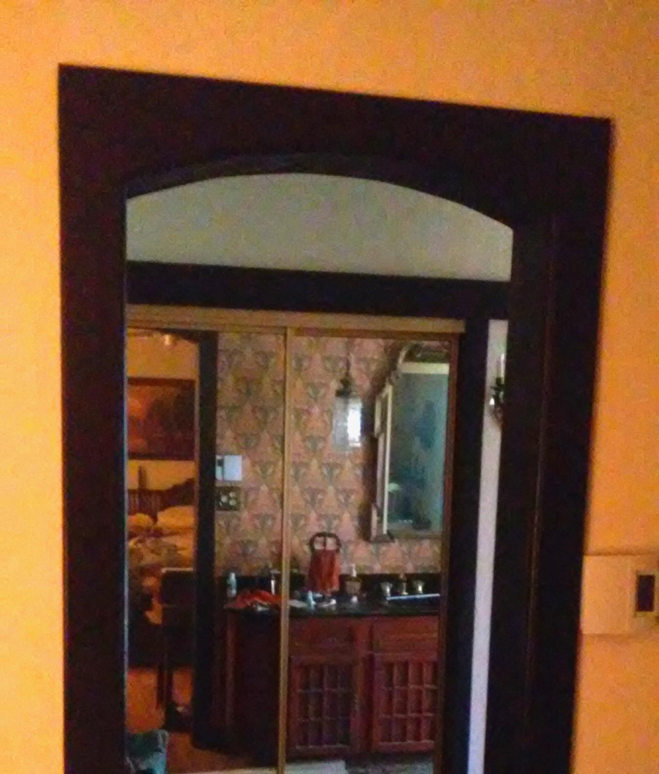

When I built my house I did a couple of arched doorways by kerfing the back side of ½" plywood. One could try something like that for small cabs maybe filling the kerfs with caulk. For a 12, 15 or 18 cab maybe use ⅛" ply layers and glue up to desired thickness.
