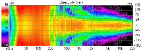

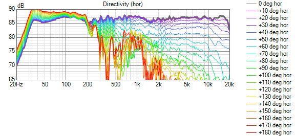

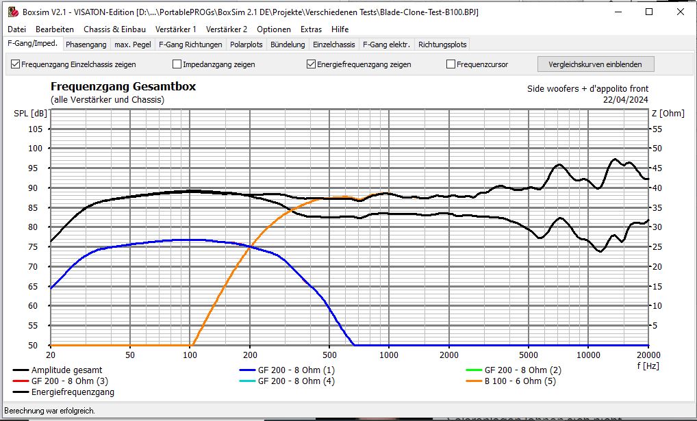

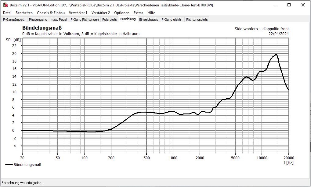

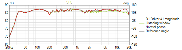

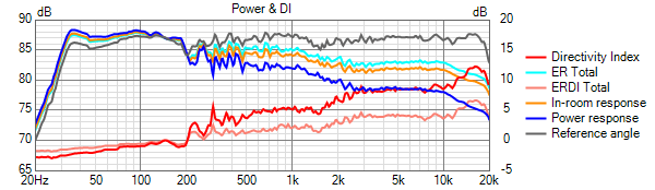

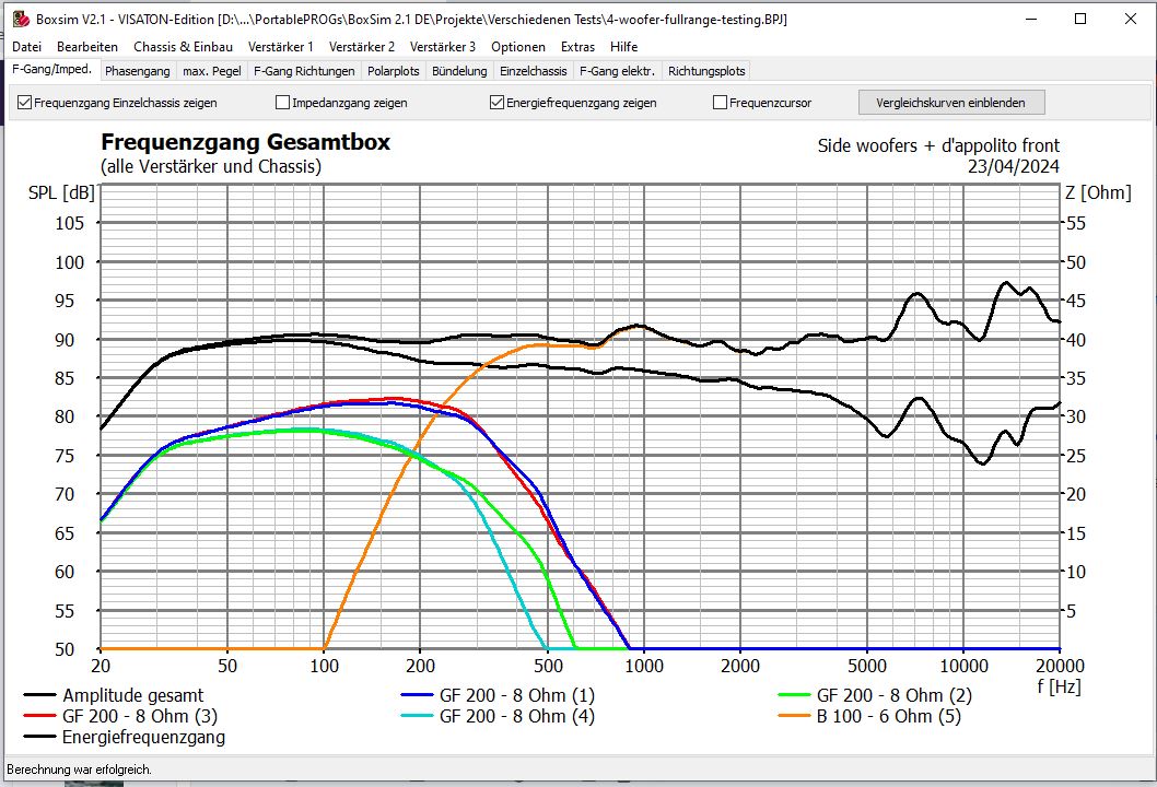

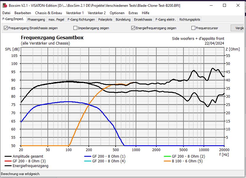

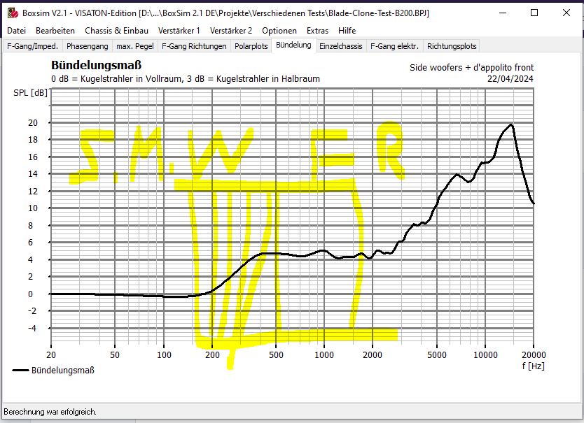

Blade is a midrange / high range coax with side mounted woofers, Visaton do not have a coax so i have taken an MTM, the interesting part of the directivity index diagram is related to the side mounted woofers

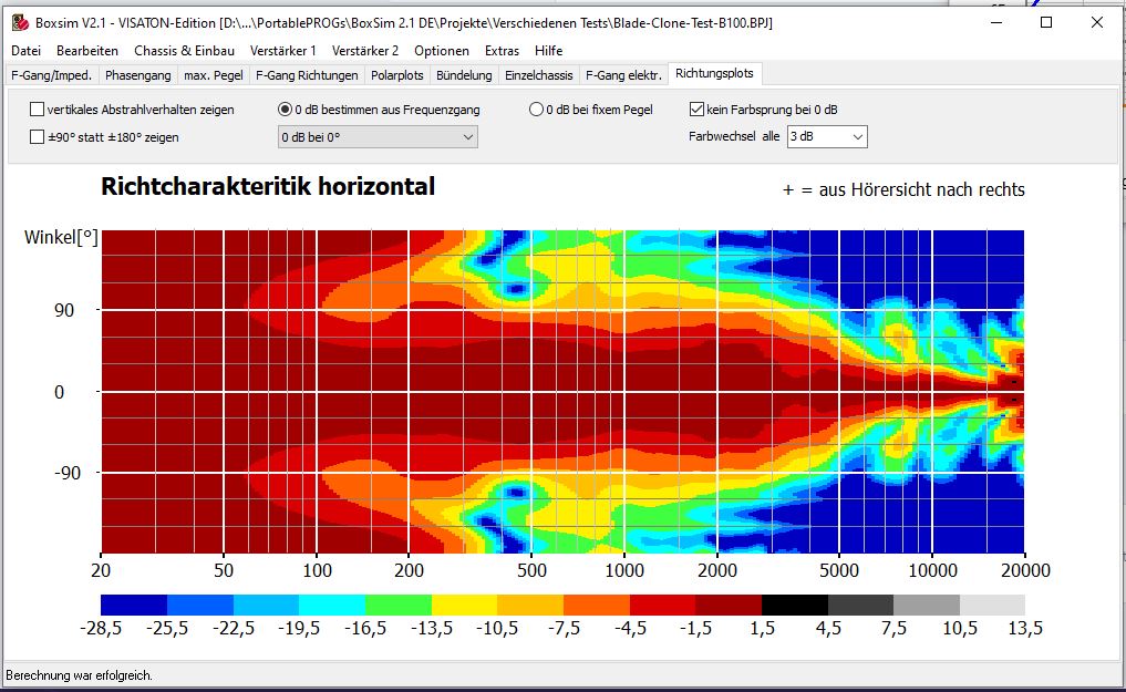

I post here the variation with one B100 as fullrange as better simulation of what the Blade coax will do - it gets even worse with the directivity plot
the Blade comes with a passive crossover, no chance to play around with delay or FIR filters, this has been done with the LS 60 that probably do not have the directivity plot screwed between 200 and 500 Hz, see also the SPL change in the estimated energy frequency response on axis, side woofers works in my eyes only up to 200 Hz with this shape of enclosure

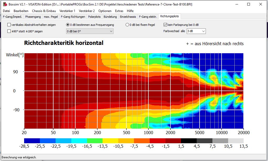

We've got measurements of what it will do. https://www.erinsaudiocorner.com/loudspeakers/kef_blade2_meta/
How can they not be more accurate than your predictions with the sims?

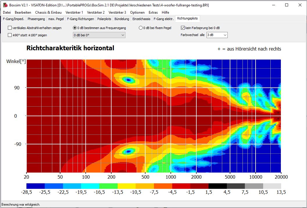

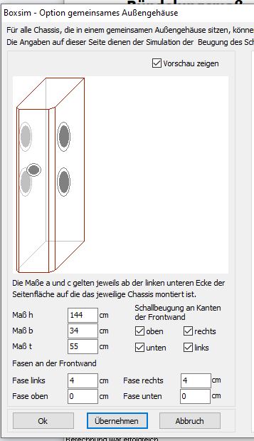

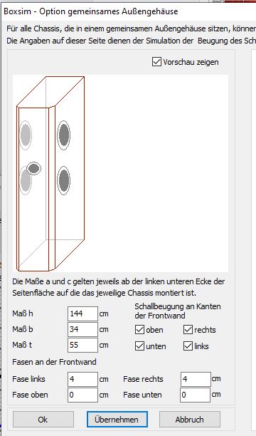

Here my answer comparing with my sim

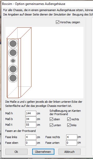

A ) Blade clone graphs
B ) Same thing with front mounted woofer drive units, well looks a little bit like the Reference 7 and not the Reference 5
just the position of the woofer makes the difference - i don't care about Erin's corner - i want to see the difference between front mount and side mount of exactly the same drivers in the same enclosure shape

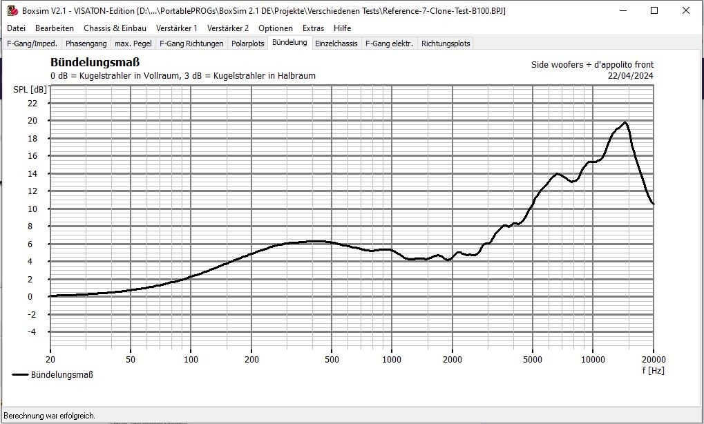

here the best directivity representation that you don't have with Erin at all first graph for A ) second graph for B )
hope it helps, Stefano
P.S.: executive summary - the KEF Blade is a design thing, technically speaking front mounted woofers make less trouble
For me, the charm of the blade is in the horizontal and vertical directivity (quite identical). And you can shove aside the measurements by Erin, but the directivity index in real life looks way better than your sim does. Not for one minute do I consider the Blade a design thing. Even the shape of it is functional.
If your simulated DI does not look like what Erin measured, something must be off on your side. Can't see it any other way. You may not care about what Erin does and that's fine. But the Klippel measurements shown by him are the closest thing we have to anechoic measurements and are deemed trustworthy.
The slow rising DI (without the sudden bumps like yours) makes it enough for me to take notice.
Combine it with the linearity and the smooth frequency response, but above all, the controlled directivity both horizontally and vertically is what it makes more than just a "design thing".

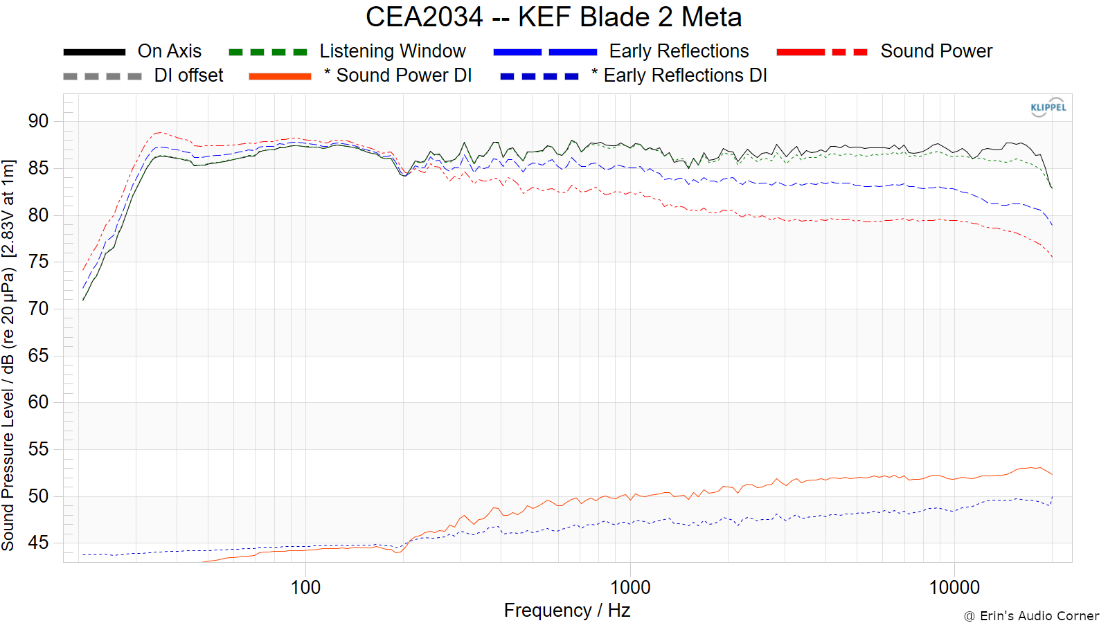

KEF Blade 2 Meta, non-normalised data.
with thanks to @bikinpunk
Reference:
more to come....
Reference:
more to come....

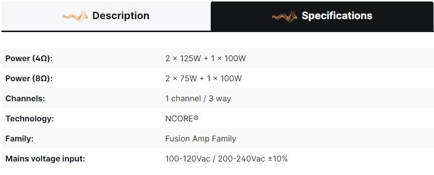

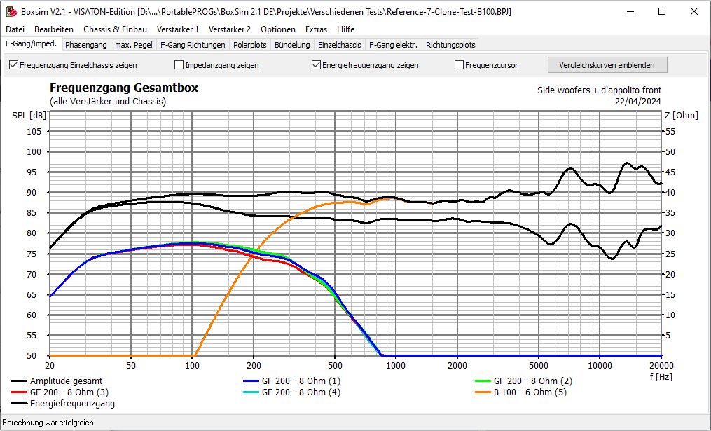

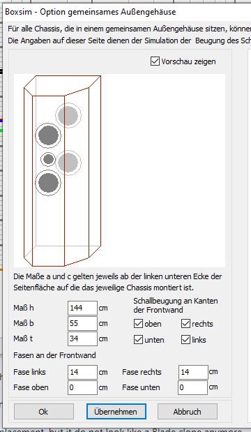

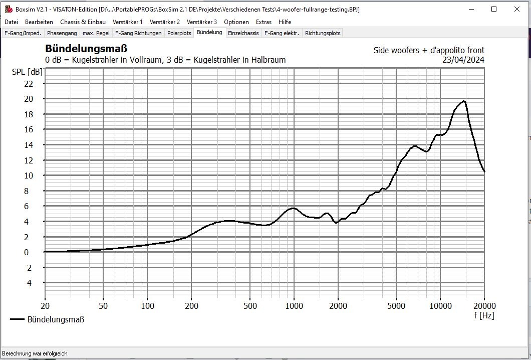

Hi @mayhem,
if you want to get out the most of your 4 woofers each side (4 times more expensive than 1 woofer, but 10 dB more max SPL)
take this placement, but it do not look like a Blade clone anymore
you need a Hypex FA123 with 3 channels, the back fire woofers need a separate channel and the front woofers and here the FR instead of the C 1ms delay
no directivity bumps for f > 50 Hz, slightly dipole characteristic in the crossover region to the FR
