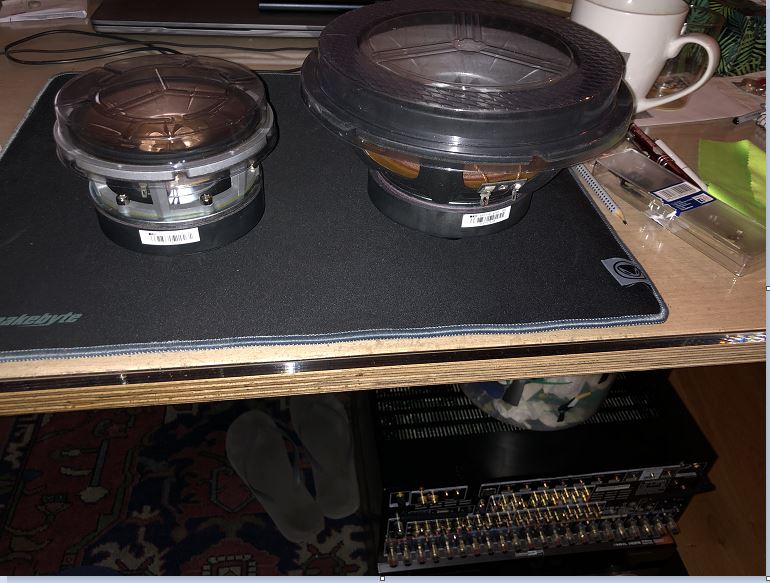

Brand new KEF Uni-Q Meta drivers are available on ebay from HK sellers. Not cheap but only marginally pricier than the Satori coax & it looks genuine.Harvest the drivers from a pair of Q350’s then…..the Meta material advantage can be realized without the price tag and mambo jumbo…….put the Uni Q in a larger enclosure with walls well lined and add an aperoidic vent……nearly the same results….at least to the point that maybe…..maybe you can hear a difference…….unless sighted listening is your thing.
If looking to clone the Blade 2, the woofers don't seem hard to replace with drivers available to DIYers, and there's lots of known ways to couple a pair for vibration cancellation. DSP & active crossovers would be the obvious way for most DIYers. The real challenge is the enclosure, since every external plane features complex curves. But tear-drop cross-section profile towers can be made with stacking CNC-cut BB plywood or skinned with multiple layers of thin BB around tear-drop shape ribs. Not quite as organically curved as the Blade, but it would likely be close enough. Though some vertical curvature could probably be worked in with progressively larger ribs in the middle. Obviously a challenging woodworking project.

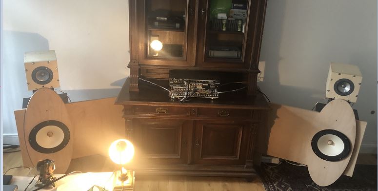

i have done some testing builds with the KEF SP1632 mid-high range coax with FA123 plate amps, not too bad with the active crossover
have taken some measurements with extended bass response - the Sonido drive units in the CB enclosure gave no bass
i was lucky to purchase the drive units as spare parts from setelec.fr but they have discontinued the KEF spare parts delivery in 2023
this other KEF drive units are waiting for testing since years

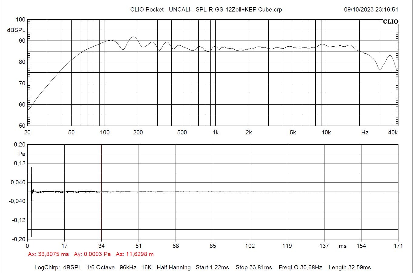

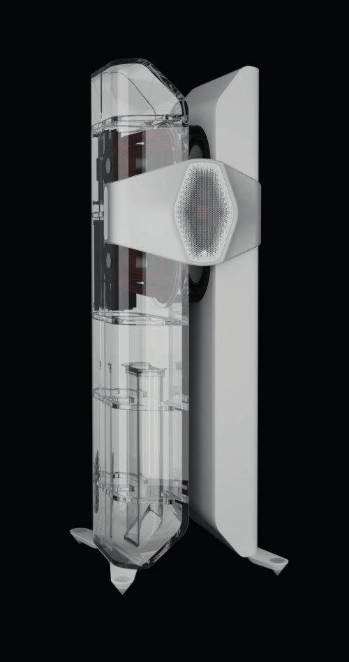

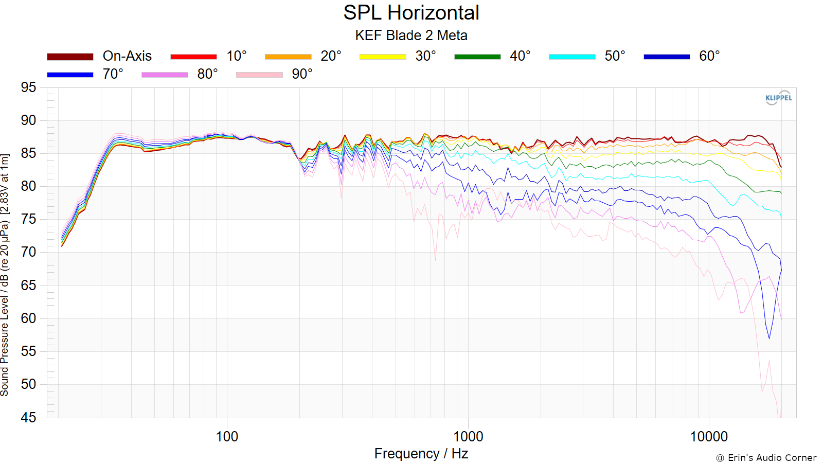

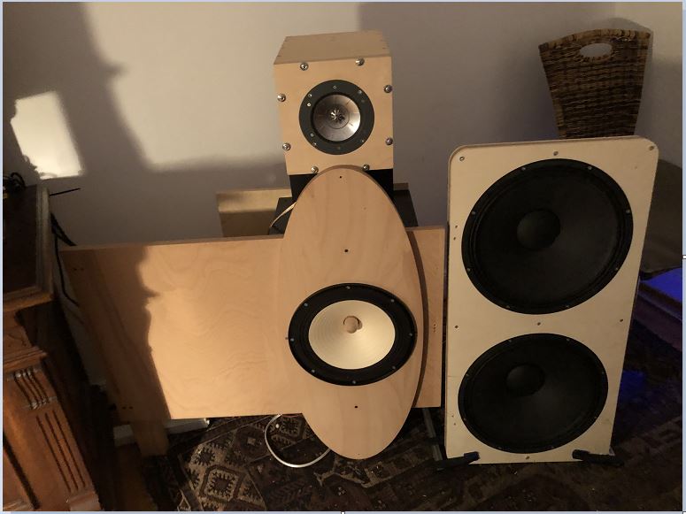

The Blade has it‘s placement limitations for sure……side wall reflections have to be considered and as such
Why is this a bad thing? Sidewalls reflections are often beneficial if the design is good. If you have poor directivity then the sidewall reflections will be a detriment. But that's not the case here with the KEF Blade 2 Meta which has some of the best DI available commercially.
Not that it matters because these aren't much different in horizontal beamdwidth than "standard" speakers with forward firing drivers which are omnidirectional up to about 300-500hz (depending on driver/baffle size, of course) and narrowing above this. Above this frequency range most flat baffle speakers are going to be ±50-70° up to about 8kHz where they begin narrowing again. Most waveguided or horn loaded designs are going to be about ±30-60° up to about 12kHz (or even 20kHz if designed well). These all have sidewall reflections.
More concisely: the KEF B2M having side-firing woofers doesn't mean it automatically has more sidewall reflections than any other typical speaker. It's radiation is narrowed to ±90° by 300Hz which is lower in frequency than many other speakers. You can even compare it directly to the KEF R11 Meta - using (4) 6.5-inch midwoofers and a concentric mid/tweeter - which doesn't narrow to ±90° until 600Hz. Which means that there are technically less sidewall reflections in this speaker's design than the majority of other forward-firing designs. I've got tons and tons of data on my site if you'd like to fact check me.
I don't know if it matters either but what you say there isn't quite right. The comparison of your Blade measurements and Amir's of an R11 on the previous page show the difference. Most forward firing drivers in a basic box are omnidirectional to about 150Hz (The driver or baffle has to quite large to change this much at all at the bottom end) and then progressively narrow.Not that it matters because these aren't much different in horizontal beamdwidth than "standard" speakers with forward firing drivers which are omnidirectional up to about 300-500hz (depending on driver/baffle size, of course) and narrowing above this.
The Blade with side firing drivers are much more omnidirectional up to about 250Hz. The side firing drivers counteract the natural baffle diffraction as measured from the front. There is often no need to apply baffle step compensation in the crossover design or at least much less.

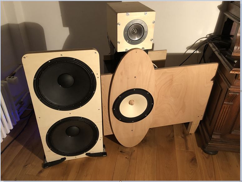

@fluid explained exactly my point, it is quite the same with the BoxSim simulated placement of woofers difference keeping all the rest - drive units, enclosure dimension etc. etc. the same
if a better directivity transition without bumps is desired already at low frequencies you have to place 2 of the woofers backfiring and work with delay with a DSP crossover with the front firing stuff

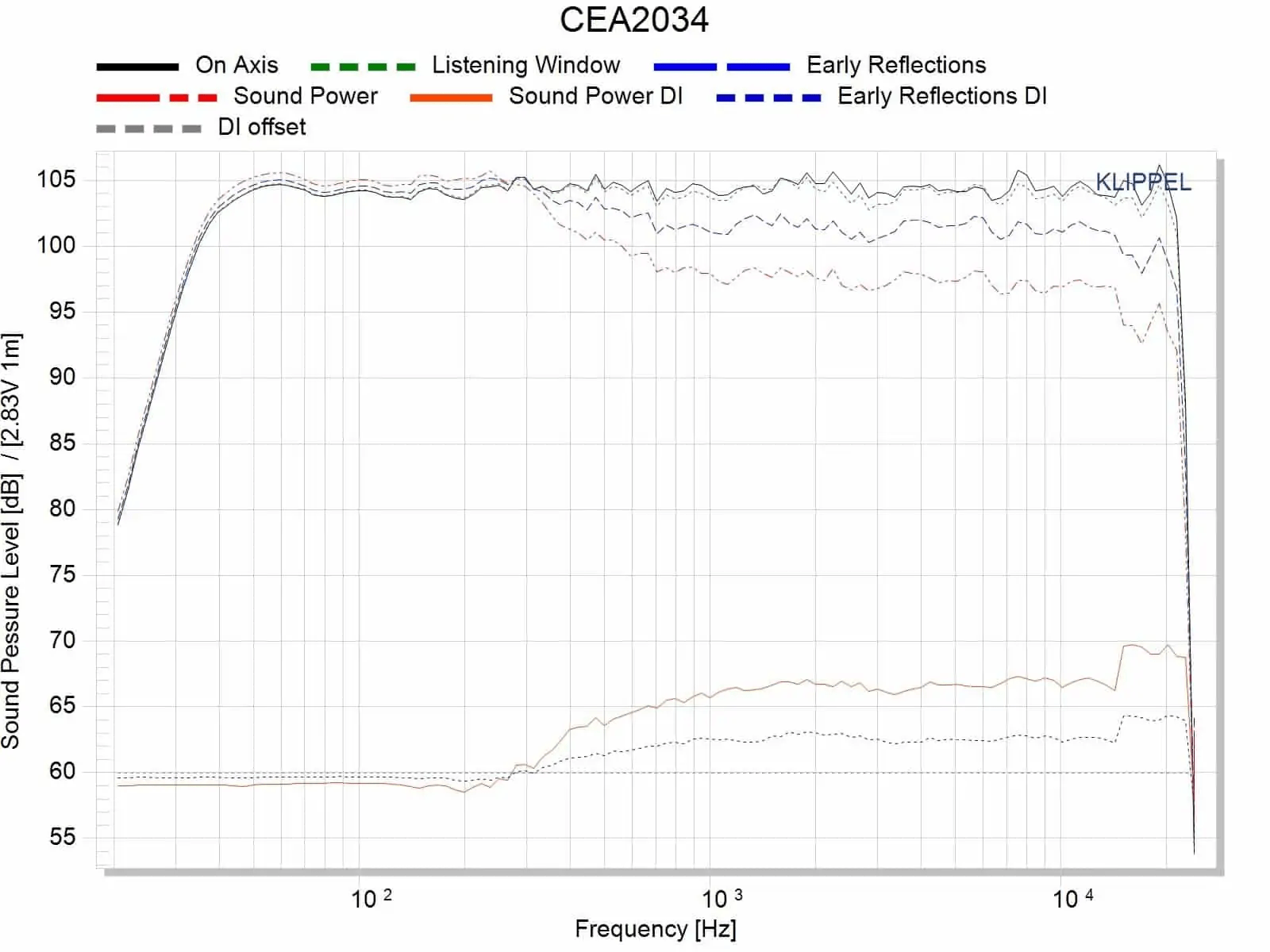

IMO Erin is spot on.
I think we need to be careful when looking at this data. Spinoramas have a fixed rotational axis that is usually set at the front baffle. When you rotate about that axis, drivers mounted on the sides and back get 'artificially' louder simply because the box dimensions push the drivers closer to the mic. If the rotational axis were set at the centre of the cabinet that effect would be lessened, but the curves for the midrange up would fall off artificially rapidly. This is not directivity, only box dimensions and measurement distance in effect - we all know the blade are omni at 30 Hz but the plots show otherwise, just slightly.
You can see this in the horizontal SPL curves, they have been matched at about 150Hz for the B2M.
It's even visible in the early reflections data for the GGNTKT speakers with rear woofers, the curves have been matched at 350 Hz.
Look at the horizontal contour plot of my speaker measurements. The large majority of them are ±180° to about 300Hz - 500Hz depending on size, of course. But that's pretty much par for the course. (±6dB, normalized)
The KEF B2M is to about 300Hz. The KEF R11 Meta is about the same. The Neuman KH80 is to about 500Hz.
Now, if you want to get outside of the "norm" and talk about larger speakers with larger baffles then you can look at the JBL 4367 which is omni up to about 200Hz (again, ±6dB normalized).
Just to note, I was talking about ±90° previously due to the conversation being based on sidewall reflections. I want to make sure we're on the same page here.

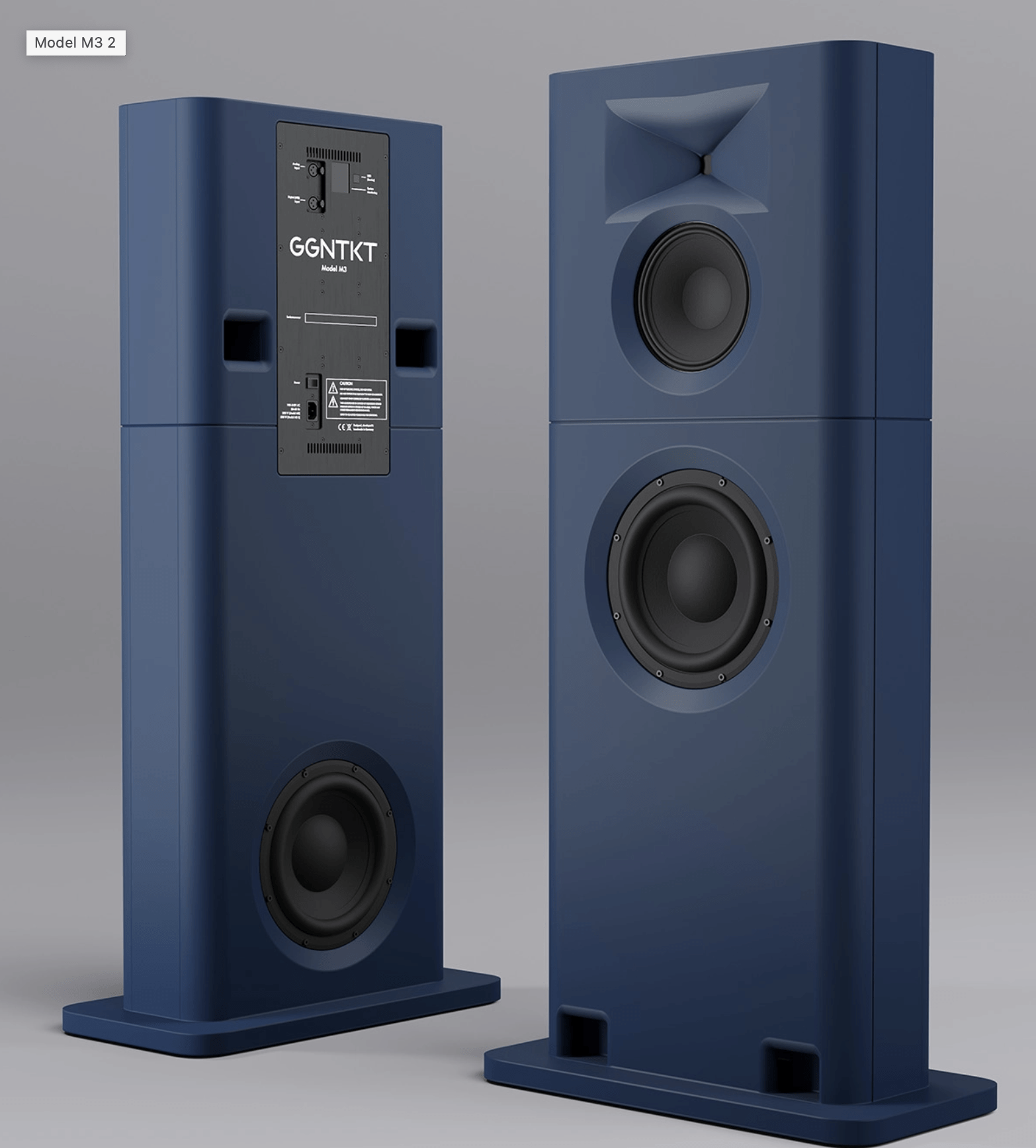

GGNTKT speakers
Alternate ways of doing things.

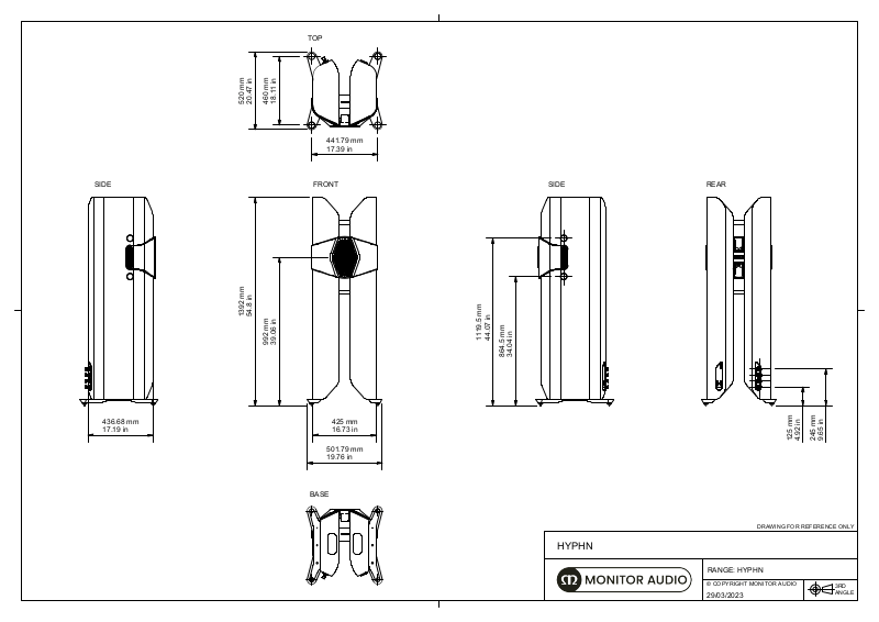

Let’s introduce th push-push Monitor Audio to the discussion. What happenbs when you put the woofers on the inside and slot load them?
Perhaps this would work for mayhem.
BTW, the bipole dip is why the DSP is udes in the GGNTKT. The wider than deepbox makes this issue smaller in a bipole.
That’s a good looking speaker IMHO. Which model is that?
Edit: never mind. I zoomed in on the picture and saw it’s the M3.
The slot is open to front and back, right?
They are using vituixcad! Can be seen in the design video
