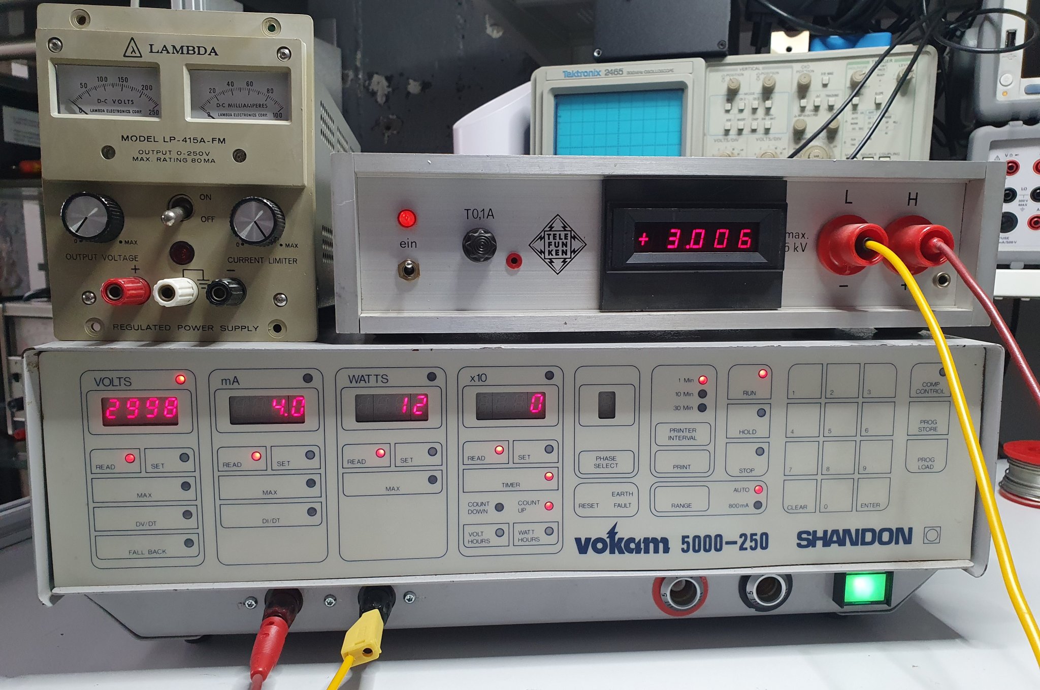

What does this mean? It means that if you place the isolated part of that connector in contact with a (grounded) metal part, there should be less than 1000V between them. A voltrage spec is always 'between two points', you can't have 'a' voltage on a point.
In the picture if you see the connector on the HV meter at the top right, clearly even if the 4mm banana was naked there would be no problem.
So it's all context.
