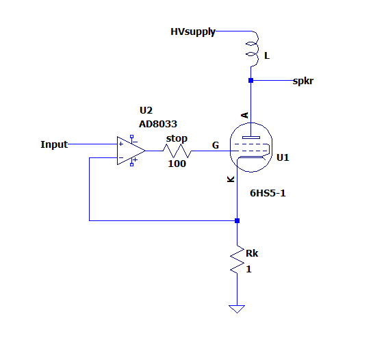

Adrian Immler from Austria was so kind to put an LTspice model together for the GI-17.
It looks like a reasonable match to my measurements.
I have modified my current amplifier model based on the 6HS5 and next will see if I can port the GI-17 model into it.
The original design used the 6HS5 in grounded grid, driven with a cathode current.
With the GI-17 that is complex as the heater supply is connected at one side to the cathode so will swing the parasitic capacitances, which causes losses.
I now want to drive the GI-17 at the grid, but with feedback from a small sampling resistor in the cathode lead to remain in current drive mode.
This way the triode will look like an (ideal) pentode.
Exciting!

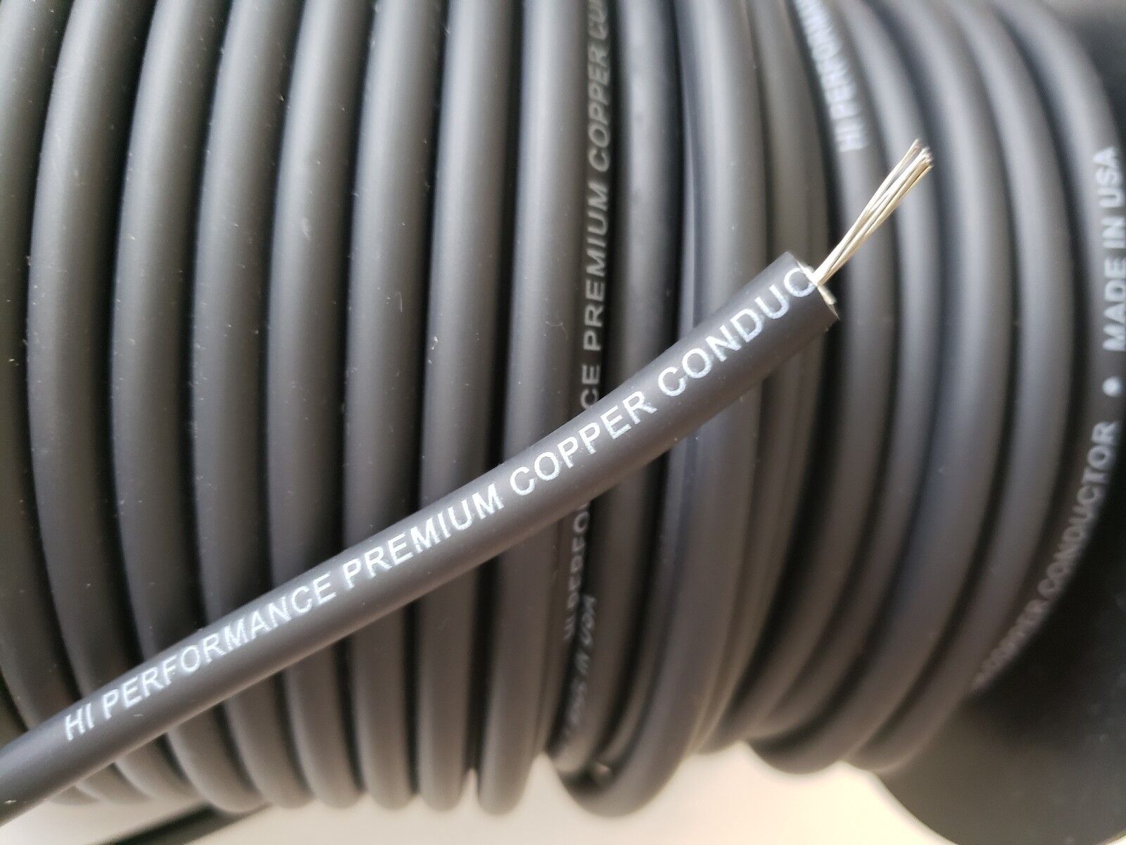

IMHO you can check in yours local automotive shops for those 7mm in diameter spark plug silicone cables with insulated cooper stranded wire in the center ,those HV cables can be good choice for your amps , think that those cables are good for at least 20KV if not way more .

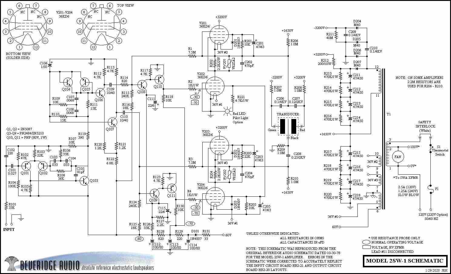

I never tried running a good sized tube with zero or negative voltage on the screen. Most pentodes, especially big ones, will need some positive voltage on one of the grids to get some current flow. The current drawn by G2 will be very low if the plate voltage remains considerably higher than the screen voltage. You aren't looking for a lot of plate current, so maybe a few volts on G2 will be sufficient? Will your circuit work if the G2 current is supplied by an independent floating supply between the cathode and G2? If so, then that's not too hard to do.
@Tubelab_com: George, reading thsi again, see the attached from the Beveridge direct drive amp. Vg2k is 36V and apparently that is enough for this application.
Maybe I should check that out.
Jan
The beam regulator triodes like the 6HS5, 6HV5 and others are essentially a sweep tube with the screen grid left out. In my experiments using them on 650 volts a positive grid voltage was needed to get reasonable plate current. The high Mu (300) and Gm (65000) of these tubes makes them prone to spurious oscillation with my clip lead construction techniques. With 3500 volts on the plate (max spec is 5500) you will be in negative grid region and within the range of an opamp chip. Curves are furnished in the 6HV5 data sheet. The other variants 6HS5, 6JD5 and 6JK5 are similar, but often cheaper. These come in two plate sizes, 30 watt and 35 watt. I have seen both size plates in tubes with the same type number on them.
