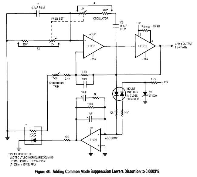

Go to http://www.linear-tech.com/ and do a search for AN43. The oscillator section begins on page 27.
The lowest distortion one they show (Fig. 48, THD of 0.0003%) has a range of only 1.5KHz to 15KHz. A couple of problems with building it:
1. You would need to provide switching of two film caps in the circuit (C1 and C2) from 0.1µf to 1µf, and that would give you two ranges...150Hz - 1.5KHz, and 1.5KHz - 15KHz.
2. Adjusting frequency with a standard potentiometer will be very very touchy. You would need a precision 10-turn dual potentiometer with very good channel-to-channel tracking. Not too hard to find, but they are NOT cheap.
3. The optical photocell might be a PITA to find. The Clarex CLM410 seems to be out of production, but the looks like the VTL5C10 is still made by PerkinElmer. I don't know who's backside you'd have to kiss to latch onto one of these devices, but it might not be hopeless.
4. The output of the circuit swings almost rail-to-rail by default. You would need another pot and likely an output buffer to make it really usable.
I was ready to go this route until I found the SG505 for a good price.
Edit: jackinnj, very cool!! Never saw that before. However, it's not exactly simple, and fixed at 10KHz freq. Still, unbelieveably low distortion.:eek: (it's AN67, BTW)
