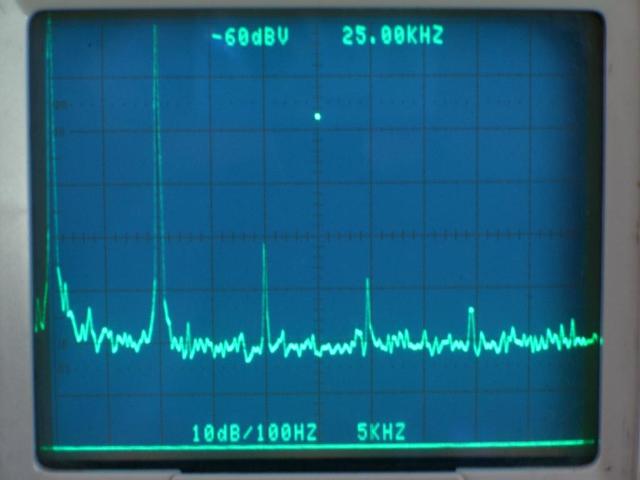

here are the residuals of the Linear Oscillator -- 10kHz to 30kHz -- I used the averaging function to eliminate the environmental noise. there really is no second or third harmonic to speak of, but there is some distortion around 11, 12 and 13kHz which has to be dealt with. As I said earlier, I think that some of the R and C values have to be tweaked to get the phase crossing correct -- and this involves more than unsoldering a few devices.
Are any residuals visible below 10K? I just looked at the KH at 10K. It measures .0018% w/ 80 KHz filter. But there are no close in residuals, even with the internal oscillator set to 1 KHz. The Boonton measures .0025% with no close in stuff.
Could they be in the spectrum analyzer you are using?

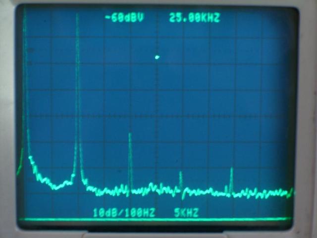

The spectrum analyzer I'm using is a 3577a -- here's a look at the Boonton Residuals -- 10kHz, 10V output -- scale is 20uV/div
You need to be cautious of the input overload both for accuracy and frying the input mixer (probably not an issue with the 3577).
I have a passive input filter (a B&K 1607) that I use to atteunate the input. I can get a 70 dB notch that allows the analyzer to look into the mud better.

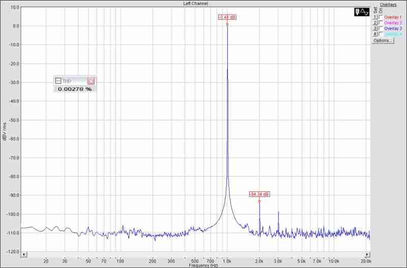

Here is my Boonton with a 70 dB notch in front of a Tek 7L5. The noise is lower at 10 Hz but I can't sweep a wide enough band, the slowest sweep is 10 seconds per div. and the amplitude isn't accurate if the sweep is rushed.

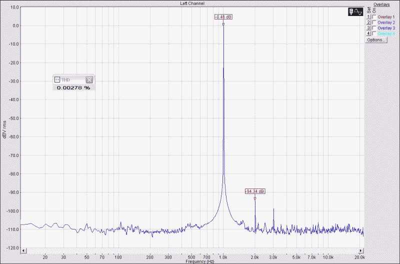

And here is the KH4400 under the same settings.

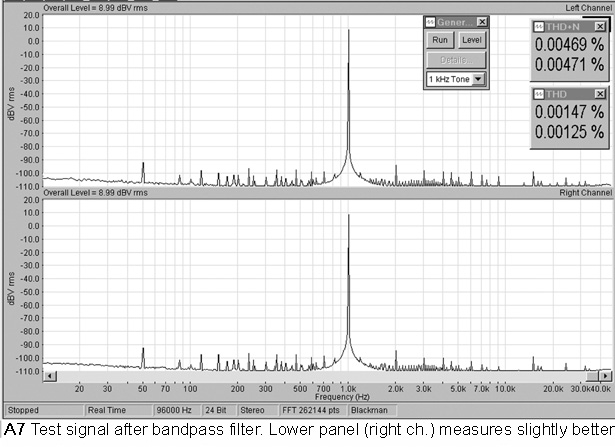

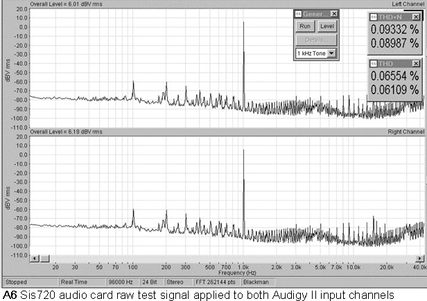

I have been using this approach now for over a year and a half. Attached is test signal after bandpass filter. In this case it is a state variable bandpass using the spare op amp (I use the OPA 4134 quad) as output buffer.
Input is a Sound Blaster Audigy II MX at 24 bits /96 KHz, and after checking different levels I believe the residual arctifacts are mostly in the acquisition path.
Next post is the raw soundcard output.
