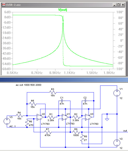

kambule said:
Rodolf,
Interested to see the active LPF clean up some residuals if the sound card output.
Do you mind to post the schematic of the active filter circuit ??
thanks in advance.
kb
I do not have the original schematic files since it is a very old design (over 15 year back), so attached is a new one on LtSpice and simulation.
The actual circuit measured in the previous post includes a couple of modifications:
1. Devices are 3 parts from a OPA4134, and the spare one is connected as inverting unity gain buffer at (Out).
2. Resistors R1 and R2 are 10 turn 5K potentiometers.
Care should be taken as usual with grounding, power supply decoupling etc.
Rodolfo

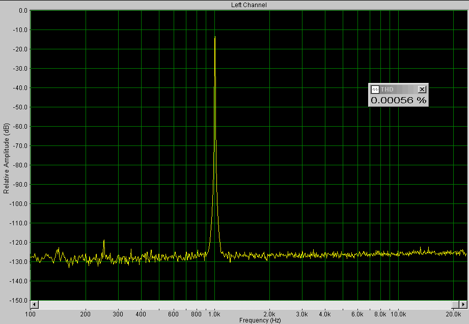

I use internal pci-soundcard with very good results.
The trick is to not use full scale signals and avoid the internal resampler of the soundcard.
This way i got perfectly clean fft plots, no harmonics visible. (below noise floor)
The signal source was goldwave, using the expression evaluator you can generate any testsignal you want. (Don't forget to manually add dithering) Playback was 24bit,48khz.
FFT plot also 48khz, 32768 window size, blackman, averaging = 10.
The soundcard is M-audio delta 24b96.
With this setup i can perfectly measure amp output, clearly seeing only harmonics created by the amp.

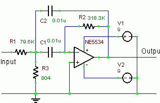

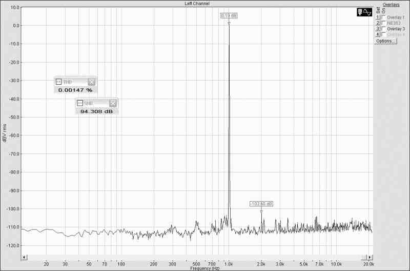

Here is the FFT from a Waveterminal 192L with a bandpass filter between output and input loop. I gave you the direct connection FFT plot in an earlier post.
The bandpass filter is a second order filter using a single NE5534 with +/- 9 volt battery supply.
OK the plot looks bad. Fundamental is at 1 volt ( 0db) and 2nd harmonic is at -102db .
Note: The filter center frequency is not 'exactly' at 1Khz. Its slightly less than 1Khz. So with a properly ajusted filter you might get the second harmonic down by about 2 db more , which will be -104db = 0.00063% .
The 0.00147% reading on screen includes all harmonics ( till the 9th I think ).
-102db is = 0.00079% .

Here is the filter I used.
Opamp is NE5534.
All resistors are made up of two in series to get a fairly accurate value. Best method is to measure the capacitor values and then calculate the resistor values.
I did not use a dc decoupling input capacitor and the output had a 100 ohm resistor . Supply was from two 9 V batteries through 22 ohm resistors in each supply line and a 220uF capacitor for decoupling at each supply terminal on the chip.

Again -- try the passive notch -- then you can isolate the problems not related to the fundamental -- this is a modified version of the one which Cyril Bateman used in his capacitor distortion series of articles in EW - the closer you match the components the better the notch -- this shows 54dB on the bode-plotter.

Jackinnj I do get your point. Yes I could have used a LPF . I tried the bandpass because on another sound card in another computer I get mains supply harmonics. Earlier I had a two opamp filter . I decided to see how good a simple single opamp bandpass would look.
You musn't forget that the aim of my exercise is to get a 'very' pure sine wave to feed into the DUT.
