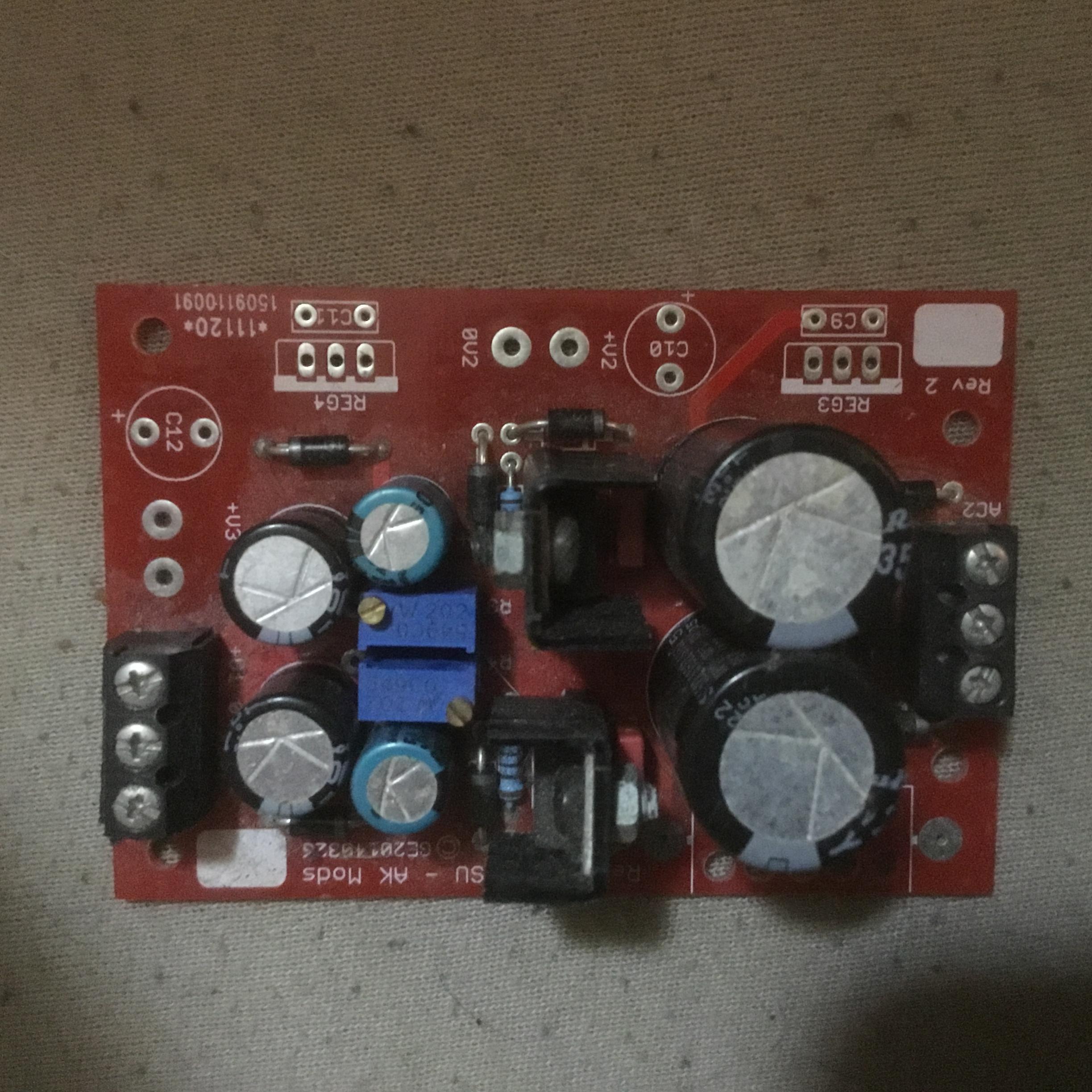

I have a couple of Signal A41-25-16 power transformers on the shelf, rectified they will put out about 24VDC. I will use these power transformers with the AudioWind regulators linked in a previous post. I am skipping using the Quasimodo snubber/zobel and come back if there is an issue.

Hello All,
Today looking back at this thread I see that I made a mistake.
Take a look back at post #1474, I called out a regulator, Audiowind A2007 and a transformer.
I see in the photo in post #1493 that I had one of the transformer leads under the wrong screw terminal on the regulator.

What value of volume potentiometer is recommended for amplifier?
And which power supplys works well with the amplifier?
Hi
Mr Marsh used a 15v psu at one time 12 to 20 volt is apparently ok providing caps are rated for it. I use 15v+/-. Any good quality one will do no need for anything too exotic. I used one that was on Dirty PCs years ago
From memory I think it’s a 100ohm pot but I may be wrong and it may be 50 ohm. If you get low vol try the other pot
Hope that helps
