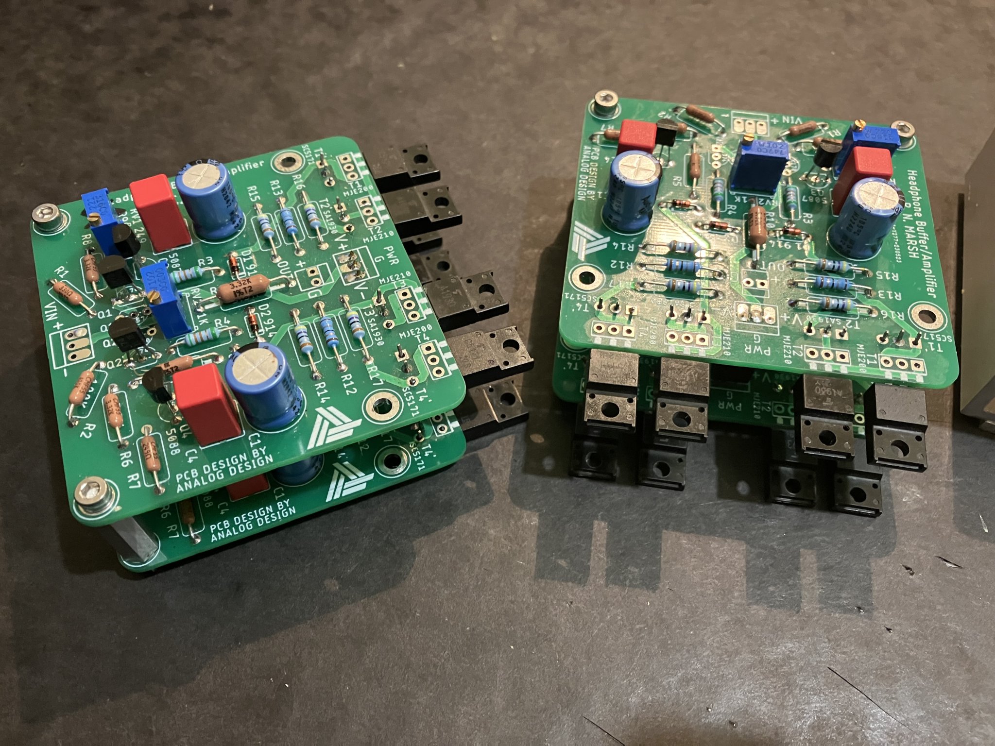

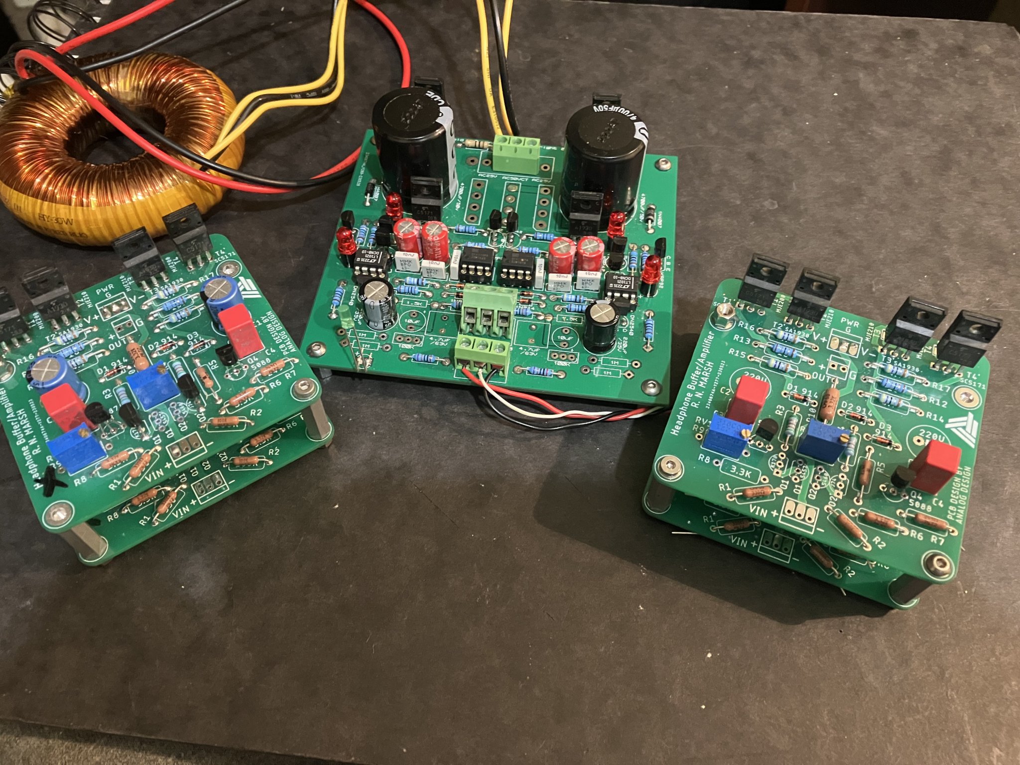

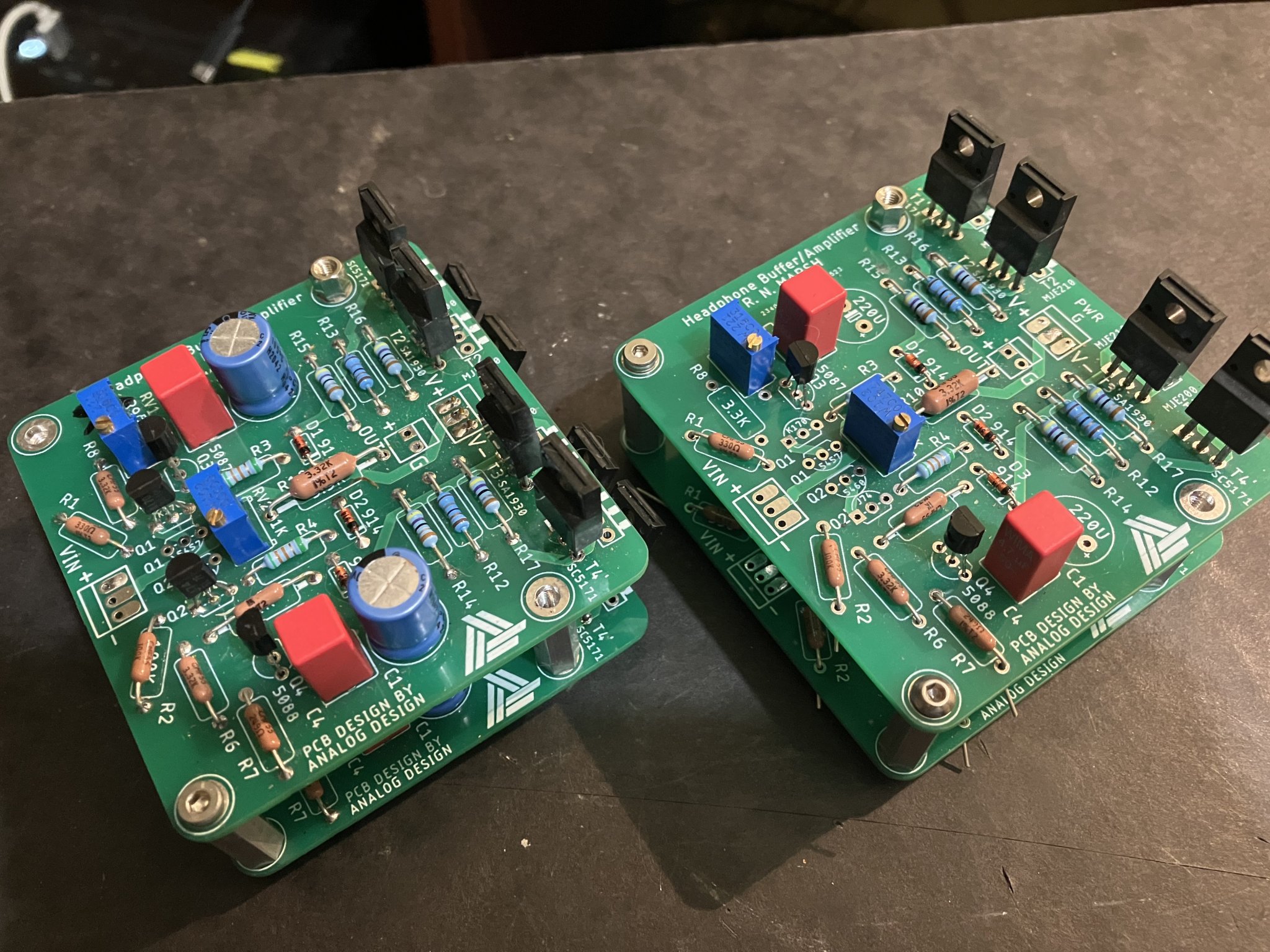

Here are some PCBs that Prasi designed for me to use Toshiba 1571/1930 TO-220 type BJTs. Provision is also included for original footprints so lots of choices to use.
They sound excellent, I had a pair of these running non stop for two weeks. Very addictive sound. I will now build up a second pair to fit as a balanced amp. All running at 26V from a Gilmore Golden reference PSU.
A few boards and matched toshibas left at cost if anyone wants to try them. A truly excellent head amp indeed.

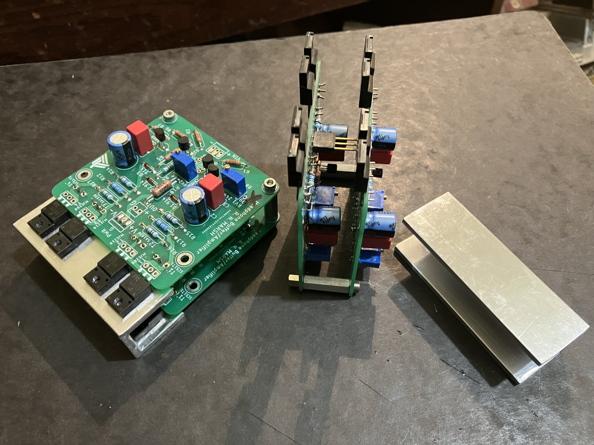

Meanwhile, this is how we roll in South Shropshire kid... I bloody love this stuff, the building aspect. Problem solving, being meticulous. I'm thriving with this new balanced Marsh build - pic below show setup for stacked boards on U channel extrusions, these are smashed onto the side panel, the Marsh amps do not get terribly hot, they are very well behaved so this assembly method should do. Power is wired to beneath the bottom boards, they are connected via stackable pin headers.
Waiting for one quad of fets at exactly 8.6ma to match the ones I originally had, these four boards are a super matched quad. All transistors are practically 1:1 matched. This amp will be a beast.

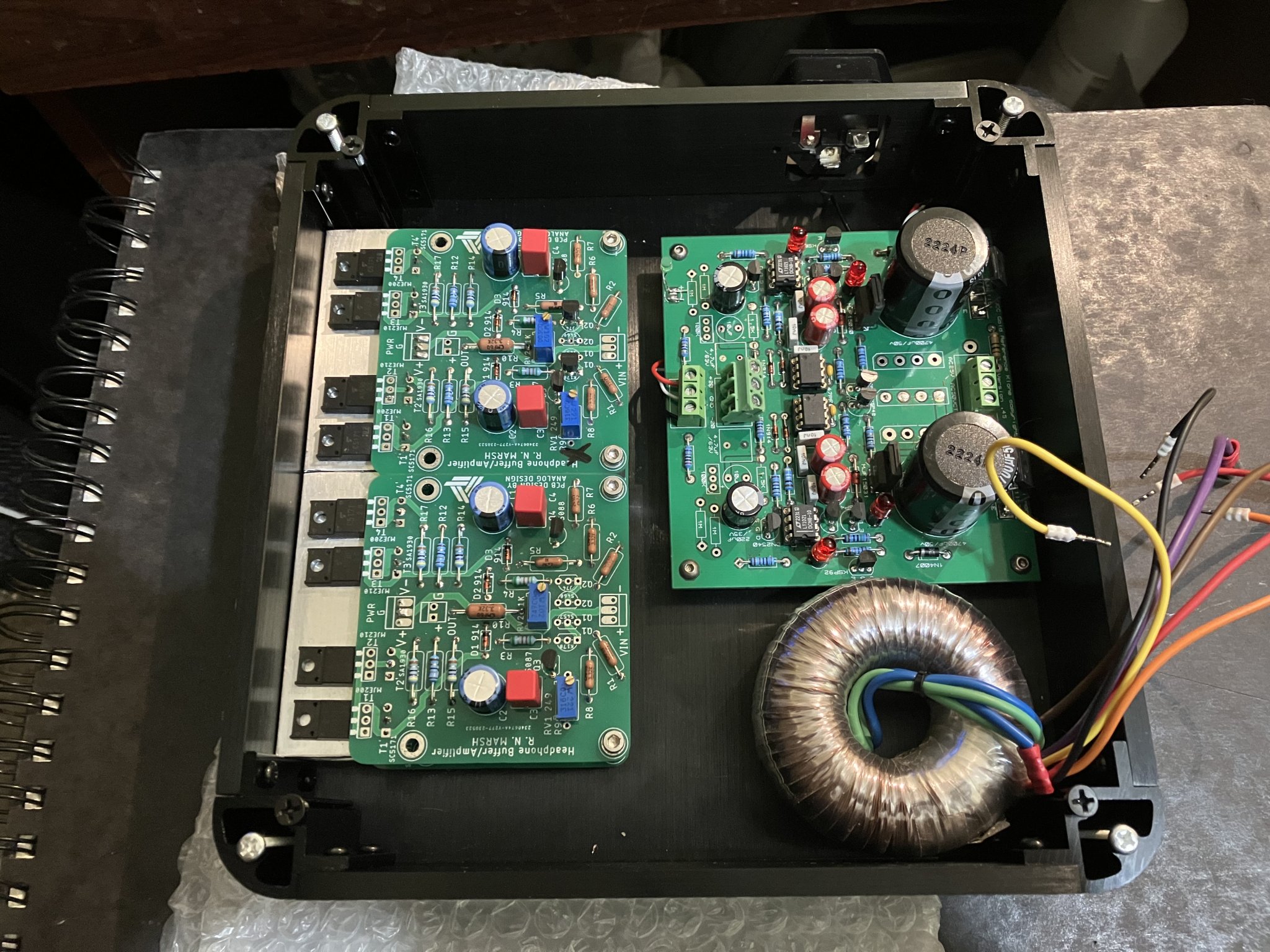

Found an excellent case for this project, very chunky and sturdy, the amp is built upside down into the lid, no screws visible from the outside - Enclosure

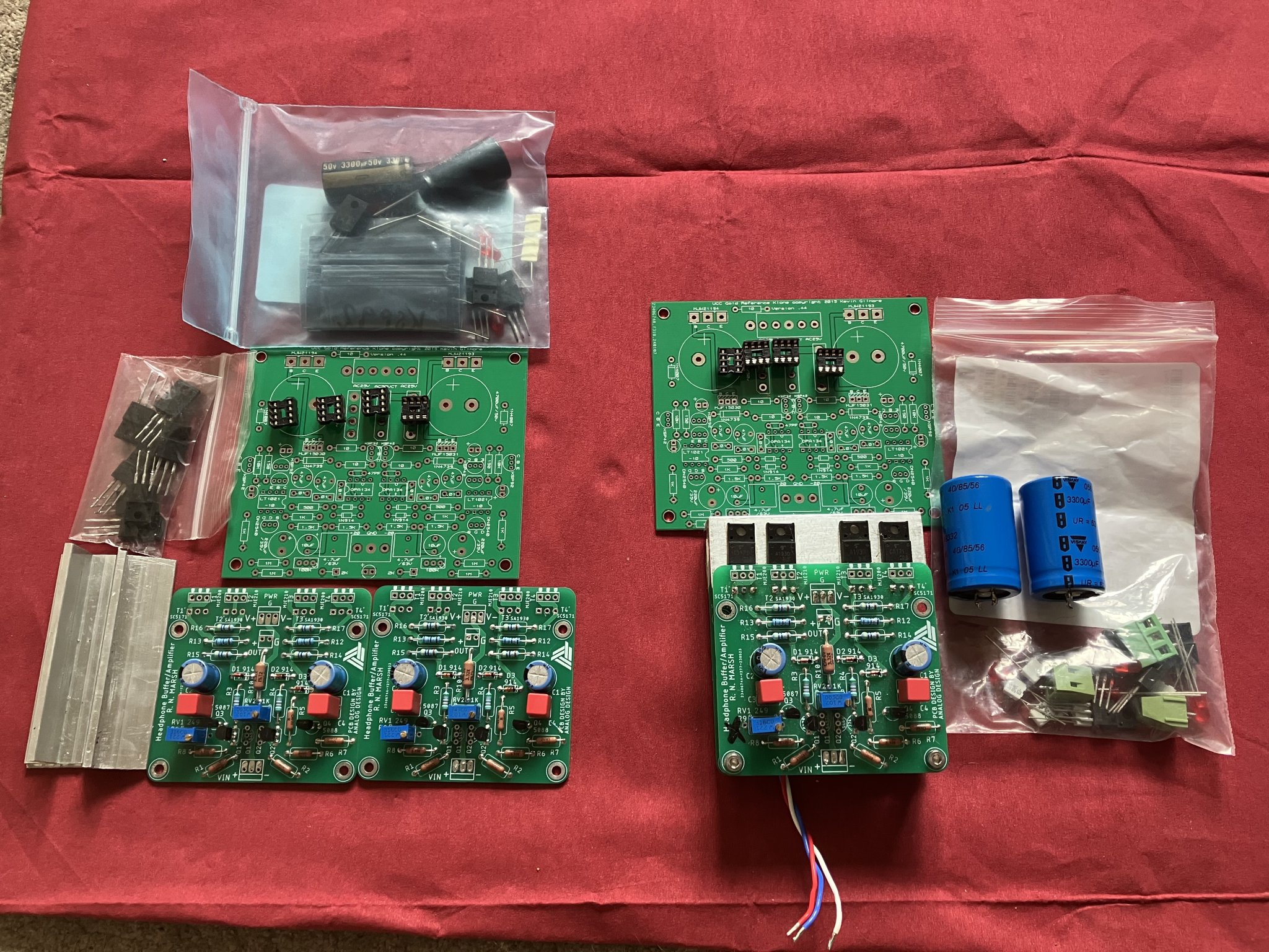

Hello all, if anyone is interested I'm selling my Prasi designed Marsh HPA boards to fund the next stage in the evolution of the circuit layout. I have a plan to go mostly SMD and possibly a fully balanced amp in a single PCB with the Golden reference supply circuit built in. (also single ended boards maybe) Very likely to fit a specific chassis seen in my last post (excellent chassis)
I would like to have the input fets thermally tracked to each other or even use LSK489 / LSJ689 in SOIC or SOT packages, (not sure about matching these however)
Believe me Prasi will be doing doing the heavy lifting here but I will go to SketchUp or Blender to do a layout plan. It's quite a job bless him, he is a legend for sure. I recommend his work very much.
So, two sets of boards, a pair each set along with Gilmore Golden Reference PSU PCBs and a few parts to help build the PSU boards. The parts kits vary slightly as I scraped them together with bits I have spare, but both kits are same price. Bear in mind each matched quad of K170/J74 cost nearly £50. All active devices are essentially super matched 1:1, very tight groups. DC is zero. You will not find better.
In the attached picture, the right hand kit (kit #1) is more complete, the HPA boards are entirely built and ready to play, Mounted as a stack on U channel block. the PSU filter caps are Vishay MAL high end caps, Toshiba 2SA1930/2SC1571 BJTs for Cap Multi section, LEDs and connector blocks.
Left hand kit (#2) Have the output transistors removed as I tried some Toshiba 2SA1360 & 2SC3423 TO126 BJTs, the original 1930/1571 BJTs are included along with two T-section mounting plates. PSU kit contains KSP42/ 92 small signal transistors, Nichicon filter caps, LEDs and Toshiba BJTs.
Both kits are £65 plus shipping and worth every penny. Brilliant sounding amps, the Toshiba BJTs are a definite upgrade, The boards however can accommodate several types of transistors, certainly worth experimenting. I have a few pairs of blank PCBs left if someone wanted to try different combinations. I cannot recommend this amp enough, a classic by Mr Marsh.
Get in touch, questions welcome, I put these here first before the swap meet.
