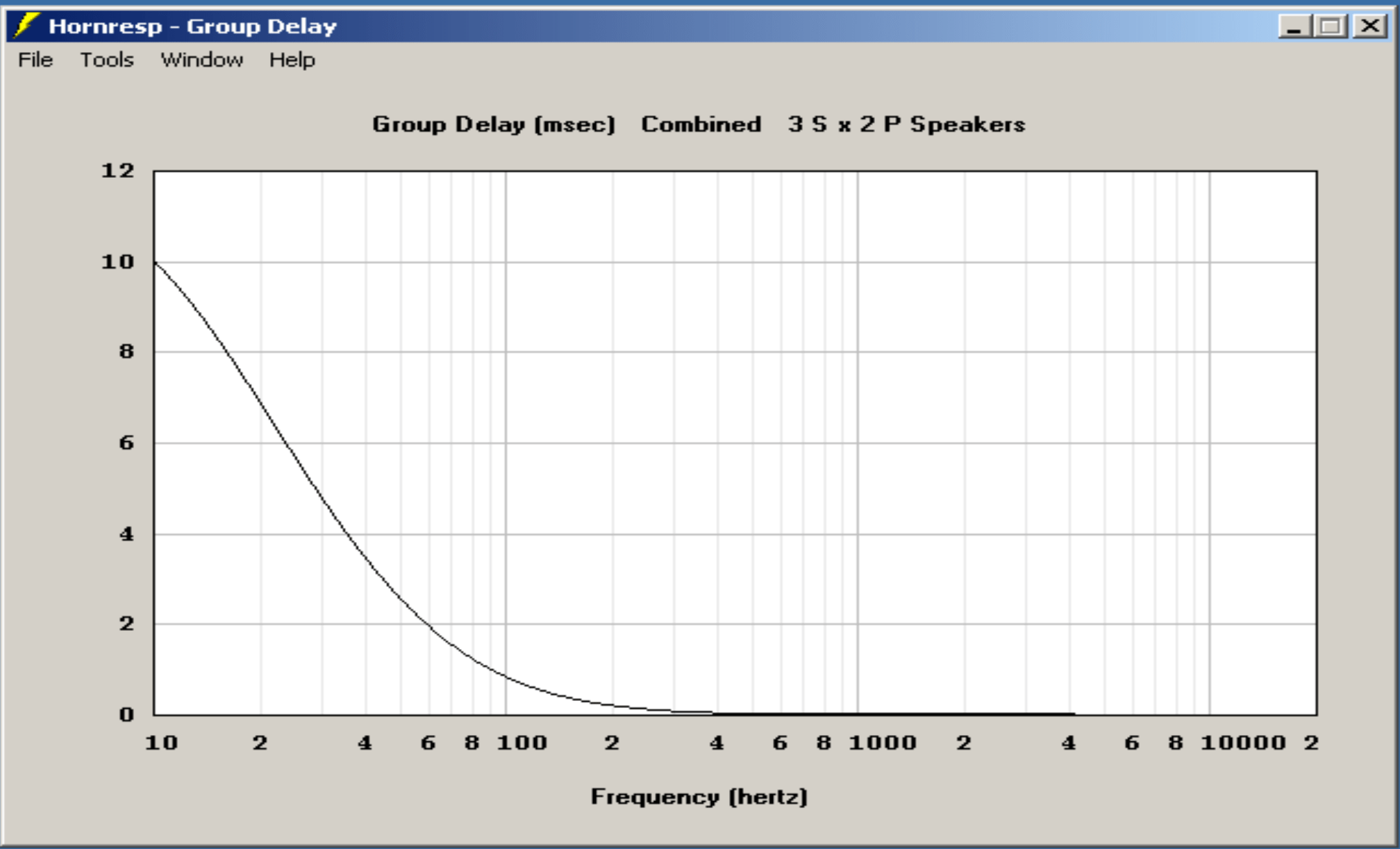

So now comes the question which design to go for. I have no idea how audible the 'less clean' impulse response, group delay and phase graph will be compared to the flat open baffle design. If I'm correct, the flat open baffle desigh has the best impulse, group delay and phase graphs. Only max SPL is better for U and H baffle designs. (in my simulations +6 dB) But I can compensate for that by adding more drivers, for instance 8 instead of 6 per channel, although this gives only +3 dB gain so the price per dB is steep. This makes the physical length larger which is welcome for larger listening positions.
Comparison of 20 cm wide flat open baffle to 20 cm wide and 2*10 cm deep H baffle:

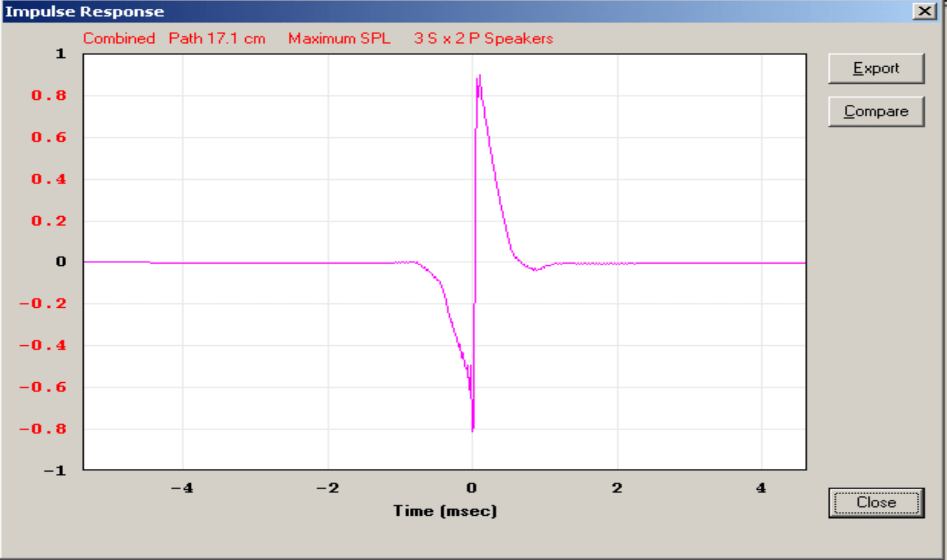

I would not look at the impulse response calculated from the Maximum SPL curve as it is rather meaningless. I would look at the frequency response curve and impulse response after you have applied whatever EQ and crossover you will be using.

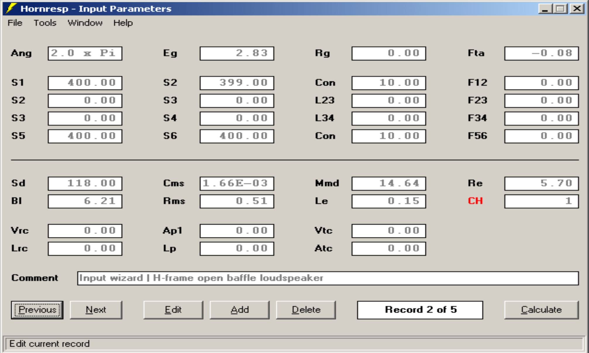

Can you post screen shots of your Input Parameters window for the H-frame? Or you could also export it as a Hornresp record from the file menu while viewing the Input Parameters window. I am unable to reproduce your Impulse results and am trying to understand it. Oh, also what version of Hornresp are you using?

Thanks again for your extensive reply! I was already questioning myself why the inserted parameters were sometimes changing slightly, but this explains it.
In the attachement I put an export file of the H-frame simulation if I'm correct. I made a screenshot of the Input Parameters screen as well:

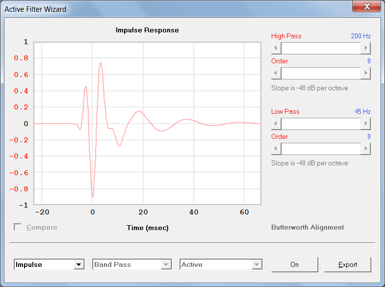

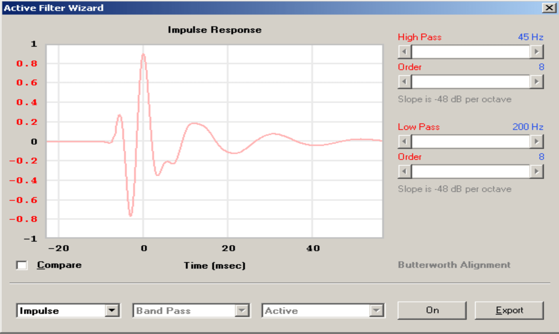

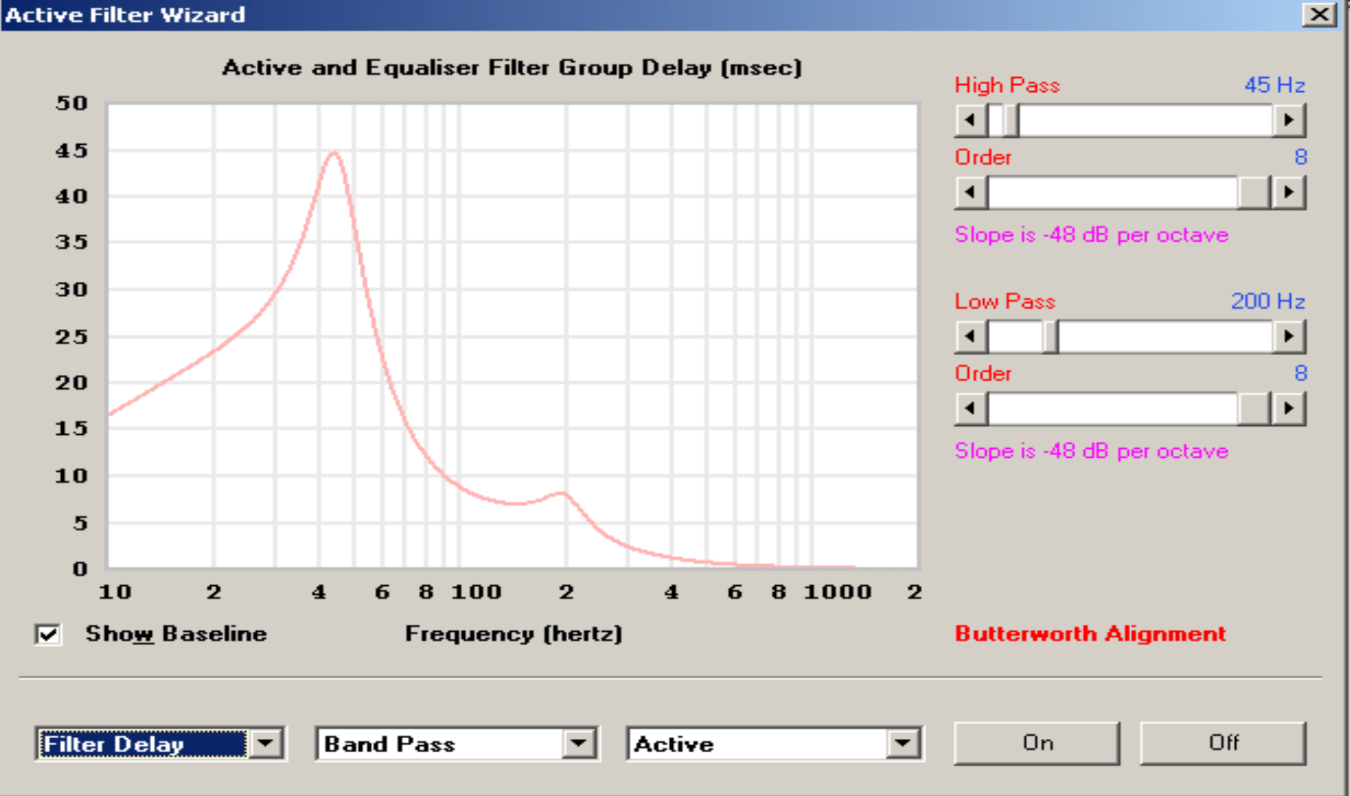

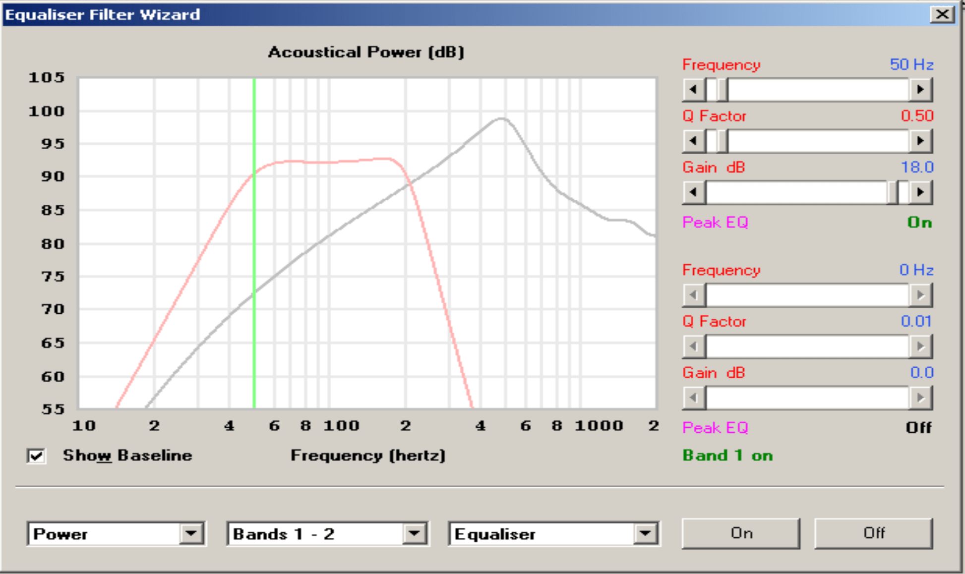

About the equalizing and crossover: I guess this can be arranged by using the Filter wizard => Active option where I can insert a Low pass filter, for instance 48 dB/oct @ 250Hz, and a High pass filter @45Hz 48 dB/oct for limiting driver excursion and Filter wizard => equalizer option where I can compensate for dipole roll-off. (I just inserted some quick test values to get an idea of how this effects ipulse response and group delay).
Some screenshots of the Filter wizard:
filter_wizard_active.png filter_wizard_equalizer.png filter_wizard_impulse.png filter_wizard_delay.png

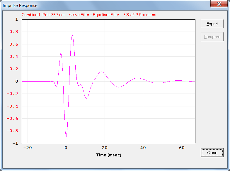

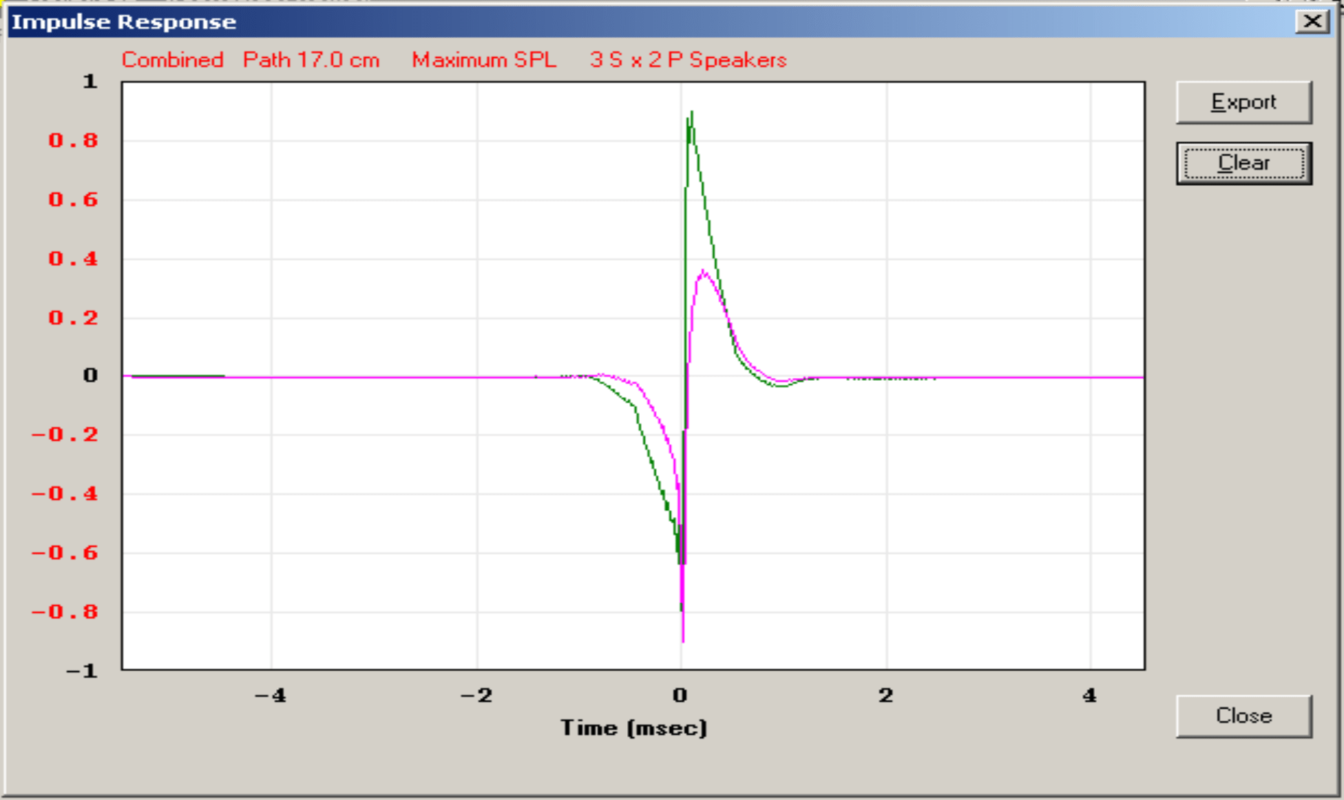

I still have some things which remain unclear, for instance, when I view the impulse response in the Filter wizard I see a different graph compared to the impulse response graph from the tools => impulse response menu. If I'm correct, both should be equal and display the impulse response of the complete system which is in my case the active section (high + low pass filters) and the equaliser section (1 peak eq) together with the loudspeaker? (I pushed the "On" button in the Filter wizard to apply the filters to the different graphs / result.

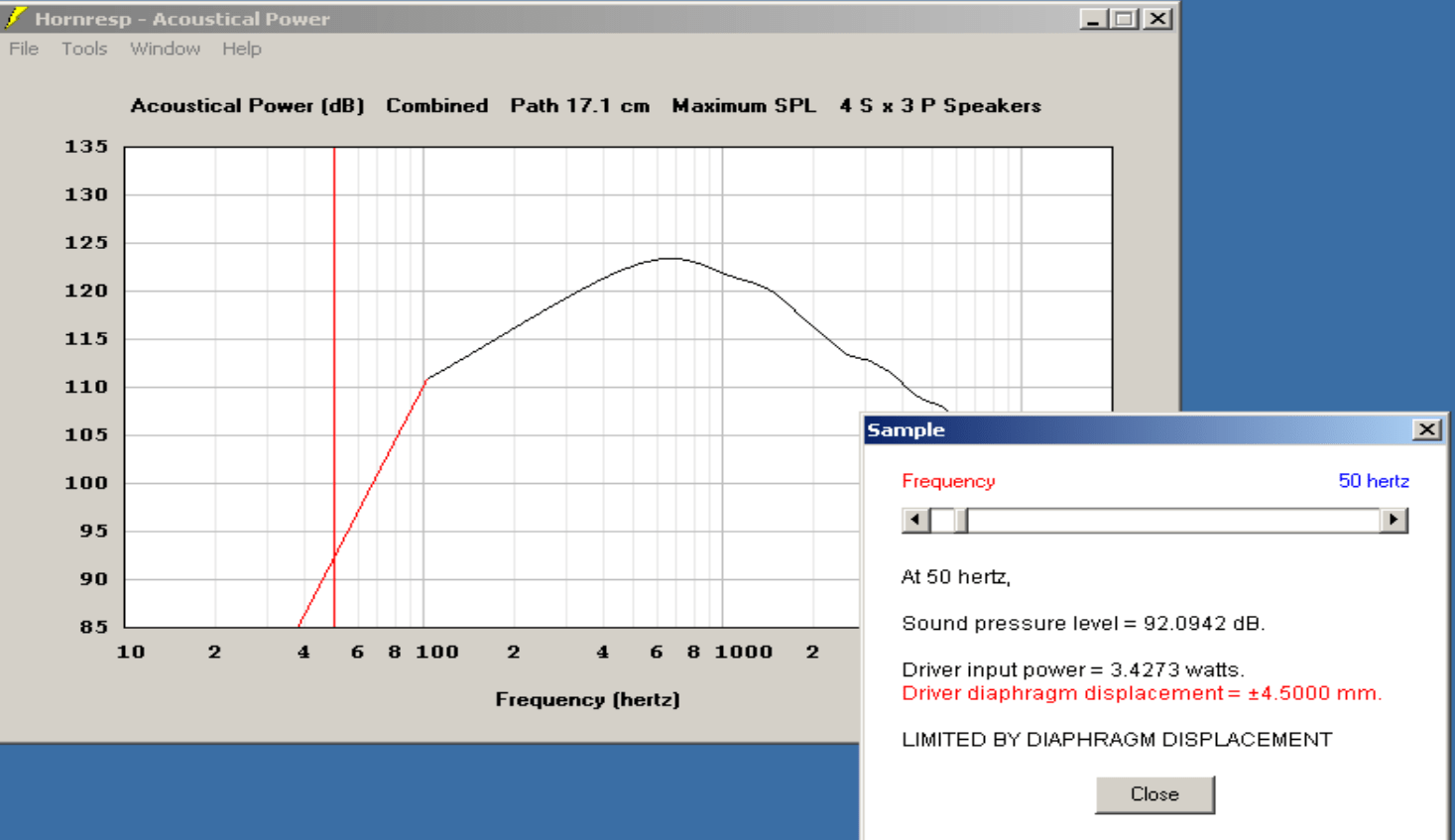

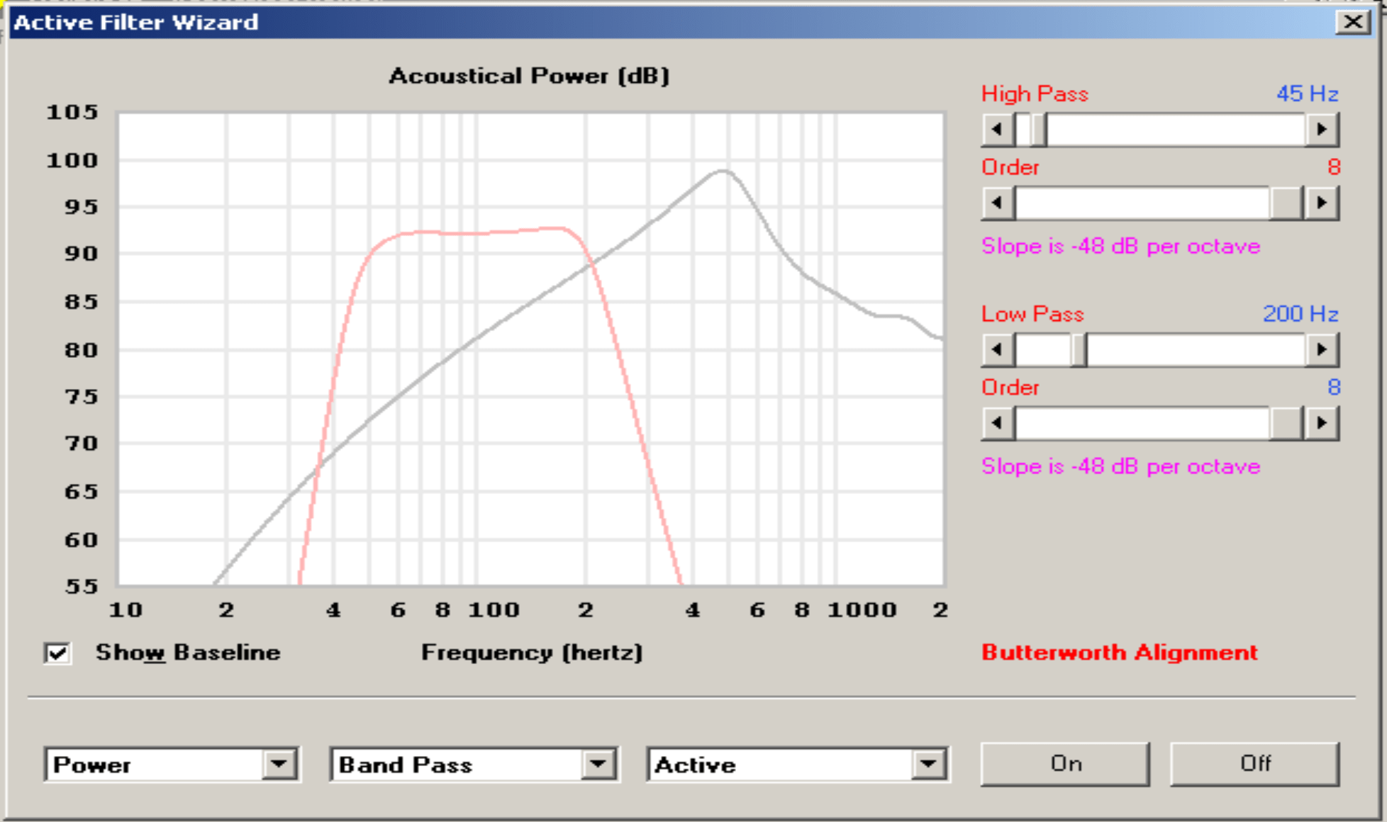

Acoustical power graph after applying the filters to the H-frame baffle:
Phase response from the Filter wizard:

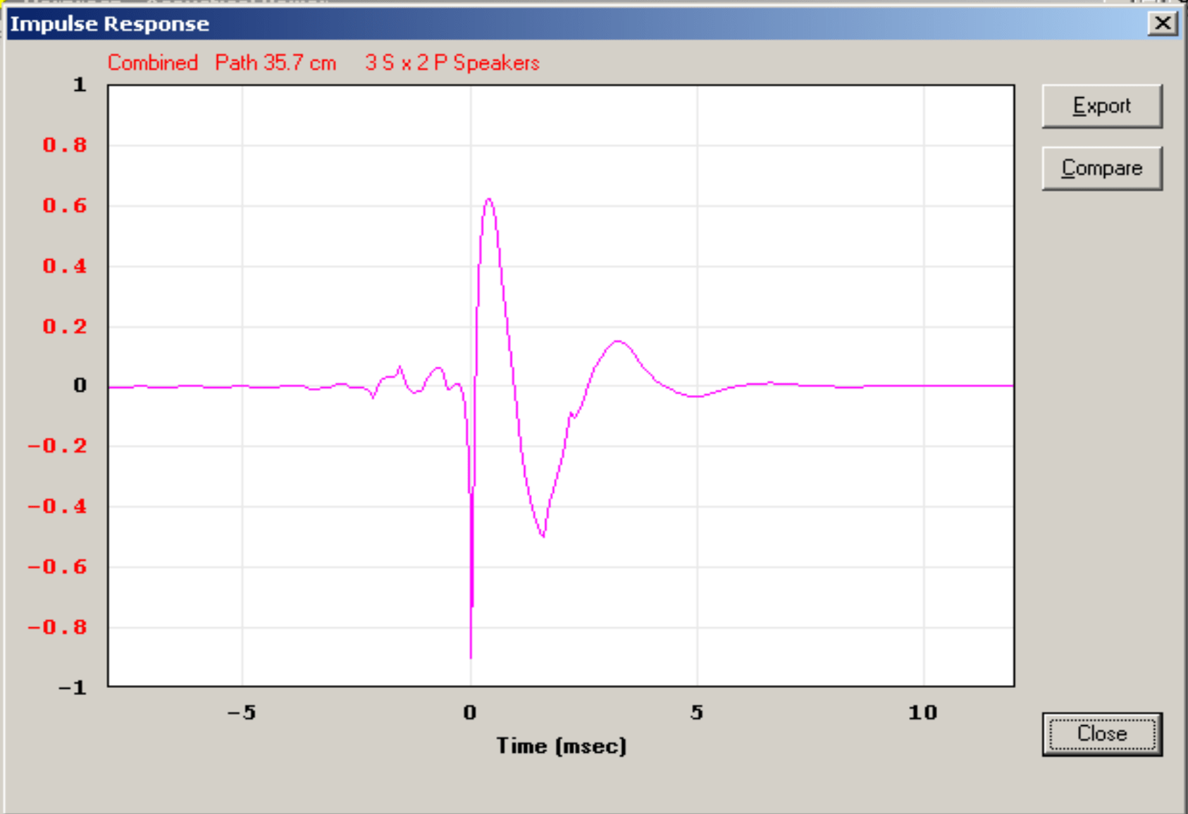

Phase response from the Tools => impulse response menu:
Any idea why the last two graphs differ?
The chosen filters have reduced the power response to an impractical level (-10dB).
The first impulse response is for single loudspeaker, the second impulse response is for an array of 3S x 2P loudspeakers.
EDIT - On further checking something doesn't seem quite right. I need to investigate further.
I found the problem, it will be fixed in the next update. The impulse response results will then be the same.
Thanks for your message and sorting out the problem. Just to be sure: in the current version the first response from post #107 is for a single speaker, the second for multiple (3S x 2P) speakers. In the next updated version the first graph (impulse response in filter wizard) will take into account the multiple speakers selected by the user?
The current version already does that. It turned out that the results were different due to a bug, rather than being caused by a different number of speakers. The first impulse response you posted is correct, the second one is not.
When the update is released (hopefully shortly), the results for your two test examples will be as shown in the attachments.
