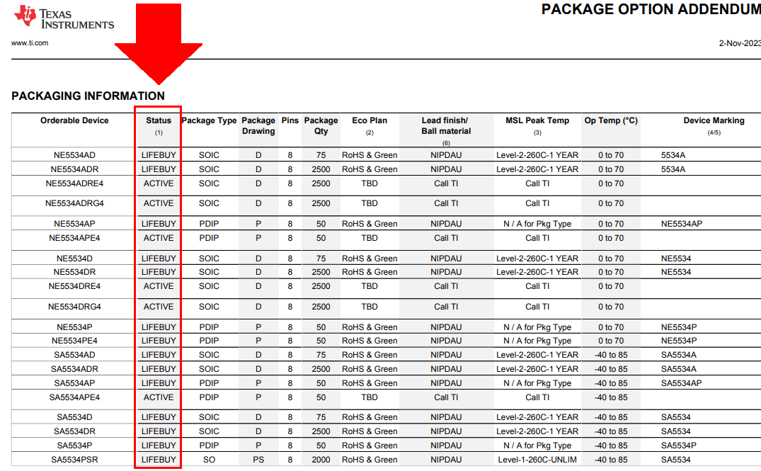

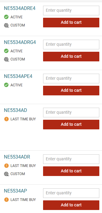

NE5534A end of life announced

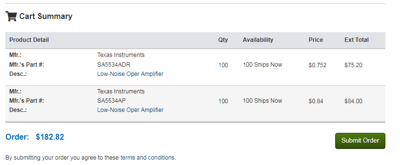

I just made a hoarding-panic order at Mouser, 100 each in both thru hole and SOIC. I chose the "Industrial" temperature grade, -40C to +85C, because the additional cost was so low.

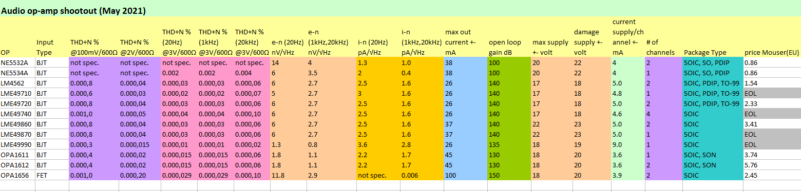

OPA1642 ad OPA1652 are JFET devices with reasonably low voltage noise and low distortion - the 1652 however cannot drive 600 ohms well.
The LM4562 of course has 12dB more current noise than the NE5534A and the issues with high susceptibility to RFI, no production testing for noise (with large variation by all accounts).

They now are not so awful ! : OPA192 has 5.5 nV/sqrtHz @ 1 kHz and 10 nV @ 100 Hz, almost 1641 . And THD 0.00008% and 5 microV offset (vs 1 mV of 1641). Input current noise 1.5 fA/sqrtHz @ 1 kHz (vs 0.4 pA of 5534). For MM phono is much better than 5534, 210, 1641, imho. PS. Output short circuit current 65 mA vs 38 mA of 5534.

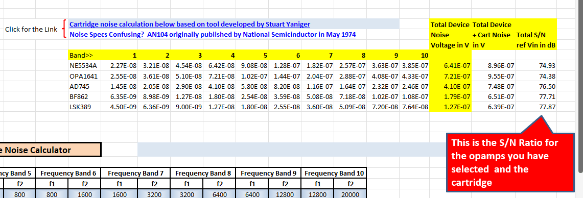

Because of the noise shaping by the RIAA EQ amplifier, you can do slightly better with an OPA1641/2 than a NE5534A and you get better RFI to boot. The SNR figures below are the absolute best case for a standard RIAA EQ amp with a cart of 1000 Ohms and 500 mH, 47k load and 125pF input capacitance (c 1.5-2m interconnect cable from T/T to phono amp). The gain setting resistor for these results was set at 110 Ohms (which is what the X-Altra MC/MM used but with paralleled LSK389/JFE2140 devices for the MM stage).
Of course, the OPA164x devices are a lot more expensive.
Data below from the Hifisonix RIAA noise calculator you can find here https://hifisonix.com/preamplifiers/so-just-how-quiet-is-your-phono-stage/
