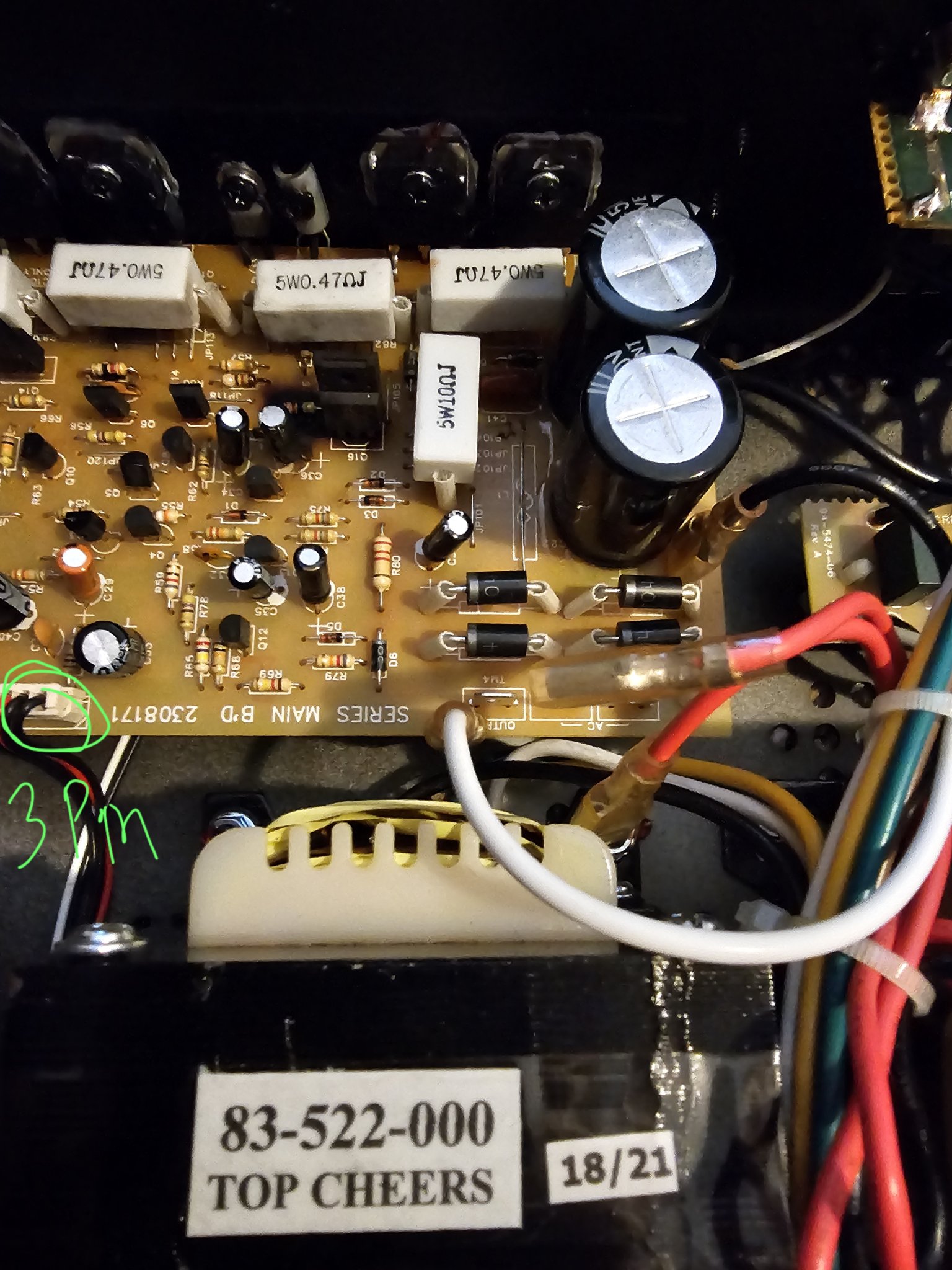

Hello, I am new to electrical engineering, but I am competent enough to understand a lot of the basic things. I am trying to fix a Bogen C100 that I acquired, and have attached the schematic provided by the manufacturer. When I got it 2 of the resistors had catastrophic failures and at first I didn't know why, and don't fully understand still. They are R70 and R77 both 22ohms. I replaced those with the same type and value, and when I turned in on, the BJT, G17, burned up. I believe R74 also was overstressed because part of it charred, but it didn't fail completely. It's value is also unlabeled on the schematic and I pointed it out. I got another BJT, a 2SD718 NPN BJT. I replaced that, but I didn't replace R74. I connected everything back, but a connector to another part of the circuit, wasn't plugged in. It was a 3 pin connect that I believe connected to the front potentiometer volume knows and it's board. There is only one actual plug connector, everything else is tab connectors on the main board. From what I remember that should mean that any other boards connect through that boards connection as well. When I turned it on that time, i saw sparks on what looked like the main board near the ac main side, but cant be 100% certain. I checked everything and nothing seem bad, burnt, or otherwise hurt. I noticed connectors between GND and COM as well as between LINK and 4ohm. I was wondering is something was shorted, so I checked for continuity on those connected terminals and all the others to include the 25V, 16ohm, 70V, and right end GRD. They all had continuity with each other, but I don't know if that is supposed to be like that or not. I ended up takeing off the connectors between them and turn it on again, I believe I plugged the 3 pin connector back in. Well the new BJT catastrophically failed and burned a hole on the right side, which may be the emmiter. The resistor that was unlabeled R74 also seemed worse. I measured the resistance of it before and it measured 219ohms in the circuit, but now value starts below that and climbs. I can't read the value because the middle 2 rings are charred off and or lost their color. I don't have a full picture of the internal components right now but but will be able to attach one later. I am attaching everything else I have and an image I found showing those back connectors.
So my questions are as follows;
1. What is the value of R74 supposed to be?
2. What could I have caused to make components fail?
3. Why is the device and components not working correctly.
4. Can I safely test components to make sure they are good and if so how? (If desoldering is needed that's is fine)

When a directly coupled amplifier fails, there is a cascade of failures that ripples back through the circuit destroying several devices. Any attempt at repairs by replacing one of the failed parts simply repeats the failure and sometimes worse. Whenever an amplifier repair is attempted, the initial power up must be done under controlled condition so that overlooked problems can be detected before more new parts are destroyed. The classic device is a power limiting device such as a series incandescent lamp in the AC power and perhaps the use of a Variac transformer to bring up the voltage slowly. Initial power up is done with no load connected.
1. 220 Ohms is a reasonable value for R74.
2. The circuit includes an overload detection and protection, but it may not be effective, especially if C35 and C36 have dried out. Failure is usually due to an output short, but this amp uses an output transformer which is a hazard to such an amp.
3. It's clear that the output transistors have failed. This results in a current surge that shorts some transistors and opens others. This is a classic failure.
4. Transistor shorts can be detected in circuit but ultimately you have to remove and test the bias VBE multiplier Q7, the protection circuit D1, Q13, Q15, D4?, C35, C36, drivers Q14, Q16, outputs Q17, Q18, Q19, Q20, resistors R74, R81, R82, R83, R84.
Once you have tested and replaced all these devices, you may attempt a power up using a power limiting device, and no load. When you get zero DC on the output ("4 Ohm" no link) and then connect a speaker to test the sound. A signal generator and oscilloscope is a better way to test the "sound" if you have them. Transistors can be partially tested as two diodes using an ohmmeter, however this is not a totally conclusive test.

If R74 has fried, it is because Q14 and/or Q16 are shorted. They provide the excess current path which causes this. Outputs can be blown too, but only blown outputs wont usually take out the charge- suckout resistor since the fault current does not flow through it.
In case of a driver or output failure, you’re supposed to replace the whole kit and kaboodle, and at least TEST the vbe multiplier. You can get away with just replacing which side is blown if only one is - but you do risk leaving overstressed devices in there. In any case, if one fails in a parallel bank, you must replace the whole bank so that there is CONSISTENCY.

R77 is base driver resistor to Q16 lower driver. Usually this blows when output transitor failure takes out Q16. O.T. could have been replaced by previous owner. Short of ZD1 or C33 could do it. R74 is not labeled but if it is the one next to D2 between bases of Q17 & Q19, then yes, output transistor failure or driver failure either one could burn it up.
When output transistors short extremely high current slips out the base line and blows up a lot of parts forward of that. Output transistors failure usually caused by wiring fault or shorted speaker coil or part. Screw terminal P.A. amps do not suffer the wiring faults that bar band phone jack amps incur all the time.

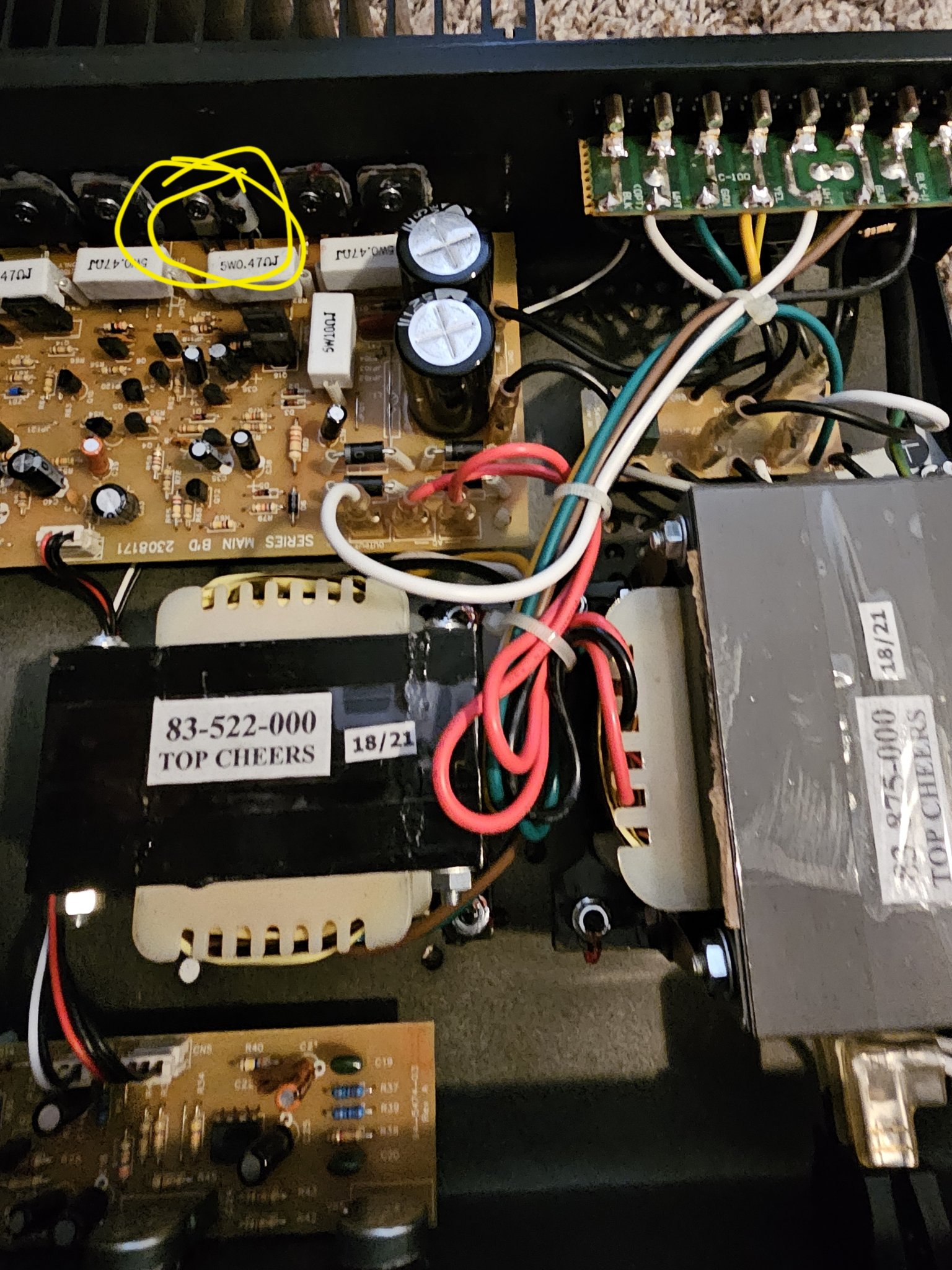

The thing in the yellow circle may be a heat sensor transistor. I believe in that metal loop connected directly to the back of the case is a black plastic TO-92 case transistor. So the plastic of the case insulates the electrical parts. The metal loop is supposed to conduct heat to the transistor. the screw holds the metal loop to the case.
No heat temperature sense transistor in the schematic, so this could be R67 a thermistor. R67 has it's own insulating case. Looks like a thermal shutdown of signal to Q5 & Q8.
