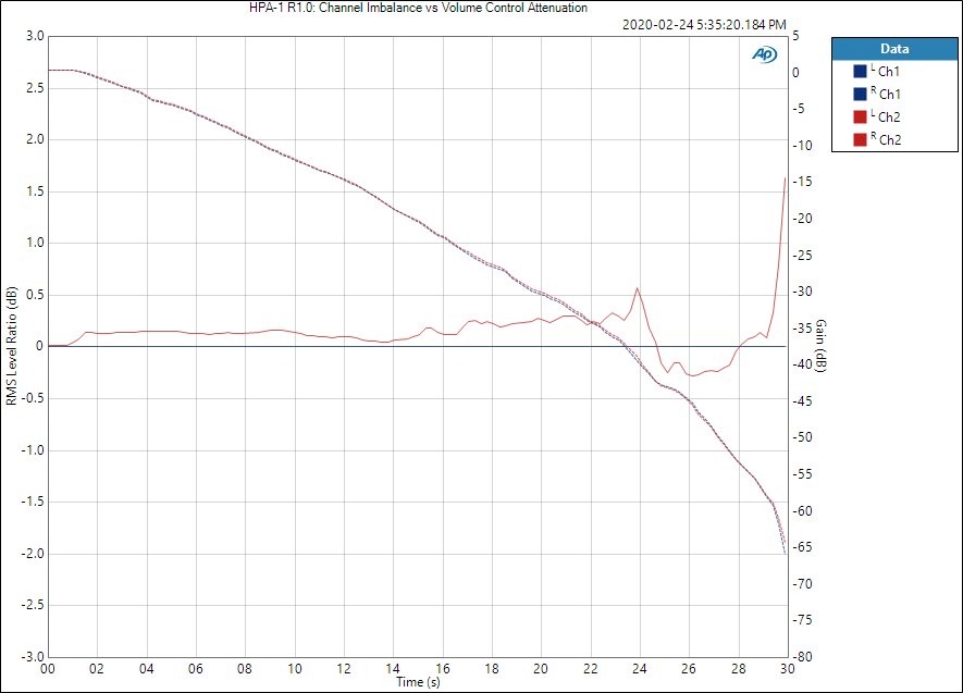

No, spend the time to look at the sample chart in the article. The article teaches how to convert to decibels as well. Then you will come to understand why ALL normal stereo potentiometers will mistrack. Look at the small values at the start. These small values have to be maintained by BOTH channels in a continuous variable resistor. Look at the first 5 or so values and then look at the total resistance of the whole rotation and then calculate the sensitivity and then convert to decibels. That is the reason why Tom recommends staying away from the first part of the rotation of the pot because mistracking between channels is severe at the early part of the pot as explained prior.
Conversely, if you were to have one channel's first say 4 resistors mistrack by a factor of two, by the time you reach the second to last resistor, you'd never notice it but at the lower levels it would be horrible.
Take an audio taper pot and an ohmmeter and take some measurements! Then stick in those values on a scientific calculator or in excel and you will see the problem. All reasonably priced pots suffer this unless you are super lucky!
Now if you are operating at the far end of the pot, yes, you are OK but if you increase your gain, you will be operating at the lower end of the pot and you likely will notice it as Tom explained.

Right. But as I also point out in the interview, it's actually really hard to find the spots on the pot with high tracking error. I was only able to do so because I deduced where the transitions would be from the data sheet and searched around those areas.
I'm not denying that you can find volume settings with a large (±2 dB in case of the Alps RK271, for example) mismatch, but you will only see that large mismatch over a minuscule change in pot rotation. We're talking a small fraction of a degree here. In actual use, you'll never see it, as evidenced by attached plot. The plot shows the attenuation vs pot rotation for my TCA HPA-1 headphone amp. It uses an Alps RK271 ("Blue Velvet") pot.
Contrast that with an attenuator, where finding a spot that delivers an SPL that's comfortable for background music can be a challenge.
I'm content with the tracking error of a volume pot. But, sure. For the ultimate precision in tracking you need an attenuator. If I ever design one, I would make it a relay-based one, though. Using one of the many volume control chips would be an option too. Those are basically attenuators in IC form.
