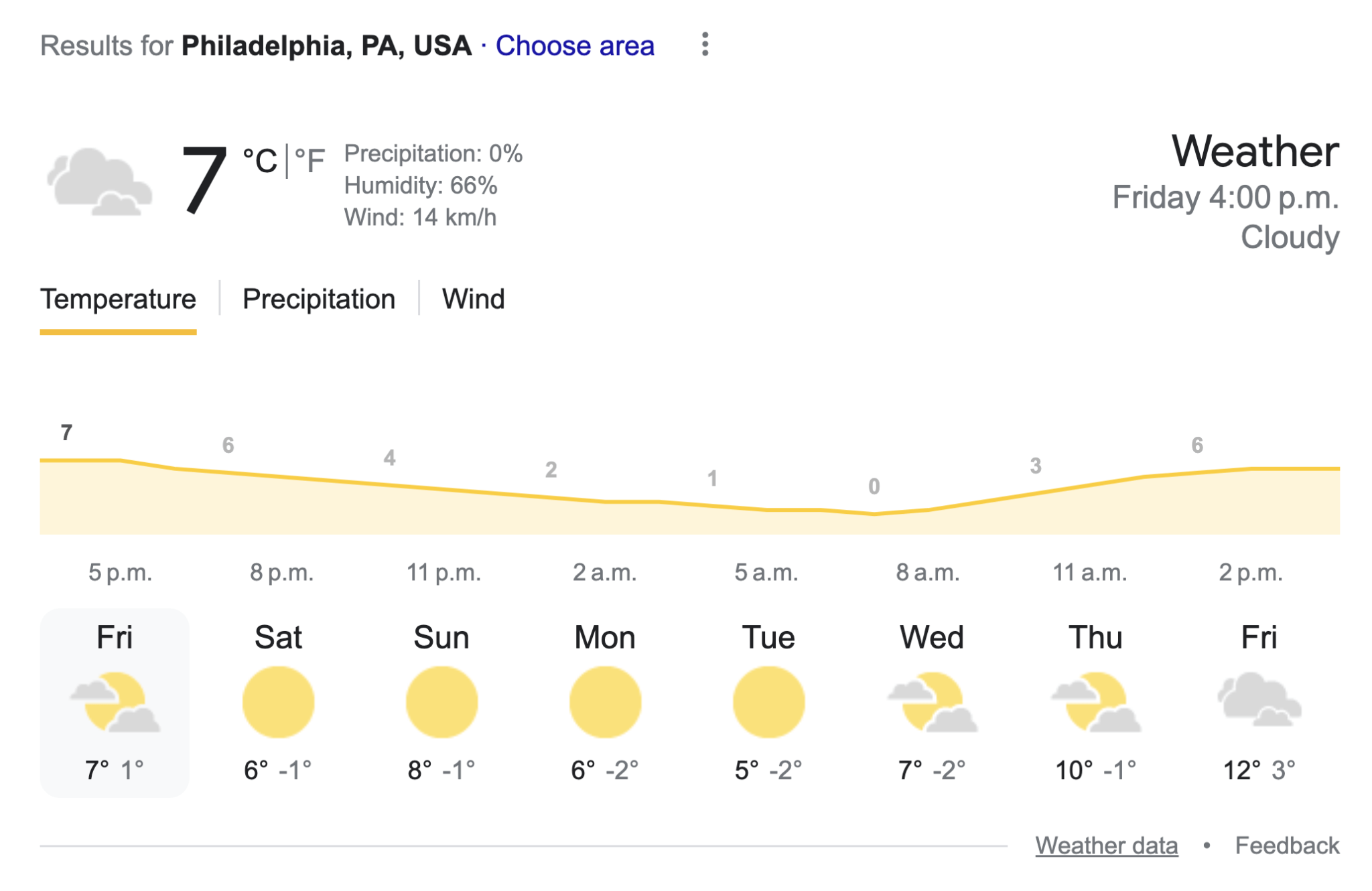

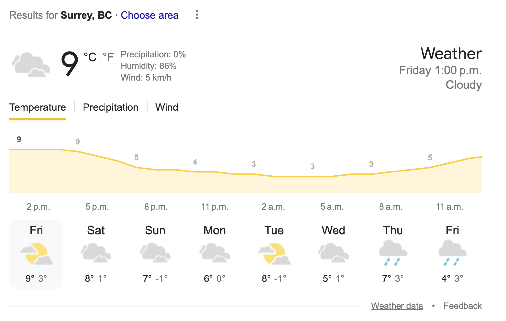

climate here is fairly mild, nothing like Canada.
hehe. Vancouver is actually a little cooler in the summer and a little warmer in the winter, than the SE corner of Pa.
This is current.
