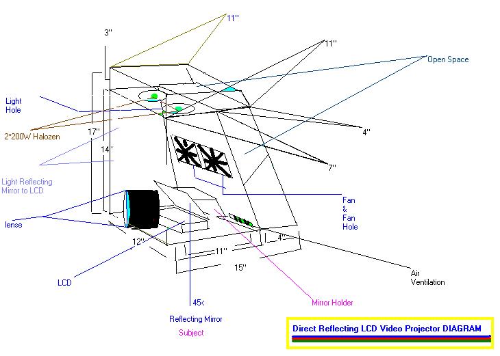

Hmm, thread seems to have been dead for over a week but if I'm bored so I'll throw in my 2 cents. Looking at the most recent projector design posted I would have to say that it will not work. As has been said before you are indeed trying to use light to filter light. The light from the LCD shines onto the mirror making an image on the mirror (if you use some sort of special glass like that HUD stuff). Shining light through this will indeed just make your image more washed out and likely nonexistent as LR said. I still think that ace was talking about something different. (If this is what you meant ace then I stand corrected.)
Unless someone can show me a schematic to the contrary then I'm led to believe that the plus projectors do not work this way. Seems to me that they probably work by shining a very bright light onto the object that is being projected and then taking what light is reflected (though significantly reduced by most objects since they aren't that reflective) and collecting that to be projected back onto the screen. This is not at all what jake's projector design does.

snowman,
I don't see how that picture will result in a projected image.
How does the light get from the panel (after reflecting off of it) and through the glass/mirror arrangement and out to the screen?
What I DO see:
Light goes from the lamp through the mirror. Some light reflects down to the panel and some goes out the lens directly.
Some light (after bouncing off of the panel) goes back to the lens.
Some light (after bouncing off of the panel) goes through the mirror and hits the top of the box.
No light (after bouncing off of the panel) goes out the lens and toward the screen.
Can you draw a path with numbers showing how the light gets from the lamp to the screen?
It looks like you are trying to project an image onto the mirror, and shine a light THROUGH that to get an image. If that's the case, it won't work. You can't modulate light by shining it through an image on a pane of glass or a mirror.
What am I (still) missing here?
plus projectors dont work that way and we know if u'd bothered to read the previous posts -
the paper etc. sits on glass at the top and under is a mirror on a 45 deg angle. now there are also two halogen lights pointing at mirrors mounted on the internal wall.
that means that when u light in from the top all you can see is mirrors and 2 lights

Ok so the great minds here have established wht seems to have been obvious from the start. A mirror can't be reflective and transmissive at the same time. You can't project a reflection, which is essntially a projection itself.
