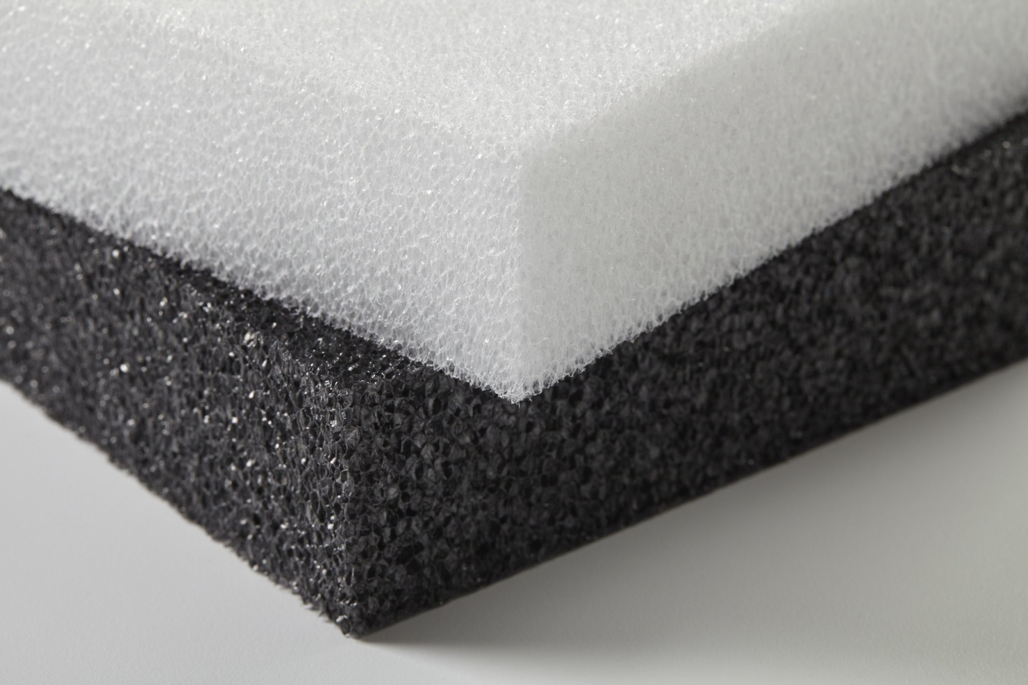

So my $0.02 CAD worth on this: I've shipped a couple of heavy amps, including two DG300B weighing in at about 17 kg, each. Definitely create a foam surround for connectors, switches, pots, and anything else that sticks out of the chassis. I would use either the pink insulation foam sheet for this or the high-density foam shown in Post #20. Tape this surround to the amp. Without it any drop of the box will cause the connectors to eat through the cushioning and smack into hard objects. That causes chassis panels to bend and switches to get broken.
