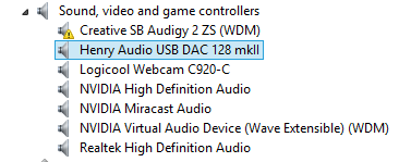

It was a mix of hardware (cold solder) and incomplete instructions for batchisp?? Program command was missing. This is now working:
C:\Program Files (x86)\Atmel\Flip 3.4.7\bin>batchisp.exe -device at32uc3a3256 -h
ardware usb -operation erase f memory flash blankcheck loadbuffer awx_20140918_m
kII_RC03.elf program
Running batchisp 1.2.5 on Mon Jun 12 17:02:03 2017
AT32UC3A3256 - USB - USB/DFU
Device selection....................... PASS
Hardware selection..................... PASS
Opening port........................... PASS
Reading Bootloader version............. PASS 1.0.3
Erasing................................ PASS
Selecting FLASH........................ PASS
Blank checking......................... PASS 0x00000 0x3ffff
Parsing ELF file....................... PASS awx_20140918_mkII_RC03.elf
WARNING: The user program and the bootloader overlap!
Programming memory..................... PASS 0x00000 0x1c987
Summary: Total 9 Passed 9 Failed 0
After this, I did a reset from dfu-programmer:
C:\dfu-programmer-win-0.7.2>dfu-programmer at32uc3a3256 reset --debug 4
target: at32uc3a3256
chip_id: 0x2ff1
vendor_id: 0x03eb
command: reset
quiet: false
debug: 4
device_type: AVR32
------ command specific below ------
It now shows under audio widget devices? Audio interface and Control Interface??
Bingo;)
ardware usb -operation erase f memory flash blankcheck loadbuffer awx_20160323_
olume_control_0dB.elf program verify start reset 0
Running batchisp 1.2.5 on Mon Jun 12 21:41:58 2017
Parsing ELF file....................... PASS awx_20160323_volume_control_0dB
elf
Programming memory..................... PASS 0x00000 0x14383
Verifying memory....................... PASS 0x00000 0x14383
Starting Application................... PASS RESET 0
Summary: Total 11 Passed 11 Failed 0
